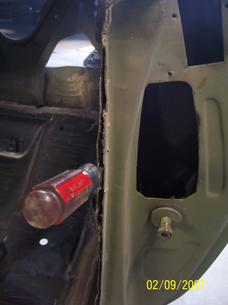

Well, I have to agree with Chris' original post in that the bad work out there is becomming more apparent. I think it's mainly because of the mad rush to make fast money when muscle cars (especially Camaro's) started going through the roof several years ago. Before I met Todd, I was building a car for another customer. He had purchased a Camaro online but not ebay. I'd have to say that the car looked as advertised when it arrived. The seller said it was ready to paint with no rust and it looked close to that description when it showed up. Well I saw a small bit of seam sealer on the floor durring disassembly and decided to pick at it. I didn't stop picking until the Car needed a new floor, firewall, outer houses, fenders, etc....you get the picture. The LH door was hitting the "A" pillar so I pulled on it and found a 1/4" gap that was filled with duraglass. Actually, the pillar was no longer attached to the car. The replacement quarters were not even welded to the door jam and they never fixed the wheelhouses. Can't tell you how many times I see guys put quarters on without fixing the wheelhouses. If that customer would have had me just paint the car and not fix it, I'm sure it would have killed him. The lack of welds throughout was incredible. I think a lot of novices have no idea of what "Uni-body" means or even care about safety.
To say the buyer was at fault would be correct to an extent since he didn't pay for an inspection or inspect the car himself. He spent another $10k on the car just to have me fix all the problems. It came from a body shop who filled it full of mud to get it out the door. Just like Chris' friend, they did a great job making it look like all the rust was repaired properly.
I also agree that ebay has a lot of junk, but you do on rare occasion find a good solid car. "Payback" came from ebay and it was a very solid car. I remeber looking at the car for Todd and was very surprised at how good it really was. I told Todd that if he didn't buy the car I would. Like many have already said in this thread, don't go cheap and always personally inspect any facility doing work for you if possible. Customers shell out a lot of money for what they expect to be quality work. There are however customers who want to cut corners to save a buck. I usually tell those customers to find another shop because my name is on the line. I also doubt if they would tell anyone that they told me to do a crappy job. Some shops have no sense of pride because they are rulled by the almighty dollar. I'm a different breed. I do this because I actually like it and take great pride in giving a quality job as I'm sure the shops that are a part of Lat-g do as well.
Here's a few pics of the Camaro I mentioned above.
Both quarters were never welded to the jam

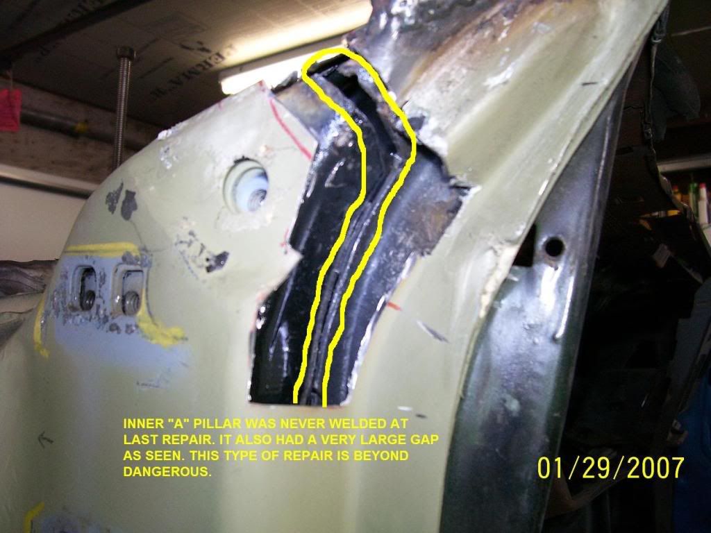

"A" pillar cob job!

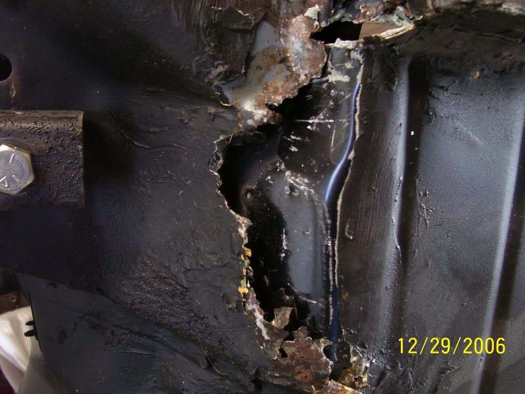

Nice floor pan repair with Duraglass!
