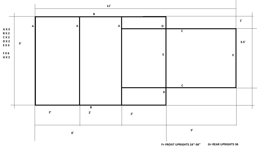

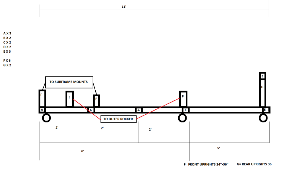

Cart/Jig
So I have been tinkering on Paint.... I dont have access to a CAD program( probably overkill anyway). I came up with this fairly simple(for me) design for a Cart. I have seen some plans floating around but wanted to try my own. My main problem is how to account for the rear clip. For now Im going to install the floors and do the rear clip after the trunk is installed. I would like to find a way to attach it to my cart, however I'm not sure there is even a point.
It's paint... dont be too harsh, it may be hard to read.
http://i987.photobucket.com/albums/a...o/CARTIDEA.png
http://i987.photobucket.com/albums/a...EASIDEVIEW.png

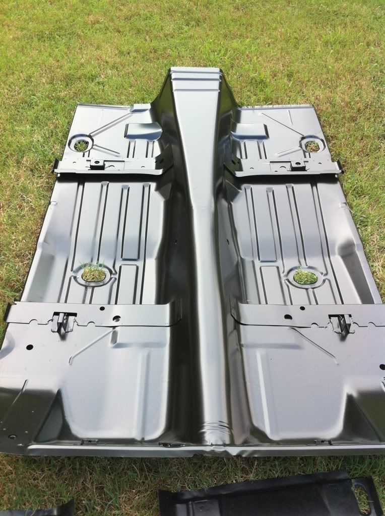

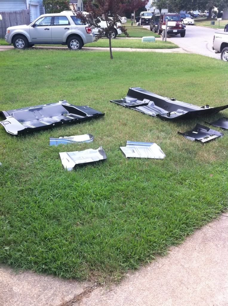

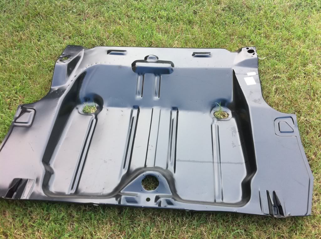

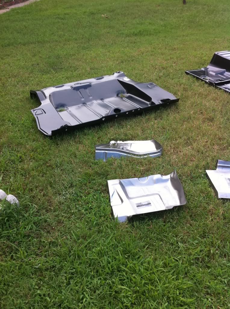

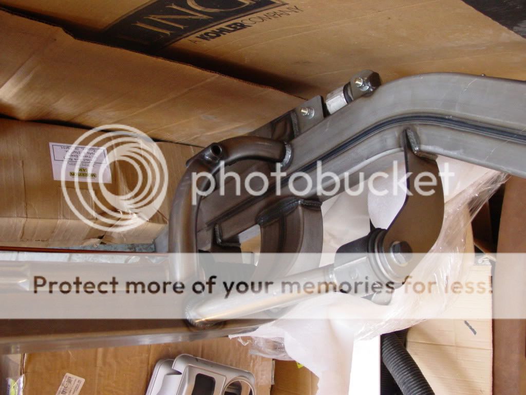

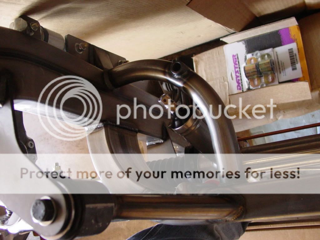

while throwing some weld through primer on the rails of the AME clip,I heard the growl of a Diesel. Yesterday I recieved a call from a frieght company asking if a Semi could fit in my neighbor hood, I told them most straight trucks have problems. I look out to see a Semi with a 48' trailer squeezing between cars.
we ended up getting him to the house, and got the parts unloaded. all the floors arived in good condition. there is one extra brace on the main floor pan which i'm not sure what that is I'll take some better pics tomorrow. I'm guessing it for a convertible.
http://i987.photobucket.com/albums/a...o/414d72d5.jpg
http://i987.photobucket.com/albums/a...o/6e035a14.jpg
http://i987.photobucket.com/albums/a...o/273807a9.jpg
you can see the brace infront of the rear seat mount
http://i987.photobucket.com/albums/a...o/4740bf05.jpg
http://i987.photobucket.com/albums/a...o/634adc76.jpg
waynieZ 08-11-2011 06:29 PM
Nice load of parts :thumbsup:
I think that brace your talking about with the cage nut is where the sub frame bolts to. My hardtop had it too.

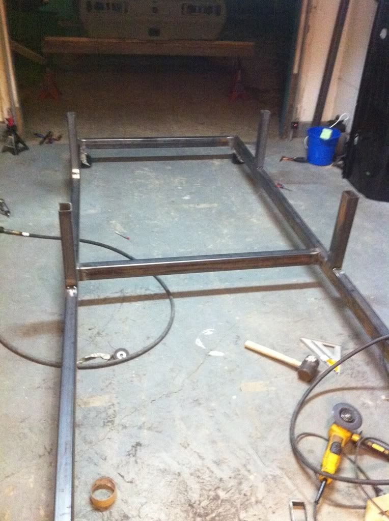

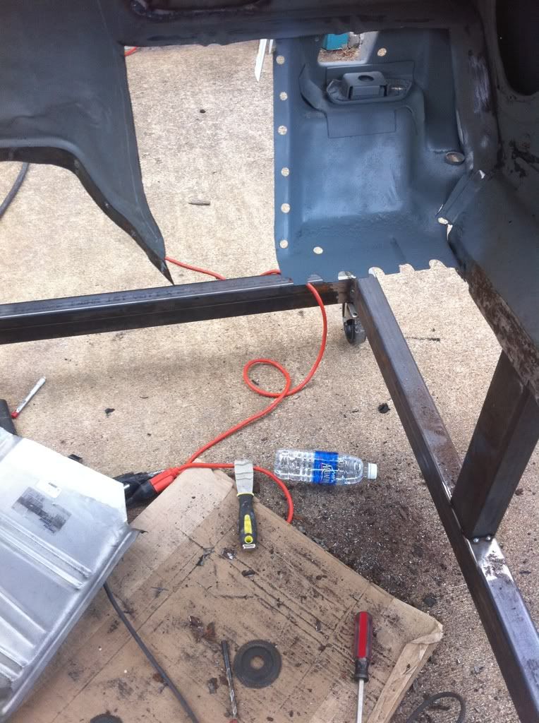

johnnymac46 08-19-2011 08:01 PM

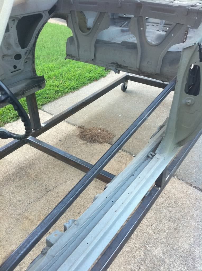

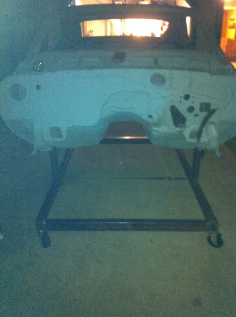

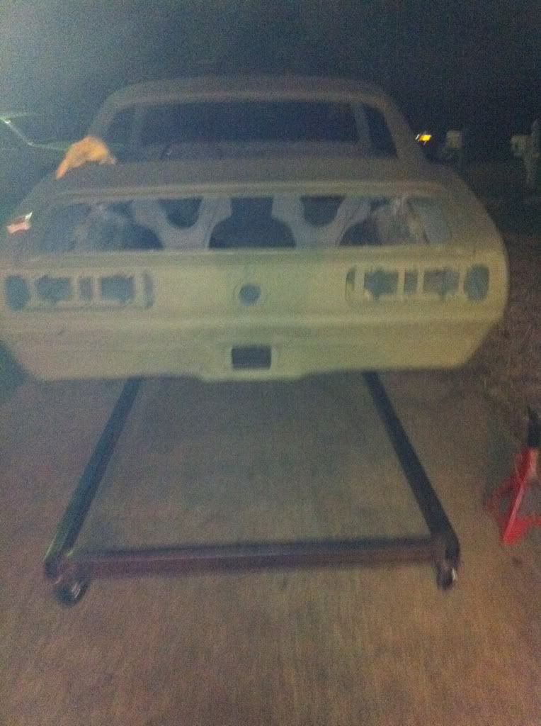

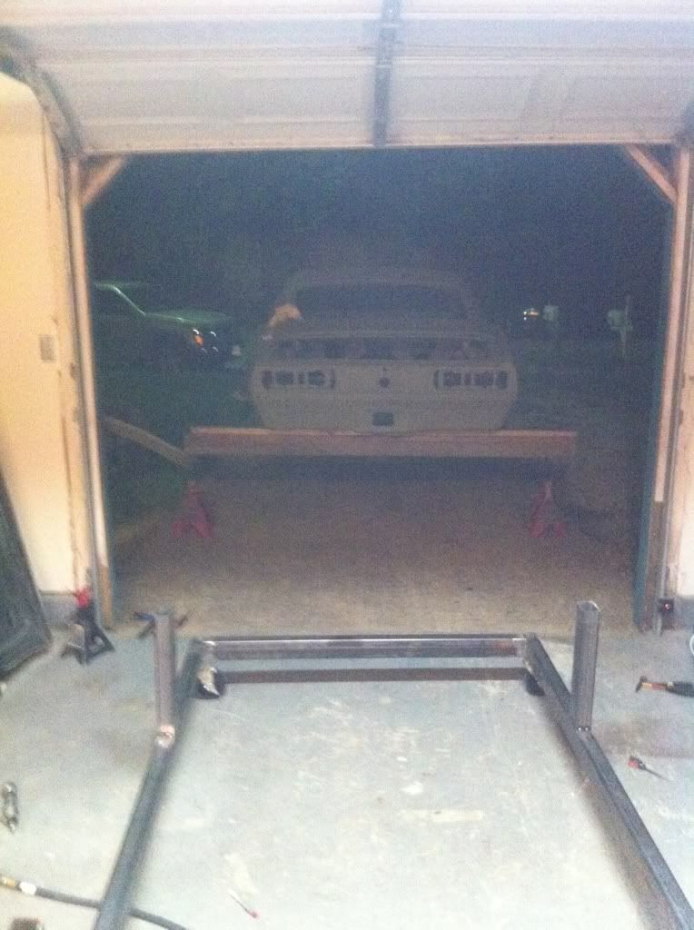

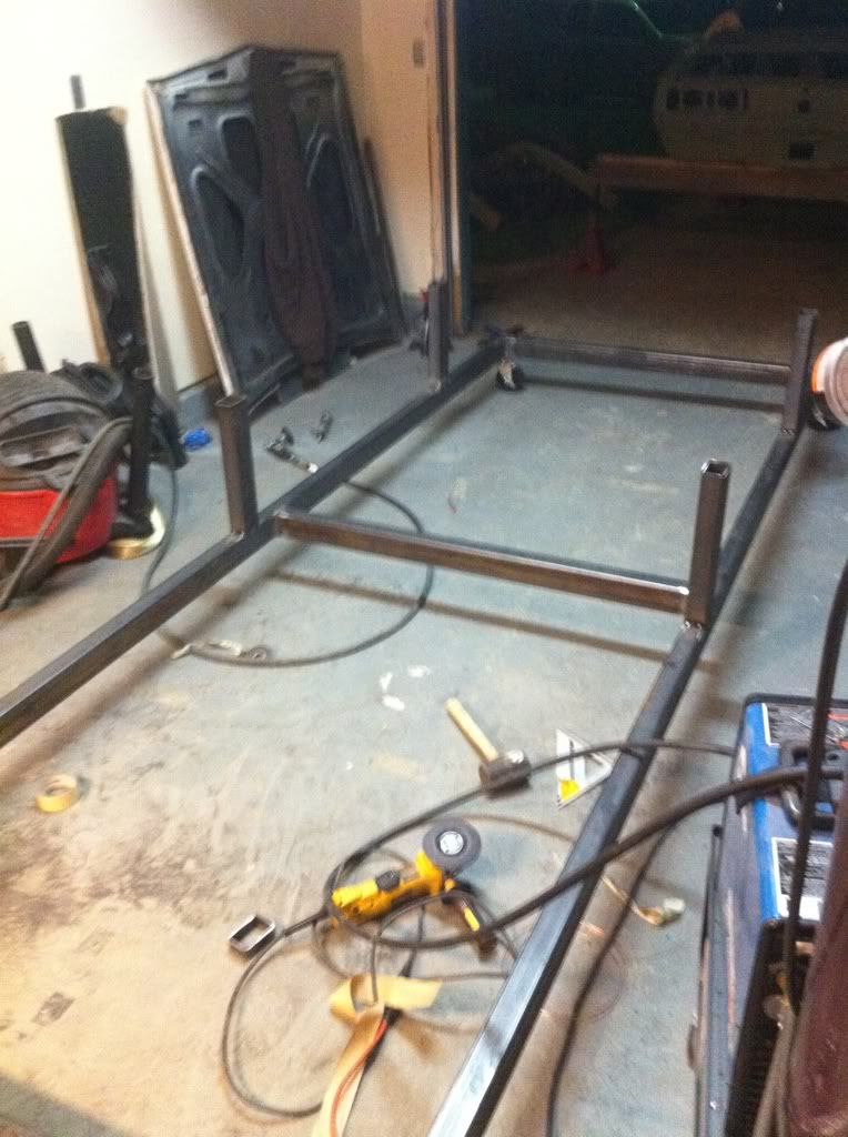

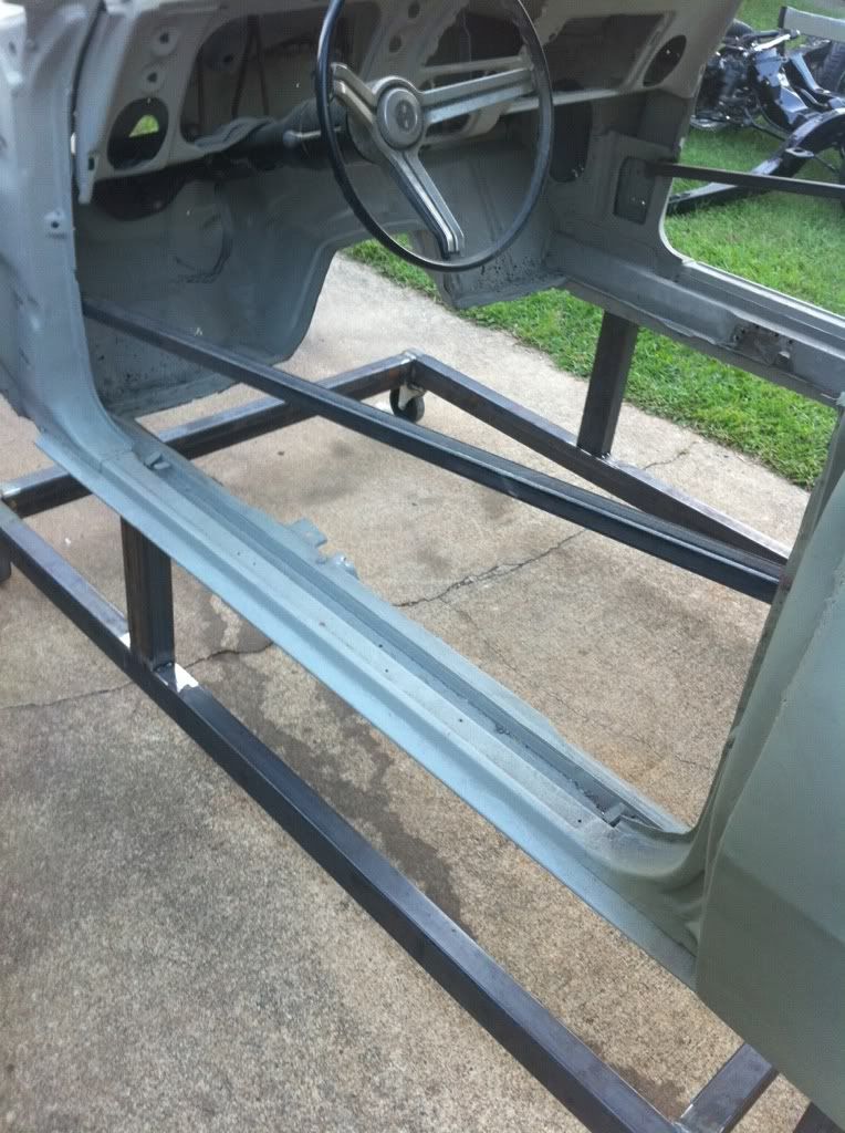

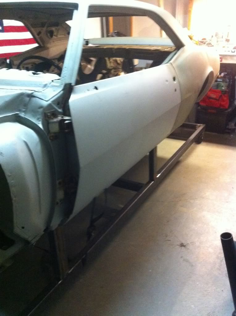

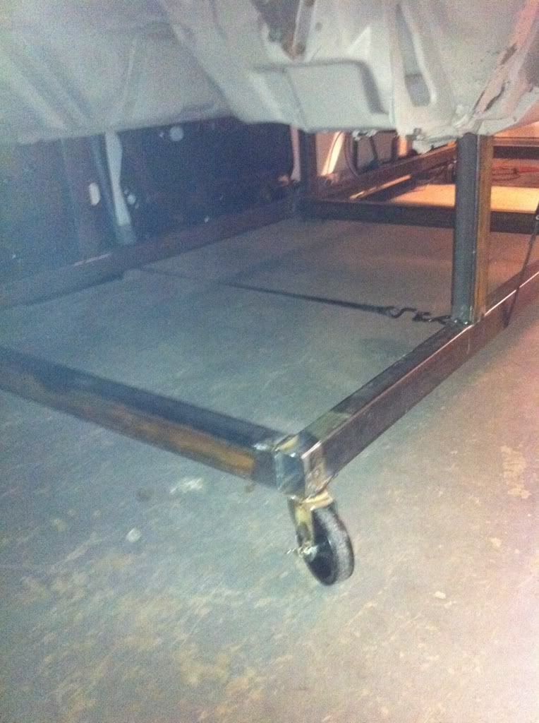

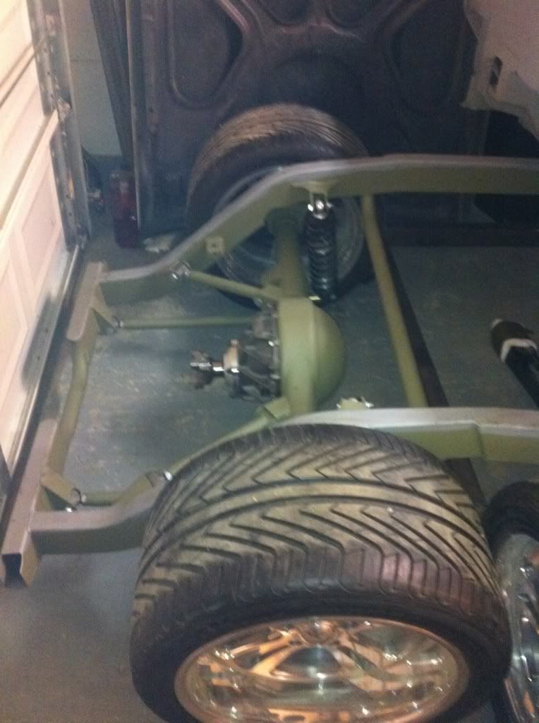

Update of the day..... I made my way to the local metal distributor today, and picked up two 24' 3x2 11ga tubing and one 24' 1x1 11ga square stock. When I got home I started to build my cart. Not the elaborate plans I made I went super simple (hopefully it does the job).
After getting the main box tack welded together and square I ran out of wire for my Mig. Made a trip to Northern Tool and picked up the wire and some caster wheels.
I ended up getting it together after a lot of head scratching, sweating and measuring and re-measuring. Then came the fun part.
I chose not to take any pictures of me moving the car onto the cart, because I was worried it could fall at any time. With the more 2x2's and 4x4's and jack stands than I care to mention I ended up getting it on for the night.
Tomorrows plan is to get the car squared up on the cart, and final the rockers to the cart to keep the car where I want it. Then brace the inside of the car with the 1x1 square. Then out with the floors:willy:
here are some crappy Iphone pics I'll get the camera out tomorrow.
http://i987.photobucket.com/albums/a...o/3ef6fcc9.jpg
http://i987.photobucket.com/albums/a...o/4110d599.jpg
http://i987.photobucket.com/albums/a...o/8f898de2.jpg
Once I get the car where I want it I'll add in a rear brace to keep the trunk from sagging
http://i987.photobucket.com/albums/a...o/6f0083d4.jpg
http://i987.photobucket.com/albums/a...o/9b116ff1.jpg
http://i987.photobucket.com/albums/a...o/882faeb4.jpg
http://i987.photobucket.com/albums/a...o/931ad451.jpg
http://i987.photobucket.com/albums/a...o/2d823ca5.jpg
The garage is real tight now
http://i987.photobucket.com/albums/a...o/5cbe8379.jpg
http://i987.photobucket.com/albums/a...o/5dd33110.jpg

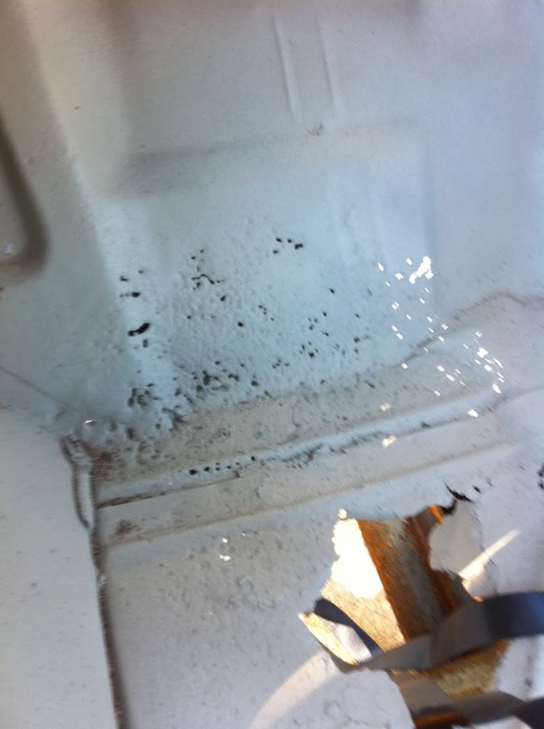

So the doors are braced, and I rough cut the floor out. I left about 1/2 inch by the spot welds. I need to invest in a spot weld remover. I have a couple step drill bits, and some bits that work pretty well for spot welds.
I went through all of my cutting discs for my grinder and almost threw my battery powered dewalt kit into the street. The batteries weren't holding a charge for more than 10 minutes. I'll give it another shot tomorrow, they have all night to charge if not I'm going to pick up some tools with cord.
I only had time to take a couple of pics (iphone) before the sun went down. My Camera is also dead....which goes to show anything battery operated will fail when you need it.

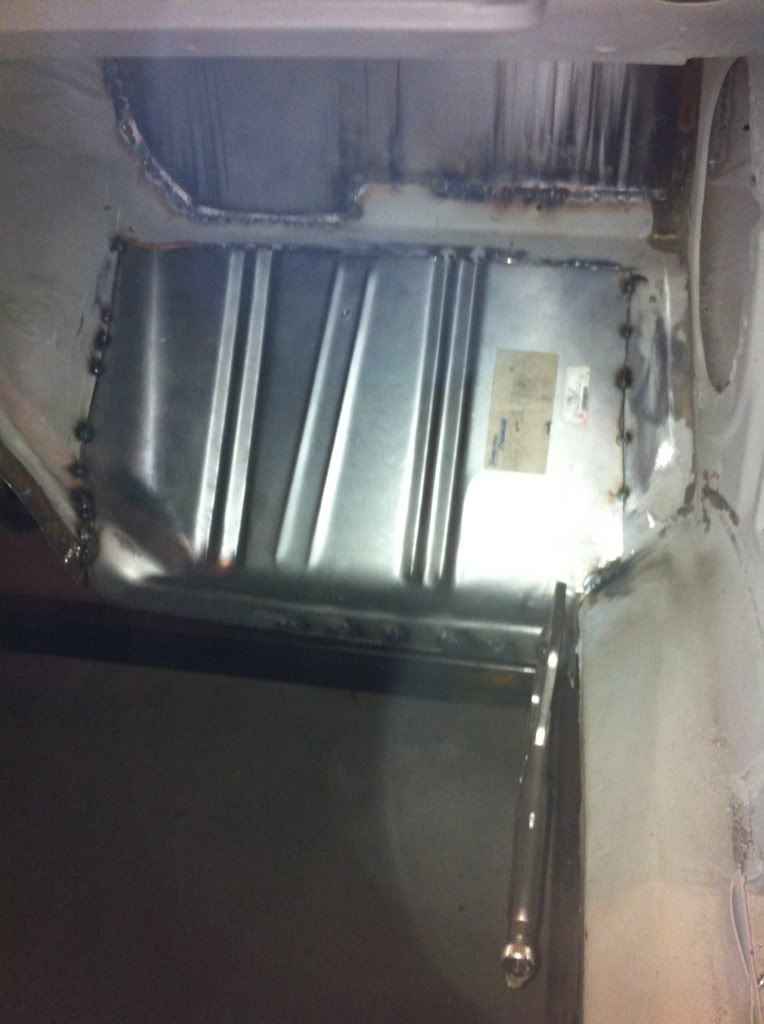

I removed the floorpan spot welds and started on the passenger toe board

Nothing new just better Pics, I have to finish the passenger toe board and install the driver still. I took the last few days off from the car because of a memorial for some fallen friends.... and now I'm waiting on this Hurricane to pass to get some more work done.

I had to move everything inside including all the scraps from the original floor. I have the chainsaw on standby for this storm.

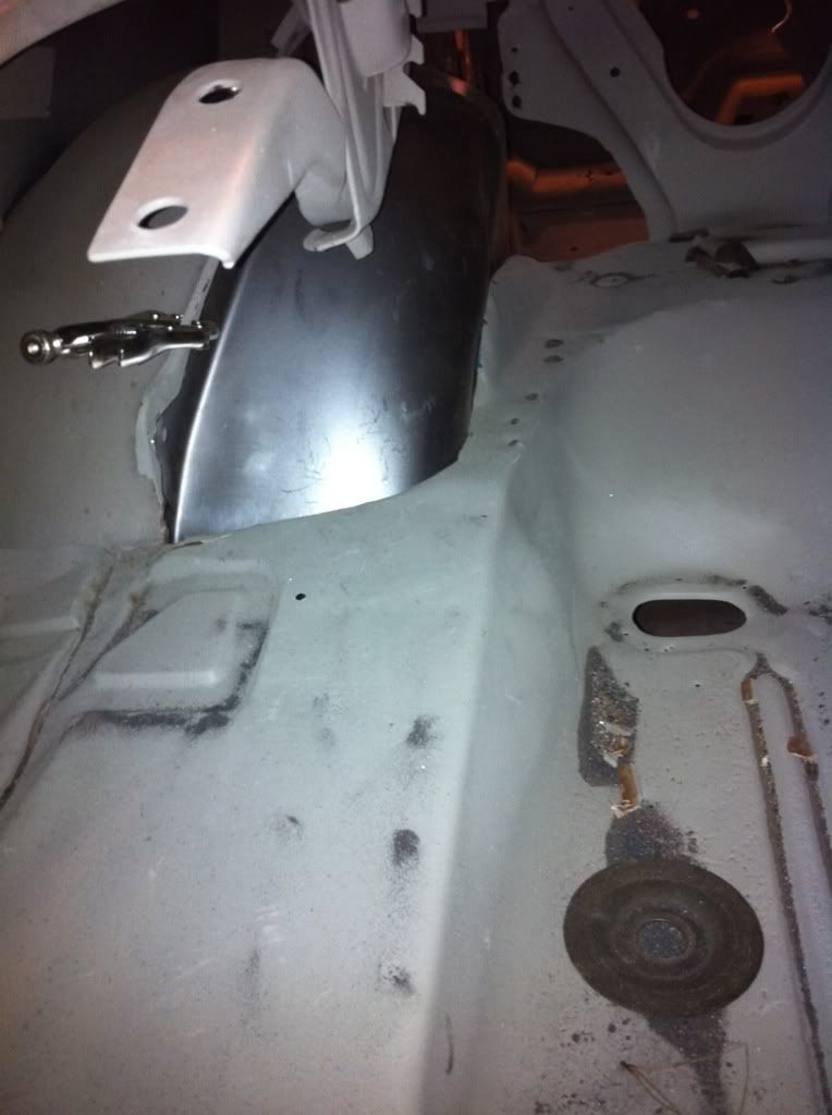

I got the one piece floor in and much to my suprise the subframe bolted right up and everything went well on that end.

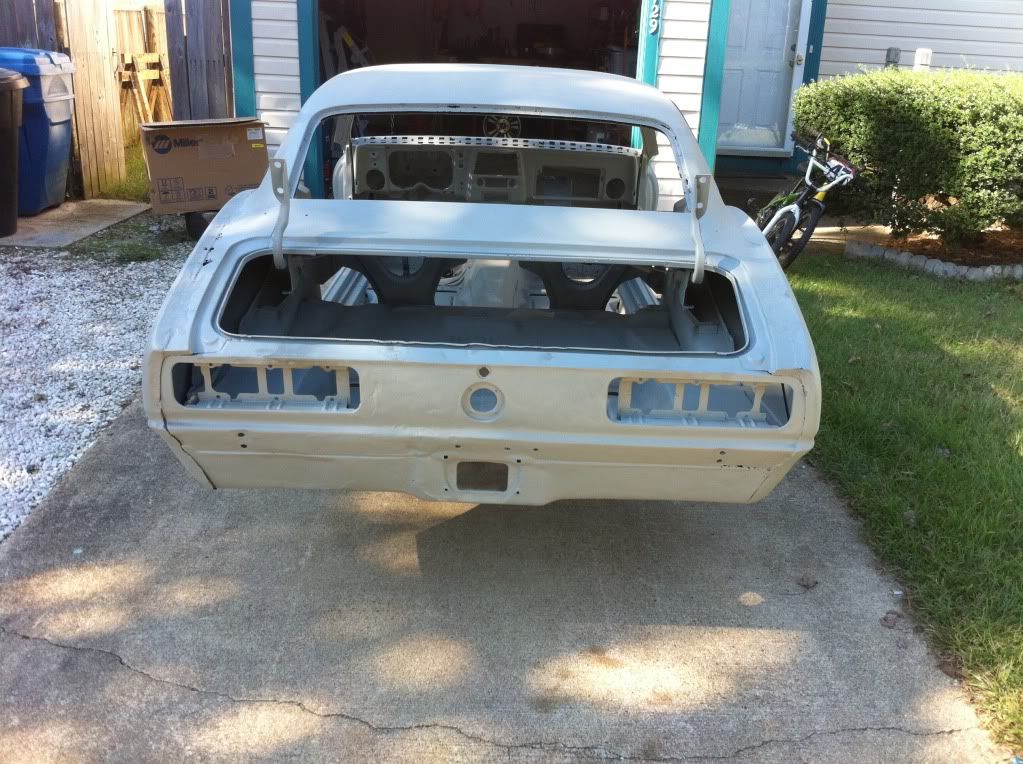

Yesterday I cut out the trunk pan, the more I looked at the tailpan the more I knew it needed to be replaced aswell. I saved myself about 100 spotwelds by just cutting it out as one piece. The previous owner did a pretty terrible job doing Qtr skins which left me 5 spot welds on each side of the tail pan, and a huge discusting bead weld on the bottom of the qtr I needed to cut.
I started to mock everything up in the trunk area, I still need to make some fill plates for the trunk floor. I am waiting on a new outer wheelhouses, tailpan and inner panel. I am still debating if I want to replace the Qtrs while I'm in there. I dont do it now I think I will kick myself later.

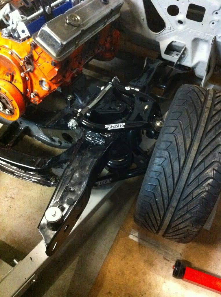

Originally Posted by johnnymac46 (Post 289300)
I took all of the glass out, and got the firewall stripped down yesterday. Thanks a lot to Frank from Prodigy Customs, he saved me a lot of time and headache with a quick tip on the E-brake cable. I hope to get it off to Media in the next week or so. from the looks of things im going to need to replace the whole floor pan, and do some work around the rear window
http://i987.photobucket.com/albums/a...o/P5250118.jpg
http://i987.photobucket.com/albums/a...o/P5250115.jpg
Care to share how to get The E-brake cable out?

Just wondering about the firewall fill plate shown here, did you go with DSE fill plate to smooth the firewall or you fabricated plate by yourself?
Is the fill plate welded on both sides or from inside only?

I went with the DSE plate, its a nice piece, I cut out the inside to avoid rattling, then welded 90% from the outside and the rest from the inside in the difficult areas.
