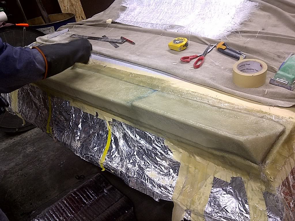

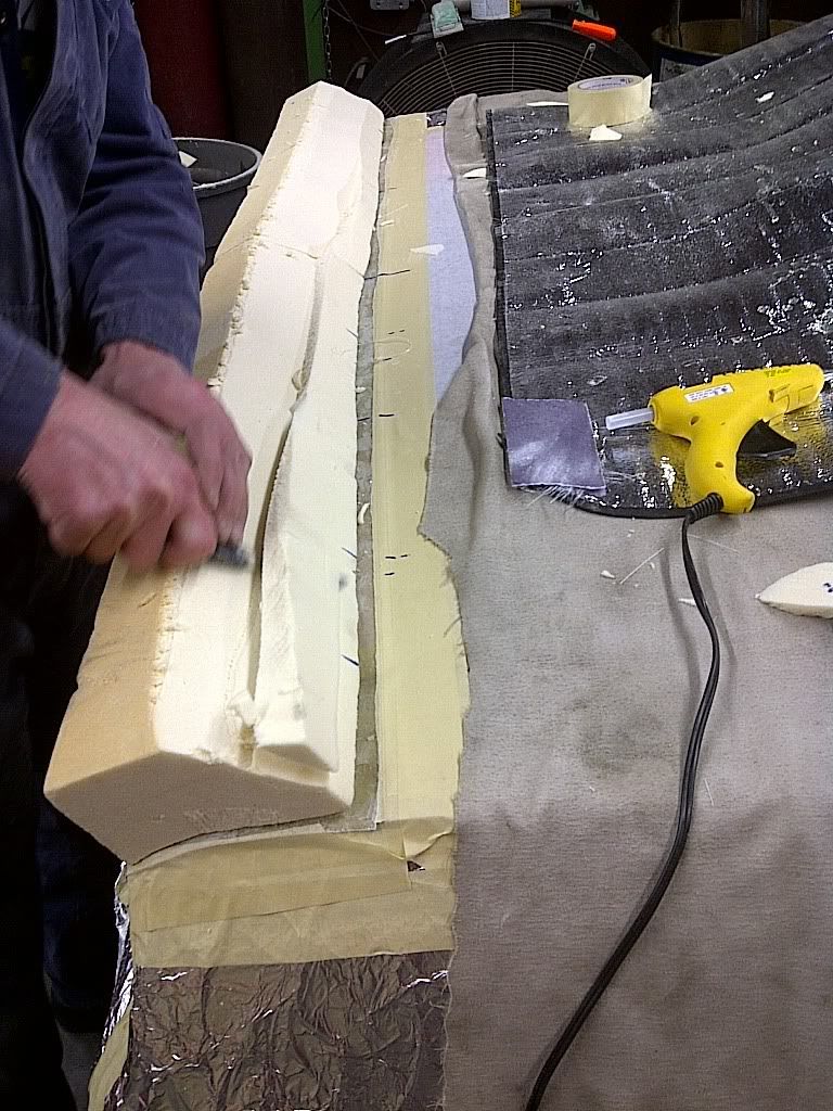

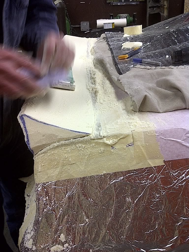

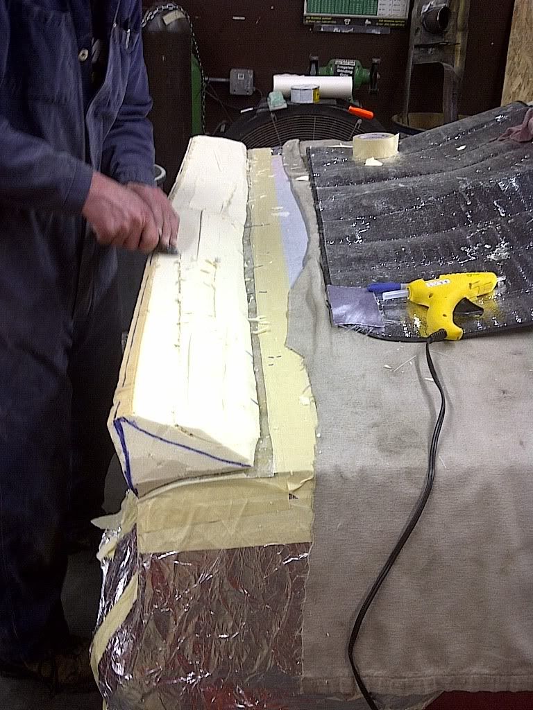

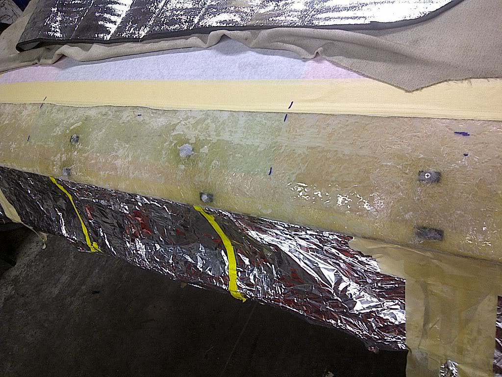

Ok, so I couldn't deal with how the stock spoiler looked on RedZed so....here we go again :rolleyes: . One night after work, Gary and I decided to make a new custom rear spoiler. So out cam the tinfoil :_paranoid and away we went.
http://i1187.photobucket.com/albums/...0322-00066.jpg
Add a little foam...
http://i1187.photobucket.com/albums/...0322-00065.jpg
and start carving...
http://i1187.photobucket.com/albums/...0322-00068.jpg
and shaping....
http://i1187.photobucket.com/albums/...0322-00072.jpg
and sanding....
http://i1187.photobucket.com/albums/...0322-00073.jpg
starting to shape up :D
http://i1187.photobucket.com/albums/...0322-00081.jpg
more coats of fiberglass...
http://i1187.photobucket.com/albums/...0322-00085.jpg
Ready for fill and paint.....
http://i1187.photobucket.com/albums/...0404-00088.jpg
MaxHarvard 07-27-2011 09:58 AM
Roger, what kind of foam is that and where did you get it?
I've been trying to find that stuff for forever!
redzed 07-27-2011 10:03 AM

redzed 07-27-2011 10:13 AM
Just a high density urethane carving foam is what I've been told. We get it from a local foam shop.
