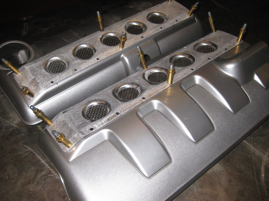

What are those, coil covers? Nice work Scott!
pokey64 02-11-2011 08:40 PM
I'm liking the dimple details Scott. Keep the updates coming! :thumbsup:

Ron,Ed,those are LS2 GTO coilcover's.I cut the inset area out where it said GTO then flare punched some .063/3003 alloy alum. sheet.The stainless wire cloth is from McMaster-Carr warehouse.Going to paint coil covers argent silver,and flared alum.pcs.black wrinkle then aircraft rivet the flared pcs. down.Car is headed off to the paint shop to day.Will add progress to the photo bucket as
Mr.Brian work's his magic.Thank's Scott

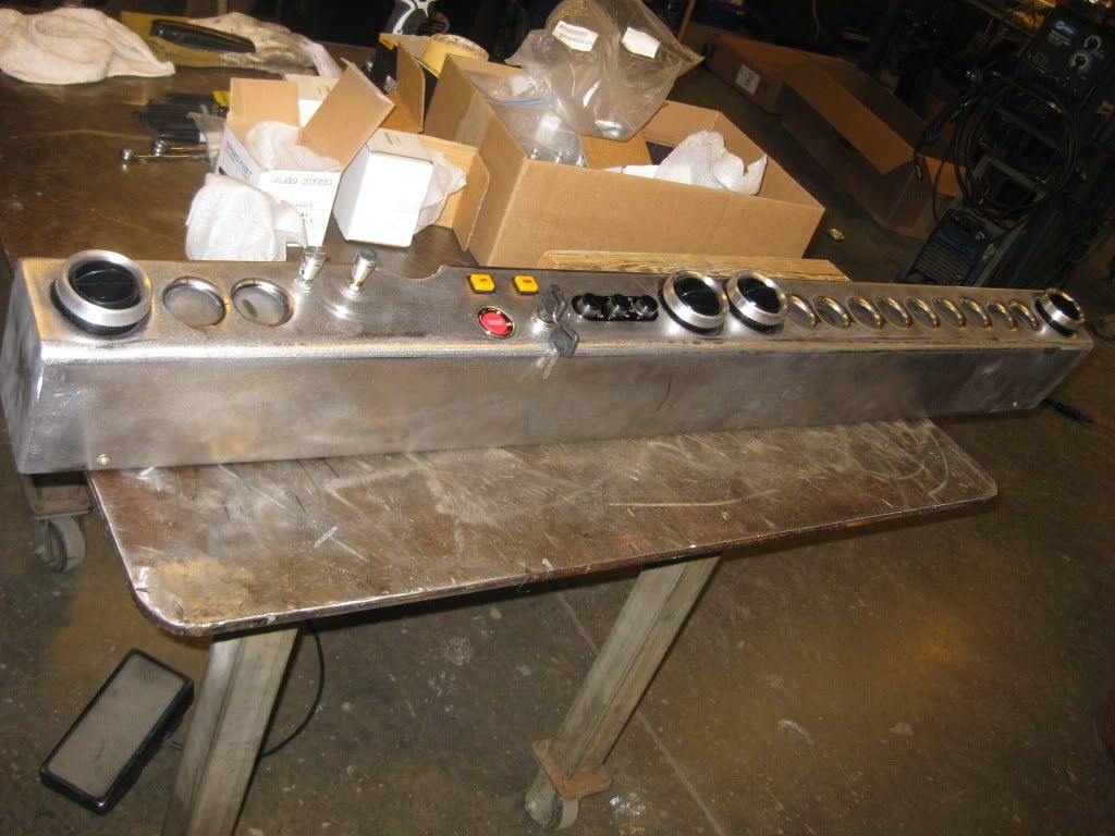

I am really digging what you are doing with the dash Scott!!
http://i1196.photobucket.com/albums/...2/IMG_0010.jpg
http://i1196.photobucket.com/albums/...2/IMG_0380.jpg

Scott.... the lower dash looks incredible..... I always thought the lower portion in 2nd gens were lacking something.....
coolwelder62 02-12-2011 06:16 PM
Thank's,I think your right about those's dash's.Dan Holoahn & DSE get all the credit for the dash design.I just strole the DSE site grabing idea's.
