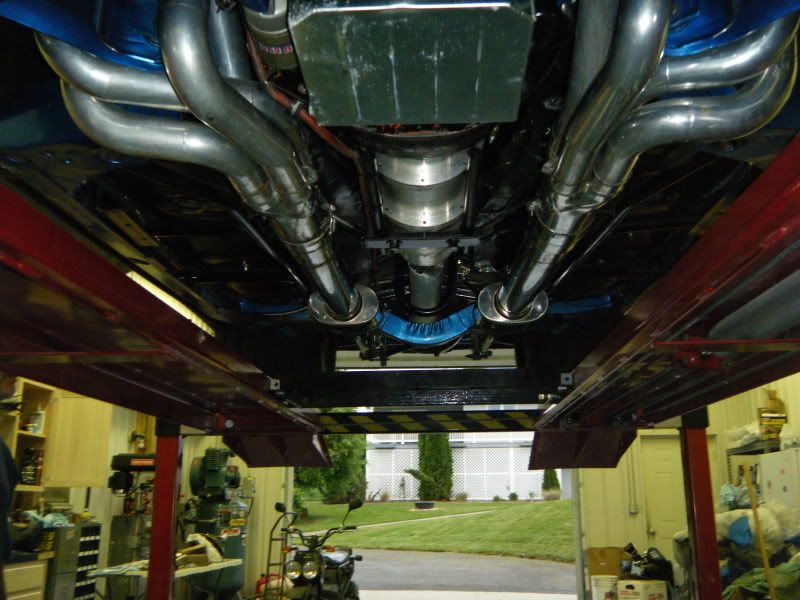

cantcatchmitch 05-30-2011 07:50 PM
http://i24.photobucket.com/albums/c2...even/041-3.jpg
http://i24.photobucket.com/albums/c2...even/036-4.jpg
http://i24.photobucket.com/albums/c2...even/038-1.jpg
http://i24.photobucket.com/albums/c2...even/037-1.jpg
http://i24.photobucket.com/albums/c2...xseven/302.jpg
http://i24.photobucket.com/albums/c2...even/040-2.jpg
it doesnt look like much, but ive kept myself busy on this old girl. in the past few weeks i built the whole exhaust, 3" mandrel bends with dynomax race bullets that im hoping arent too obnoxious for long trips. i got just about all the plumbing done in -8 stainless braided, of which i stripped the anodizing off all the fittings and polished them out, i also built stainless rad hoses, which are of course, polished. this weekend my friend and i aligned the car, and i got a few more pieces painted. the trans tunnels been modified for the six speed, and i got about a third of the car buffed out too. i also got a bunch of the trim repaired and back on the car to boot.
ive also been really busy with my dads car, his 496 big block powered 66 chevelle. this winter he picked up a jeffco transmission, which is clutchless, and like a lenco has a lever for every gear. it is straightup badass. well, that transmission isnt shaped anything like the richmond 6 speed that is now in my car, so we had to make a few, er mild changes. the middle three feet of the floor was cut out and reshaped. a removeable tunnel was built, runners were ran on the frame for strength and an easier way for a tranny mount, new trans mount was built, new 4" exhaust was built that doesnt hang so low under the car and its got new carpet now and a new parking brake lever from lokar. it was an exhausting project, but we knocked the whole deal out in about 2.5 weeks.
http://i24.photobucket.com/albums/c2...xseven/305.jpg
http://i24.photobucket.com/albums/c2...xseven/304.jpg
http://i24.photobucket.com/albums/c2...ven/011-20.jpg
http://i24.photobucket.com/albums/c2...ven/009-22.jpg
http://i24.photobucket.com/albums/c2...ven/008-31.jpg
http://i24.photobucket.com/albums/c2...ven/007-30.jpg
http://i24.photobucket.com/albums/c2...ven/005-32.jpg
and a video.
http://i24.photobucket.com/albums/c2...ven/th_310.jpg
let me know what you think guys.

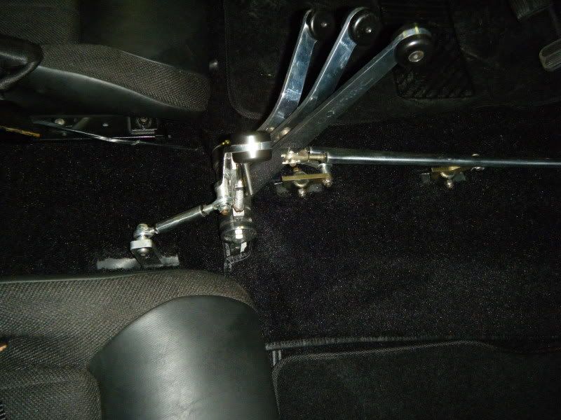

Leadfoot1 05-31-2011 11:07 AM
Too cool!!!!
Very nice of you to put up that video too! I was going to ask how its shifted so i am anwsered!!!
One other question if you dont mind, i looked at your rad hoses and they are VERY nice. I would like to do something similar and am wondering where i can get some tubing for that? Also, what are those rubber sleeves? They look Sooooo clean!
Thanks, and keep on knocking down the work on the Imp, it gets better every post!

cantcatchmitch 06-01-2011 02:32 PM
Lead,
the hoses are just pieces of stainless tubing i got from columbia river mandrel bending. found here>>
http://www.mandrel-bends.com/catalog...FQMRNAodrzg_dA
the rubber sleeves that connect them are just silicone hoses that i also got from columbia river. i think jegs and summit also sells both of those items.
the jeffco is an unbelievable transmission, at WOT there simply is nothing cooler.
thanks to everyone who checked out my update and left comments, you guys keep me going and keep me pushing myself to get better.

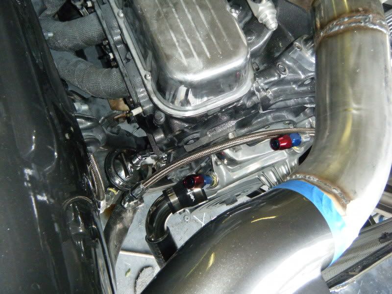

cantcatchmitch 06-08-2012 02:06 PM
so time for an update? i think so.
well since my last update: my wife and i got married in november( we actually moved into our house in august) and have since been busy with being a domesticated husband(ugh). but in all honesty, ive been spending alot of time with her getting moved in, and working on the house projects.
taught myself to drywall and finished the garage, so when the car is ready to come home (im hoping in a few weeeks) itll have a nice place to sleep.
besides that and the car which you'll see in a moment, ive been playing with nitro:
http://i24.photobucket.com/albums/c2...xseven/369.jpg
http://i24.photobucket.com/albums/c2...n/IMAG0291.jpg
http://i24.photobucket.com/albums/c2...xseven/437.jpg
this is nitro, we got him in february and hes 8 months now, pure bread doberman( we decided against cropping his ears). hes a lot of work, but hes really an excellent dog.
ok now for the good stuff.
http://i24.photobucket.com/albums/c2...xseven/450.jpg
http://i24.photobucket.com/albums/c2...xseven/447.jpg
http://i24.photobucket.com/albums/c2...xseven/481.jpg
http://i24.photobucket.com/albums/c2...xseven/490.jpg
my first cold air setup i built, was too low. i could not get the car to idle decent with it on the carb and decided to build a new one, with more taste, and it cured the problem. i didnt have enough room between the roof of the intake and the carb and mustve made turbulence and choked it off. now thats fixed. i molded the new one out of fiberglass.
http://i24.photobucket.com/albums/c2...xseven/448.jpg
http://i24.photobucket.com/albums/c2...xseven/476.jpg
http://i24.photobucket.com/albums/c2...xseven/480.jpg
http://i24.photobucket.com/albums/c2...xseven/487.jpg
http://i24.photobucket.com/albums/c2...xseven/489.jpg
been trying to get all the interior on the car done as well. took a few trys but i finally built some door panels that suit me, only thing i wanna do yet is pull the inserts out and sew some diamonds in them to go with the rest of the interior. the arm rests i got from fesler on there black friday sale and the cranks are from lokar( may change them to billet specialties later) i made a new dash panel out of fiberglass and wrapped it in vinyl instead of the wood attempt i had earlier, it just fits better, also cleaned up the wirings on the gauges as well. i started puttin the stereo togther, built a box for my two 15 inch re subs, and i built mini boxes for all my component speakers as well. i also picked up a 6.5 inch kenwood dvd/cd/nav/ head unit for it as well. ill try and get more pictures this weekend and get them up, but for now i thought id bring you all back up to speed.
