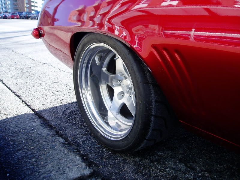

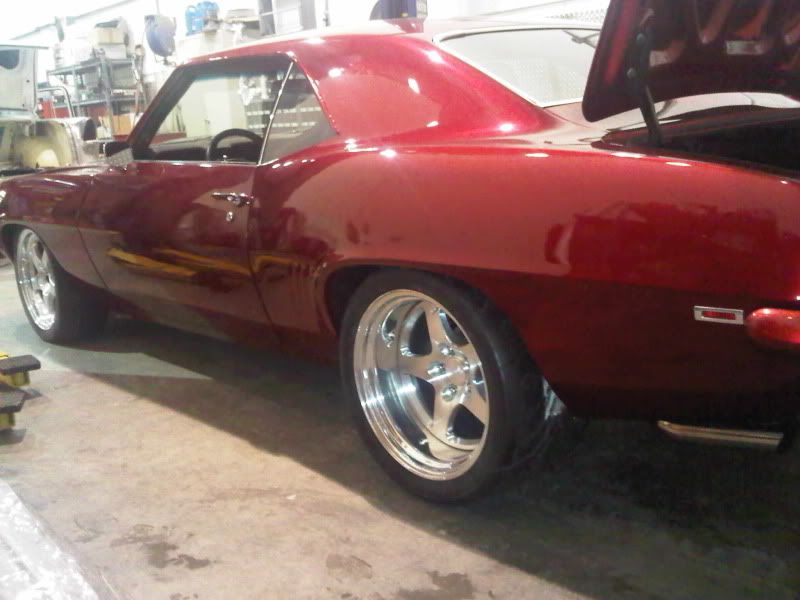

Rybar 01-24-2011 01:31 PM
Well Bill adjusted the height, says this is as low as it can go without the suspension binding. The springs still need to settle. They are 175 lb springs. Have to say I'm a little disappointed, I wanted the rear to sit lower than this but hoping once it settles it will? Any ideas or thoughts are welcome.
http://i34.photobucket.com/albums/d1...10124-1316.jpg
http://i34.photobucket.com/albums/d1...10124-1317.jpg
Sieg 01-24-2011 02:54 PM
What components of the suspension binding is he refering to?
I agree the rear is a little high, is compouned by the front being a little low?My car is about .75-1" high in the rear...........I can definitely relate to the dissatisfaction.
Cannon Racecraft should be able to make custom springs if coil bind is the part of the issue. http://www.cannonracecraft.com/ if the shock length/travel will accept it.
Hopefully it's not linkage geometry.
Rybar 01-24-2011 03:13 PM
He says it's the linkage bar geometry that will bind. Going to a shorter shock or spring would create this.
Looking at Todd's G-bar his car is sitting lower than this, but the G-link is a little different.
I'm going to wait and let the springs settle and then see how it sits. Should have it back this week.
Frank told me this kit could be dropped quite low, but maybe he wasn't exactly correct. I'd like it as low as the DSE setups most guys run.

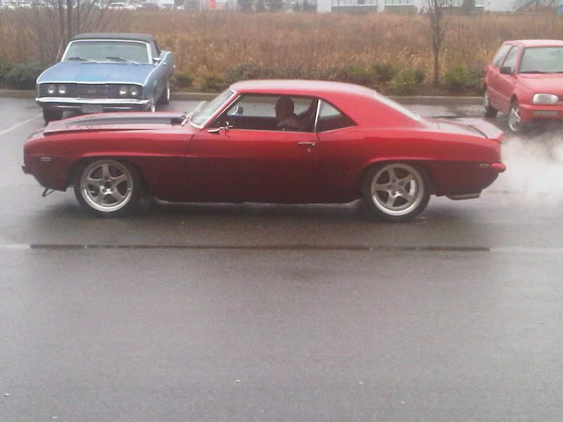

Rybar 01-25-2011 02:41 PM
Guys, so Bill ended up installing a shorter spring. Car is sitting alot lower now and the only problem he can see is the top of the diff pumpkin hitting the trunk floor as I have about 1.5" of travel. The new springs are 200 lb.
Sorry for the crappy pic:
http://i34.photobucket.com/albums/d1...10125-1137.jpg
Franky, the noise ended up being the shifter hitting the trans tunnel shifter hole opening. Bill clearanced it a bit and now the mystery noise is gone.
Sieg 01-25-2011 02:54 PM
1.5" sounds minimal, how much travel does a DSE Quad or AME 3 Link have?
The car looks like it could be .25-.5" low now, full tank of fuel in the pic?
If you're going to track day the car, bottoming under hard corner loads could create traction/control issues at inopportune times. :(
