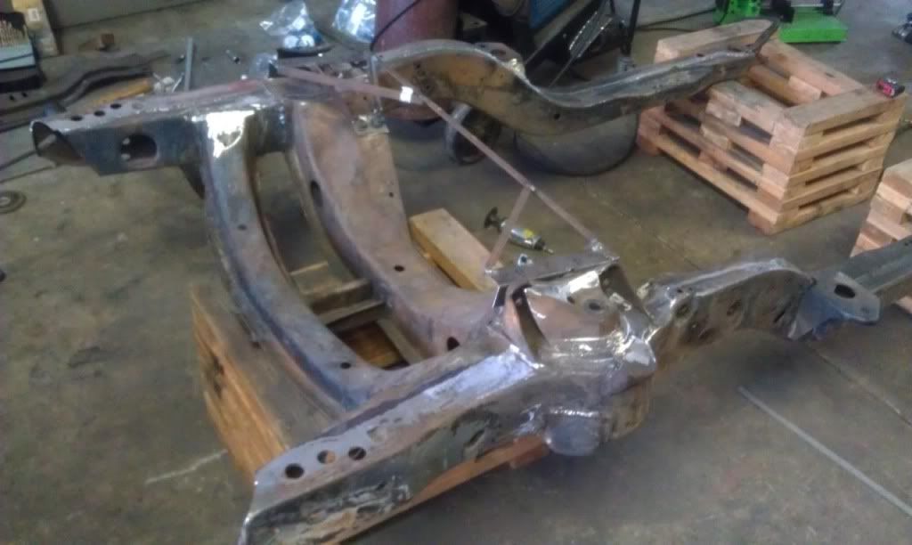

Dave what's the deal posting this silly mini pic?
http://i236.photobucket.com/albums/f...psd37b0b28.jpg
My little brain and old eyes are not capable of extracting details..............:bitchslap: :D

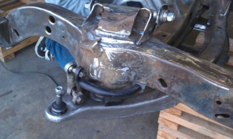

Rich - Did you match the gauge of the control arm for the reinforcing stock?
Pre-shape the plates to fit the arm or tack and clamp as you go?
Upper mounts were cut and lowered 3/4" and moved .25-.5" rearward?
Stock height upper ball-joint?

Hey man it's not cool to shoot the messenger. I just post what is sent to me. :action-smiley-027:
http://i236.photobucket.com/albums/f...hoto_002-2.jpg

Rich, one of these days could you send your assistant a bigger pic of the upper arm mount? If Rob's your photog, never mind. :D

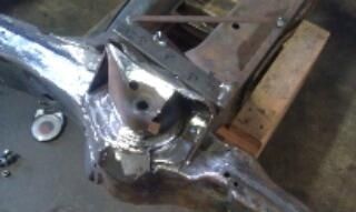

incoming
http://i236.photobucket.com/albums/f...ps9ac2c9b8.jpg
http://i236.photobucket.com/albums/f...psa2dc42db.jpg
http://i236.photobucket.com/albums/f...psc7ab88ac.jpg
Sieg 02-17-2013 03:14 PM
Record breaking response time!! :thankyou:
CrossRamRich 02-17-2013 03:46 PM
I cut the template from construction paper, went to the scrap yard and found some 10 gauge. Plasma cut the piece a little big, tacked, clamped, and bent. Hit it with the trusty 4 1/2 inch grinder, then filed flat. Mocked the bushings, figured out the grease zerk location then welded them in. You could make them lighter by cutting holes, but I'm trying to achieve a period correct look. The uppers are getting a strap on the underside. All this and the iron headed crossram weighs a mint, so I'm hoping to save weight with aluminum brake caliper and hats.
The upper mount is technically a G mod and moved back 3/4 inch more. I built a template to hold the points after cutting everything free. I took alot of measurements before execution.
:cheers:

Does the shock mount remain at the original "height"?

The shock mount gets a shave and a tap into place. Probably about 3/8 down. Don't cut from frame. Just the top.:)

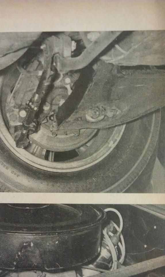

Rich asked me to post this pic of the Smokey bumpsteer correction from Hot Rod December 1967.
http://i236.photobucket.com/albums/f...ps3b21bf26.jpg

Originally Posted by intocarss (Post 465854)
That is one way of gettin the job done. They do make 1/2 inch taller tie rod ends now. Same effect. You have to bump the car to get the real numbers. No springs, no shocks, no sway bar, just hubs and wheels. Pozzi was telling me he has seen over 1/2 " of toe change with some set ups. This is a huge problem with the stock engineering. Fixing the problem will change the whole dynamics of feedback the car will give. We have like 4 inches of travel. Can you imagine what those dudes do with those off road race trucks! :wow:
Check out the boxed arm and bolted lower ball joint. Some crazy stuff there!

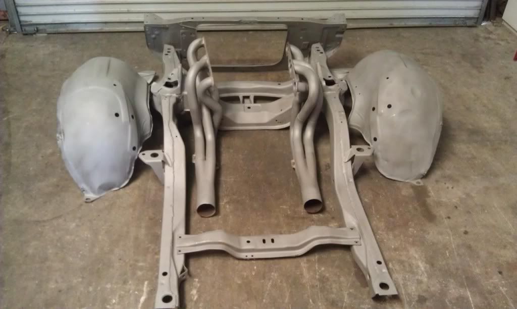

http://i236.photobucket.com/albums/f...psdc0bfc21.jpg
Roberts68 04-06-2013 05:33 AM
Been blastin'? I have a freshly blasted stock sub in my garage right now too. Dropped off Wed and picked up Thursday. Factory welds are hideous!!:welder:
Those header primaries are massive looking! Pretty cool picture:thumbsup:
