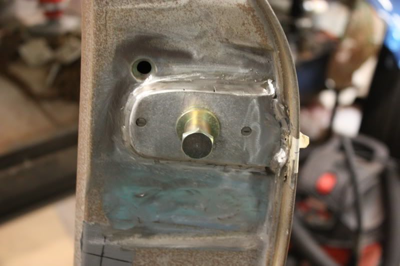

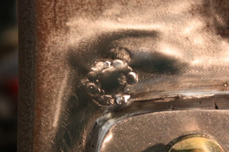

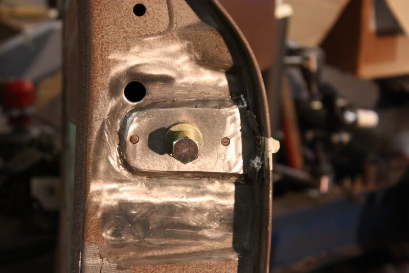

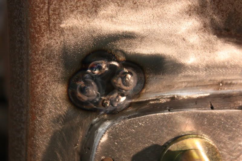

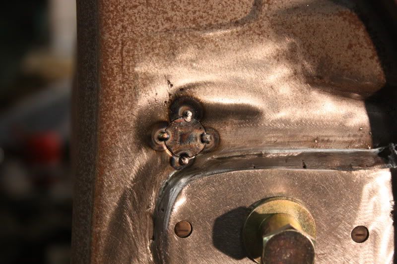

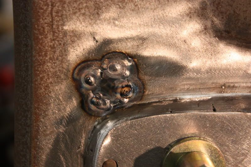

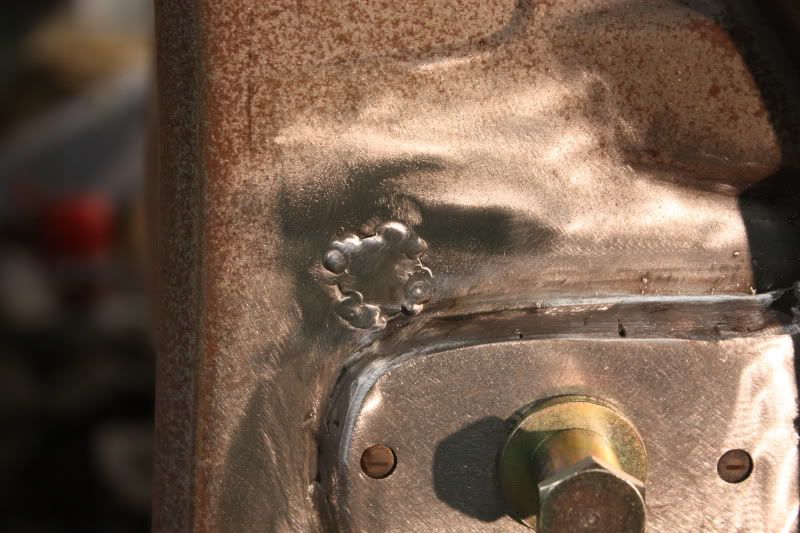

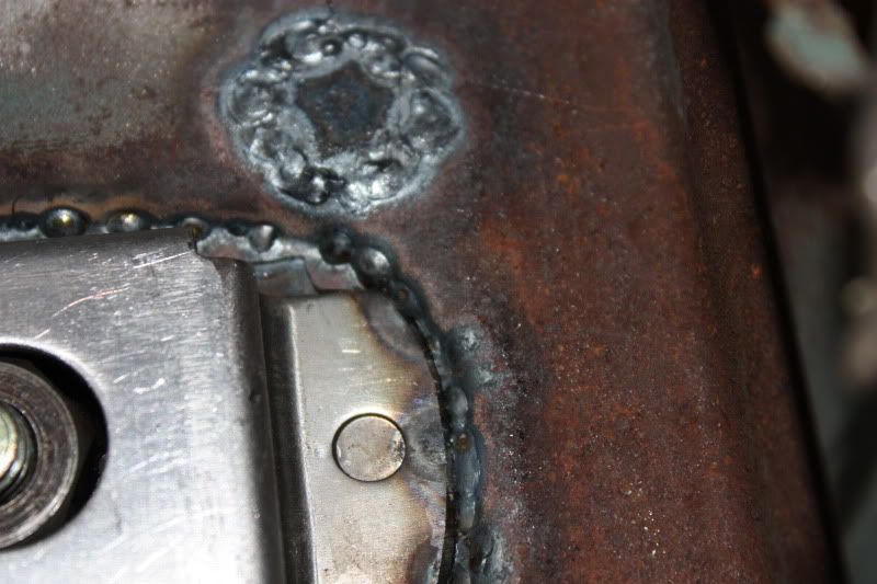

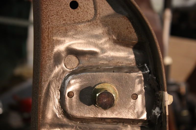

Well, here we go. Just did this tonight. This was all using the TIG machine. Now take this for what it is worth, I have only burned about 6 filler rods with this thing. Oh, sorry for so many pics, I wanted to show every step. I am putting Bear Claw latches in the truck. This is just an example of filling one bolt hole, but illustrates the process ok I think.
http://i140.photobucket.com/albums/r...n/IMG_4882.jpg
http://i140.photobucket.com/albums/r...n/IMG_4884.jpg
http://i140.photobucket.com/albums/r...n/IMG_4885.jpg
http://i140.photobucket.com/albums/r...n/IMG_4886.jpg
http://i140.photobucket.com/albums/r...n/IMG_4888.jpg
http://i140.photobucket.com/albums/r...n/IMG_4889.jpg
http://i140.photobucket.com/albums/r...n/IMG_4890.jpg
http://i140.photobucket.com/albums/r...n/IMG_4891.jpg
http://i140.photobucket.com/albums/r...n/IMG_4896.jpg
This is the back side of that hole inside the door.
http://i140.photobucket.com/albums/r...n/IMG_4895.jpg
So let me have it, what looks right and what looks wrong? I have a lot of welding to do! Thanks for any input.
GregWeld 02-22-2011 07:51 PM
Oh........ I think we have a new member of "TIGS R US".... :woot:
Once you go TIG you find it harder and harder to pick up the squeeze machine.
:D
Remember -- ALL welding... rule #1 if at all possible.... CLEAN CLEAN CLEAN metal... and even cleaner for TIG. MIG lets you get away with murder... TIG will kick your butt on dirty stuff.

Chad, your's looks like a real project! :D I can sure see the benefits of TIG in this situation, thorough penetration and less material deposited on the top side of the work. Doesn't look too bad to my unexperienced eye, only thing I would question based on Greg's (Mr Clean) statements is in the last photo, the backside of the door material could have been sanded clean.......??

ccracin 02-23-2011 04:45 AM
Seig,
Thanks for the comments. Yea, I'm practicing on the project. Gotta make progress!
Greg,
I am definitely growing attached to the TIG. I need to learn how to feed the rod better. Can't get that smooth. Also, I did not realize the back side was so rusty. I couldn't see it. I actually stuck the camera in the door and just pushed the button. Took several shots to actually get the photo I wanted. It is now on our list to blast the inside of the doors as well. Practice, practice, practice!:lateral:

The WidowMaker 02-28-2011 07:53 PM
Penetration appears a little lite in areas, but close?
Or........should I take two weeks off then buy a Thermal Arc 185 or Miller 180? Reality is I need a RS600 more than a TIG right now.
still too much build up on top, tacks spaced too far apart and not enough penetration. the little craters in each of the welds should dissapear when you do your next tack. hell, i dont know if i do it correctly or not, but probably 40% of my previous tack will go molten when i do my next tack. too much build up on top makes it like trying to weld sheetmetal to 1/8" plate.
i would turn the heat up a little and hold the trigger for less time. that, or turn the wire speed down a little so you can hold it for a little longer without getting too much build up.
how long are you holding the trigger for? im a "pull-1-2-off" kind of guy. sometimes its forrest gump counting and other times its an auctioneer, but i find a rythm and go from there.
Sieg 02-28-2011 08:55 PM
Thanks for the constructive feedback, I agree with all the points mentioned. Being a total newb to it and having limited experimentation time makes the learner curve longer. I typically learn best by hands-on experience but also rely on written input. I'd guess due to fear of burn through and build up I'm not holding it long enough.
Yesterday I fab a clamp device for notching tubing and practice welding tubing and found during my tubing welding experiments that I may be holding the tip off too far as when it was close (IMO) the bead laid down more. Being able to see the bead well enough to relax appears to be a major challenge for me. The size of that damn nozzle doesn't help matter either. :D The Harbor Freight helmet appears to be a little dark even on the lightest setting IMO. An Optrel may be in my future since at 52 my vision is digressing thus compounding the factors.
I'm only on my 2nd bottle of gas in 6 years so more time on the gun definitely an issue though I have made a noticeable dent on the bottle in the last week.
I'll work on experimenting more with finding the extremes, that should help and my self imposed learning barriers will fall.
Thanks for the input, I really appreciate your help and support. :thumbsup:
