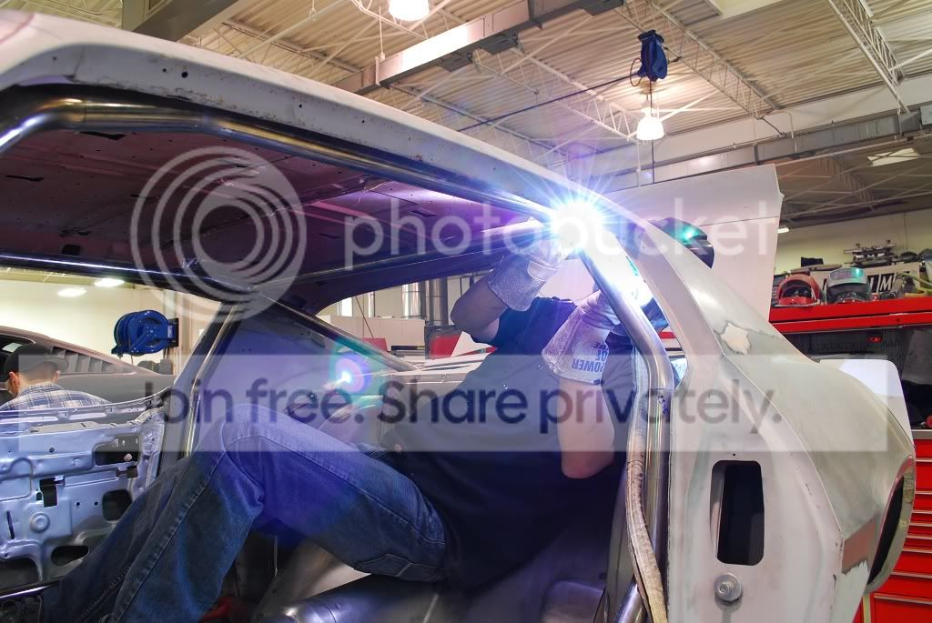

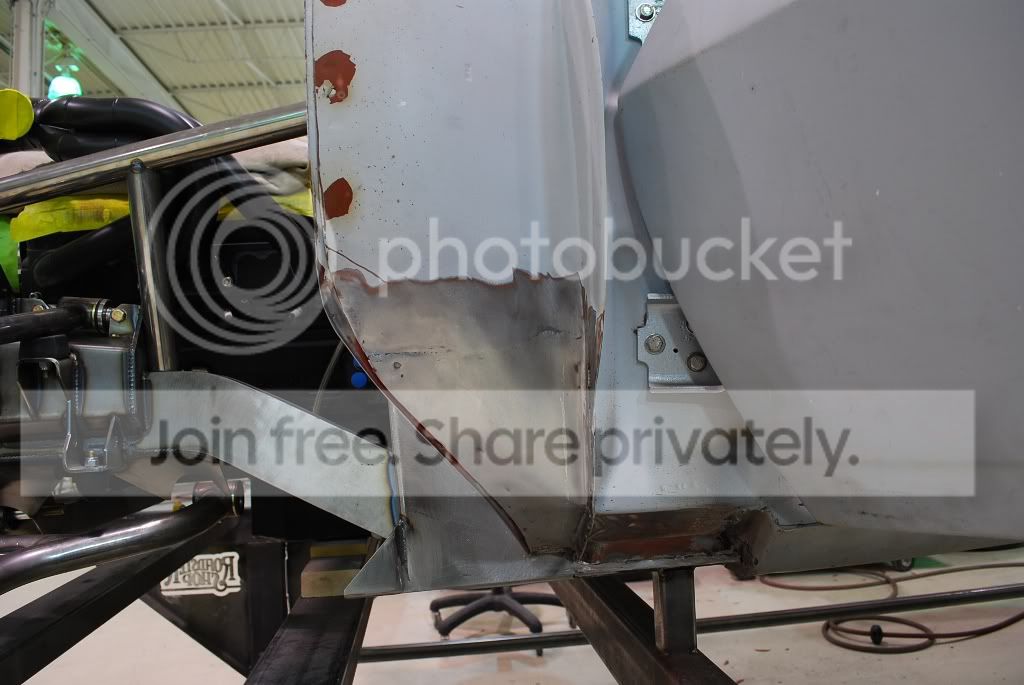

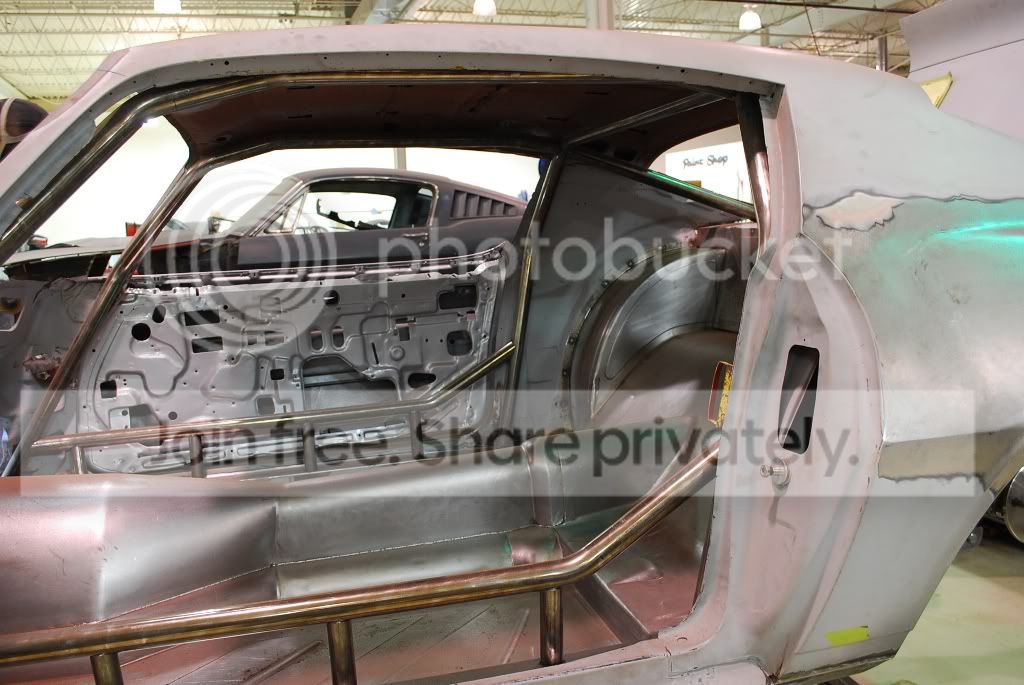

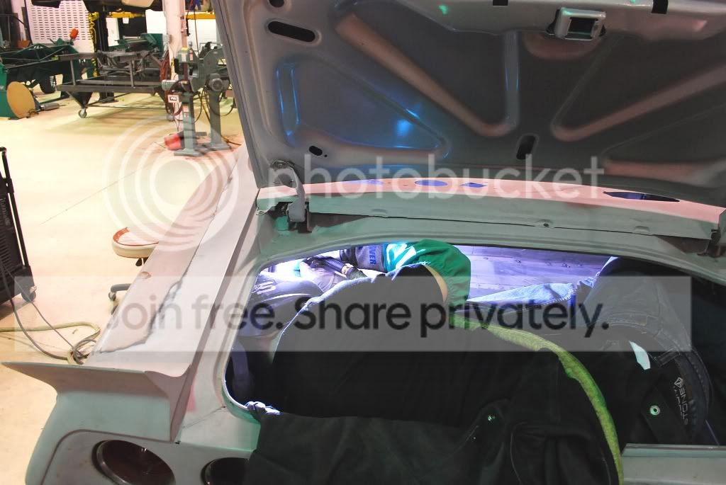

The roll cage is just about wrapped up on the car. A few areas need final welding and it should be completed. A few people asked how we weld the bars when they are that tight to the body, so I shot a few pics as Dave was working on it today. He has become a bit of a contortionist.
http://i563.photobucket.com/albums/s...ture220429.jpg
Not bad getting a guy that is 6'2" in the trunk of a 2nd gen and still being able to work the pedal on the TIG!
http://i563.photobucket.com/albums/s...ture220457.jpg
Roadster Shop 12-21-2011 05:52 PM

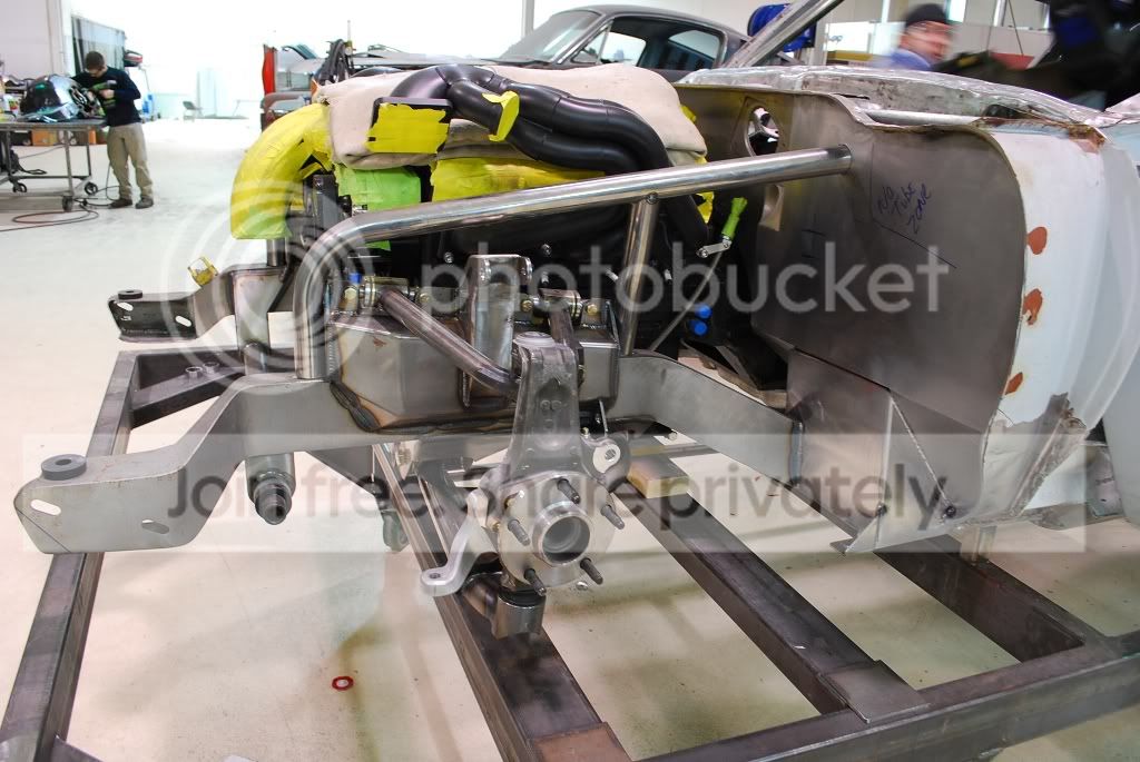

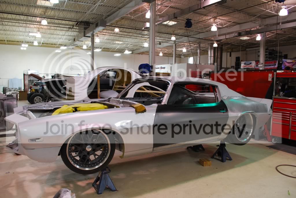

Here are a few other shots of the cage further along.
http://i563.photobucket.com/albums/s...ture220464.jpg
http://i563.photobucket.com/albums/s...ture220411.jpg
http://i563.photobucket.com/albums/s...ure2204231.jpg

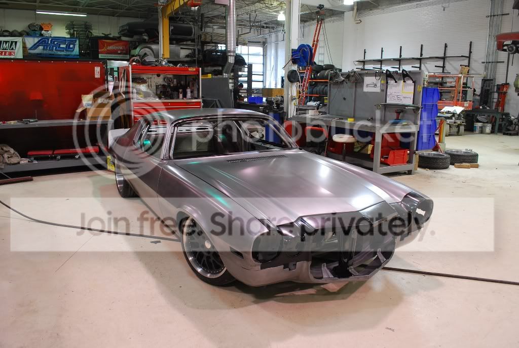

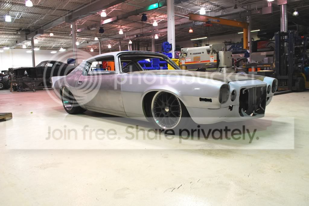

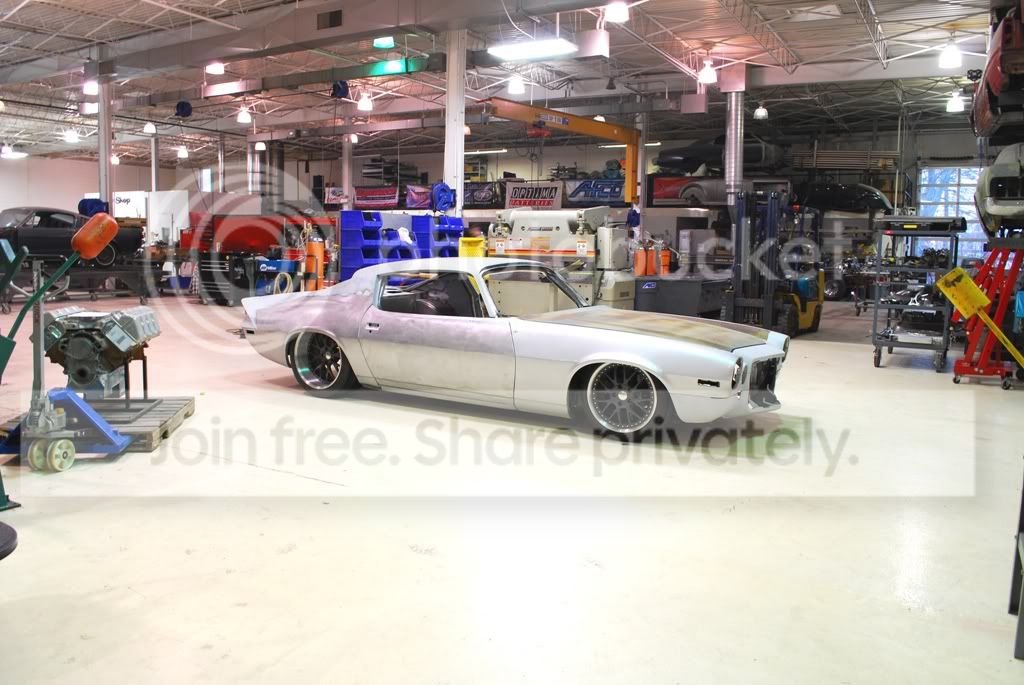

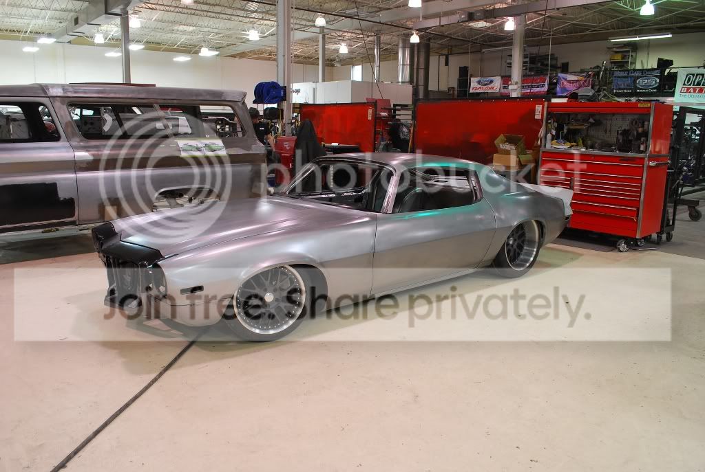

Roadster Shop 12-23-2011 02:30 PM

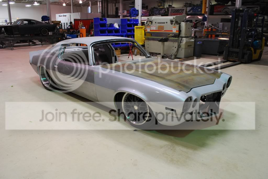

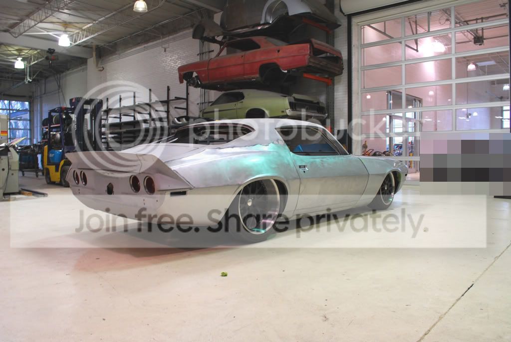

We just got the car off the chassis table and on the ground at ride height for the first time on its suspension with the correct sized wheels and tires. It just looks mean!
http://i563.photobucket.com/albums/s...ture220517.jpg
http://i563.photobucket.com/albums/s...re220528-1.jpg
http://i563.photobucket.com/albums/s...ture220509.jpg
http://i563.photobucket.com/albums/s...ture220506.jpg
http://i563.photobucket.com/albums/s...ture220504.jpg
http://i563.photobucket.com/albums/s...ture220530.jpg
skatinjay27 12-23-2011 02:54 PM
That looks like pure trouble!! Soo sick!
You taking notes rodger? Thats the angle us regular guys are used too! Lol
strtcar 12-23-2011 02:55 PM
Looks great love the flat hood.
ironworks 12-23-2011 02:57 PM
Looks awesome. Are you going to paint it orange?
brownz 12-23-2011 03:31 PM
Looks sick!!! That wall of cars kills me every time :thumbsup:
56pickup 12-23-2011 03:37 PM
Looks super bitchin guys! :thumbsup: Wheels and ride height look awesome!

Roadster Shop 12-25-2011 08:57 PM
Thanks everyone. The stance on this car is just pure bad ass. It is basically the same ride height as the Innovator and the C1RS, sitting right about 4" at the front of the rocker. With the low roof line this car looks much lower though.
Originally Posted by coolwelder62 (Post 386184)
The stance is spot on!!.But the frt. tire's need to be wider.
It has a 275 on a 10" rim now for mock up (Our standard mock up rims laying around the shop). The back spacing on the fronts is way off and they need to come out quite a bit. The rears can come out slightly. We are looking at a 305 or 315 for the front. This is the first time the car has been at ride height with wheels on it so we still have to measure out what will fit and work the best.

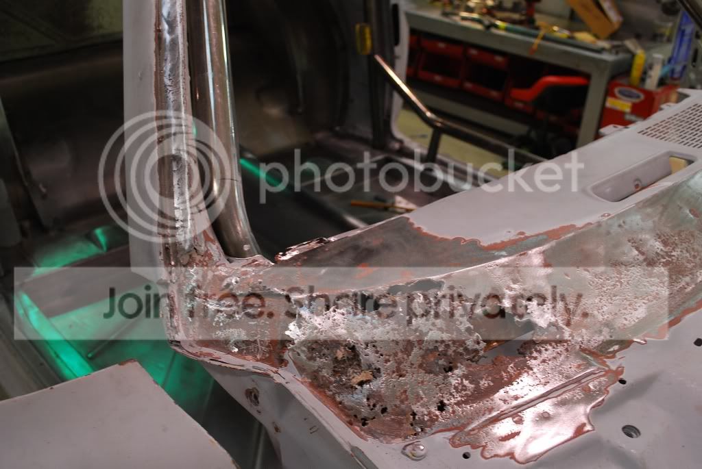

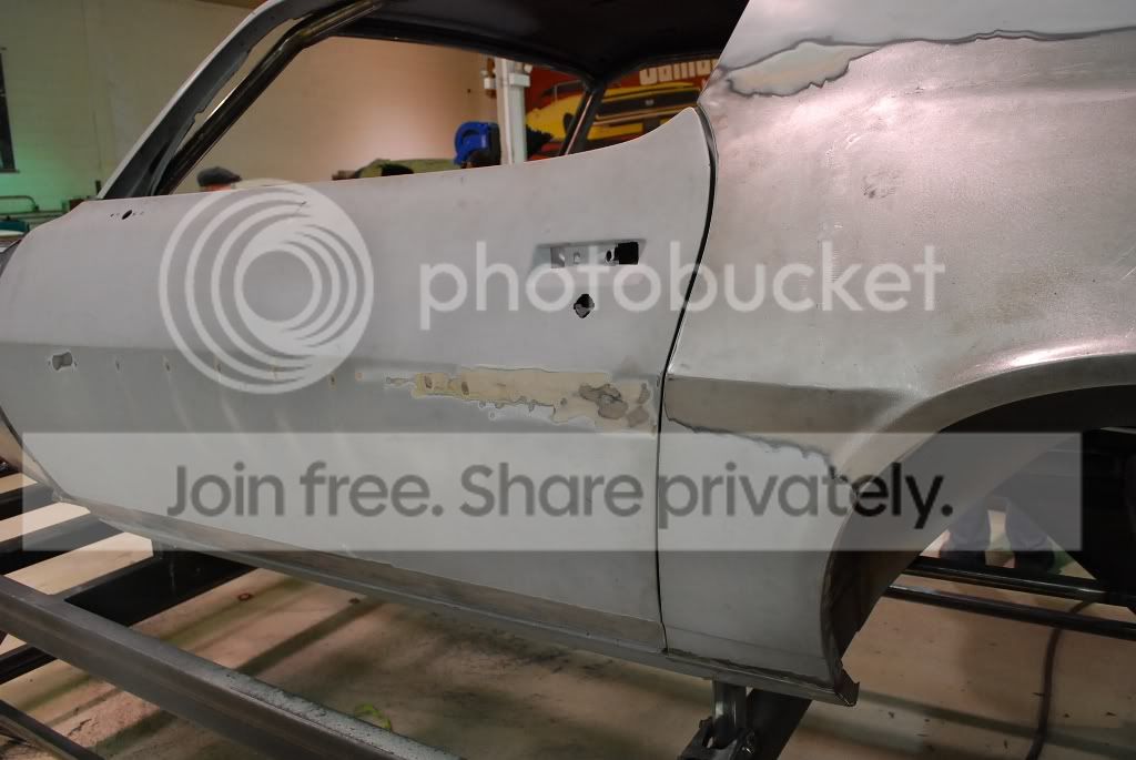

A little more progress on this build. unfortunately it isn't the cool, exciting stuff. This was supposed to be a solid, original car that was just primed before the owner purchased it. Well, it was solid if you consider gallons of bondo and fiberglass "solid". So, the last week has been spent on fixing poorly repaired rust.
While finishing the cage, we noticed some fiberglass in the bottom of the windshield area. That was ground out to find this.
http://i563.photobucket.com/albums/s...ture220388.jpg

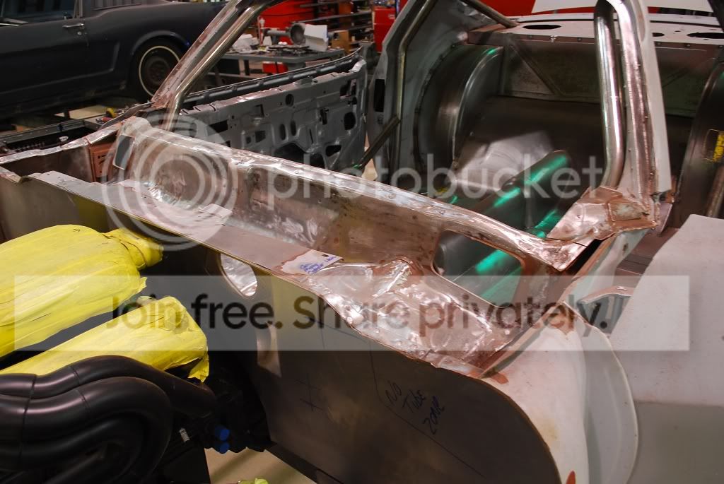

The entire top of the cowl and dash was removed and has since been blasted.
http://i563.photobucket.com/albums/s...ture220414.jpg
There were a few areas in the bottom of the cowl sides that needed more attention as well.
http://i563.photobucket.com/albums/s...ture220428.jpg
When we started lining up the doors, we found that the driver door was packed with mud.
http://i563.photobucket.com/albums/s...ture220453.jpg
That door wasn't salvageable so we re-skinned it. the passenger door wasn't as bad and we were able to metal finish it out.
http://i563.photobucket.com/albums/s...ture220549.jpg
There were a few other small spots around the car that needed attention. We would normally blast the car down to bare metal before beginning any work, but were told that the car was in perfect condition, and just primed to prevent rust. We took the guys word and never really looked into anything too closely to inspect it until now, and found a few surprises.
70rs 12-29-2011 09:21 AM
That sucks. I'm glad you found it all. This level of build really should not include gallons of bondo.

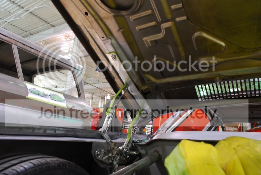

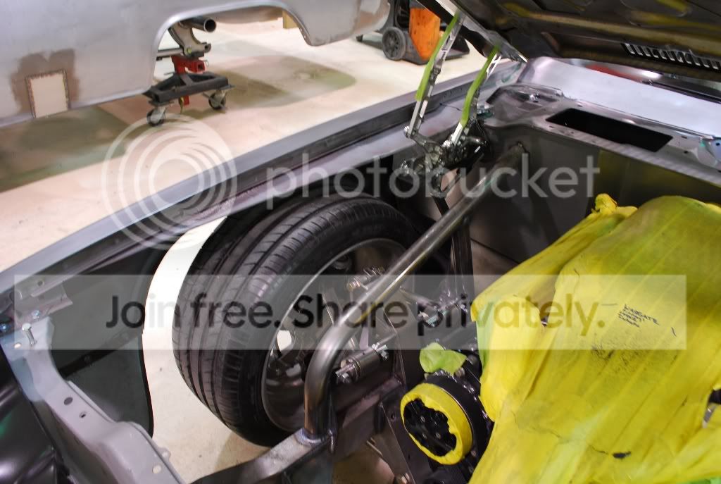

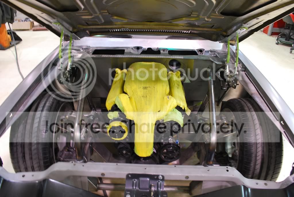

We were waiting for a few more sheet metal pieces to come back from the media blaster and acid dipper. Now that the fenders and hood are back, we were able to final assemble the front end.
With the low ride height the tires ended up coming really close to the hood hinges and inside portion of the fender. So, that area was removed and the hood hinges were moved back to gain the necessary room. The Ring Brothers were nice enough to send down a set of hinges for us to mock up the hood with to make sure that everything still functioned properly when relocated.
http://i563.photobucket.com/albums/s...ure2214021.jpg
Fabbing new inner fenders is the next step.
http://i563.photobucket.com/albums/s...ure2213991.jpg
http://i563.photobucket.com/albums/s...ture221401.jpg
Roadster Shop 02-02-2012 08:56 AM
http://i563.photobucket.com/albums/s...ture221402.jpg
http://i563.photobucket.com/albums/s...ture221399.jpg
