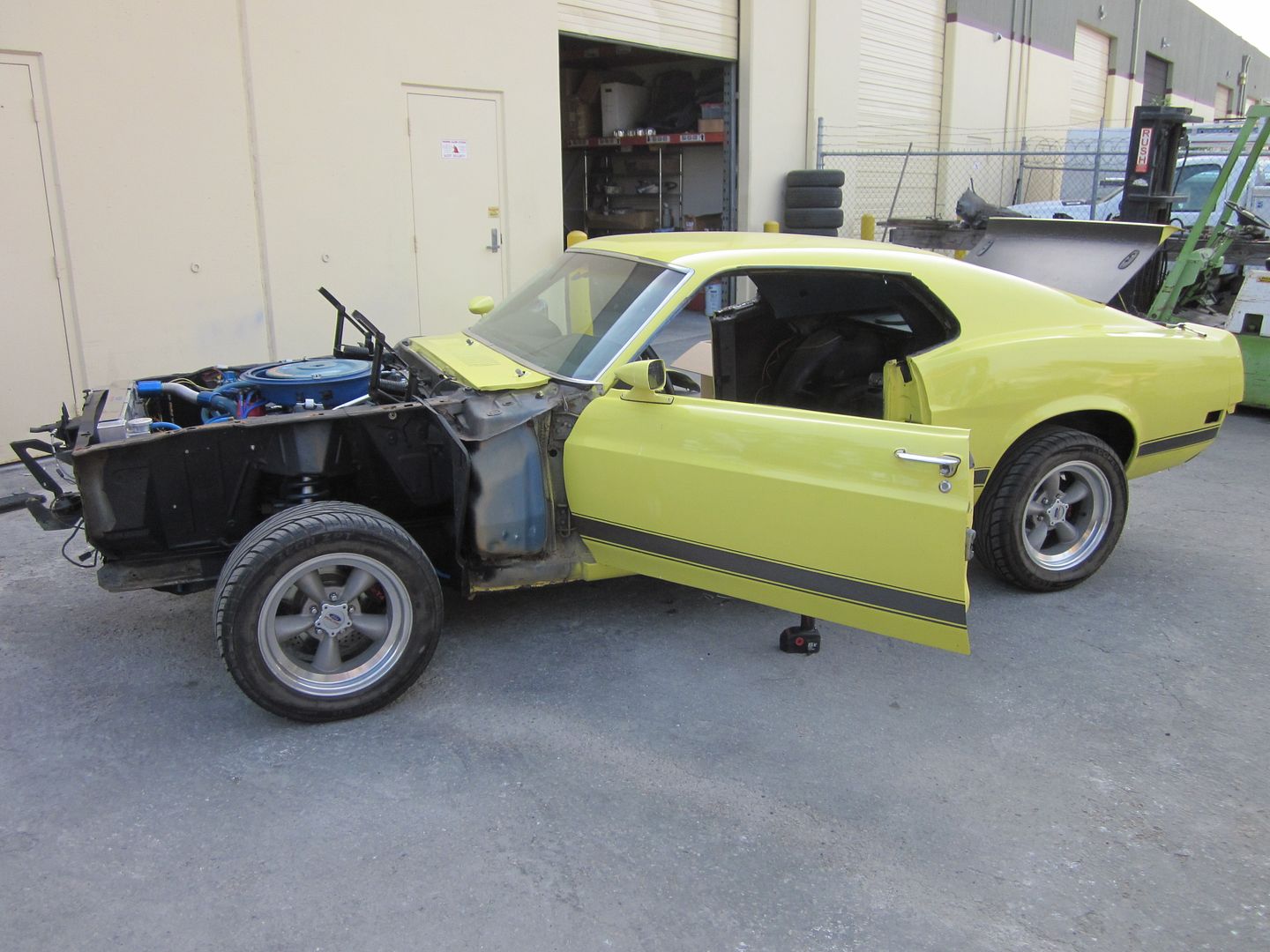

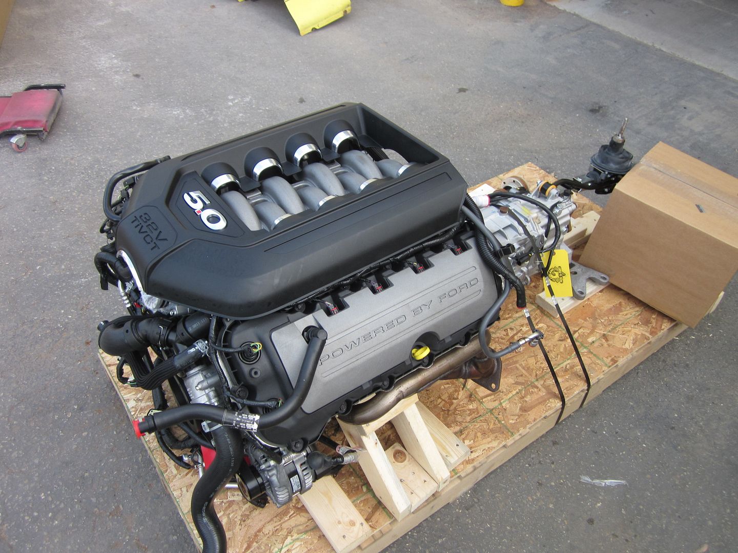

The transmission you see is the one that is currently used on the 2011 5.0 Mustangs.. 6 speed Getrag..
Just curious, are you keeping the Getrag? I don't know if you've taken measurements, but I was curious as to how far back the shifter would end up.
Matt
Cris@JCG 06-06-2011 08:14 PM
We are keeping the Getrag Matt.. The shifter is pretty far back & sits high..
But like that about the shifter position.. & can be modified pretty easy.. The assy track system will be a nightmare though.. The 5.0 motor is huge & have to fit it between some pretty narrow frame rails.. but we already have a plan on how to make it work.. I think!

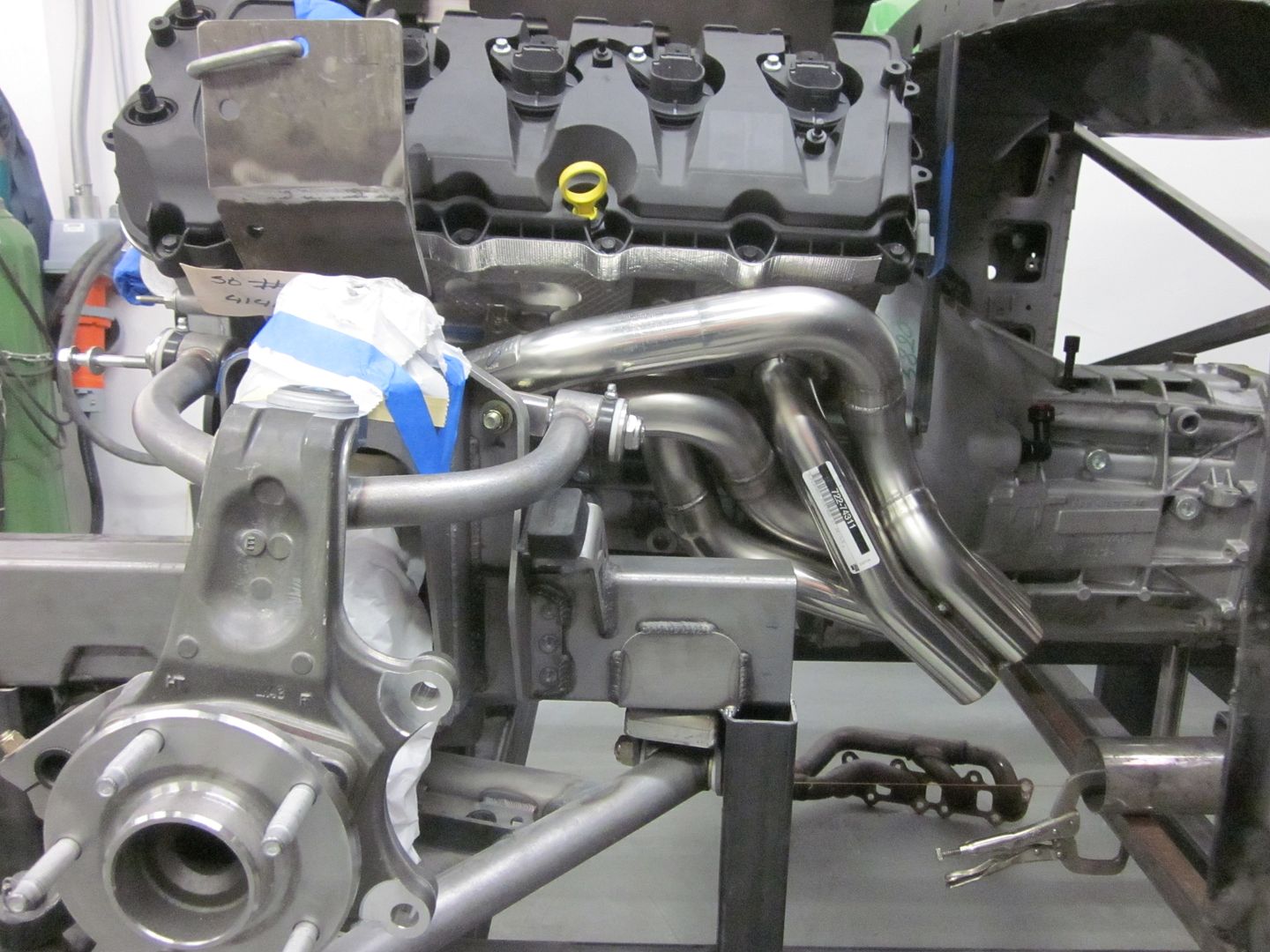

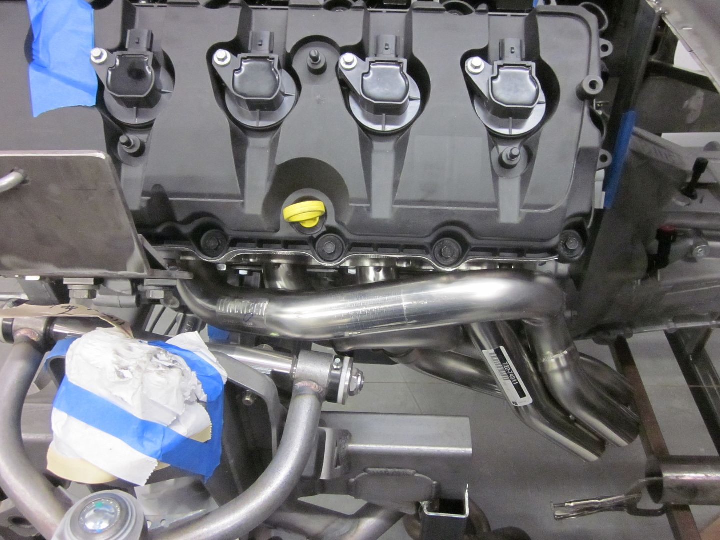

Got our Dynatech headers today.. Got the driver side in today.. the pass side will not be that easy.. Cut up up a brand new set of headers!
http://i1015.photobucket.com/albums/...n/IMG_1239.jpg
http://i1015.photobucket.com/albums/...n/IMG_1240.jpg

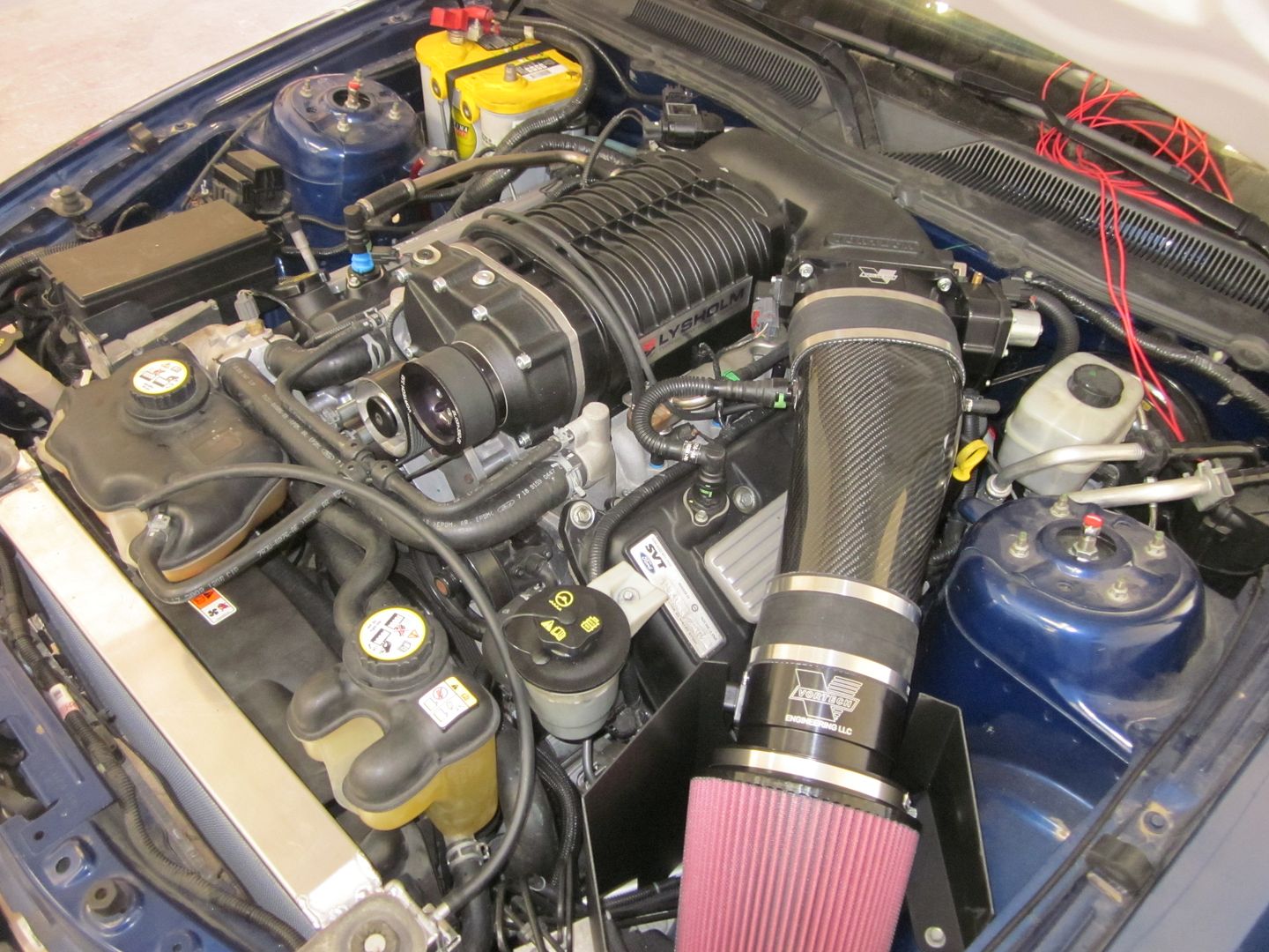

Here is a supercharged 5.4 we have been messing around with this week.. Thanks for the info Matt!

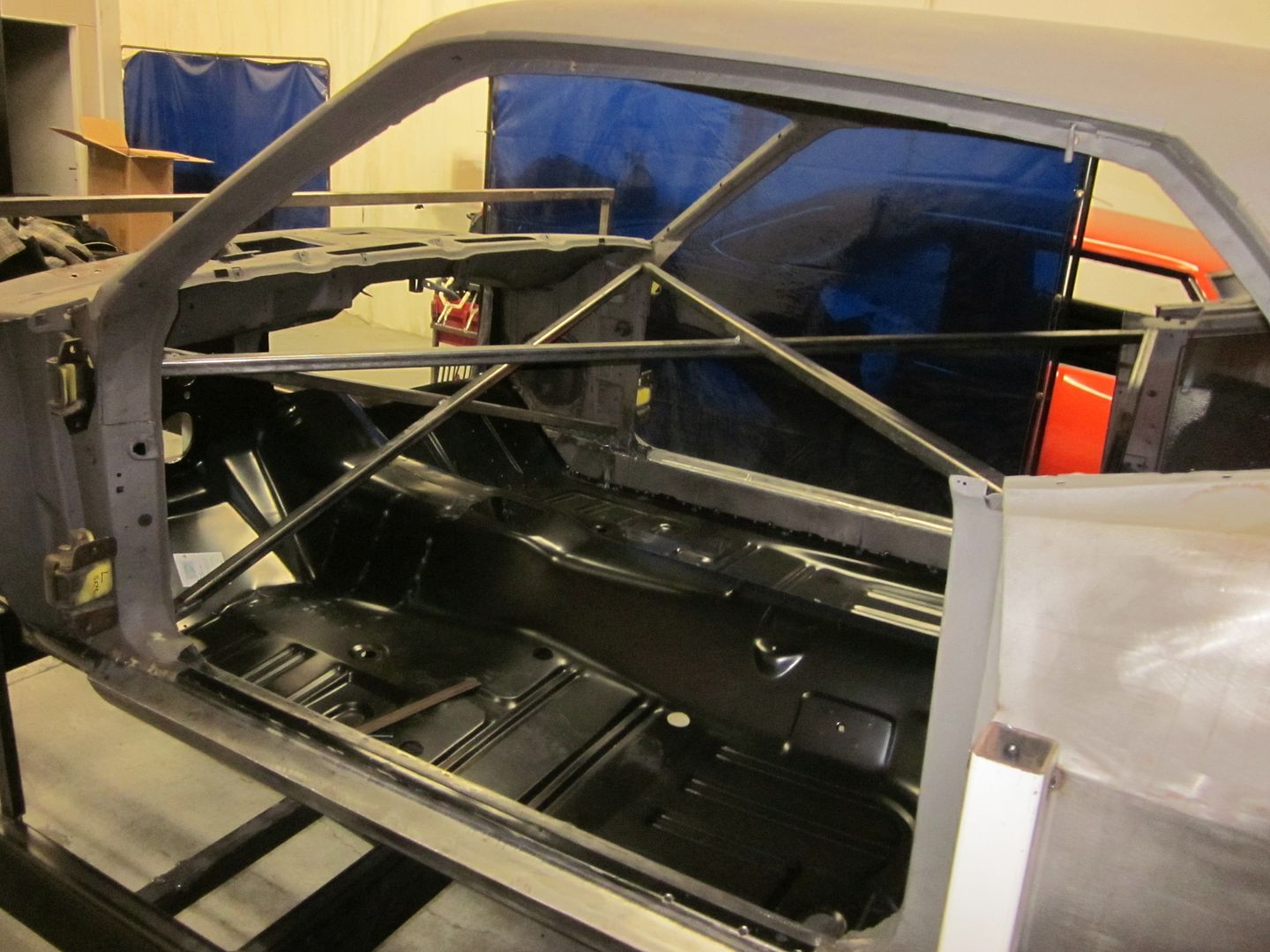

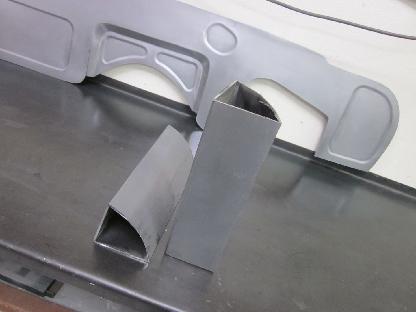

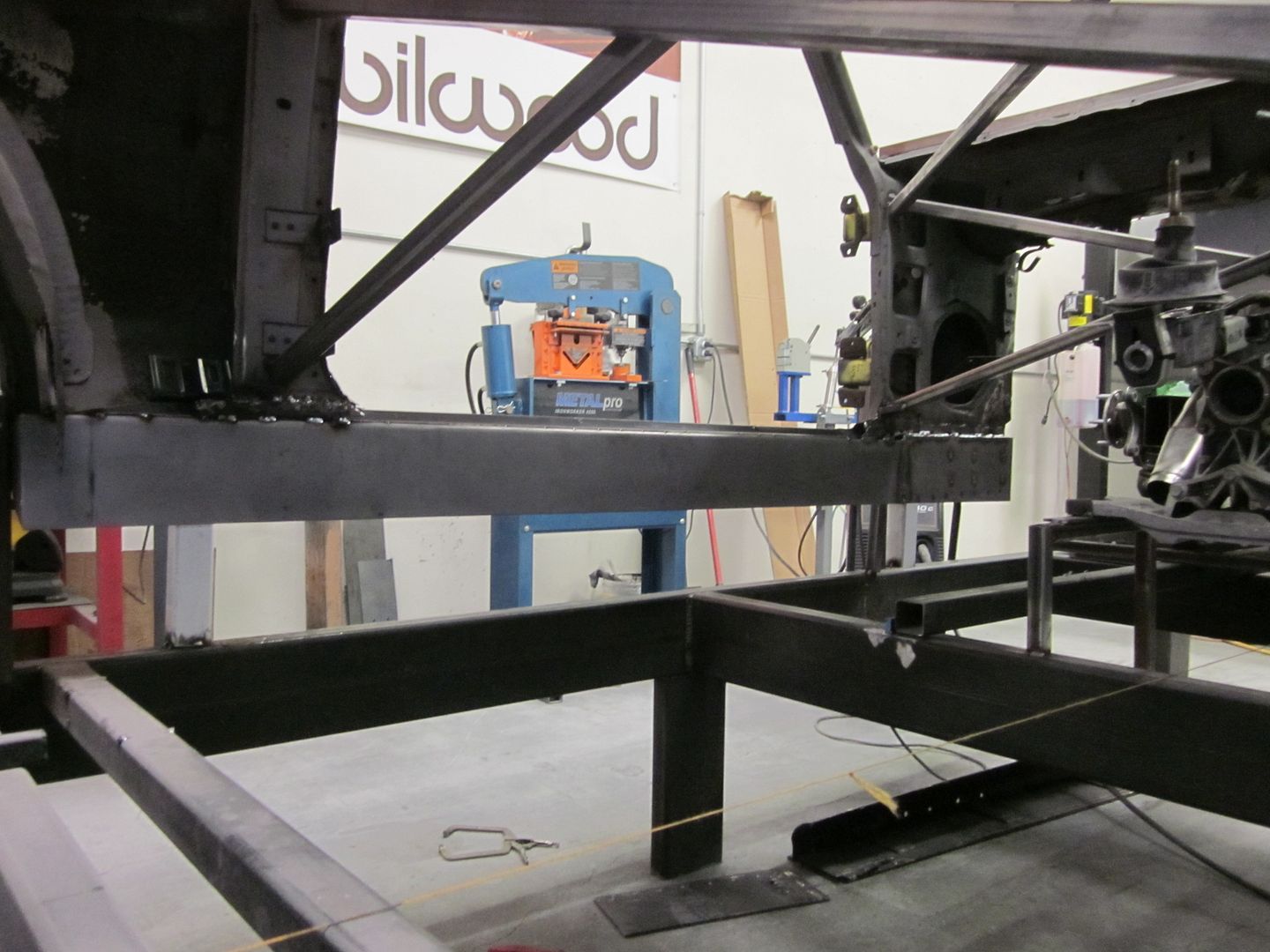

Update! Now that the Camaro is pretty close to finishing.. We have been working on the Mustang... We cut out the factory rocker panels & built a custom set by bending, rolling & welding a set out of .120 1018 plate..
Working on getting them fit & welded so we can start the firewall fabrication ..
http://i1015.photobucket.com/albums/...n/IMG_1794.jpg
http://i1015.photobucket.com/albums/...n/IMG_1795.jpg
http://i1015.photobucket.com/albums/...n/IMG_1797.jpg
http://i1015.photobucket.com/albums/...n/IMG_1798.jpg

Rockers out of .120 plate ? That seems a little overkill !
Cris@JCG 11-28-2011 03:56 PM
Not too me when it is the main chassis structure of the car! When I start building the floors & firewall it will make more sense on why we built our rocker panels the way we did..

syborg tt 11-28-2011 07:50 PM
A lot of builders do this to stiffen up the car. Some even build all the way up the "A" & "B" Pillar.
The Marlboro Syclone that I owned "A" & "B" Pillar were done this way for the Targa Top conversion. Also the Windsheild post was filled with Liquid Steel or something similar.

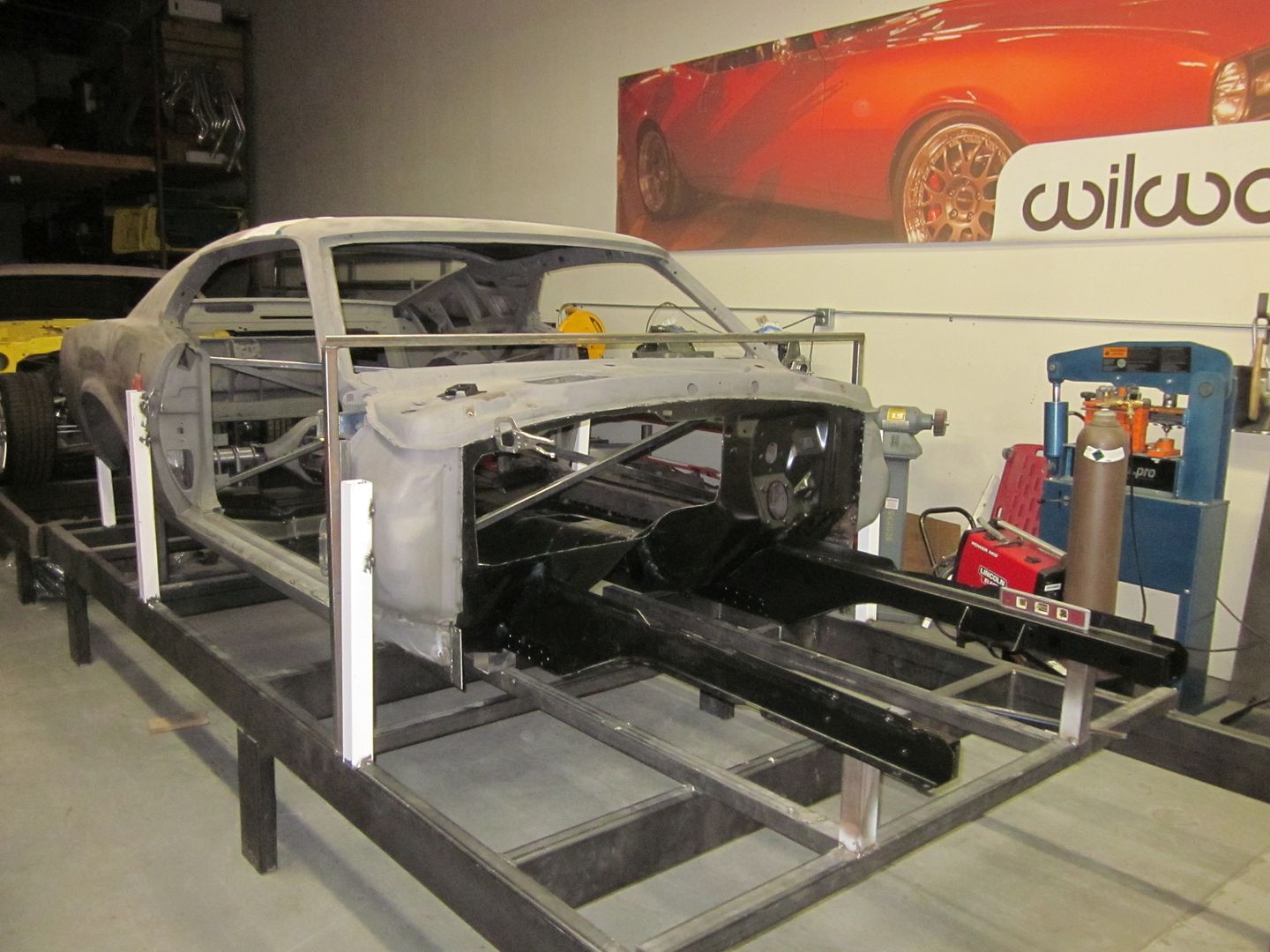

With all the changes going on this Mustang.. I feel like we got something done this week on her! We got most of the main floor structure back in place with Firewall.. though we cut a part of it out.. Got the doors back on the car with the front Anvil 1.5 stretched fenders.. Got the LS with T56 staged between the frame rails.. got plenty of room now.. Looks like the 1st gen Camaro LS headers from Dynatech will work.. We moved the motor as far back as we could.. Some progress :_paranoid
http://i1015.photobucket.com/albums/...n/IMG_1824.jpg
http://i1015.photobucket.com/albums/...n/IMG_1825.jpg
http://i1015.photobucket.com/albums/...n/IMG_1826.jpg
http://i1015.photobucket.com/albums/...n/IMG_1827.jpg

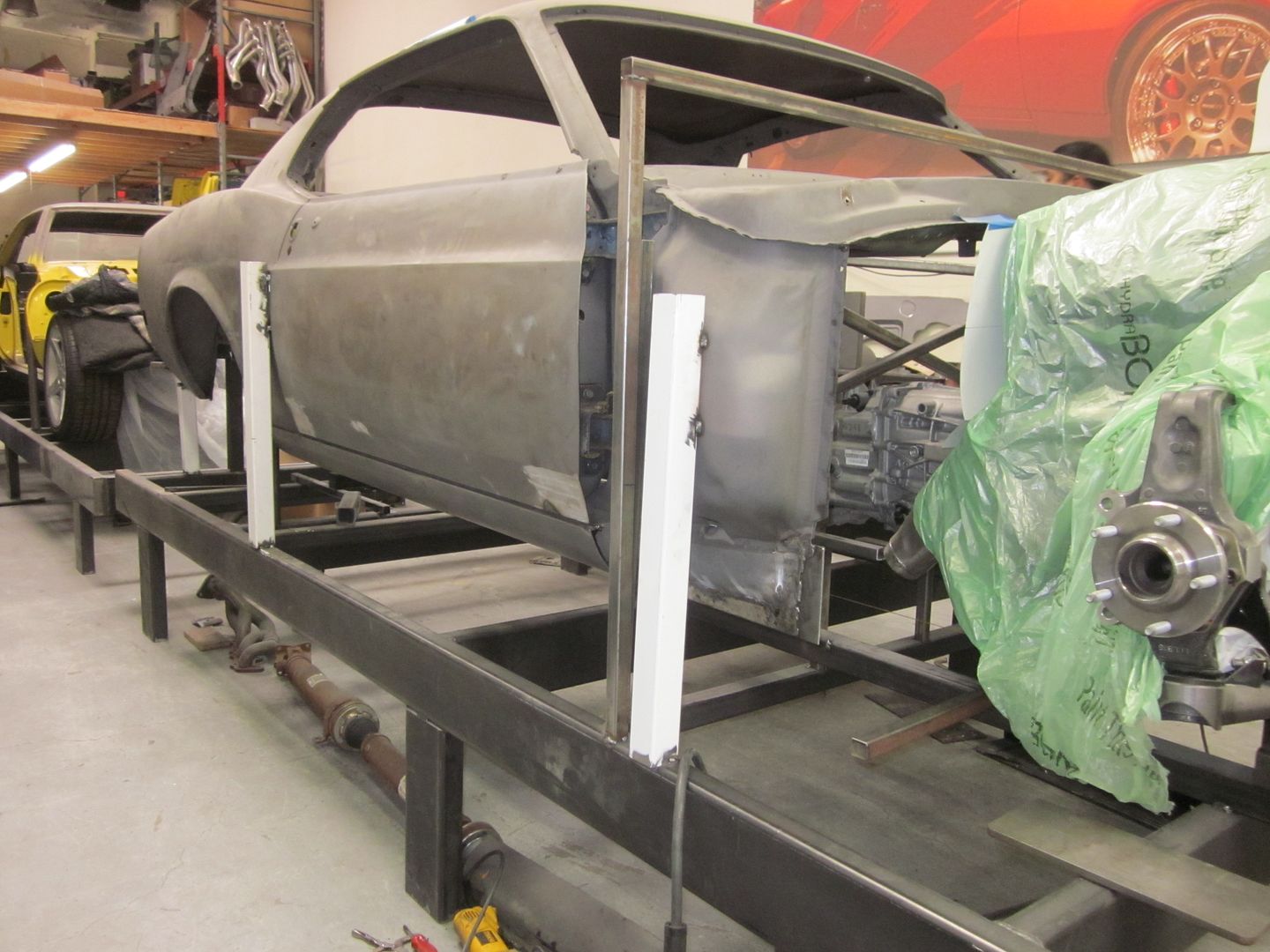

Here are some updates on the Mustang... We got the transmission support going & some firewall work going .. The owner said to keep it simple.. doing my best to keep the project moving forward & trying not to get carried away with crazy fab work & one off machined pcs.. :D
I will post pics later of the firewall with the Wilwood pedal assembly..

Thanks Bryce! This is where we finished off today.. Their is a 1.5 x 1.5 x .120 square tubing built into the frame of the firewall that ties into the new rockers we built & the torque boxes.. I got some cool ideas for the down bars.. got to get some parts machined for that..
