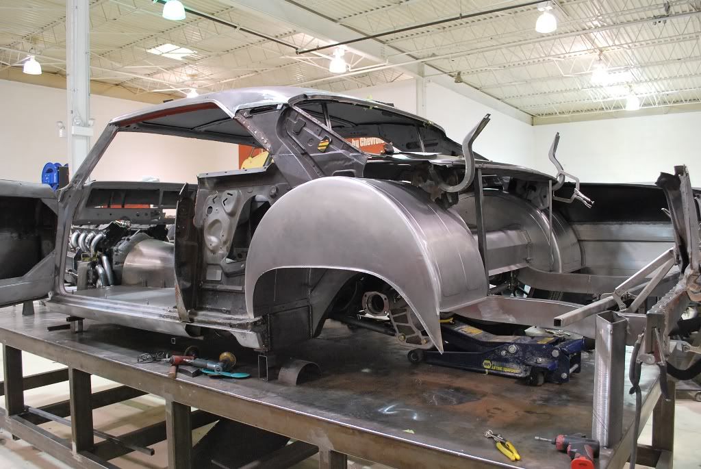

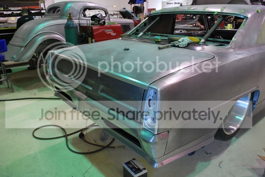

Roadster Shop 06-28-2011 06:45 PM

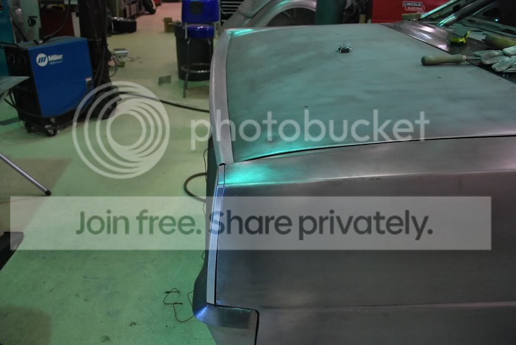

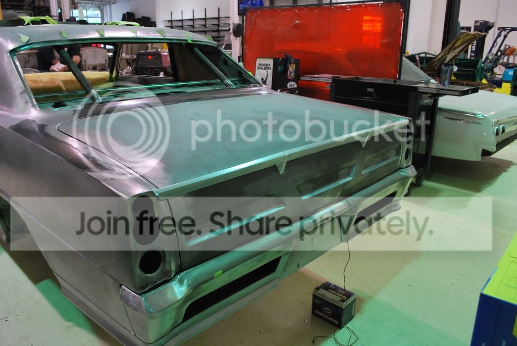

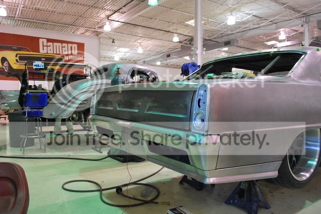

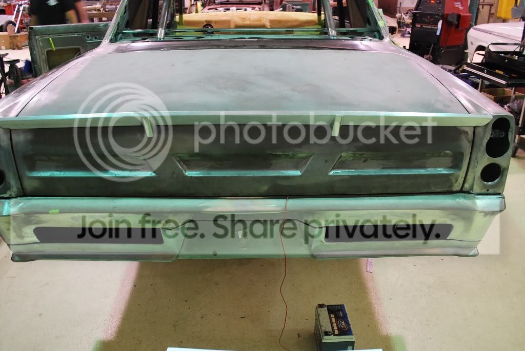

Here is a little more work on the rear of the car. Fabbed a rear lip spoiler and wrapped the lower quarter extensions into the bottom of the bumper. Also a preview of the custom billet tail lights.
http://i563.photobucket.com/albums/s...ovator/107.jpg
http://i563.photobucket.com/albums/s...ovator/106.jpg
http://i563.photobucket.com/albums/s...ovator/108.jpg
Added small accent mounts to the back side of the rear spoiler
http://i563.photobucket.com/albums/s...ovator/105.jpg
http://i563.photobucket.com/albums/s...ovator/109.jpg

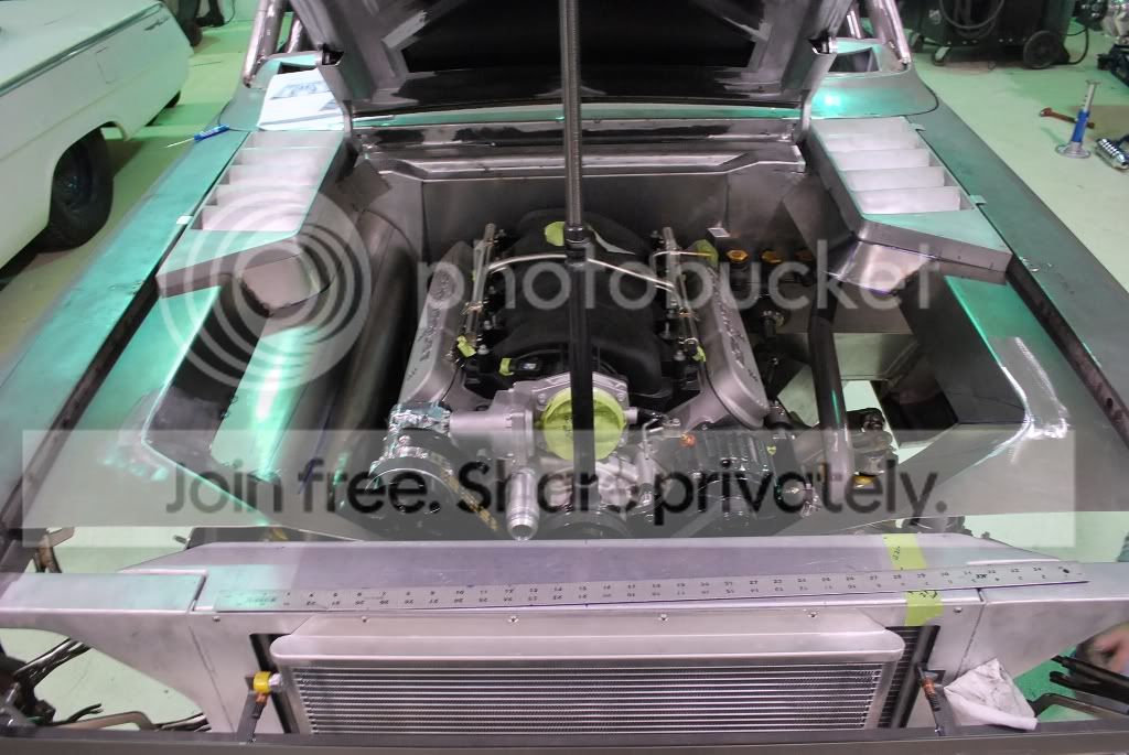

Roadster Shop 06-29-2011 12:42 PM

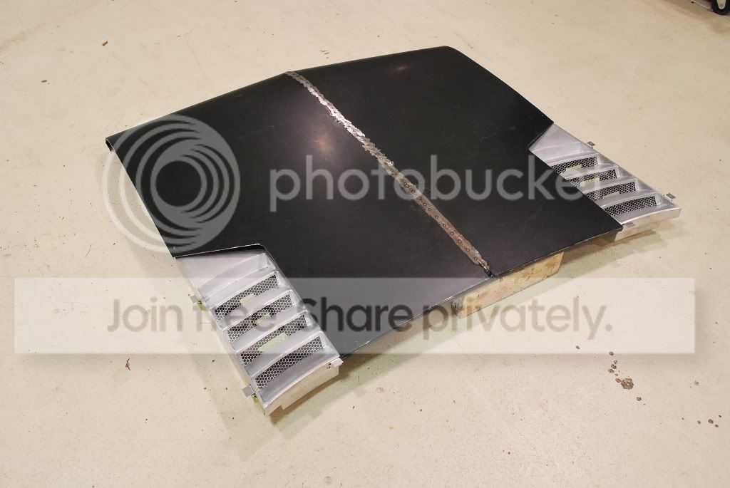

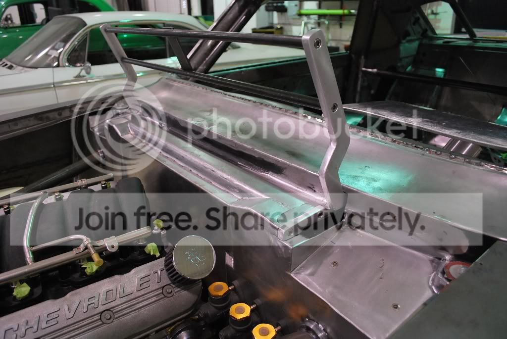

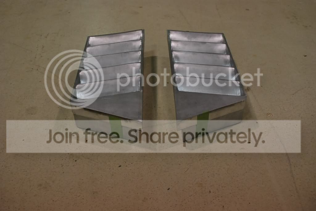

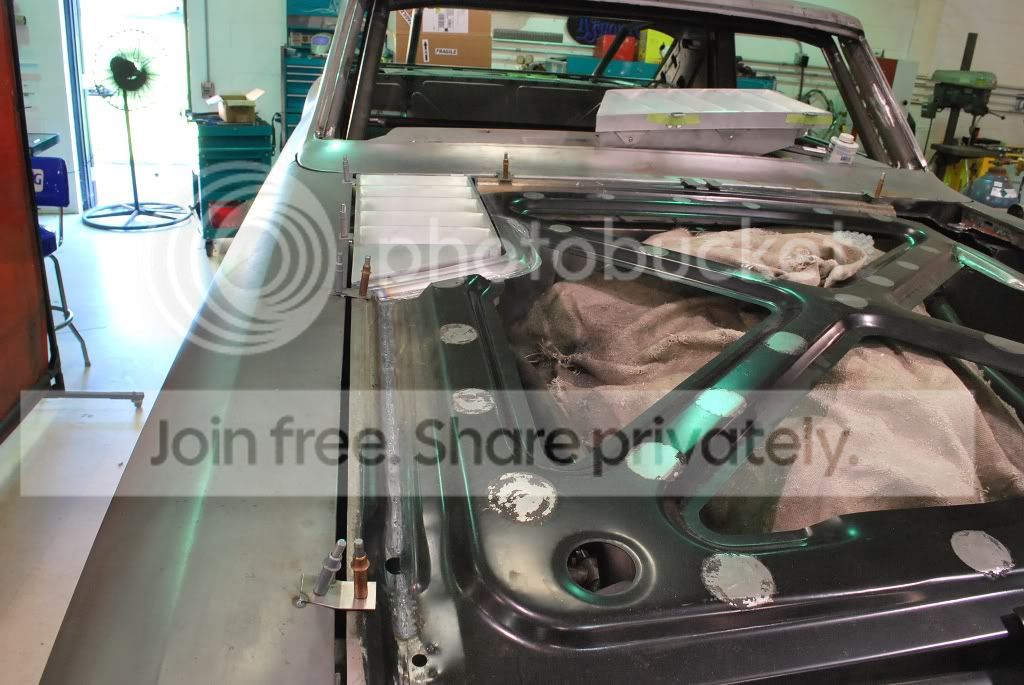

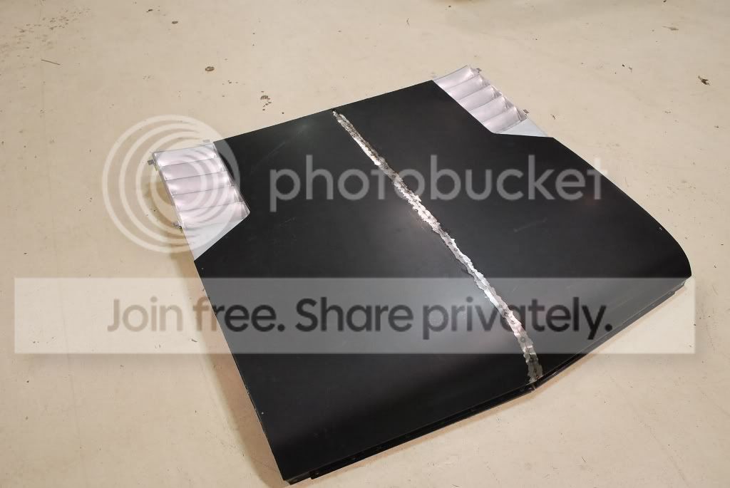

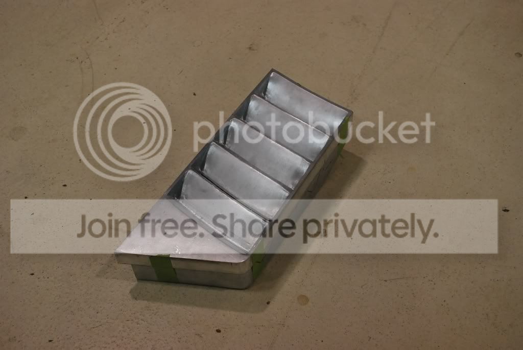

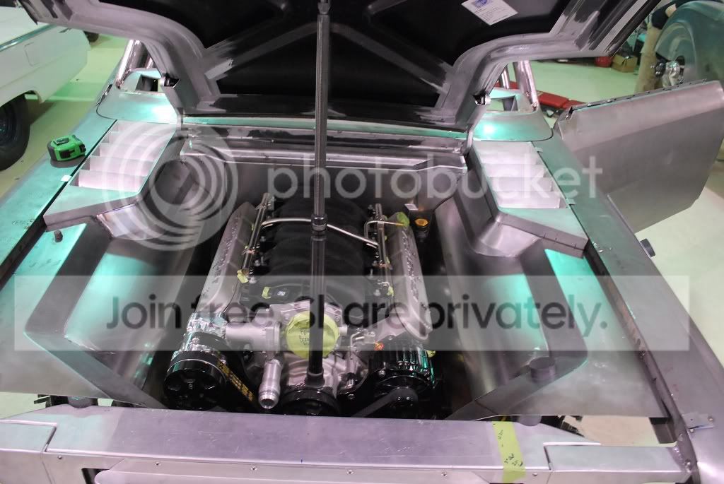

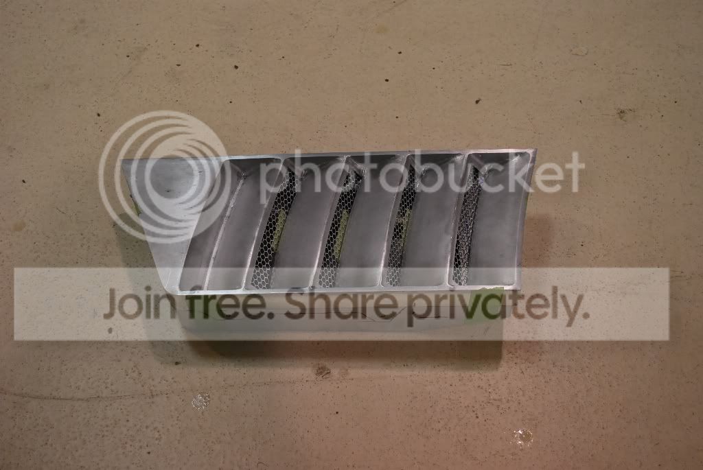

Fab work on the hood:
We really liked the way the flat hood looks on these cars and wanted to keep that feel, but add some detail to it.
We again removed the body line from the center of the hood to give it a cleaner look than stock. We fabbed 2 air boxes that fit in the corner of the hood and remain flat when the hood is opened.
http://i563.photobucket.com/albums/s...ovator/121.jpg
http://i563.photobucket.com/albums/s...ovator/117.jpg
http://i563.photobucket.com/albums/s...ovator/114.jpg
http://i563.photobucket.com/albums/s...ovator/115.jpg
http://i563.photobucket.com/albums/s...ovator/116.jpg

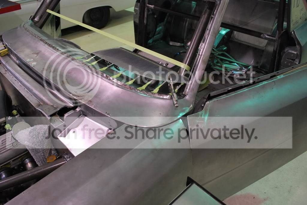

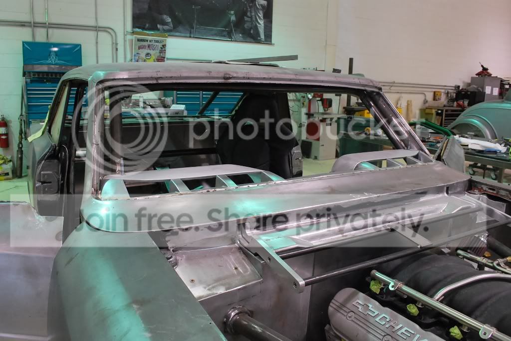

Roadster Shop 06-29-2011 12:44 PM
Since the air boxes are staying stationary, we needed to then fab new hood hinges since the air boxes were int he stock hood hinge location.
http://i563.photobucket.com/albums/s...ovator/110.jpg
http://i563.photobucket.com/albums/s...ovator/111.jpg
http://i563.photobucket.com/albums/s...ovator/112.jpg
http://i563.photobucket.com/albums/s...ovator/113.jpg

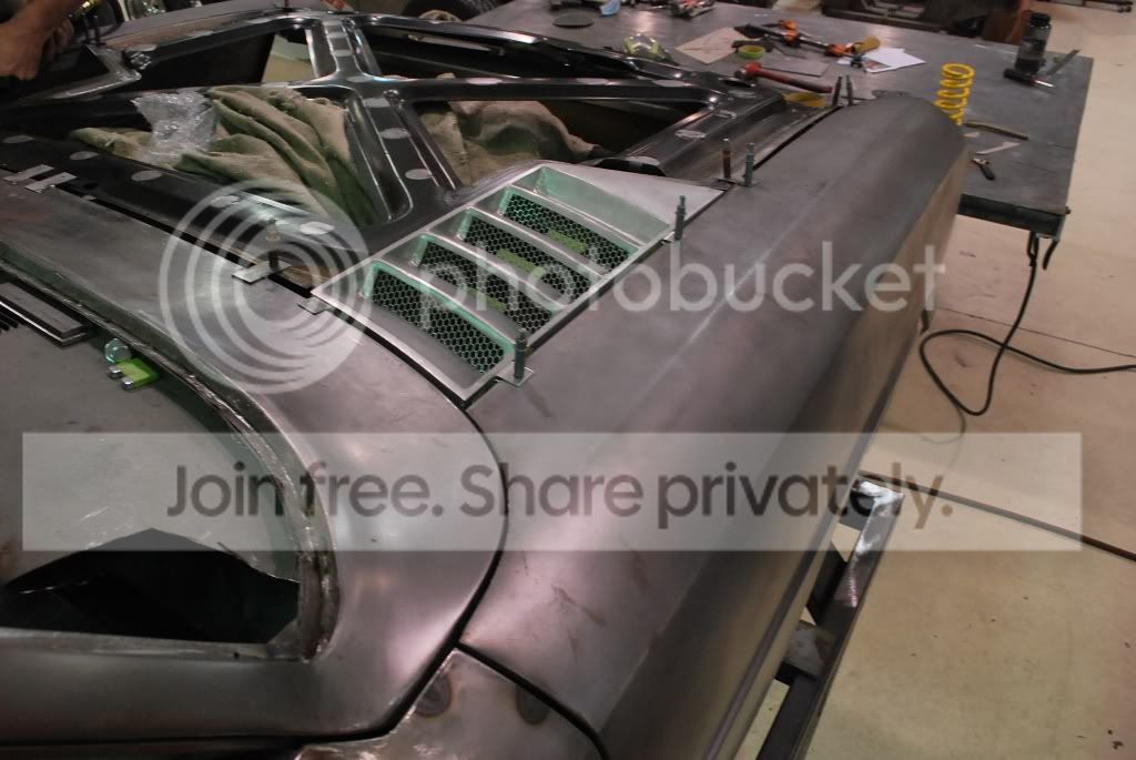

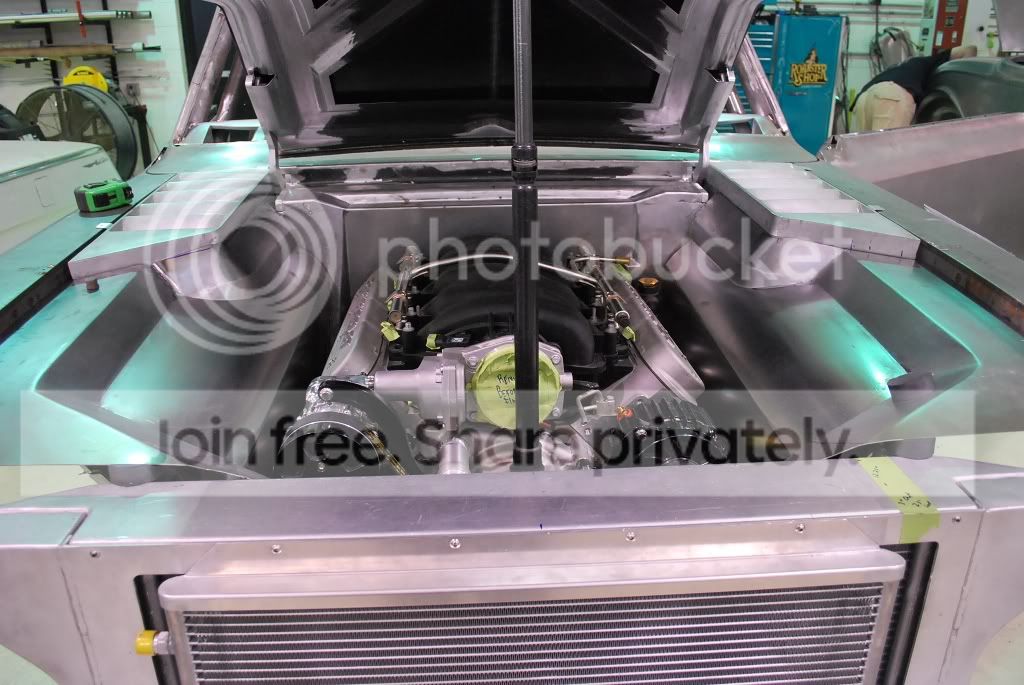

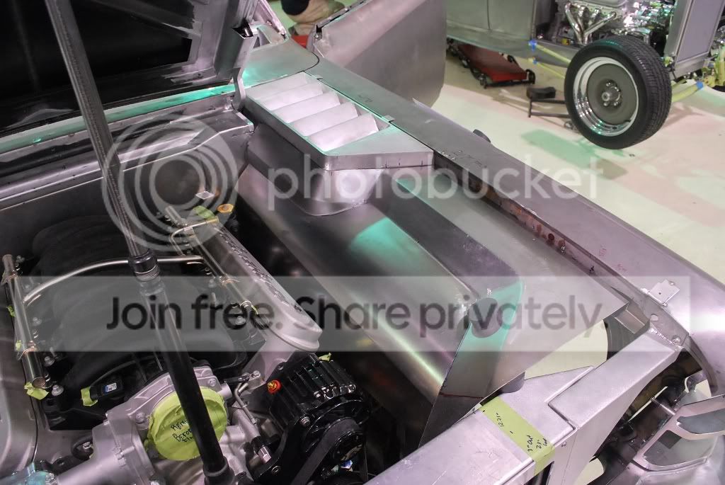

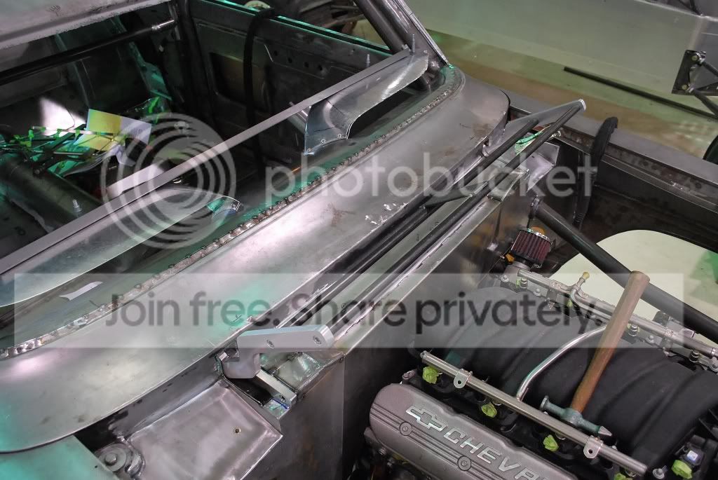

Roadster Shop 06-29-2011 12:46 PM
A few shots of the air boxes in place
http://i563.photobucket.com/albums/s...ovator/118.jpg
http://i563.photobucket.com/albums/s...ovator/120.jpg
Re-design on the hood inner structure to add more strength and work with the new configuration.
http://i563.photobucket.com/albums/s...ovator/119.jpg

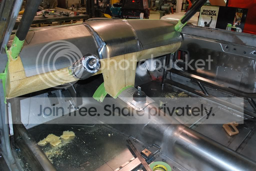

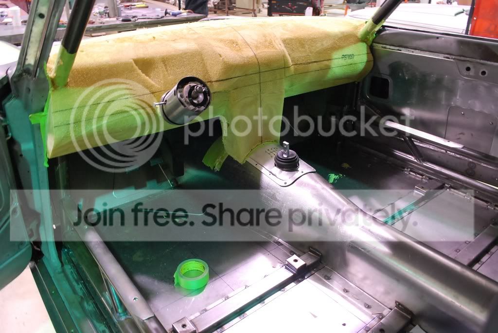

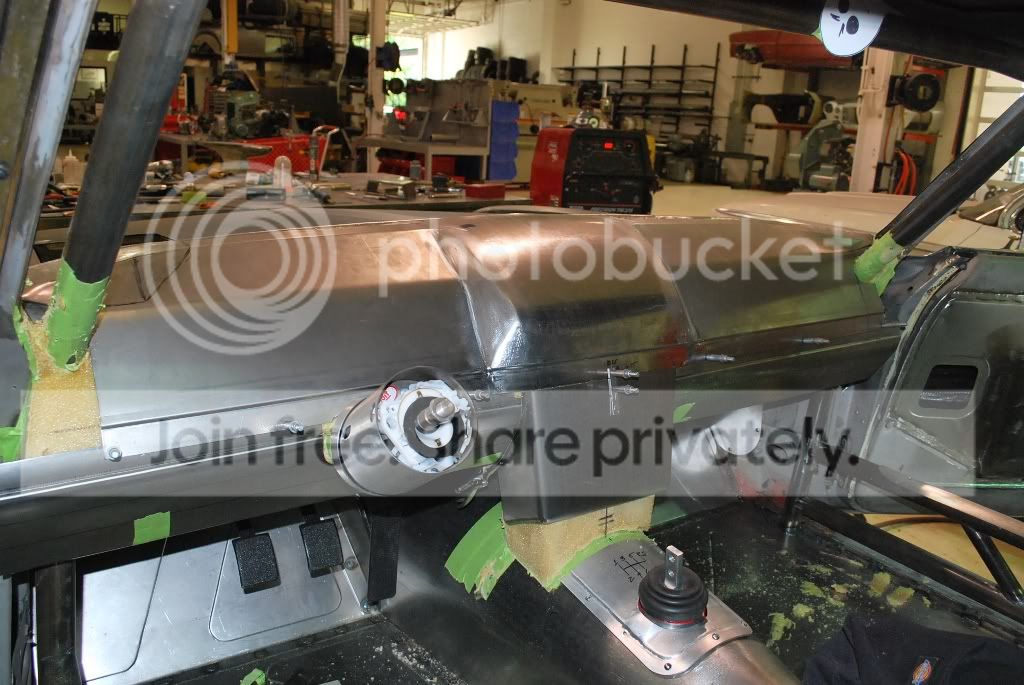

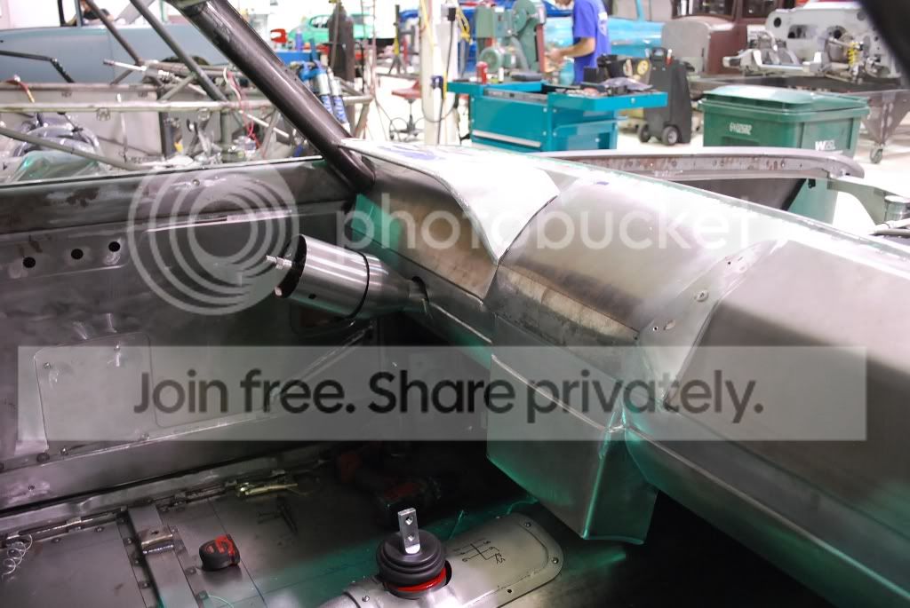

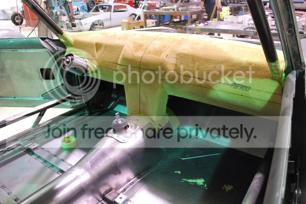

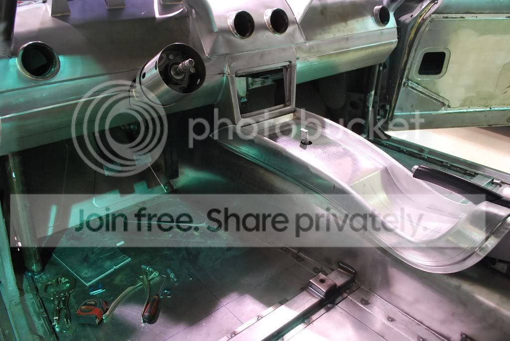

Here is some of the interior sheet metal work:
Started by laying out a dash design in foam to give us a guide to contour the sheet metal to.
http://i563.photobucket.com/albums/s...Interior/1.jpg
http://i563.photobucket.com/albums/s...Interior/2.jpg

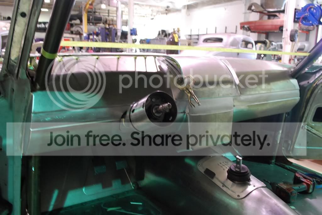

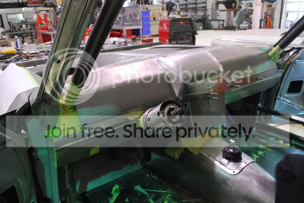

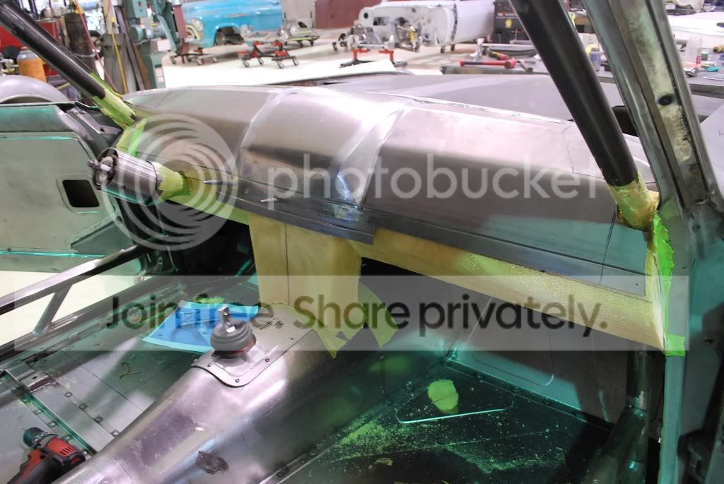

Then began forming the sheet metal and checking the fit against the foam buck.
http://i563.photobucket.com/albums/s...Interior/3.jpg
http://i563.photobucket.com/albums/s...Interior/4.jpg

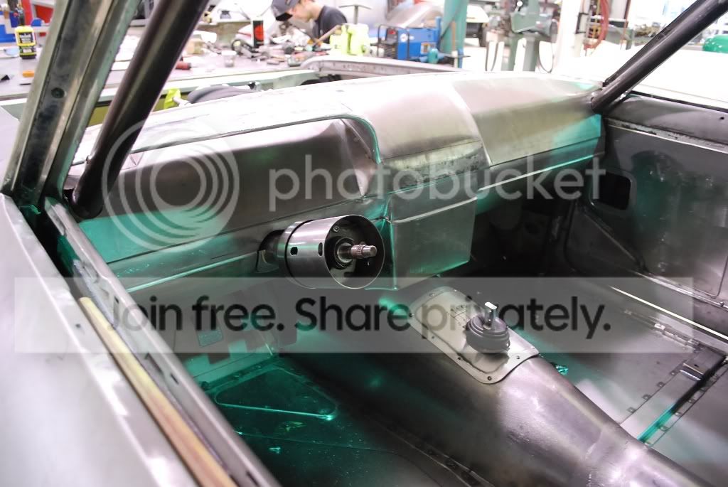

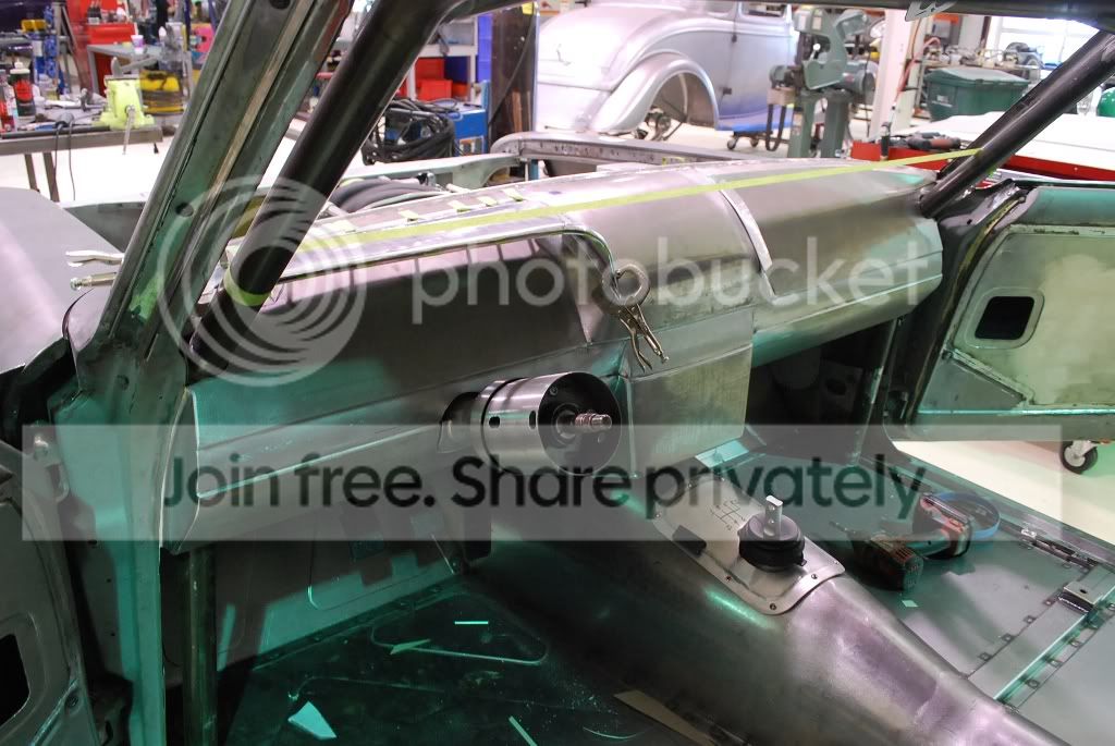

Roadster Shop 06-29-2011 07:28 PM

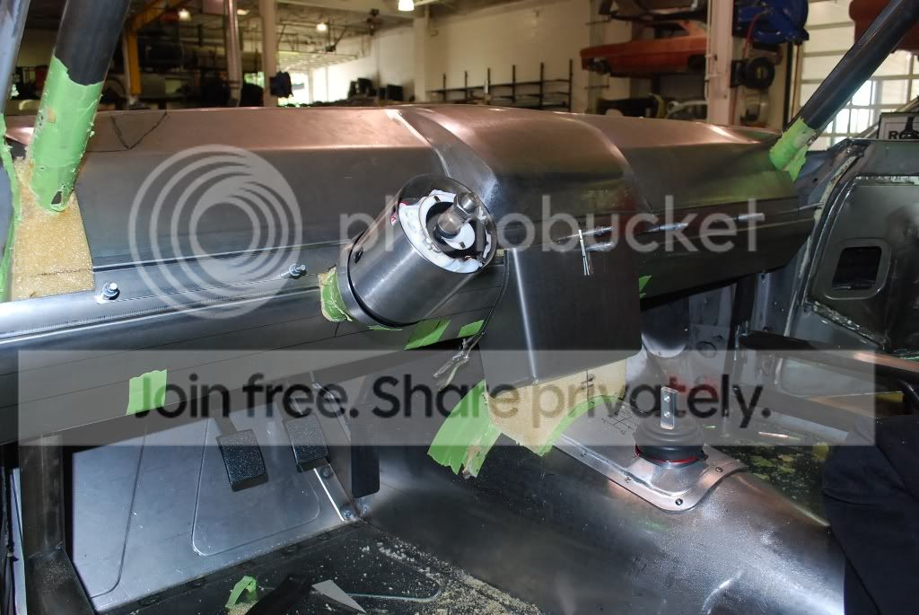

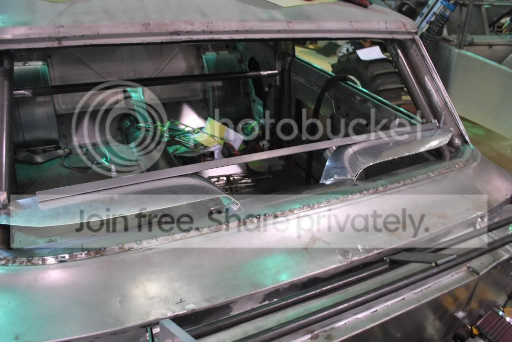

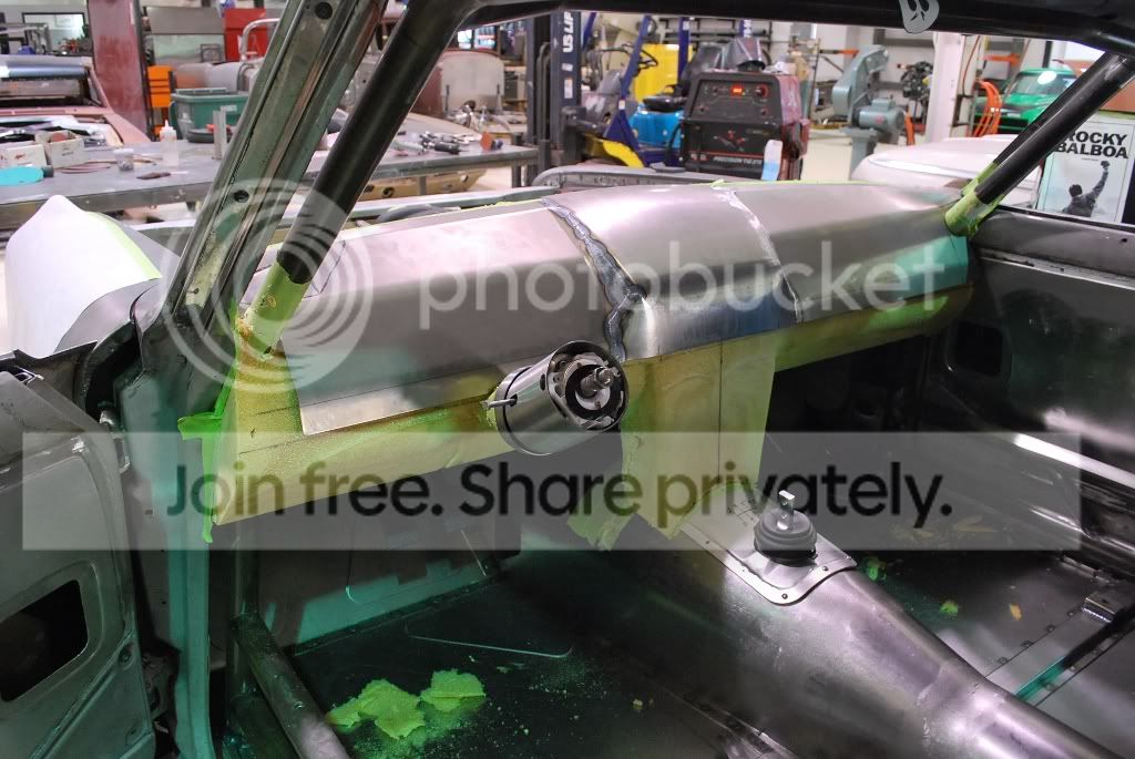

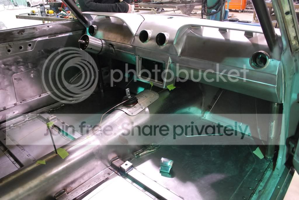

Top of the dash is getting close and beginning to lay out the inset molding that will run through the center of the dash.
http://i563.photobucket.com/albums/s...Interior/5.jpg
The inset molding is roughed in and proceeding on the lower portion of the dash
http://i563.photobucket.com/albums/s...Interior/6.jpg
http://i563.photobucket.com/albums/s...Interior/7.jpg
http://i563.photobucket.com/albums/s...Interior/8.jpg

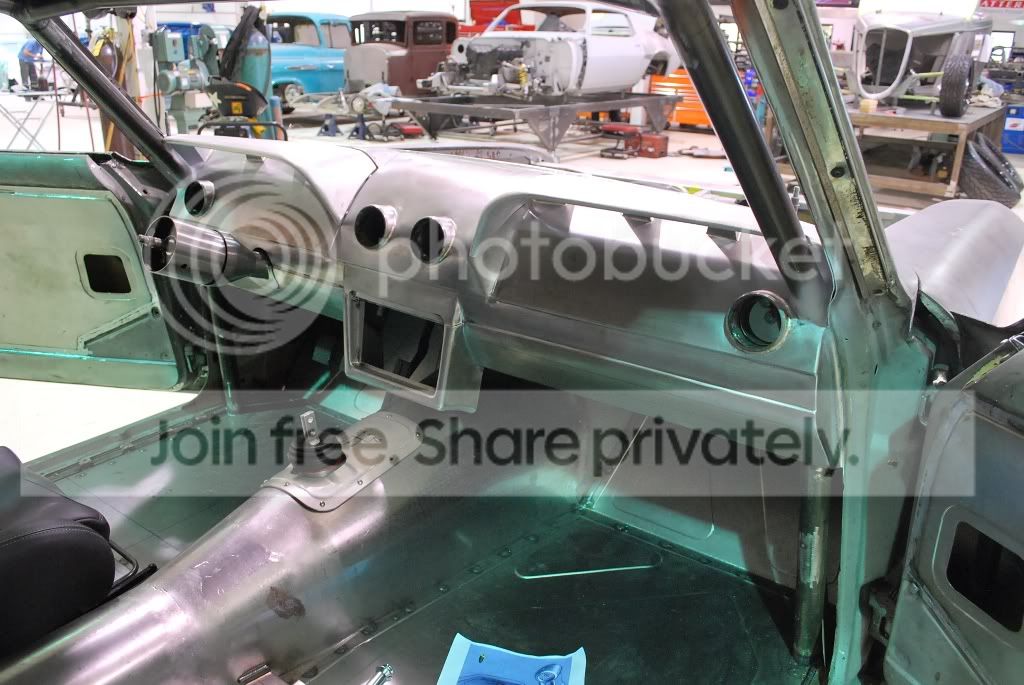

Roadster Shop 06-29-2011 07:31 PM

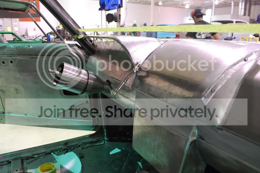

Laying out the eyebrows over the sides of the dash.
http://i563.photobucket.com/albums/s...Interior/9.jpg
http://i563.photobucket.com/albums/s...nterior/10.jpg
http://i563.photobucket.com/albums/s...nterior/11.jpg
http://i563.photobucket.com/albums/s...nterior/12.jpg
http://i563.photobucket.com/albums/s...nterior/13.jpg
http://i563.photobucket.com/albums/s...nterior/14.jpg
Roadster Shop 06-29-2011 07:37 PM
http://i563.photobucket.com/albums/s...nterior/15.jpg
http://i563.photobucket.com/albums/s...nterior/16.jpg
http://i563.photobucket.com/albums/s...nterior/17.jpg

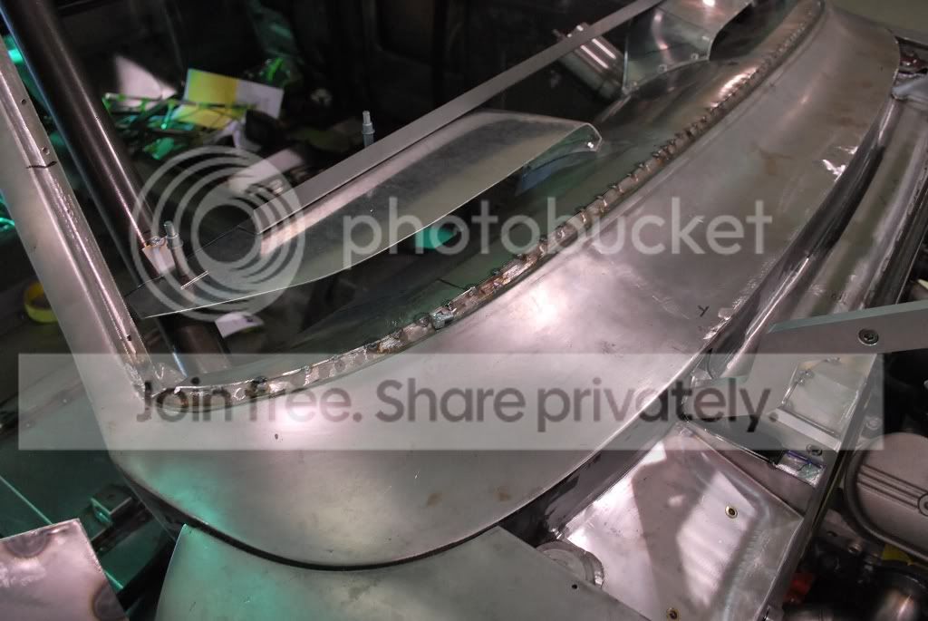

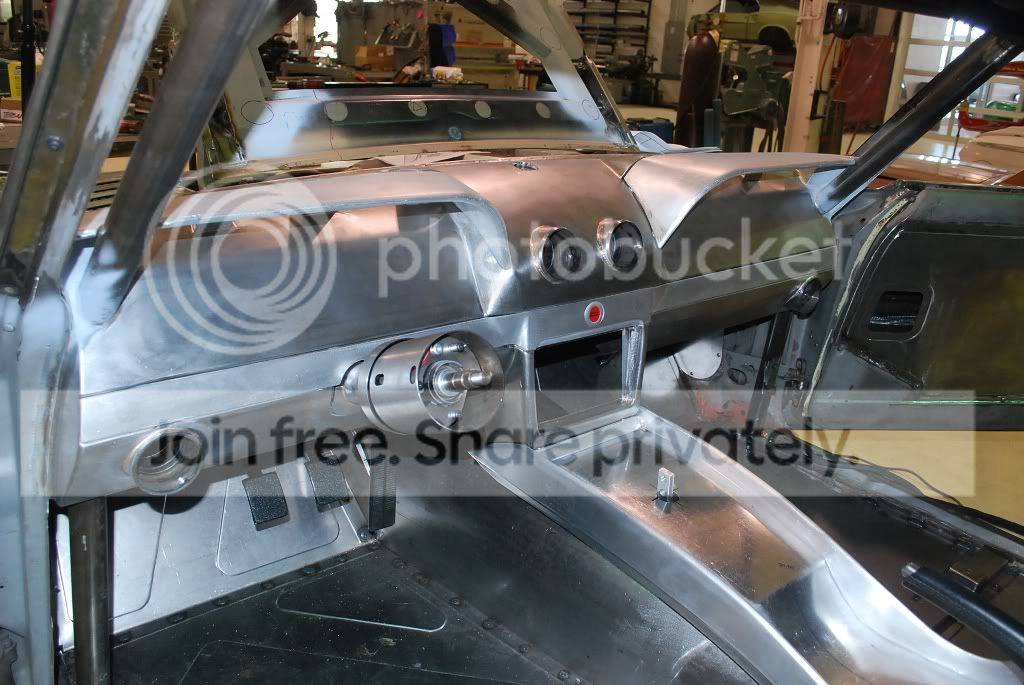

Eyebrows completed on the dash and further progress on the lower portion that will house the stereo unit. A/C vent holes also installed. The outside A/C vents were moved later on in the build in favor of a cleaner look.
http://i563.photobucket.com/albums/s...nterior/18.jpg
http://i563.photobucket.com/albums/s...nterior/19.jpg
http://i563.photobucket.com/albums/s...nterior/20.jpg

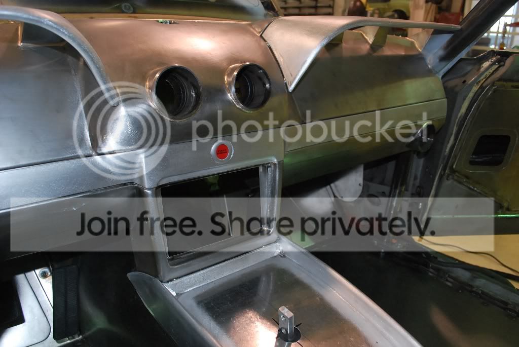

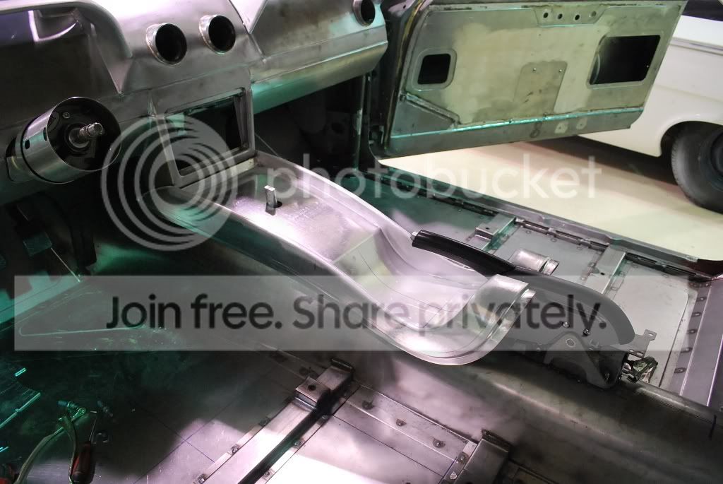

Roadster Shop 06-30-2011 05:12 PM

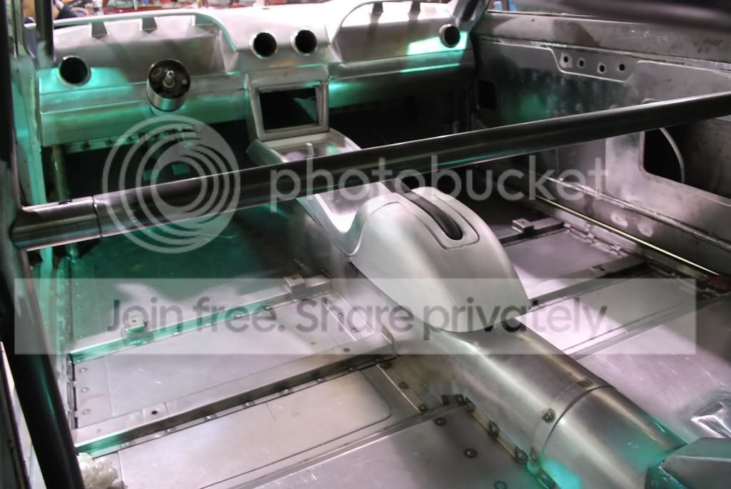

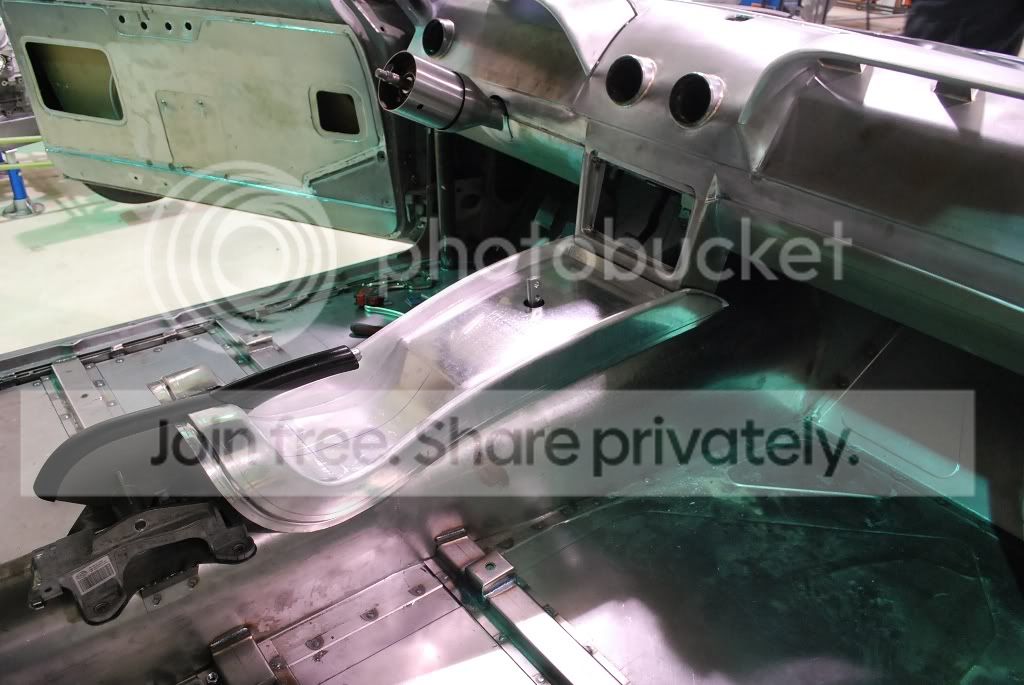

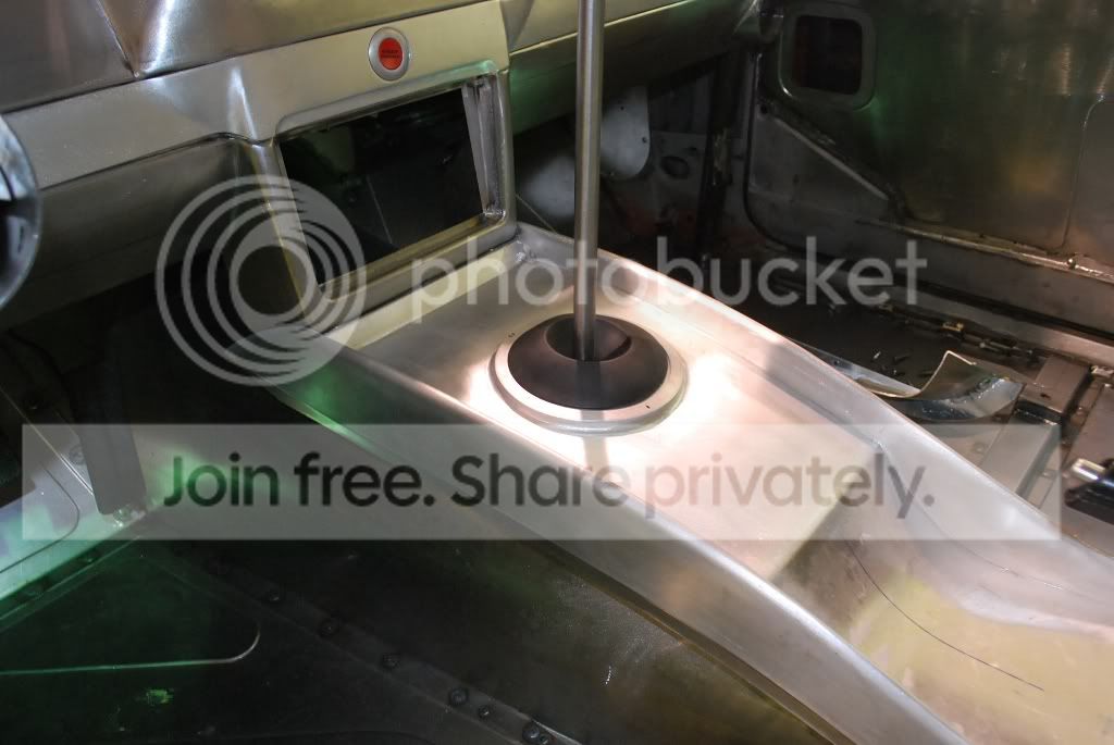

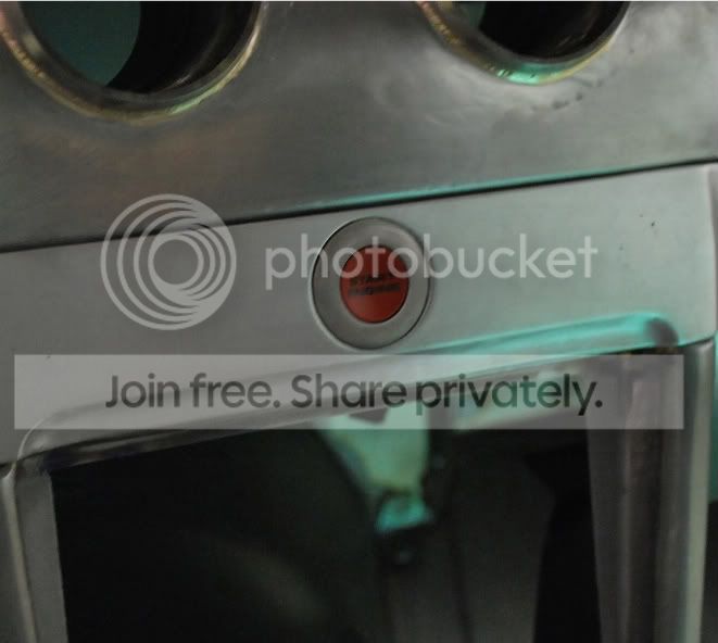

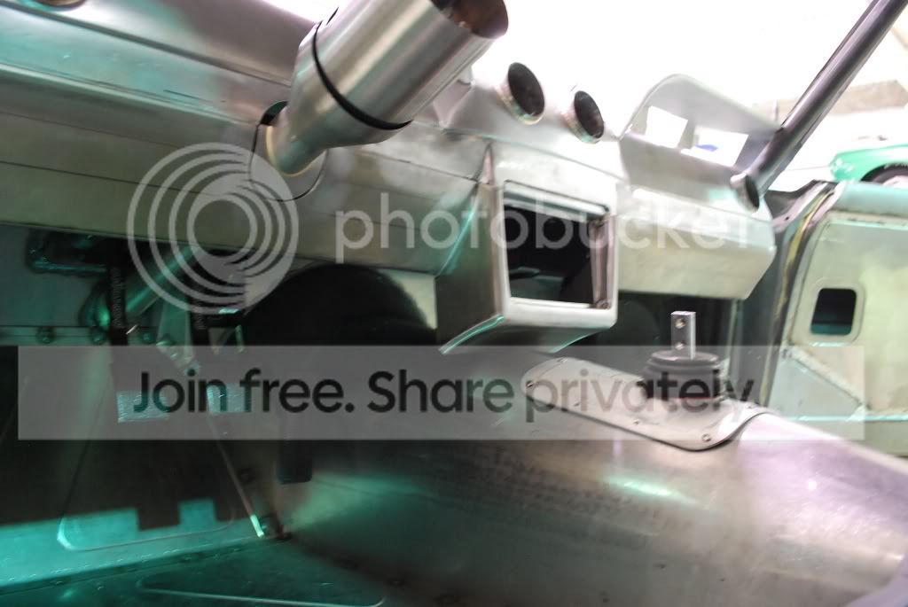

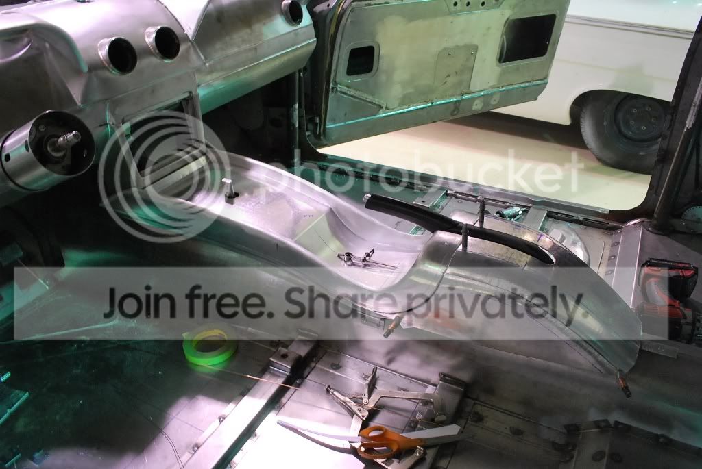

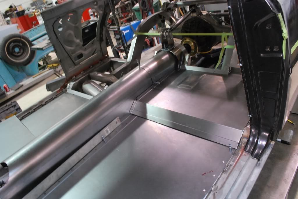

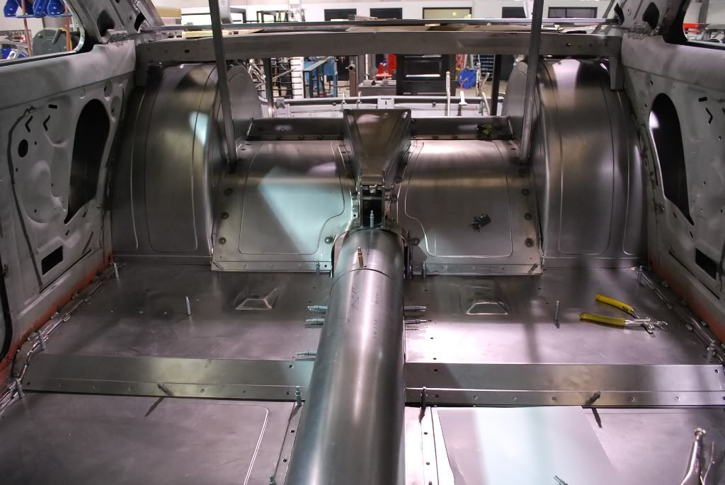

Inset aluminum trim molding completed for the center of dash along with engine start button installed. A/C vents relocated to the lower portion of the dash and the center console starting to take shape
http://i563.photobucket.com/albums/s...nterior/21.jpg
http://i563.photobucket.com/albums/s...nterior/22.jpg
http://i563.photobucket.com/albums/s...nterior/23.jpg

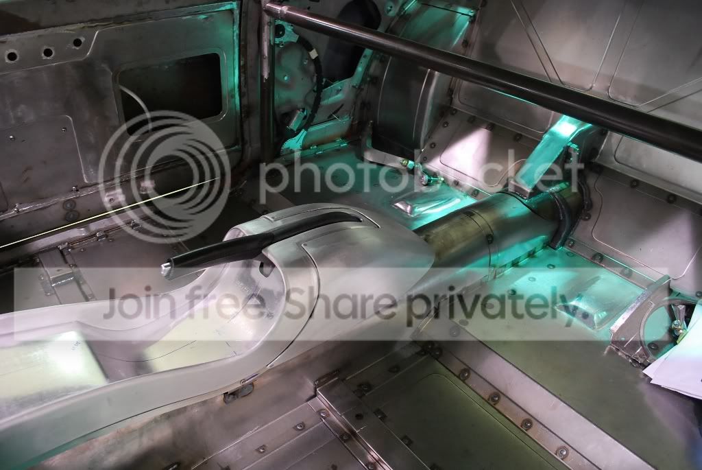

More progress on the aluminum center console and e-brake.
http://i563.photobucket.com/albums/s...nterior/25.jpg
http://i563.photobucket.com/albums/s...nterior/26.jpg
http://i563.photobucket.com/albums/s...nterior/27.jpg

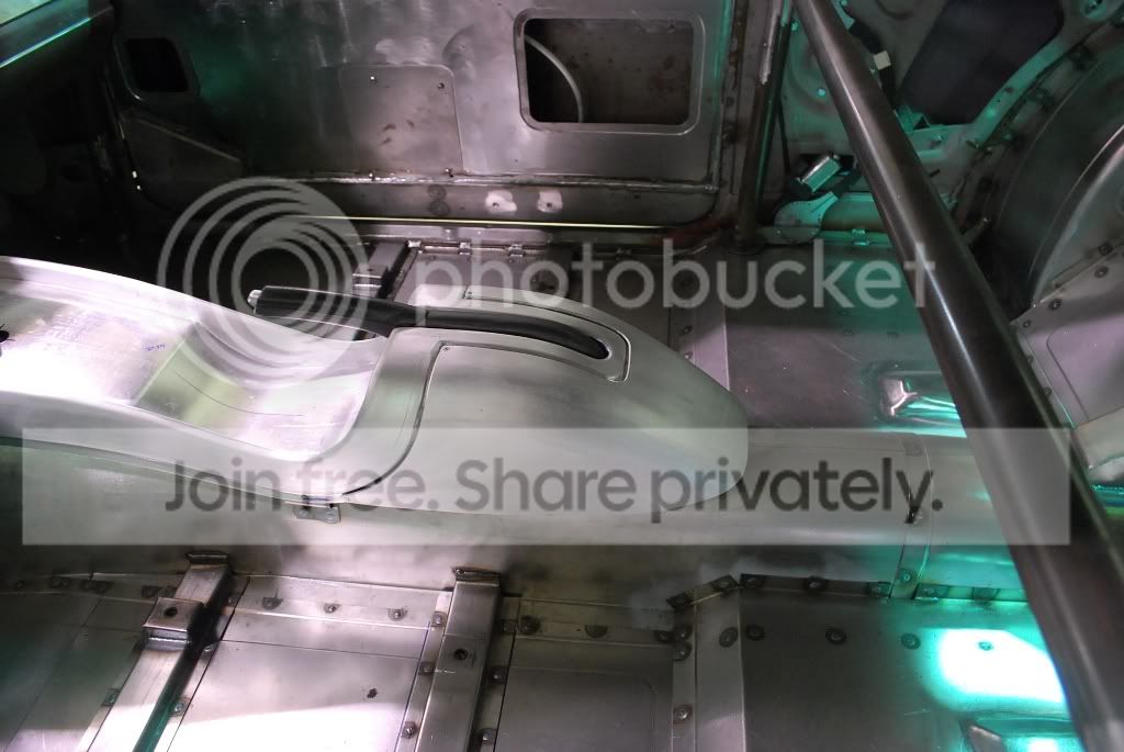

Roadster Shop 06-30-2011 05:13 PM
Rear cap portion around the e-brake.
http://i563.photobucket.com/albums/s...nterior/28.jpg
http://i563.photobucket.com/albums/s...nterior/29.jpg
http://i563.photobucket.com/albums/s...nterior/30.jpg
http://i563.photobucket.com/albums/s...nterior/31.jpg
http://i563.photobucket.com/albums/s...nterior/32.jpg

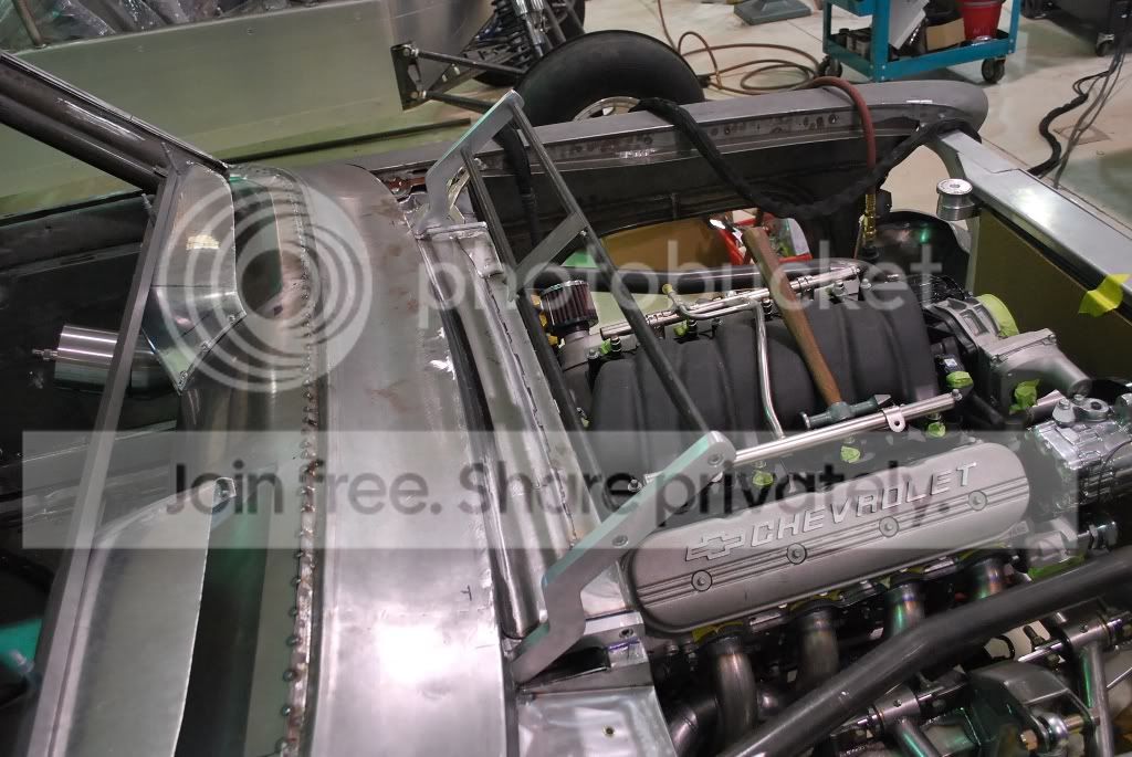

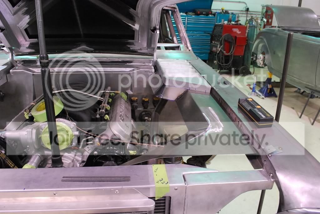

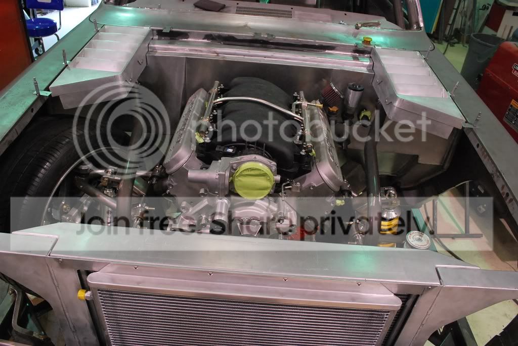

Roadster Shop 07-01-2011 05:11 PM

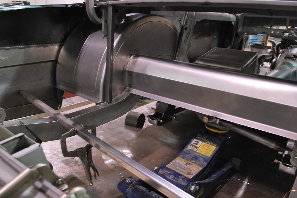

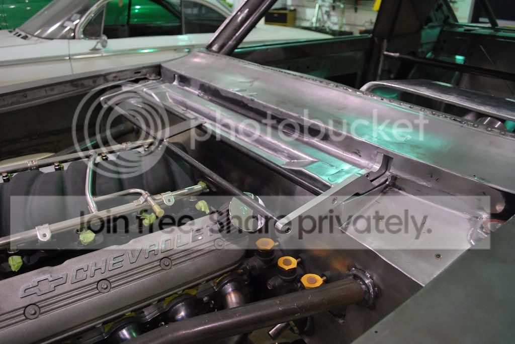

The start of the inner fenders and engine bay details:
http://i563.photobucket.com/albums/s...ne%20Bay/1.jpg
http://i563.photobucket.com/albums/s...ne%20Bay/2.jpg
http://i563.photobucket.com/albums/s...ne%20Bay/3.jpg
http://i563.photobucket.com/albums/s...ne%20Bay/4.jpg
http://i563.photobucket.com/albums/s...ne%20Bay/5.jpg

GregWeld 07-01-2011 08:55 PM
You have to pull the motor to change plugs??
Not a bad days work there!
Jr 07-02-2011 08:14 AM
Looks like those vents are functional...damn... very nice work.
