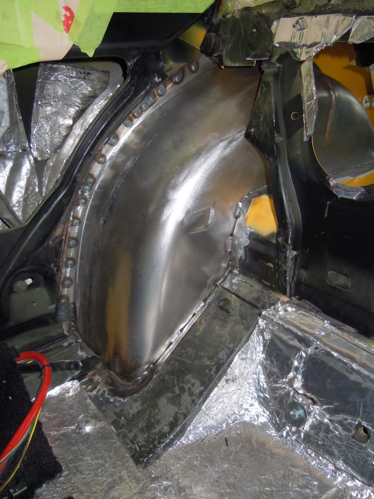

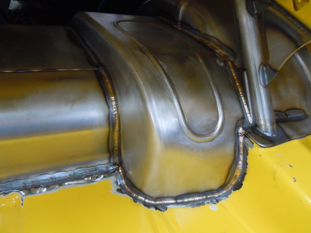

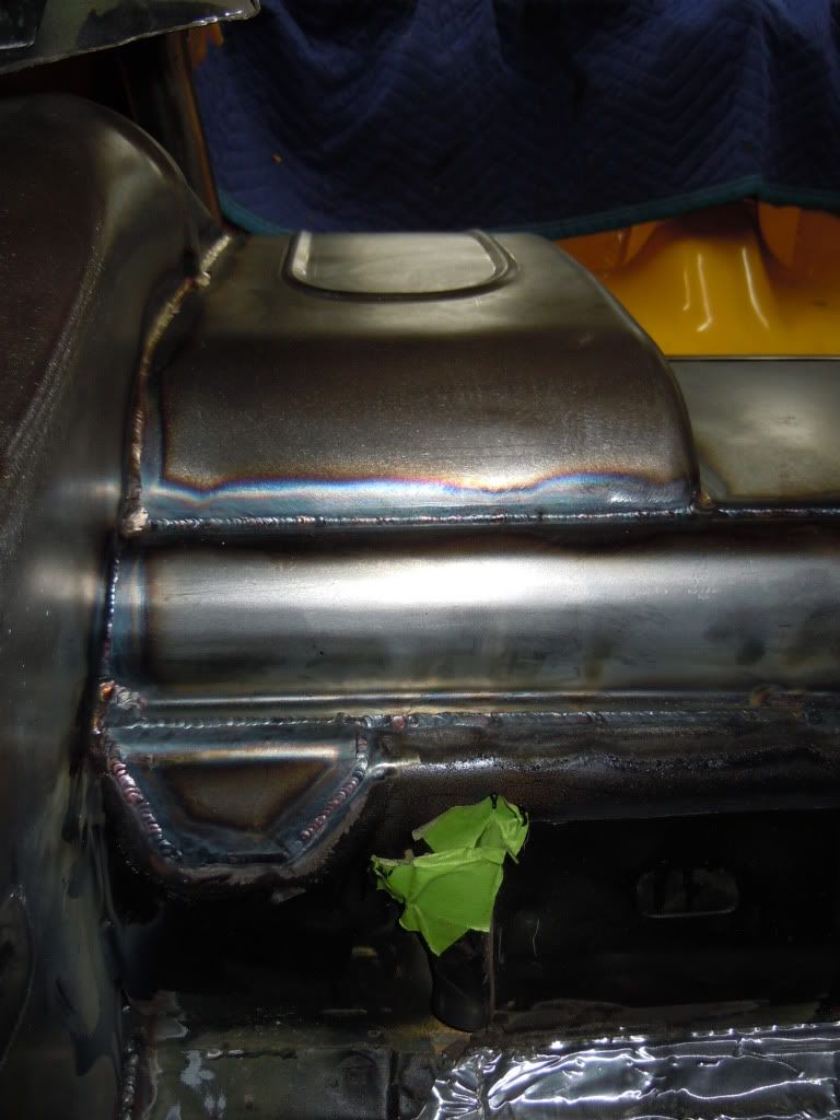

Payton King 07-13-2011 08:50 AM

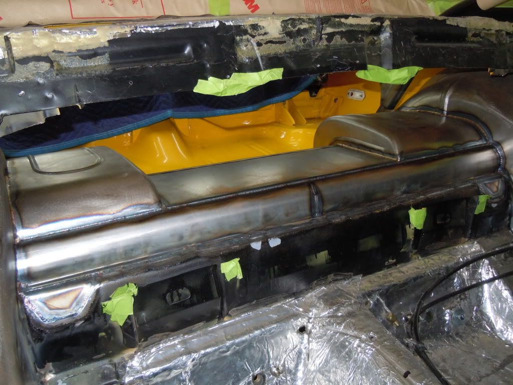

Finish welding
http://i1138.photobucket.com/albums/...g/DSCN2672.jpg
http://i1138.photobucket.com/albums/...g/DSCN2678.jpg
http://i1138.photobucket.com/albums/...g/DSCN2677.jpg

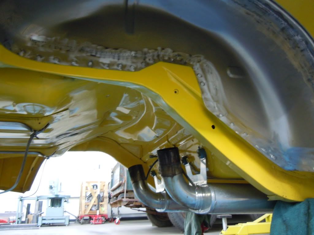

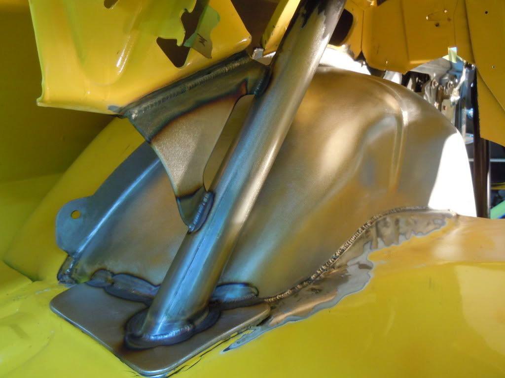

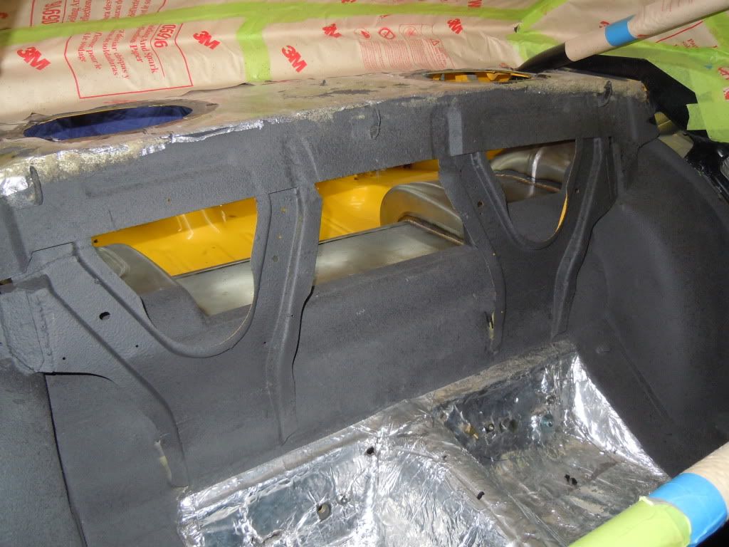

Payton King 07-13-2011 08:52 AM
From inside the car
http://i1138.photobucket.com/albums/...g/DSCN2682.jpg
http://i1138.photobucket.com/albums/...g/DSCN2683.jpg

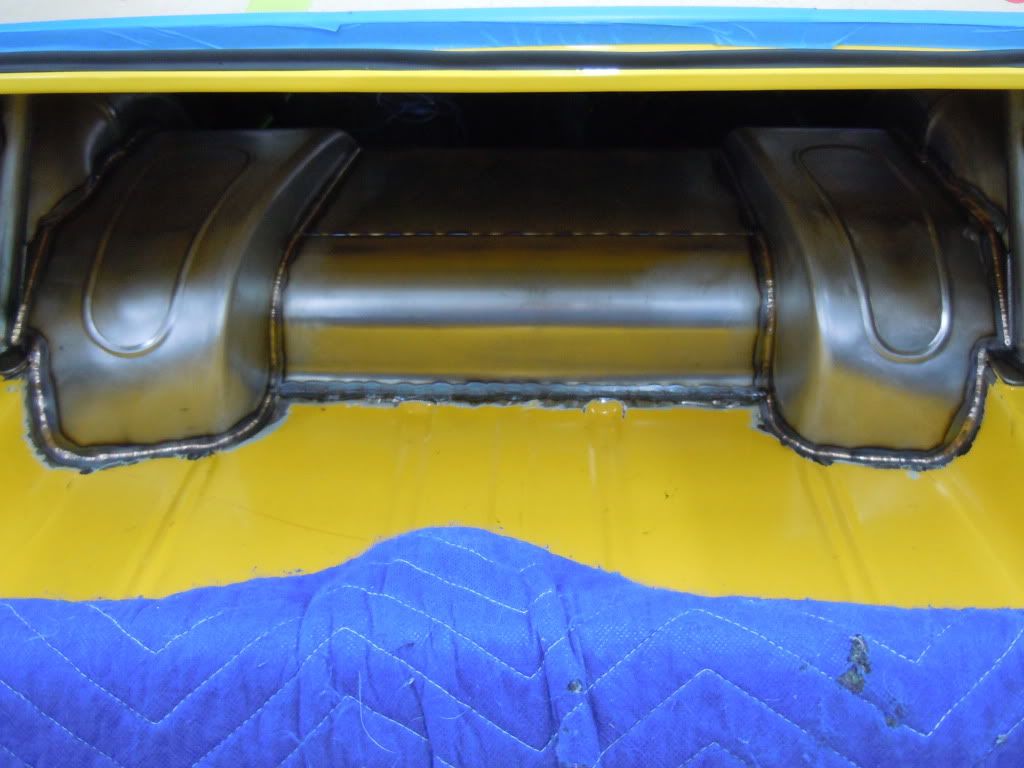

Payton King 07-13-2011 08:54 AM
more pics
With the seat brace back on and a small section POR'd and lizard skinned.
http://i1138.photobucket.com/albums/...g/DSCN2716.jpg

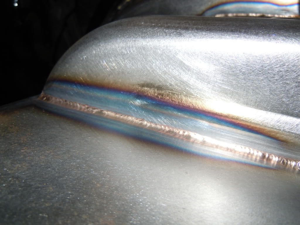

GregWeld 07-13-2011 10:03 AM
Payton -- that's looking first class! Nice welding and I like the use of the silicone bronze rod...
dhutton 07-13-2011 10:09 AM
Beautiful work. Just curious, how long did it take to do all that finish TIG welding? I don't think I have the patience, aside from the obvious lack of talent, to do work of that caliber.
Don
waynieZ 07-13-2011 10:46 AM
It looks great Payton. They do beauitiful work.

Originally Posted by Payton King (Post 359452)
Do you know what type of rod they used?

Payton King 07-13-2011 12:11 PM
Greg was correct
GregWeld 07-13-2011 12:17 PM
Kyle -- Silicone bronze rod is great for TIG on sheetmetal etc where it is NON STRUCTURAL.... it welds with lower heat - thus lowering the warp factor...
HotRod68Camaro 07-13-2011 02:23 PM
Awesome, thanks guys. I want to pick up a TIG soon so i'm trying to learn as i see fab pics.

HOLOHAN'S HOT ROD SHOP 07-13-2011 04:06 PM
Hey Guys,
Glad you guys like the work. Doing that kind of work is definately a challenge but having a good project owner like Payton makes a guy want to do his best.
Probably the most challenging thing working on a project like this is that's it's a painted, running car, a very nice painted running car! So being careful is half the battle and the other half was trying to figure out how to get my old, half blind butt in and out of that trunk. Had it pretty much down to a science before it was done, but did almost get stuck once.
Legs hanging out the trunk, pedal bewteen my knees and my head stuck with my helmet on, under the package tray, but did mange to get out after a lot of grunting and talking to myself......
Again, glad you like the work and thanks for the kind words......
rwhite692 07-13-2011 04:18 PM
Yup....
W/silicon (note, there's no "e") bronze rod, It is not unlike gas brazing. You are simply using a different method of providing the heat.

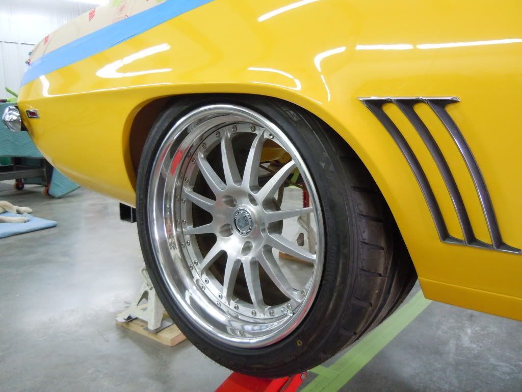

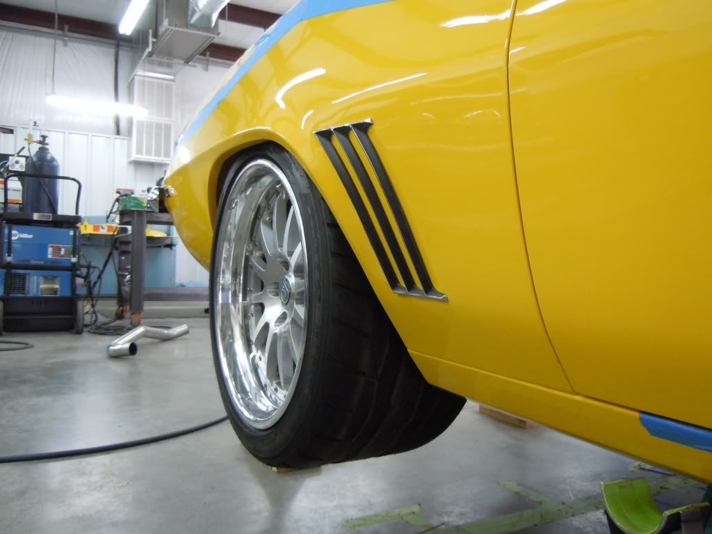

Payton King 07-20-2011 10:11 AM
back from paint
http://i1138.photobucket.com/albums/...g/DSCN3274.jpg
http://i1138.photobucket.com/albums/...g/DSCN3277.jpg

skatinjay27 07-20-2011 11:48 AM
man o man just see it with the front wheels(at those kick azz rear!) you can tell the car is gonna be on a whole nother level with those HRE's over the vette wheels..:unibrow:

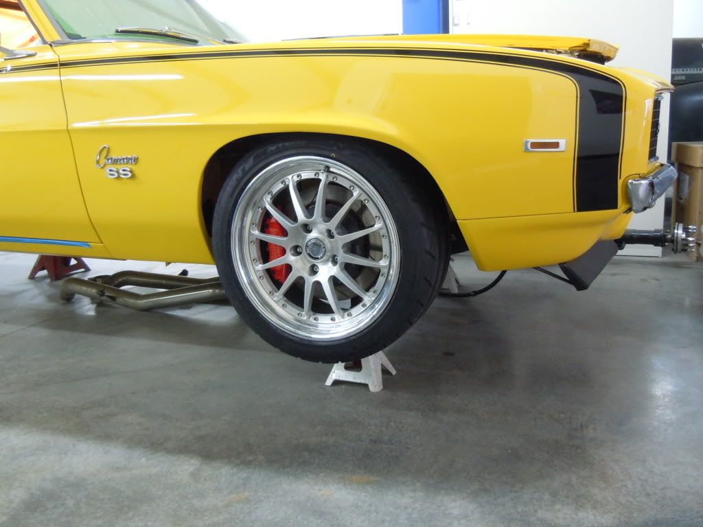

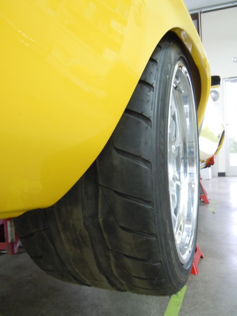

Payton King 07-21-2011 08:05 AM
I have not seen it on the ground
I do have some mock up pics
http://i1138.photobucket.com/albums/...efromfront.jpg
http://i1138.photobucket.com/albums/...g/Reartire.jpg
