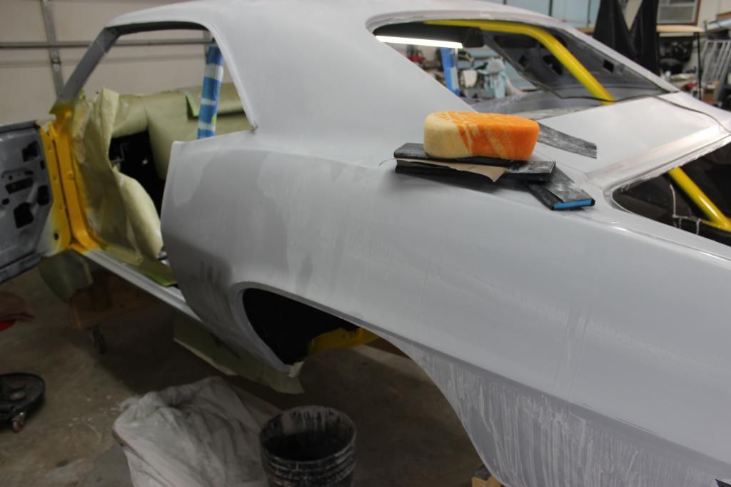

One of the things that I have been able to figure out is that I need to be spraying the white sealer over the gray primer before spraying the velocity yellow. The yellow does not cover real well. So far being able to spray the bottom and then the firewall has sharpened up my skills, after twenty four years they have gotten a little rusty, but it's coming back.
I went ahead and cut and buffed the firewall as a good spot for the practice for the rest of the car.

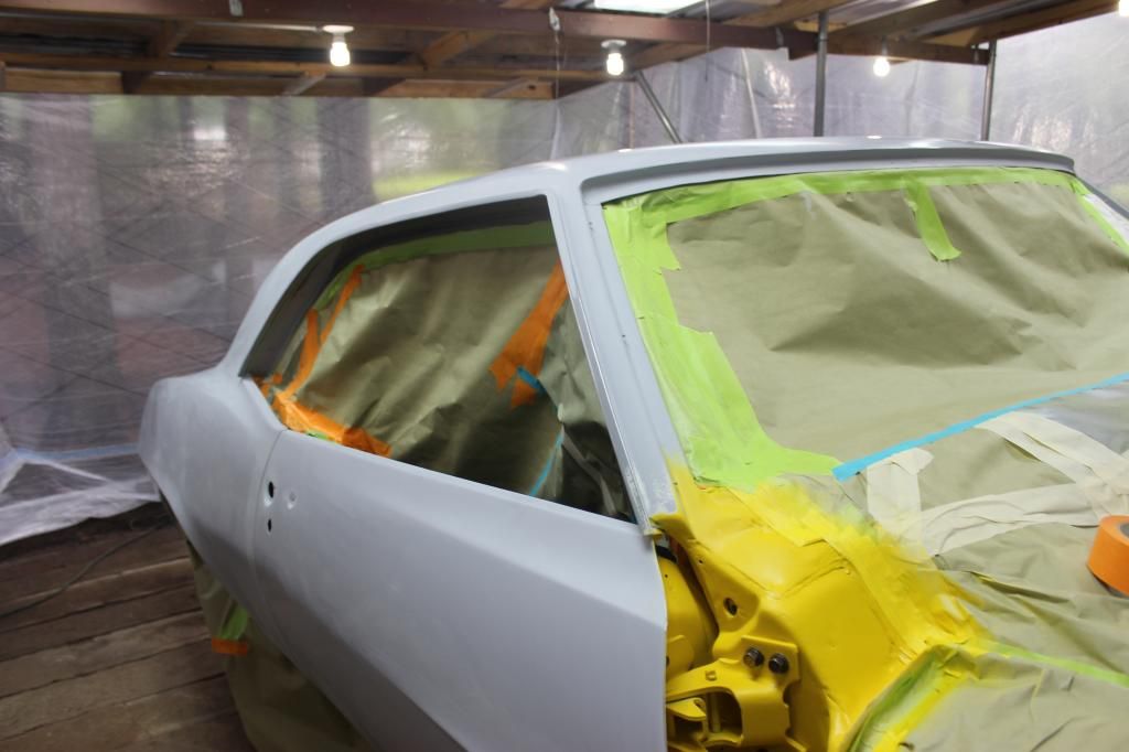

After much internal debate I decided to spray the jamb area's around the hinges before paint so that I would insure the best possible coverage.
I used the reduced epoxy primer (PPG DP48LF) as a sealer before the color.
It's a lot of work and probably overkill but oh well...

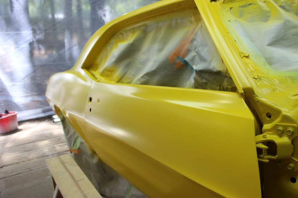

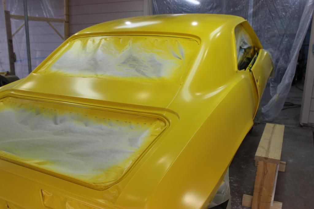

Getting some color on the body...
:hairpullout:

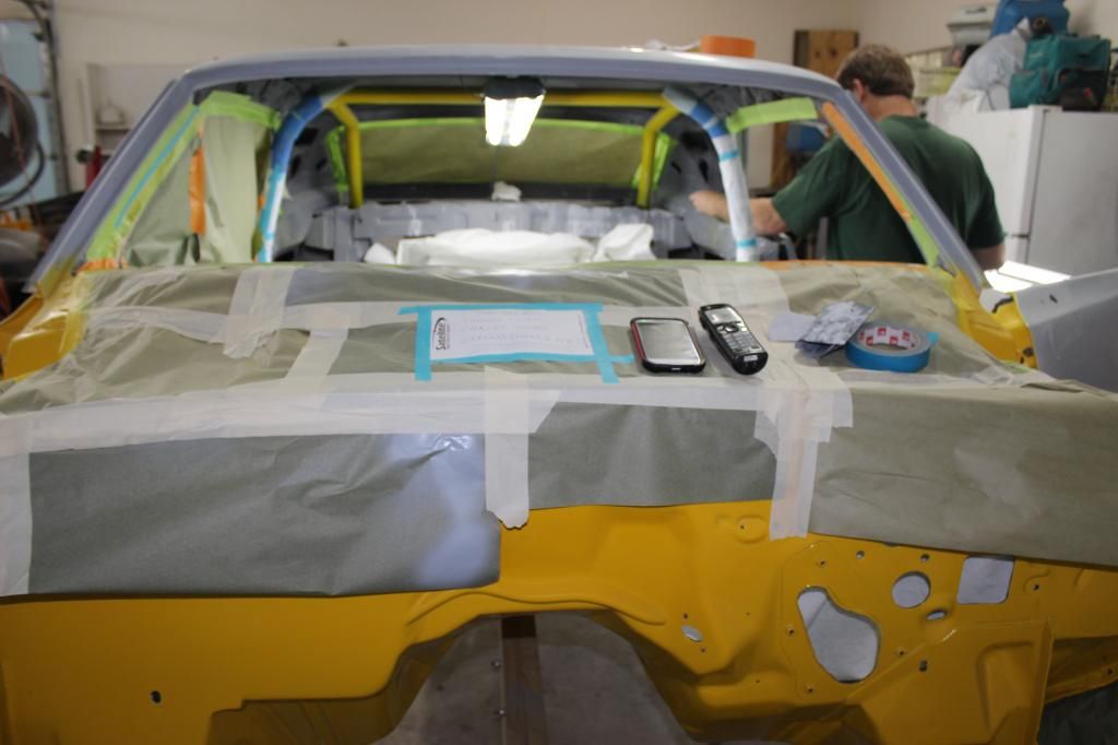

Woo Hoo... Moving along, I was able to get the doors on and then I started wet sanding in preparation of paint.
Two days later, masking up and ready for sealer, paint and clear...
