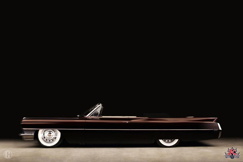

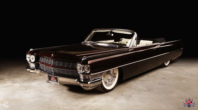

FETorino 09-03-2012 01:24 PM
Originally Posted by INTMD8 (Post 433034)
Wheels are finished! Having these built made a lot of things possible that otherwise wouldn't be. They have preserved the classic look of the car while allowing 19 and 20in Y speed rated (186mph) Michelin PS2's and also clearance for C6 Z06 brakes.
All of this should compliment the Roadster Shop chassis well.
Thanks to Larry and the crew at EVOD for the impressive illusion! :)
http://imageshack.us/a/img23/359/evod3.jpg
http://imageshack.us/a/img441/2702/evod4.jpg
I've seen that wheel look before on a Caddy, looks pretty slick.
http://i291.photobucket.com/albums/l...ca/64_frt1.jpg
http://i291.photobucket.com/albums/l...4_caddy_10.jpg
INTMD8 09-06-2012 06:24 PM
Yes that car is sweet! 22 inch EVOD's.
