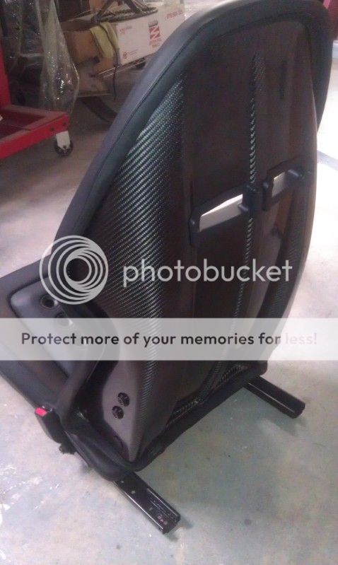

Not a chance on the seats bro. I'm also going to liken those seats to Cindy's boobs. If you got your hands on them, would you ever let go of them?
If for some reason they don't fit in my svelte, lightweight little car, I'll make sure they find a good home in your boat.

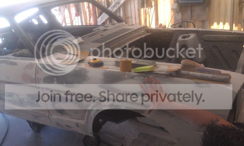

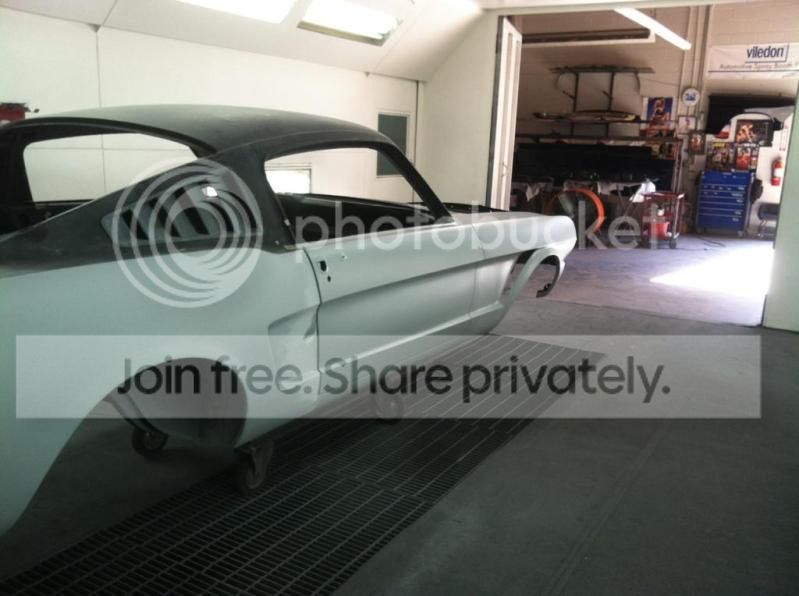

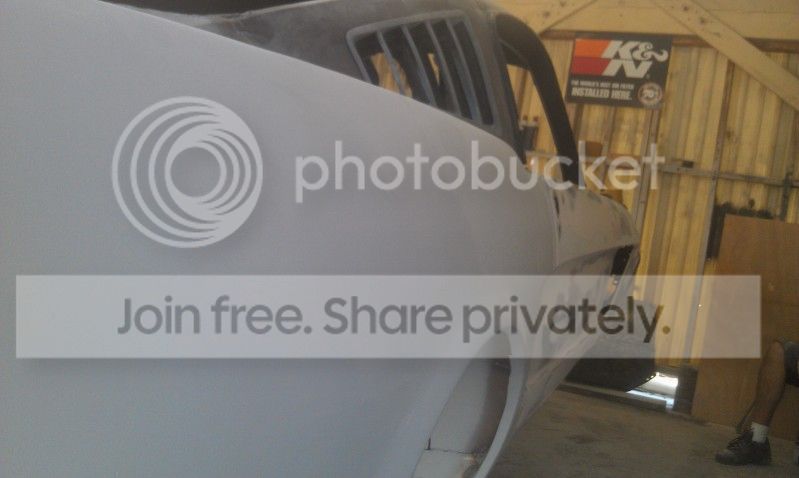

Matt@BOS 07-31-2012 11:07 PM
Been busy sanding filler. Since I got pretty crazy with the metal work and it looks like the car might actually turn out nice, soon I'll be handing it over to Jesus at the shop to go over the side one last time for me and fix all of the wobbles and heavy sanding scratches along the side. Then it will finally get a coat of primer, well at least one side will. I'll be busy buttoning up the other side in the mean time.
Right now it looks like one of those funny test cars with splotchy camo on it, so forgive me if the side just looks like a blob.
http://i366.photobucket.com/albums/o...A/IMAG0583.jpg
http://i366.photobucket.com/albums/o...A/IMAG0582.jpg
http://i366.photobucket.com/albums/o...A/IMAG0581.jpg

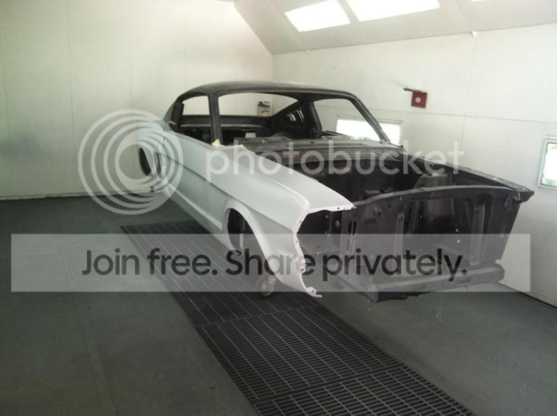

Just for reference I snapped some shots of another customer's 1965 coupé, which he has owned since new. From certain angles you can really see how much the side of the car has been changed!

FETorino 07-31-2012 11:21 PM
Matt
You should be proud:thumbsup:
It looks stout but subtle.:wow:
Ron in SoCal 07-31-2012 11:45 PM
That's a homerun buddy. Dick needs to give you a promotion...:cheers:
Rick D 08-01-2012 06:18 AM
That looks great Matt, you are doing an awesome job for your first time! You really can't see the stretch from the side view, but when you show the other stang WOW you really see it :thumbsup:
waynieZ 08-01-2012 09:52 PM
Very nice Matt! You've come a long way since I saw you. It looks great! You've got to be happy with how its coming out.:thumbsup:
Flash68 08-01-2012 09:57 PM
Dude that is impressive. You are actually talented. :thumbsup:

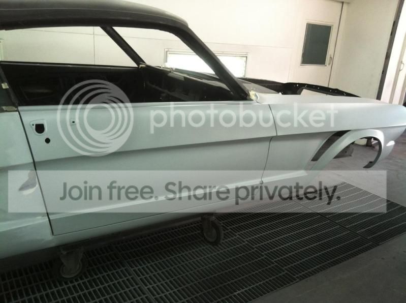

Matt@BOS 08-22-2012 01:11 AM
Little bit more progress has been made. DSE parts also shipped out today. I definitely have more of an appreciation for custom fabrication by the day. Jesus has been going back and tidying up all of my work on the passenger side of the car, as I finish up the metal work on the driver side. It is amazing what a difference a little bit of skill and experience will do. He has been getting the lines on the car pretty nice and crisp, and has also been "adding lightness" by removing extra filler than I had on the car.

Vegas69 08-22-2012 07:14 AM
I'm diggin that Matt.
ironworks 08-22-2012 07:27 AM
It's really cool to see you get out there and give things a try. Not being scared to give something a try is the biggest battle.
It's only metal it can be fixed if you screw it up.
Flash68 08-22-2012 08:23 AM
Have a pro come in and clean up the mess. Always a wise plan. :D
Are those NewGens for mock up only or are they going on?
Matt@BOS 08-22-2012 10:23 AM
Todd, Rodger, glad you guys are liking it. A lot of work has gone into trying to make a ford look cool, and I'm glad it is starting to pay off :lol:

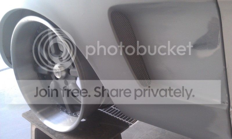

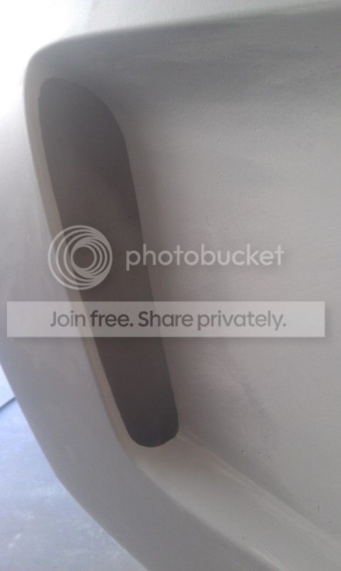

Matt@BOS 08-22-2012 05:53 PM
Originally Posted by 67zo6Camaro (Post 431867)
I was just about to ask when an update was due...
Super cool lines. Especially when you cover up all the color spots.:yes: this thing is just growing and maturing into something special. Keep the work and post comming.
Because you're so good about your updates, I'll do my best as well. Don't think mine could ever be quite as detailed. About all I can say for the last round of pictures is that Jesus had to break out the DA to sand down a bunch of my excess filler, and then put on a skim coat to smooth things out further.
Now, the pictures below demonstrate just how much of a difference nice crisp lines make. Oh, and having everything in one solid color helps a little too :D Up until now it was probably really difficult for anyone on a computer to tell what the everything looked like. I guess today is the moment of judgment. What say you guys? Love it or hate it?

Jtomas801 08-22-2012 06:05 PM
Looks great! Awesome job.
Jon
Flash68 08-22-2012 06:15 PM
Dude. That looks great. Weld building cars. You building cars. There goes the neighborhood.
Rick D 08-22-2012 06:32 PM
Nope sorry I don't like it, I think you should scrap the whole thing and start with a different car.
Tell you what Matt I will send a truck to pick it up and get it out of your way?? Sound good??? :unibrow:
Ok I like it!!! :cheers: Great job!!! :cheers:
