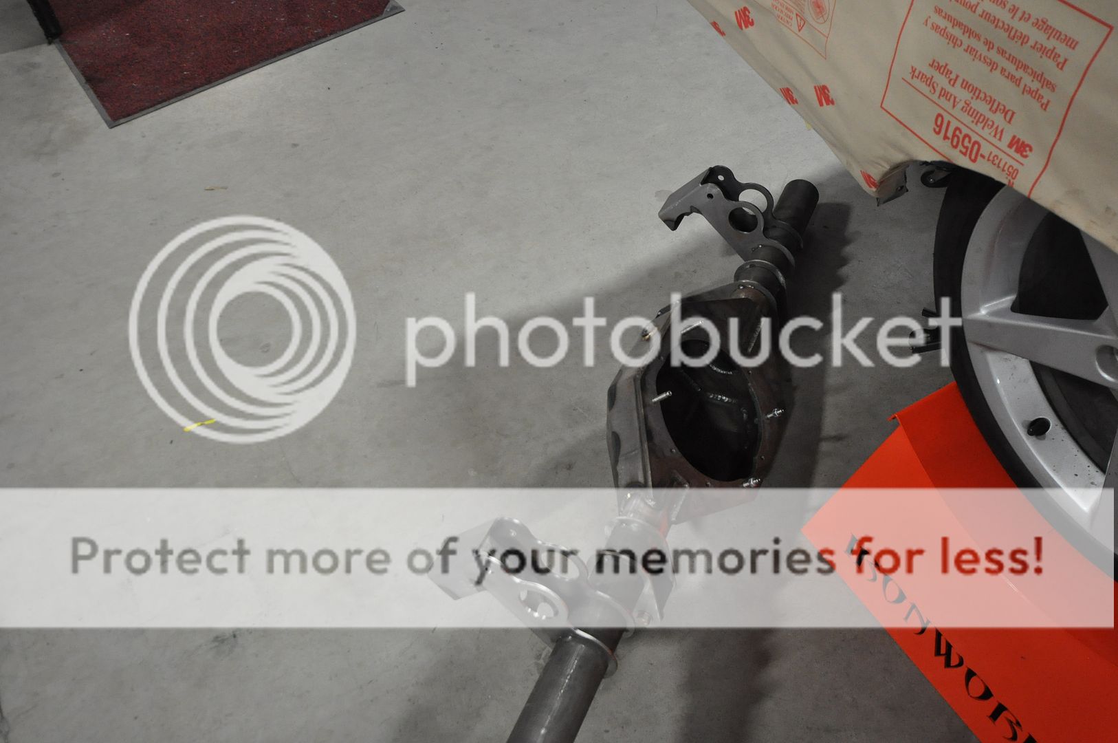

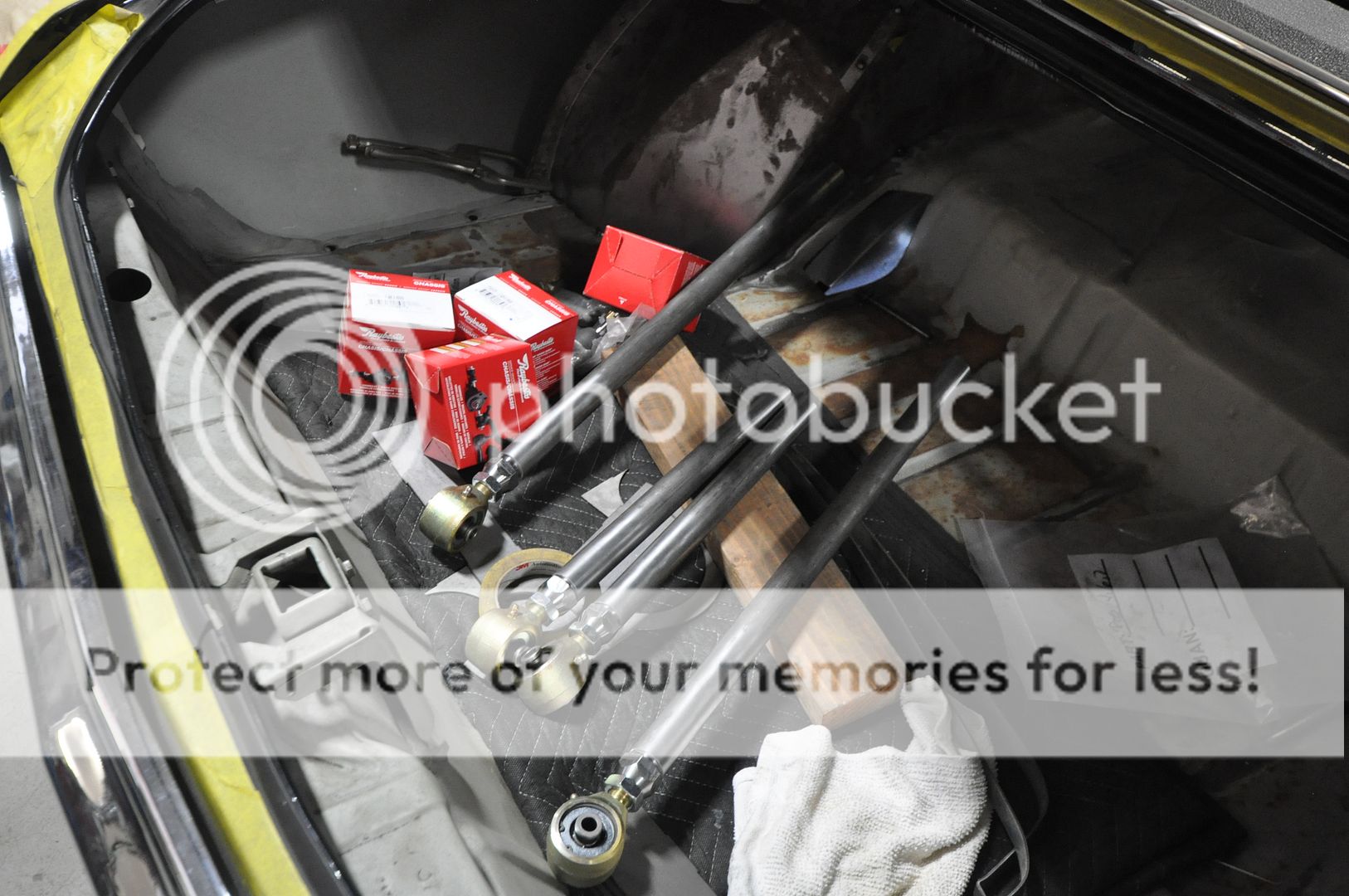

Here is the New GMR housings that come standard on the Ironworks Chassis's now. No Cheap low dollar crap here.
http://i616.photobucket.com/albums/t...-3-2012004.jpg

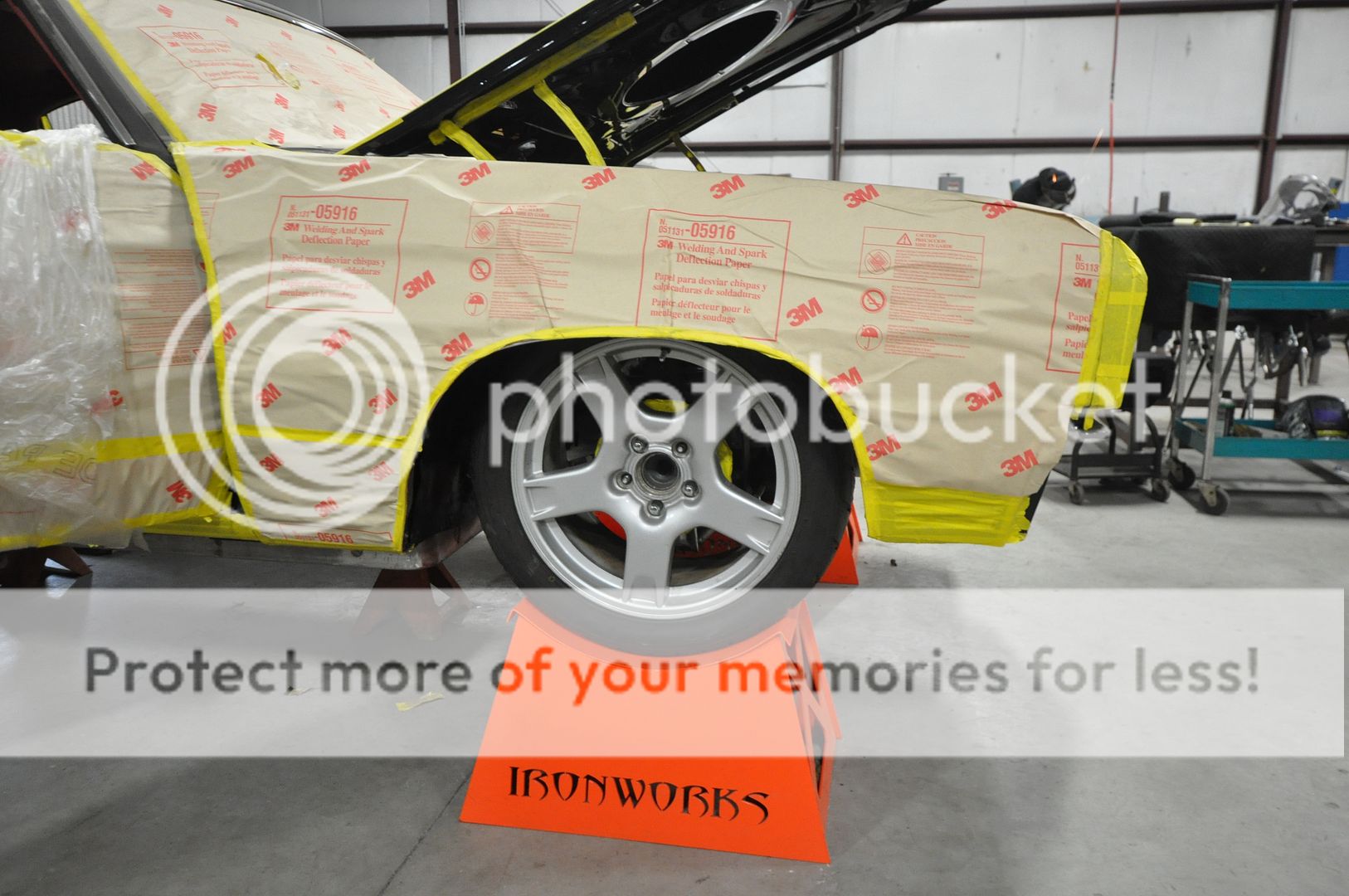

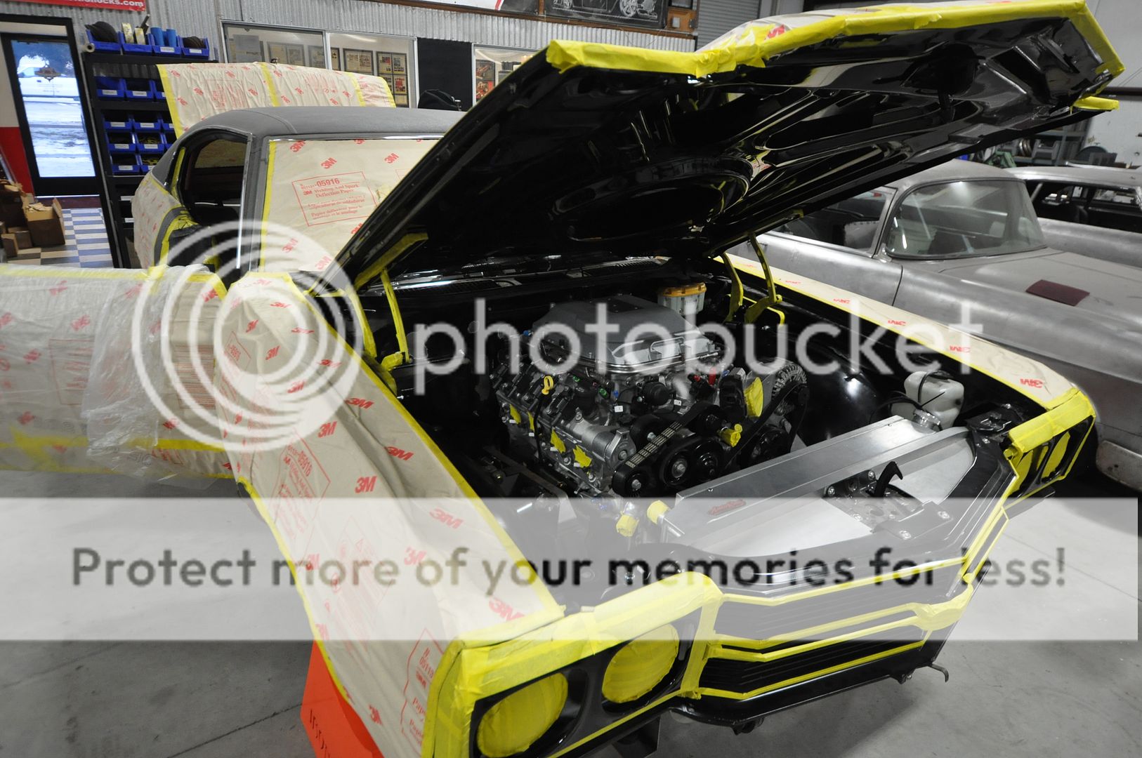

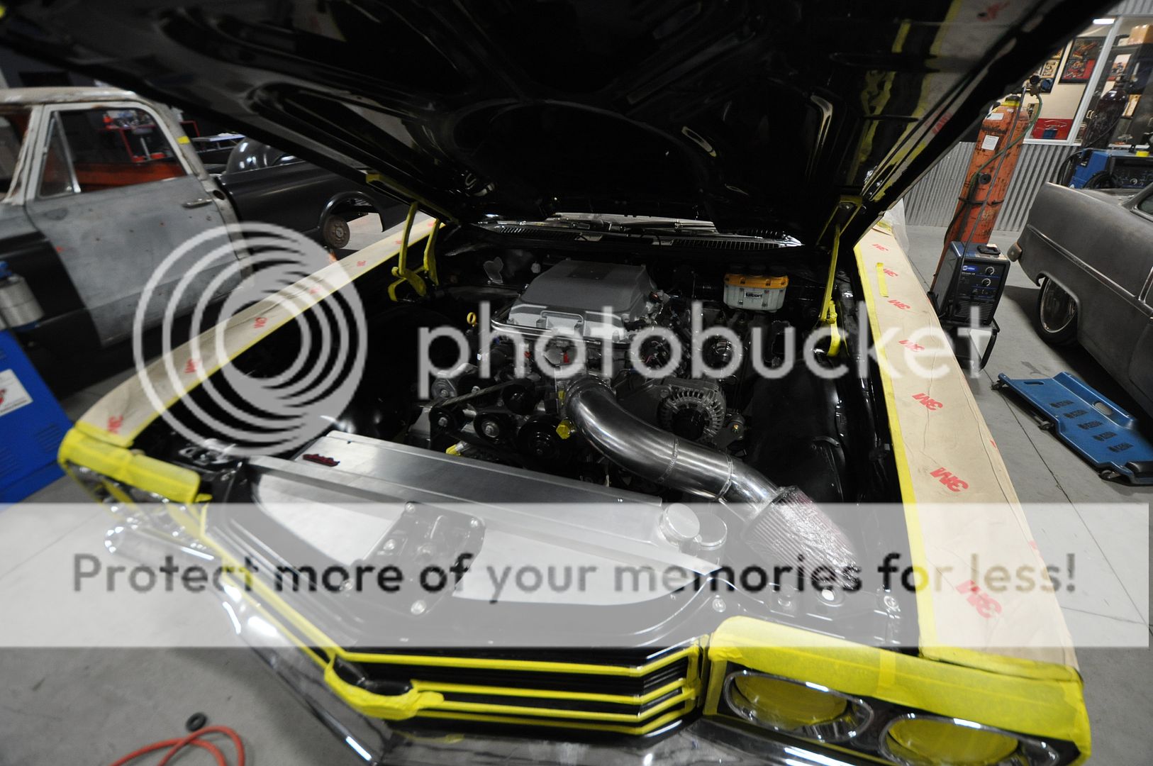

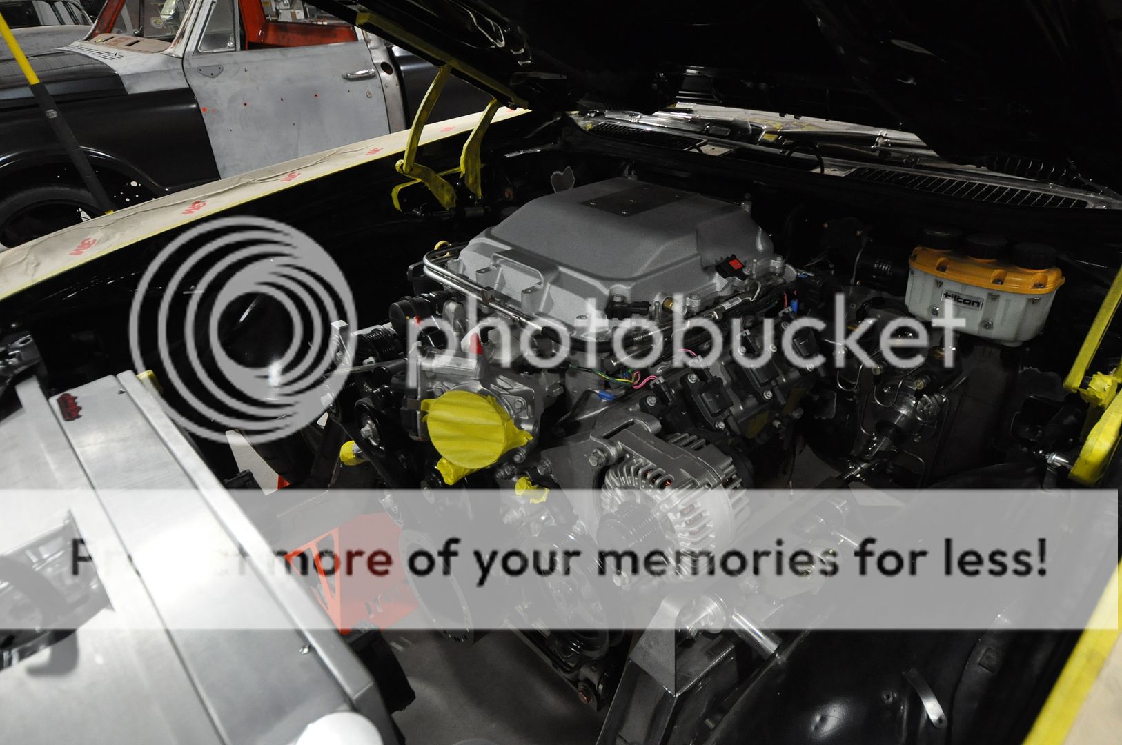

Progress
http://i616.photobucket.com/albums/t...-5-2012005.jpg
The hood now clears the top of the super charger. The cowl induction crap does not work with a supercharger.
http://i616.photobucket.com/albums/t...-5-2012007.jpg
Moving the rear floor back to clear the rear diff due to ride height. Plus we need to make a place to hang reservoirs for the RideTech triple adjustable coilovers.
In this picture you can see our LS2 ECU bracket has been cut to fit on the inside of the firewall to make mounting it simple. We have a really cool looking budnik steering wheel and the Twist Machine shifter looks right at home.

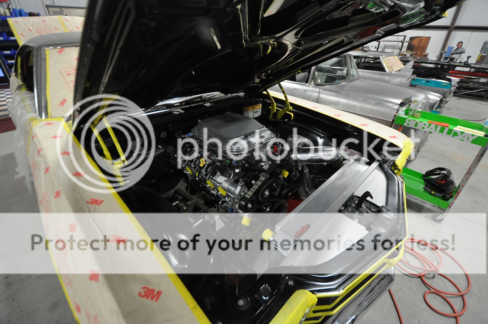

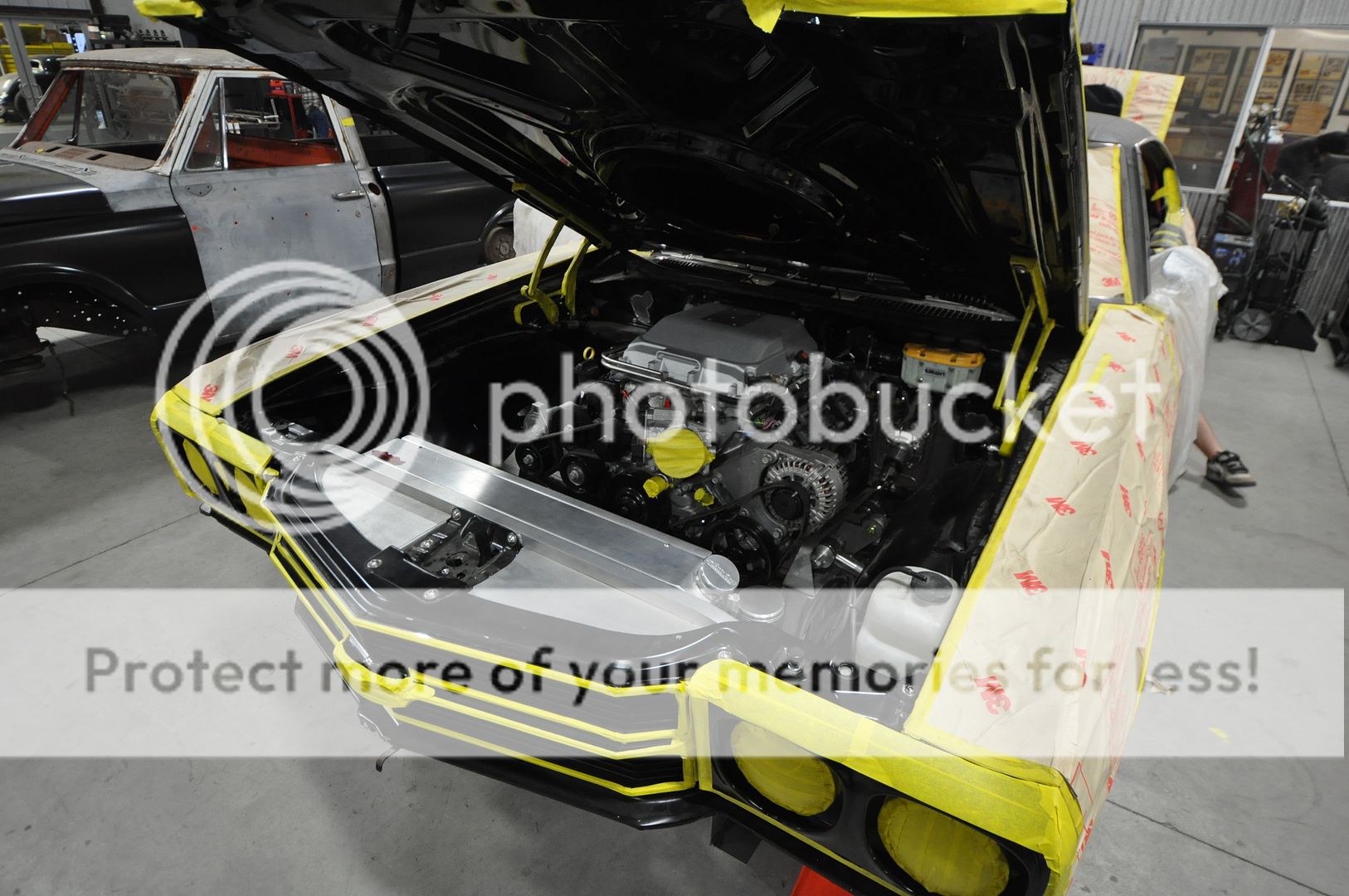

ironworks 12-05-2012 05:25 PM
More Details, Customer is flying in on Saturday for inspection.
http://i616.photobucket.com/albums/t...-6-2012007.jpg
http://i616.photobucket.com/albums/t...-6-2012006.jpg
Broc laying it down on the GMR rear axle housing.
http://i616.photobucket.com/albums/t...-6-2012005.jpg

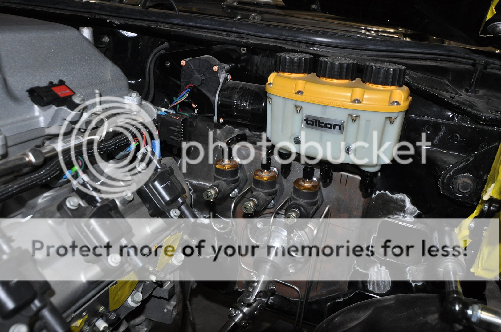

What is that tube just above the lower link mount?
ironworks 12-06-2012 07:04 AM
It's a threaded collar to hold the rear sway bar. I will post pics later of the sway bar installed on the axle housing.
T - Minus 2.5 days until the customer flys in to drive his LS9 57 Chevrolet home to Las Vegas on Saturday and do a visual inspection on the 70 Chevelle. Back to work.

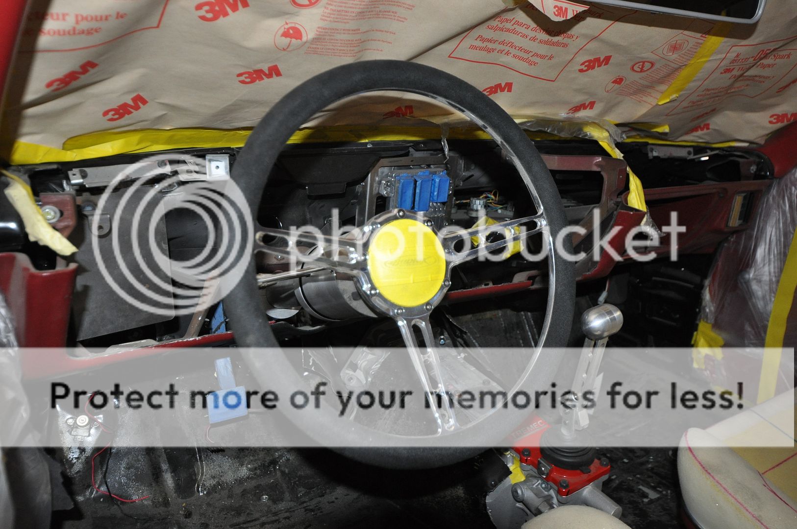

Swain 12-06-2012 11:05 AM
Nice Touch with that shifter and the Steering Wheel.

NOPANTS68 12-06-2012 05:05 PM
Man those lines you guys laid out under that Tilton unit are bitchin. I like the one that snakes around the column mount. I bet you guys could cnc something of a lid for that thing, but I don't see it being that big of an issue. Scuff it and shoot it matte black if need be. Cool build.
ironworks 12-06-2012 05:09 PM
That's the plan. We did the clear reservoir to be able check the fluid easy and not have to use a mirror and a flashlight to try and see inside to check fluid.
