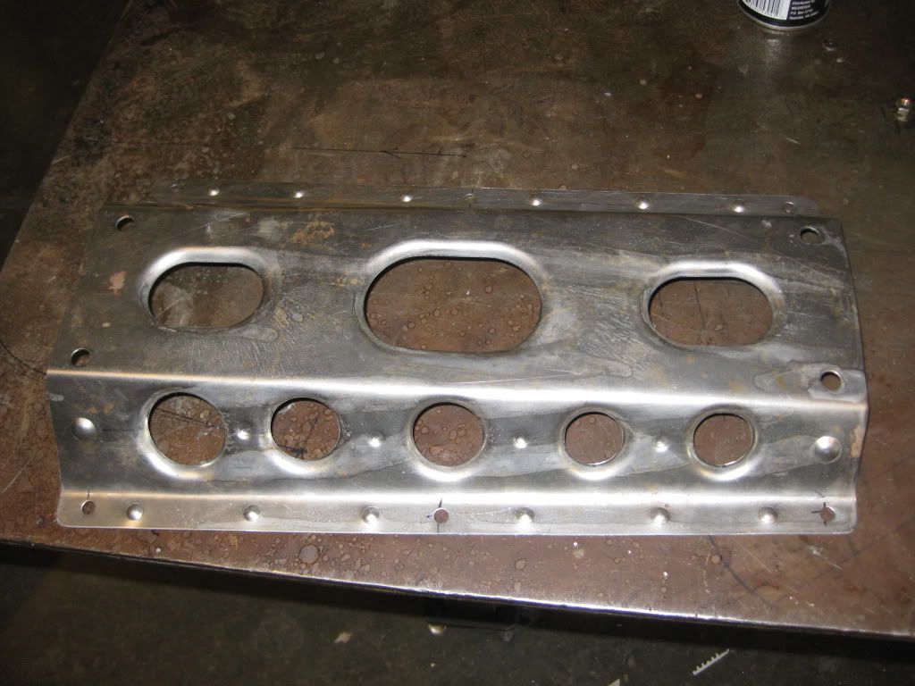

Tonight I spent some time and fabbed a Accusump mount using my new Tru-Oval punchs from Holohan's Hot Rod shop.I run out of time to get it DA'd smooth.Dinner time. http://i1104.photobucket.com/albums/...ps18c88524.jpg http://i1104.photobucket.com/albums/...ps8065b75e.jpghttp://i1104.photobucket.com/albums/...ps92aaed21.jpgGot the front sway bar arm's bent uphttp://i1104.photobucket.com/albums/...elleIII009.jpghttp://i1104.photobucket.com/albums/...elleIII008.jpghttp://i1104.photobucket.com/albums/...lebuild021.jpg
WSSix 09-19-2012 06:53 PM
Holy begeezzus do you have a press brake that can bend those arms or did you actually farm out a part to be worked on?
The accusump mount looks good. Where will it be mounted?

I bend all the sway bar arm's in house w/o heat.I am going mount the accusump in the trunk over the rear axle.

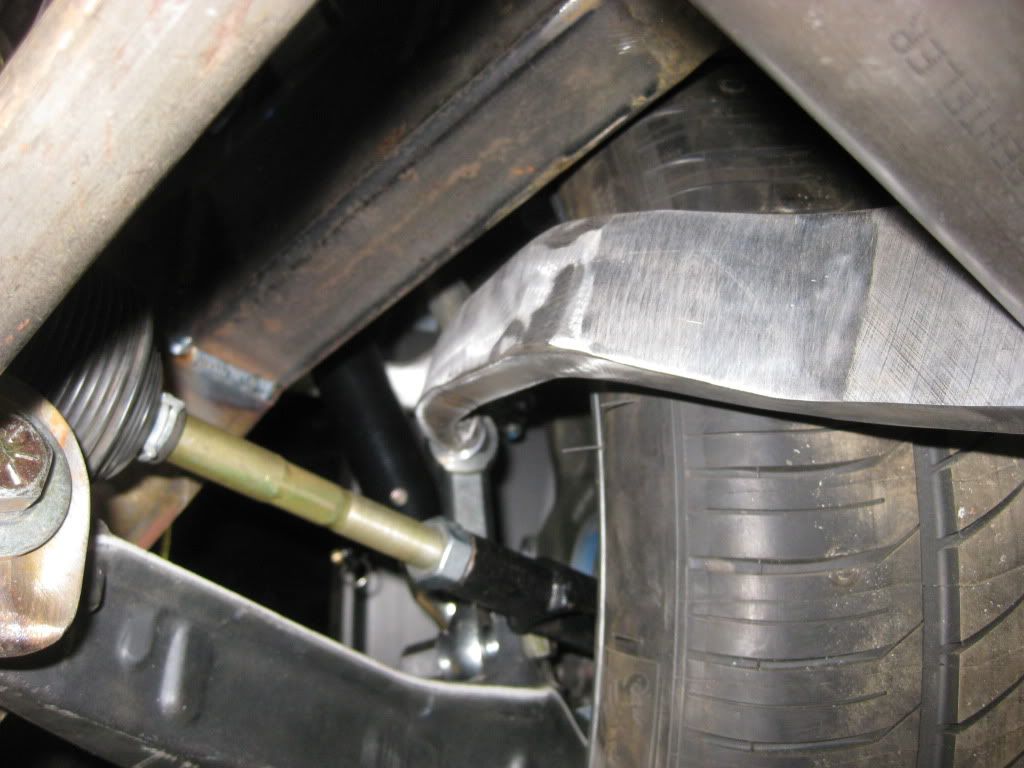

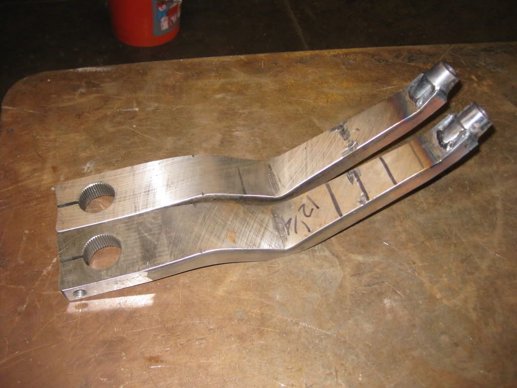

coolwelder62 09-22-2012 07:30 PM

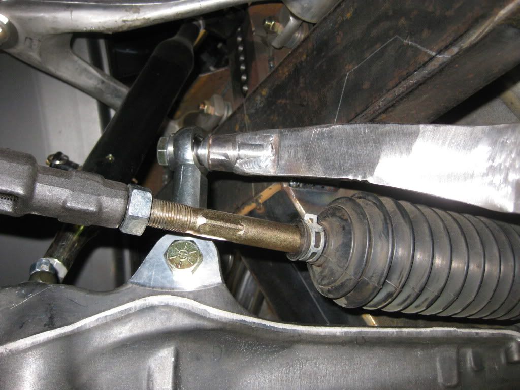

I desided to go with splined bar on the rear of the car also.http://i1104.photobucket.com/albums/...psae2674a1.jpghttp://i1104.photobucket.com/albums/...ps328b37d7.jpghttp://i1104.photobucket.com/albums/...ps561cda9d.jpgI also upgraded the frt. sway bar end link's from 1/2" to larger 5/8" rod end's and changed out the cone spacer's w/some misalinement bushing's.http://i1104.photobucket.com/albums/...ps4f7c4301.jpghttp://i1104.photobucket.com/albums/...ps665a0bc5.jpg
coolwelder62 09-22-2012 07:35 PM
I had some one ask me why is everything just tack welded. As I'm building I like to fit everything.Plus I alway's change my mind or get a new Idea.This way it is easy to go back and move thing's around.When I disasssem. it I will take it over to the bench and tig weld everything.

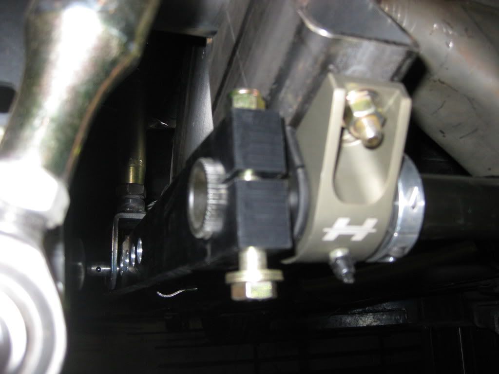

dave96dcm 09-29-2012 04:58 AM
Originally Posted by coolwelder62 (Post 437468)
Who makes that sway bar bushing mount? I don't recognize the logo, is it hotchkis?
coolwelder62 09-29-2012 07:09 AM
Those are hotchkis items.Around $125.00 pr.Stronger,an Look way better than stamped steel pcs.Plus last year I had a chance to meet John Hotchkis super cool dude.:thumbsup:
GregWeld 09-29-2012 07:15 AM
When I have odd shaped pieces like this with lots of sharp edges etc --- I run 'em thru the bead blaster... with the right grit - it will take out scratches and dulls the sharps right off there!
Then the part is ready for some etching primer... :woot:
coolwelder62 09-29-2012 07:25 AM
Greg,I was going to DA them first then glass bead them.I built this part over lunch the other day.I told Dan Holohan I would do something real quick to show his tru-oval punch's.Hoping to get some time over the next few month's to finish up and prep everything before it go's off to paint and powder coat.:thumbsup: :thumbsup:
WSSix 09-29-2012 07:58 PM
OK, I gotta know how the sway bar in the rear adjusts? I know by moving the end link but does it get tighter by having the end link back closer to the bar and looser as it moves away? The reason it works this way is because the bar can't twist as much with the end link closer in? Am I close?
coolwelder62 09-29-2012 08:53 PM
The longer the side arm the more leverage it has to twist the sway bar(That makes for a softer bar) .The shorter the arm the less leverage it has.(That makes for stiffer bar).The more ajustable the car is the easier it is to sort out.Soft rear bar tight car.Stiff rear bar loose car.So you are right.:thumbsup: :thumbsup:

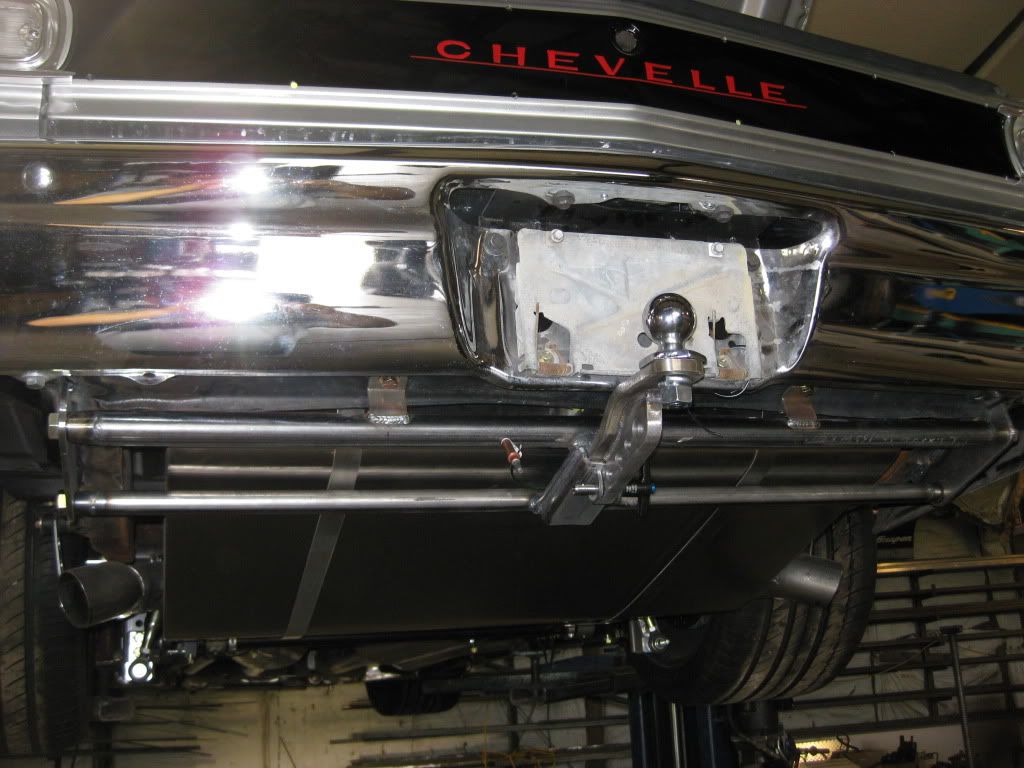

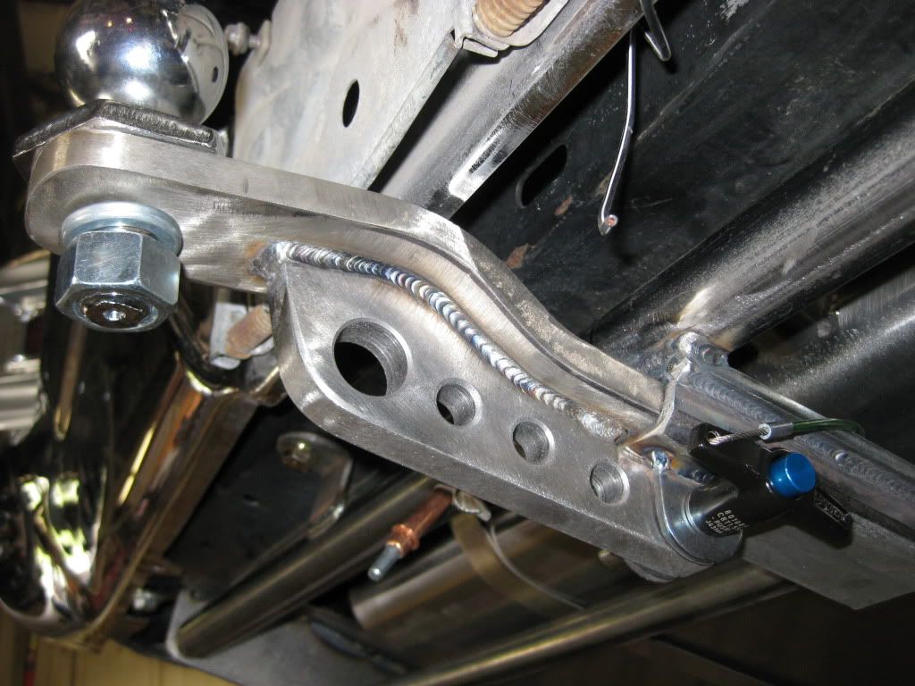

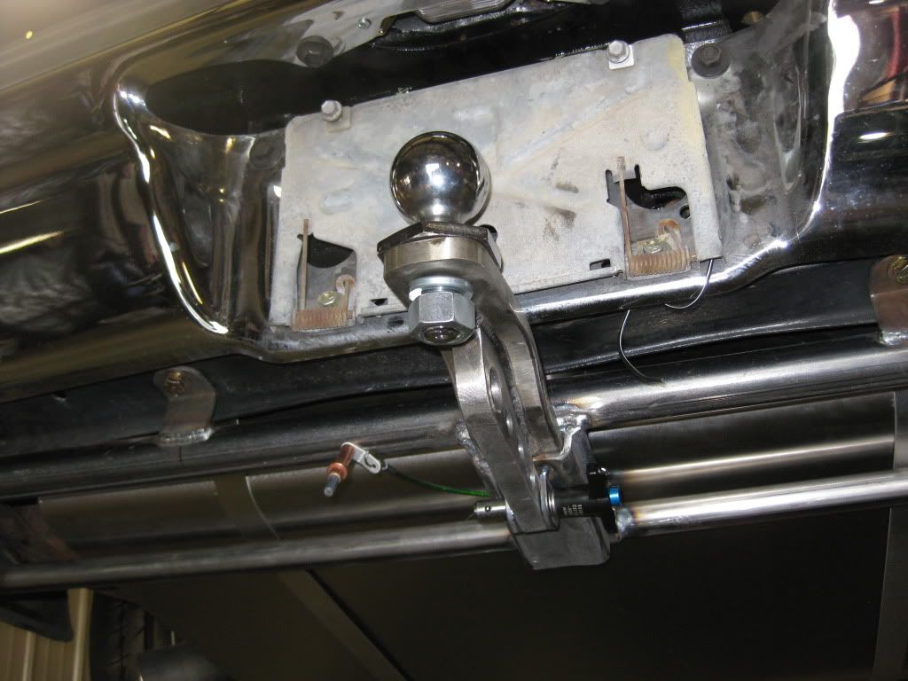

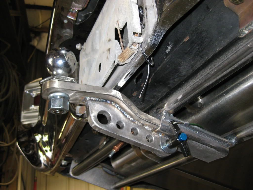

Well,I couldn't sleep last night so went to the shop I fabbed up a Trailer Hitch for the chevelle.The hitch will come off w/just 6 bolt's.Or I can remove the ball-mount W/a 1/2" pit-pin.http://i1104.photobucket.com/albums/...5/hitch004.jpg http://i1104.photobucket.com/albums/...5/hitch002.jpg http://i1104.photobucket.com/albums/...5/hitch003.jpghttp://i1104.photobucket.com/albums/...5/hitch008.jpghttp://i1104.photobucket.com/albums/...5/hitch007.jpgNow I am sleepy time for a nap.
wellis77 09-30-2012 01:01 PM
I like that design. How much or what do you plan to pull with that?
coolwelder62 09-30-2012 01:25 PM
Going to build a little alum. trailer 4'wide x5' long out of 3x3x1/4 alum angle,single 2000#axle.It will have 2 Alum. tool box's 24'w x60"L x18" h.That way I can haul our Tool's,Jack,jack stand's,Cooler,nitorgen bottle,EZ-up,Folding Chair's,Spare set of race slick's for GG's auto cross.And of course the most important thing of all(BAR-B-Q GRILL).
