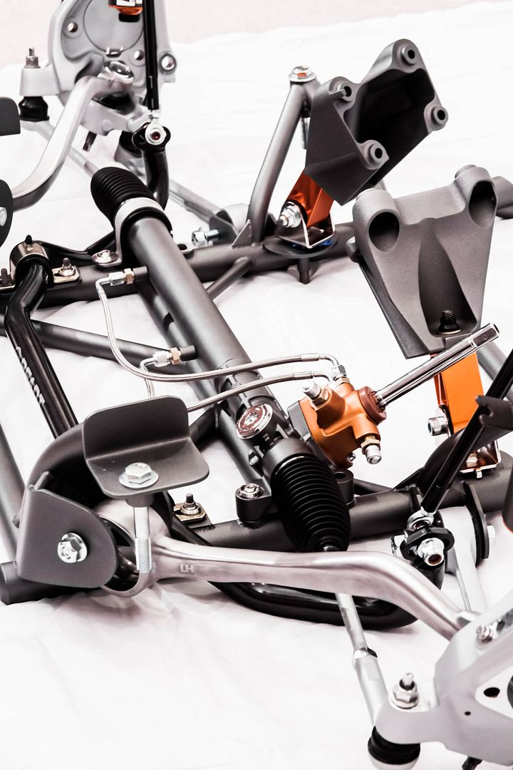

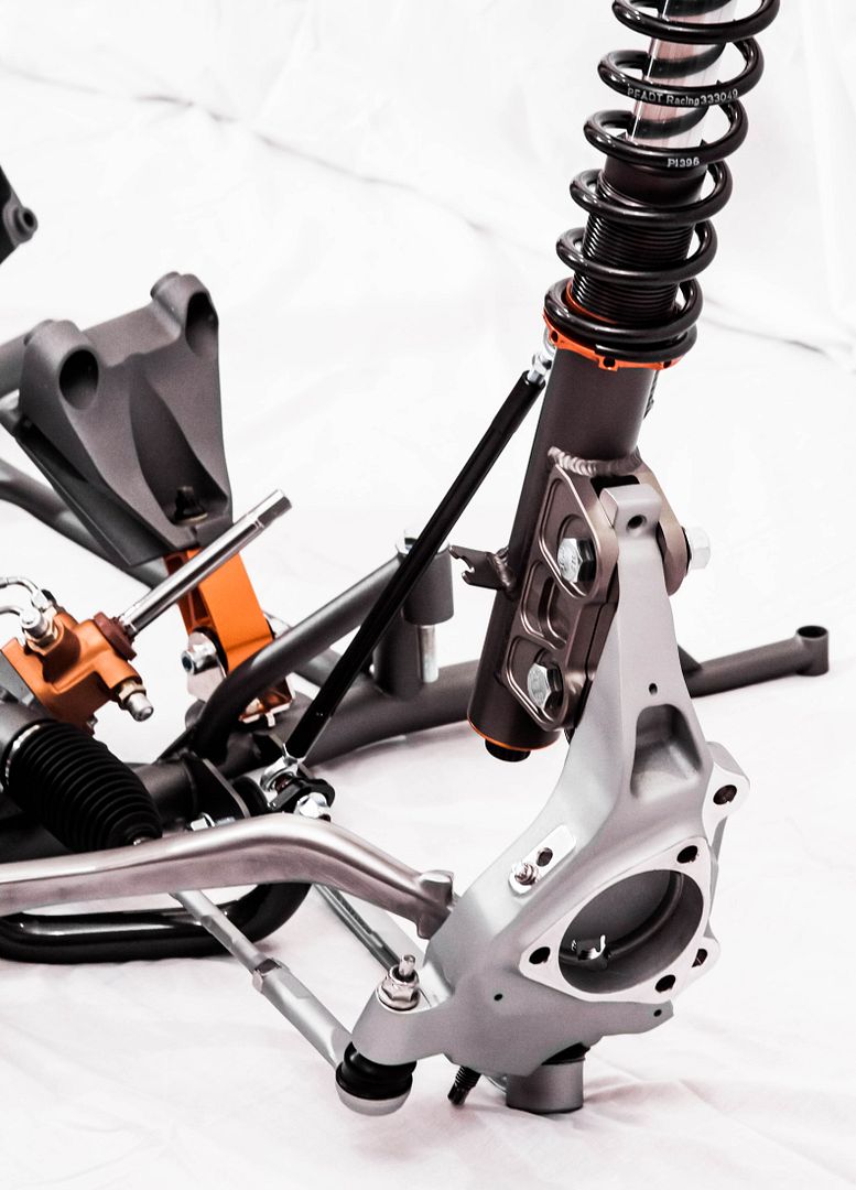

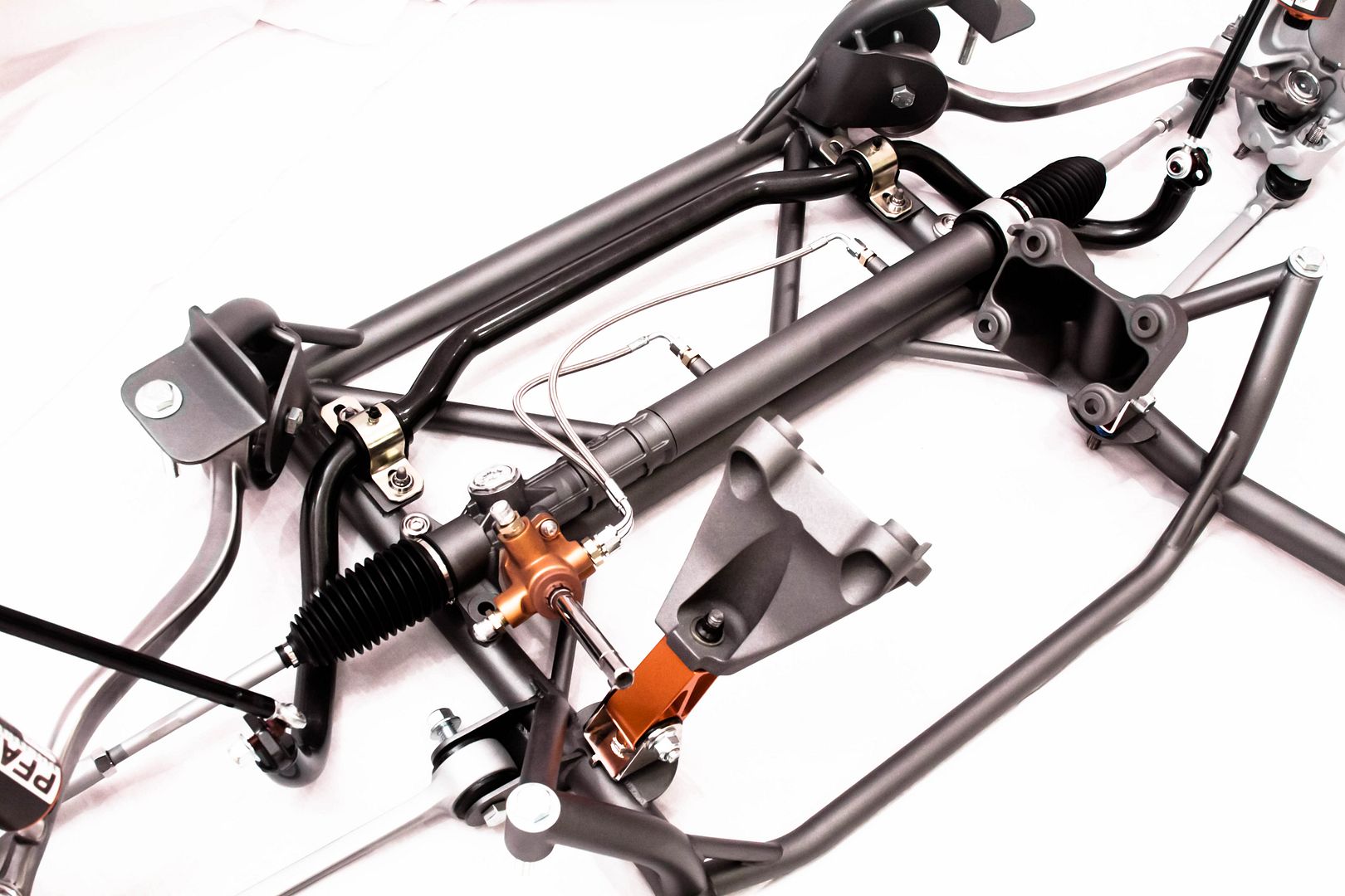

Here are a couple of pics of the front sub mocked up.
http://i1231.photobucket.com/albums/...pse4e84712.jpg
http://i1231.photobucket.com/albums/...psf05c0b13.jpg
http://i1231.photobucket.com/albums/...ps282a7ee3.jpg

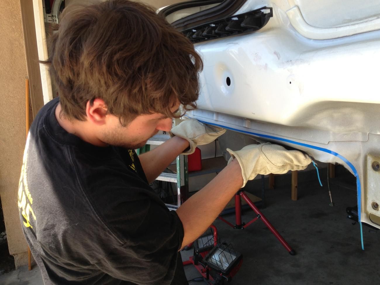

I am replacing the SS rear lower control arms with the updated ZL1s. This will allow me to run Pfadt Racing new ZL1 bars. While I'm waiting for the bars, I felt the GM arms just weren't up to par.
You can see in this picture where the lines are all jagged. I used the blue pin striping tape to outline the amount being removed.
You can see it was also covered with splatter.
And had these machine markings on the sides.
Well, after some sanding and some more sanding, we got them smooth.
Here's a quick comparison of before and after. You can see it's now more symmetrical.

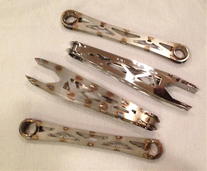

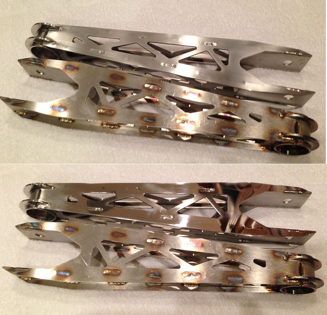

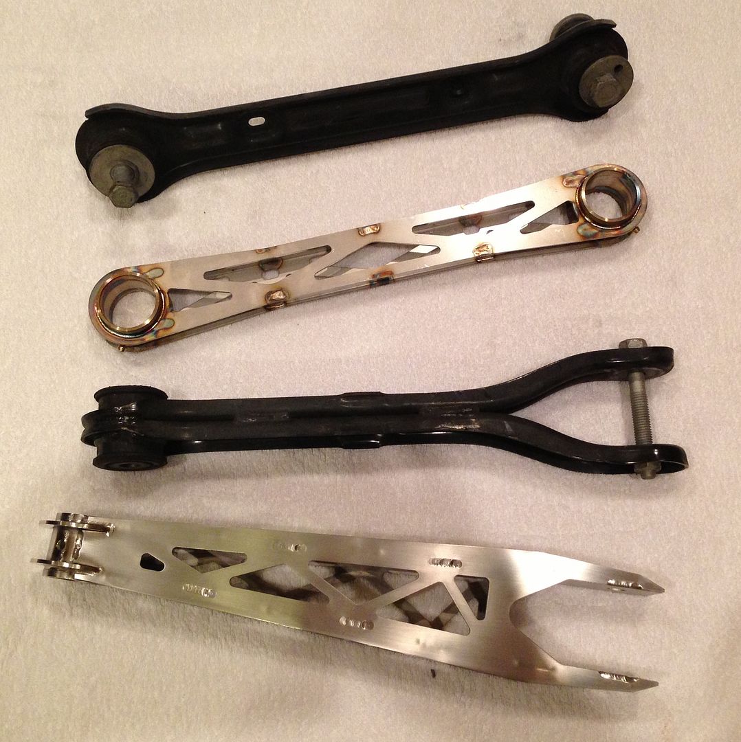

Perhaps the fabricators on here can help me with this one.
This is the rear trailing arms package I will be using from Pfadt Racing.
I was toying with the idea of making some cut outs on the control arms to replicate the Pfadt pieces. I did this quick deal to get an idea.
My concern is I don't want to weaken them to where they will flex. One idea is to box them or perhaps create filler pieces for the cut out. Any suggestion would be greatly appreciated!
What you can do is have an over lay piece with the shape and designs laser cut into it then weld these pieces to the existing uncut arms. You can even inlay carbon fiber into the recessed areas. Similar to this bell crank we did.
Might be time consuming to do. Also increase the weight of the part.

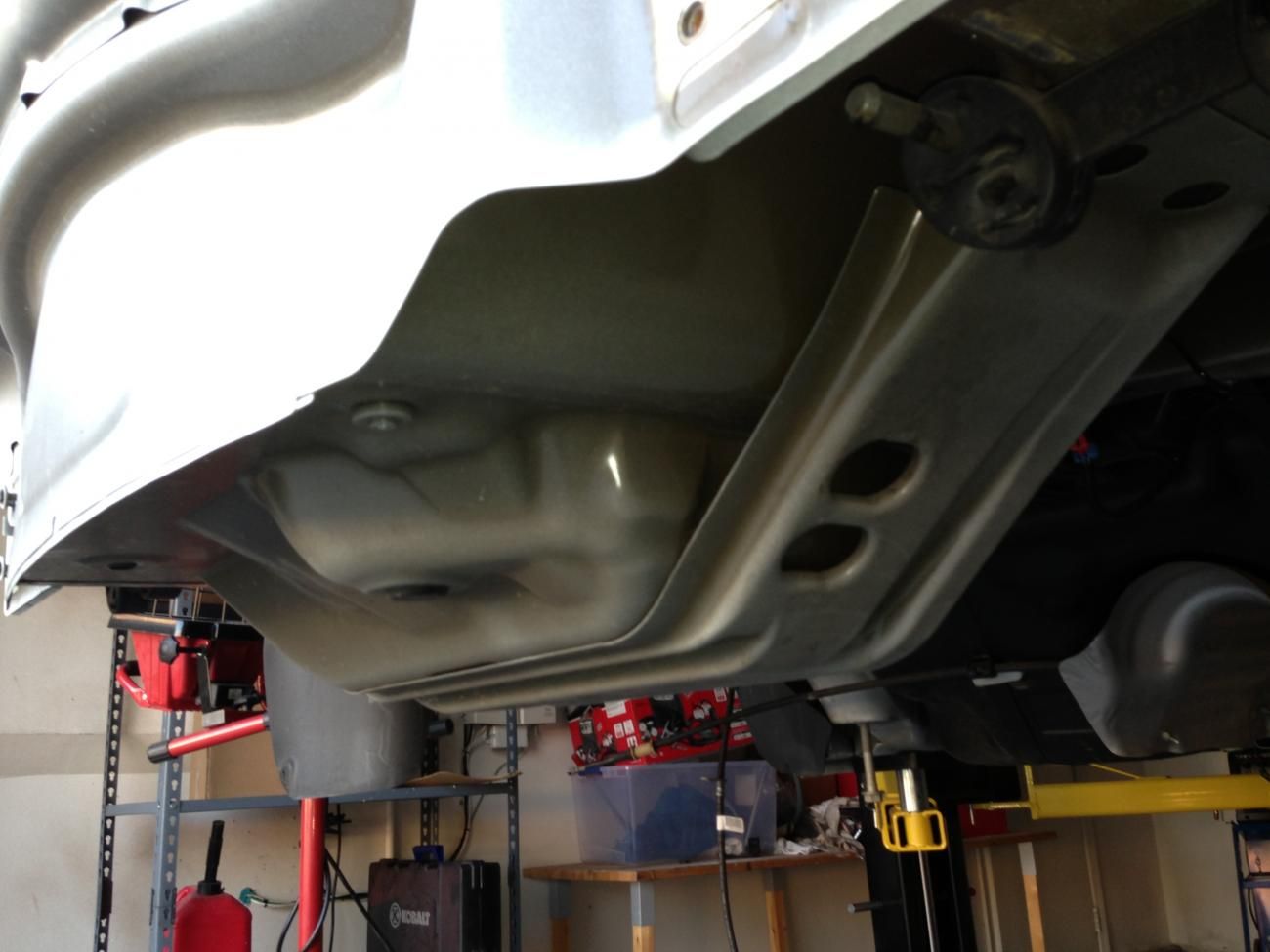

fleet 03-13-2013 05:07 AM
Originally Posted by Ron in SoCal (Post 470181)
Your whole family is sick :hail:
:lol:
"In unity there is strength." :unibrow:
214Chevy 03-13-2013 05:20 AM
That is not a subframe. What I would call that is art!! :trophy-1302: :trophy-1302:
GregWeld 03-13-2013 05:57 AM
I think this is a Ridler contender..... Well.... it might be if it wasn't a late model.
AL --- Is this YOUR car?? I don't remember the beginning details and am too lazy to run back through the thread.
The textures - the color changes - the detail - is just over the top Kool.

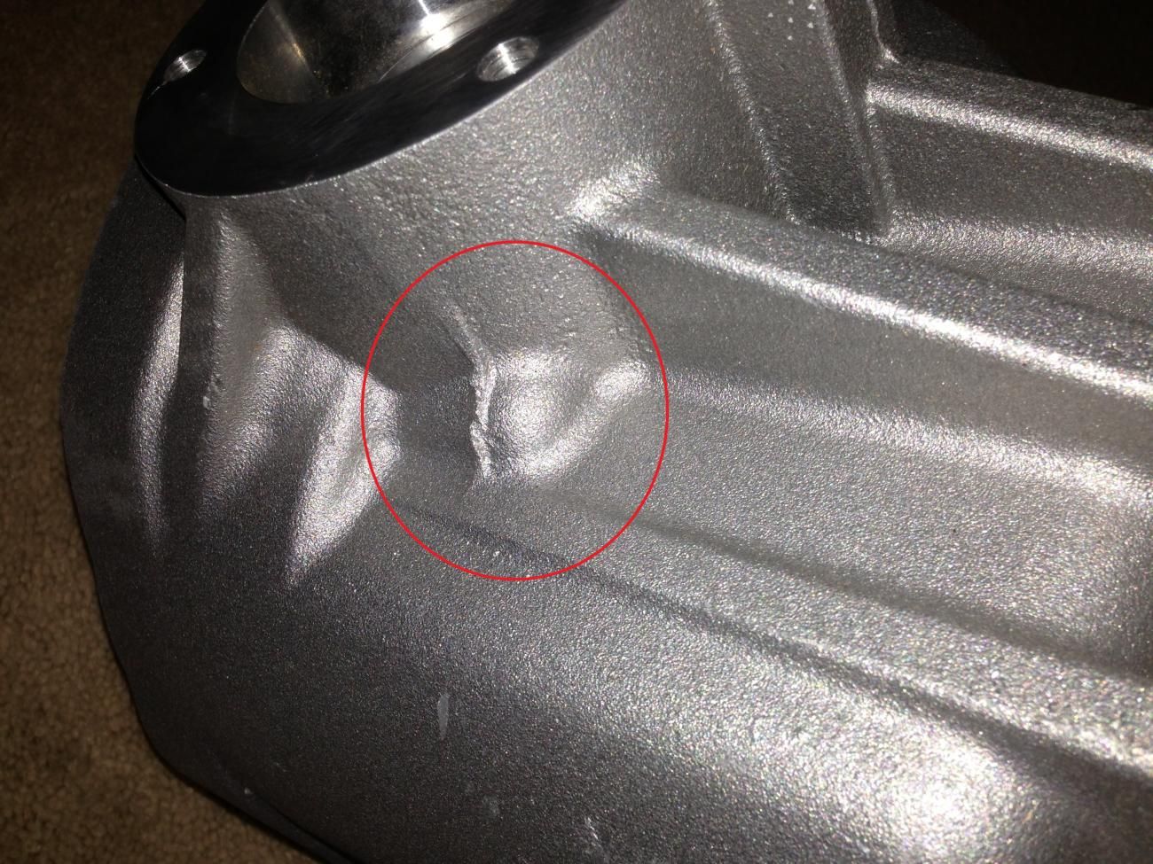

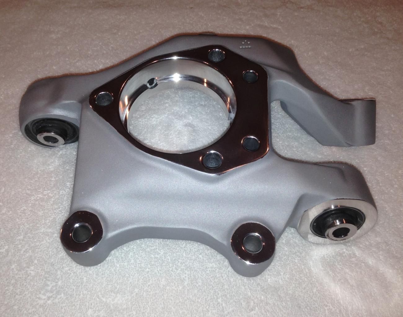

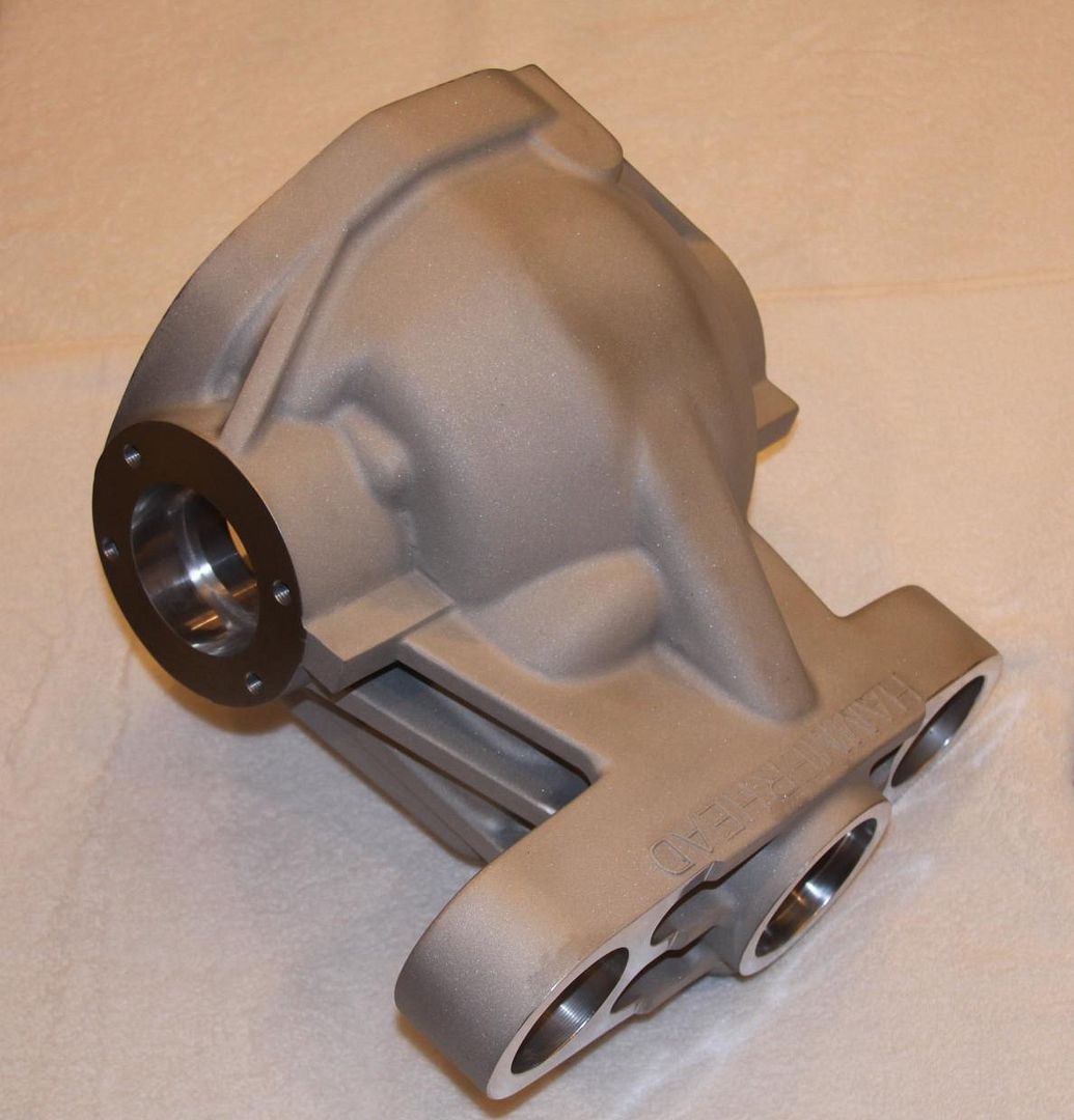

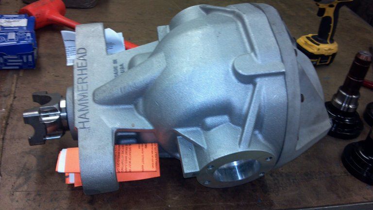

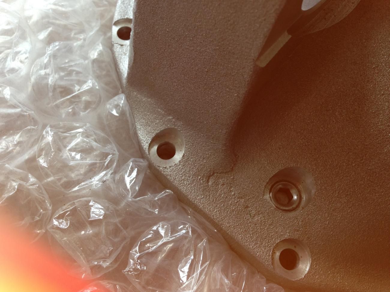

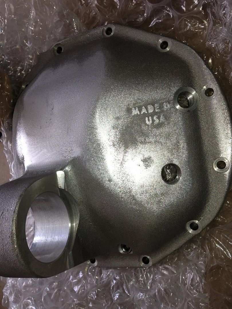

Pick up a new Hammerhead from DSS. This is a bullet proof piece as it will handle 1,400 HP.
http://i1231.photobucket.com/albums/...ps6473cf72.jpg
But as you can see the casting is really rough.
http://i1231.photobucket.com/albums/...ps895d4f73.jpg
http://i1231.photobucket.com/albums/...ps811da130.jpg

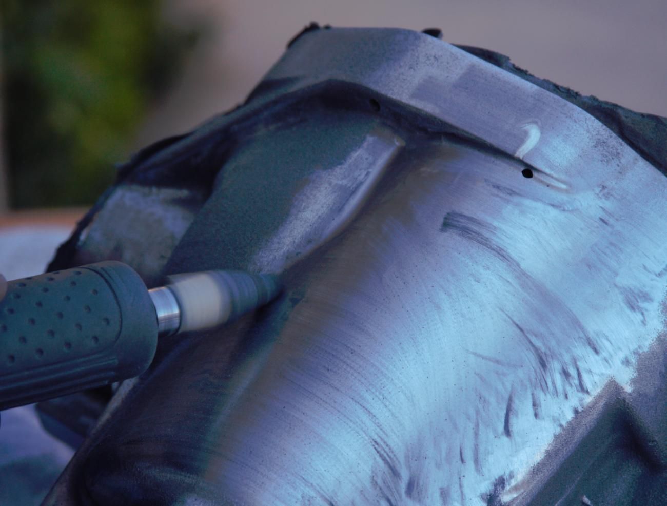

So the boys went at it.
http://i1231.photobucket.com/albums/...ps3d96722f.jpg
Once it was completely smooth, it was blasted.
http://i1231.photobucket.com/albums/...ps63351014.jpg

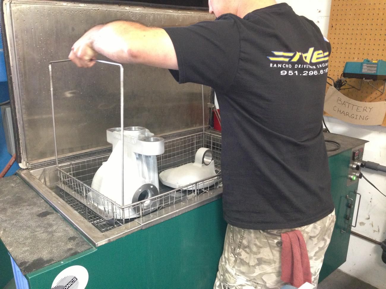

Next it was ultrasonically clean to make sure there no left over residue.
http://i1231.photobucket.com/albums/...psb9459c47.jpg
Finaly product.
http://i1231.photobucket.com/albums/...ps6e6daf8b.jpg

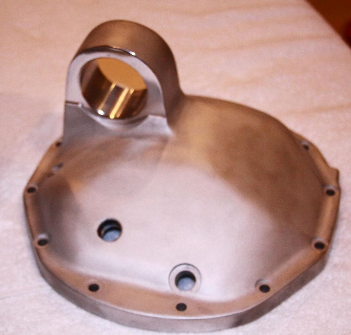

The lid got the same treatment.
http://i1231.photobucket.com/albums/...ps52bd9879.jpg
The section were the bushing mount were polishing for some contrast. The piece was powder coated texture black (sorry no pics).
http://i1231.photobucket.com/albums/...ps7854e344.jpg
Waiting on ARP stubs to reassemble.

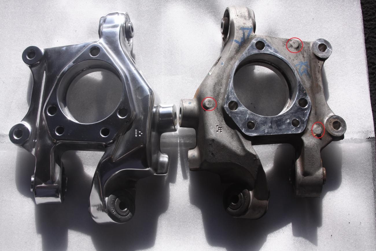

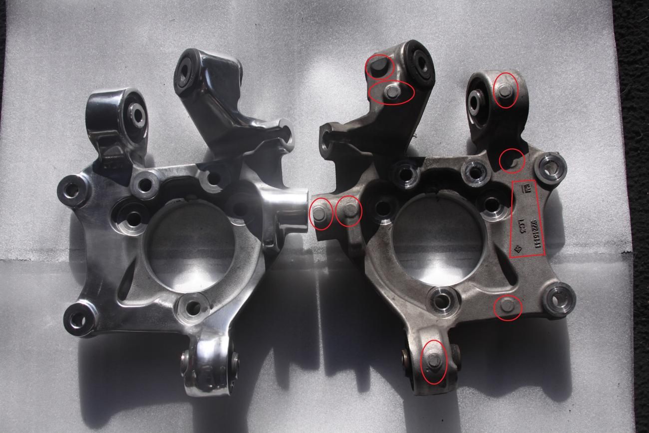

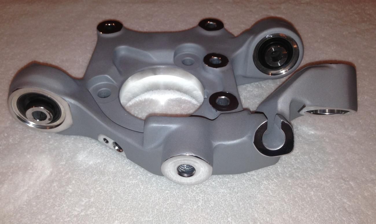

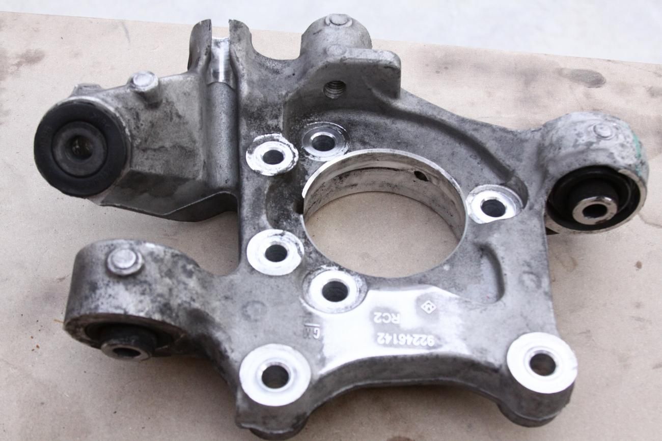

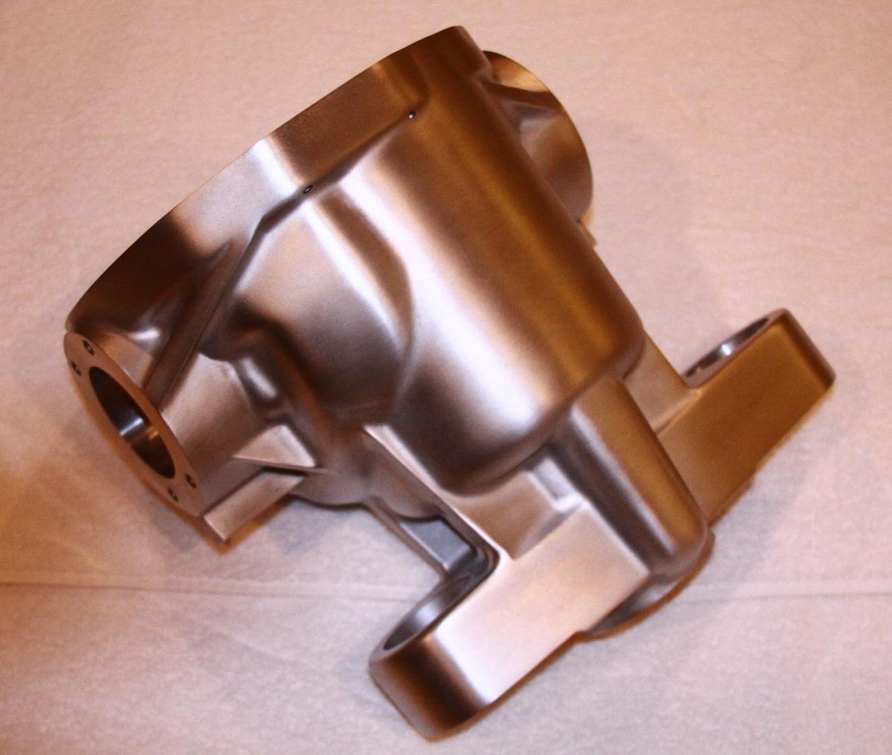

Here are a few pics of the rear spindles.
Before
http://i1231.photobucket.com/albums/...ps448d912e.jpg
The red circles represent all the bumps that were removed.
http://i1231.photobucket.com/albums/...psd4a2e937.jpg
http://i1231.photobucket.com/albums/...ps0ff0f5bb.jpg
http://i1231.photobucket.com/albums/...psa05ee385.jpg
http://i1231.photobucket.com/albums/...ps10481e58.jpg
http://i1231.photobucket.com/albums/...psaff307a9.jpg

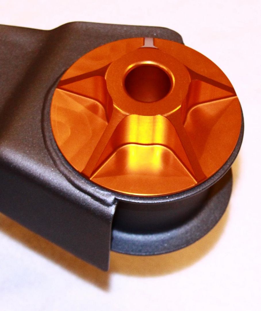

Sneak peek of the rear sub. All the bushing were replace with anodize solid pieces.
http://i1231.photobucket.com/albums/...ps5475bc28.jpg

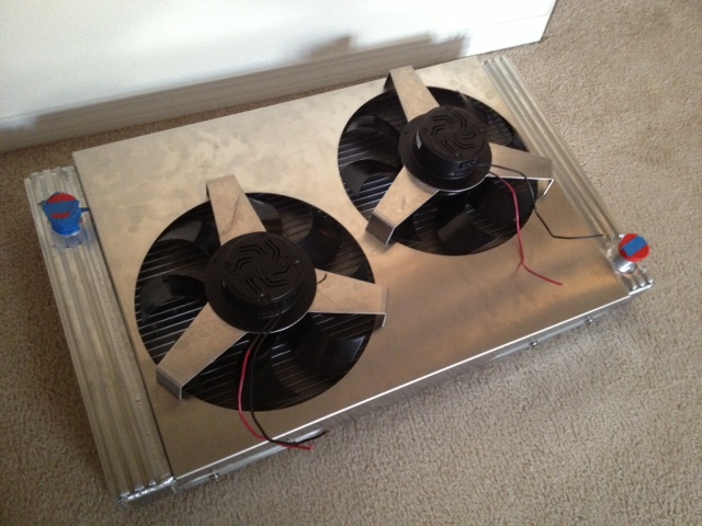

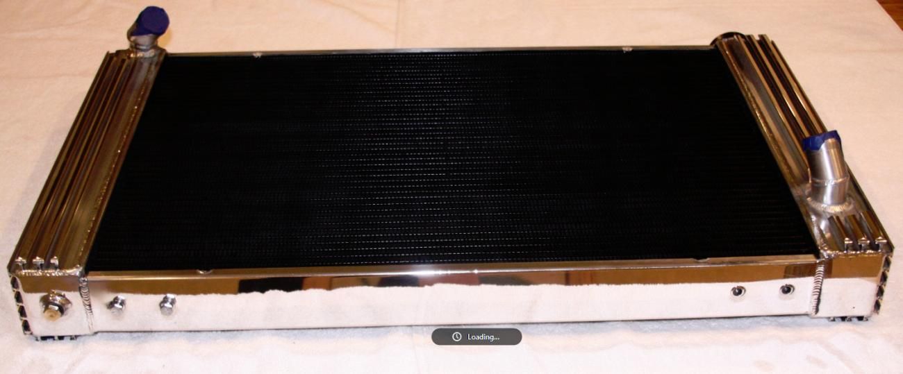

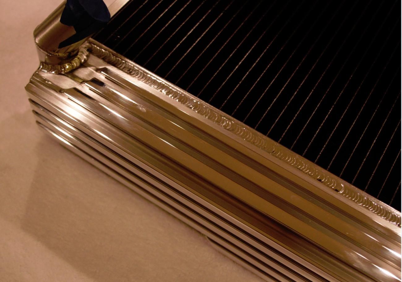

This is a Flex-a-lite radiator for Gen 5 that was going to go in the car but decide to sell and have a new radiator custom made because new radiator will be tuck under the core were you wont see it. Before selling this one, the boys decided to give it a little love. They painted the radiator black and polished the fins on the tanks and brushed between each one.
http://i1231.photobucket.com/albums/...ps0d59097a.jpg
http://i1231.photobucket.com/albums/...ps5199e48f.jpg

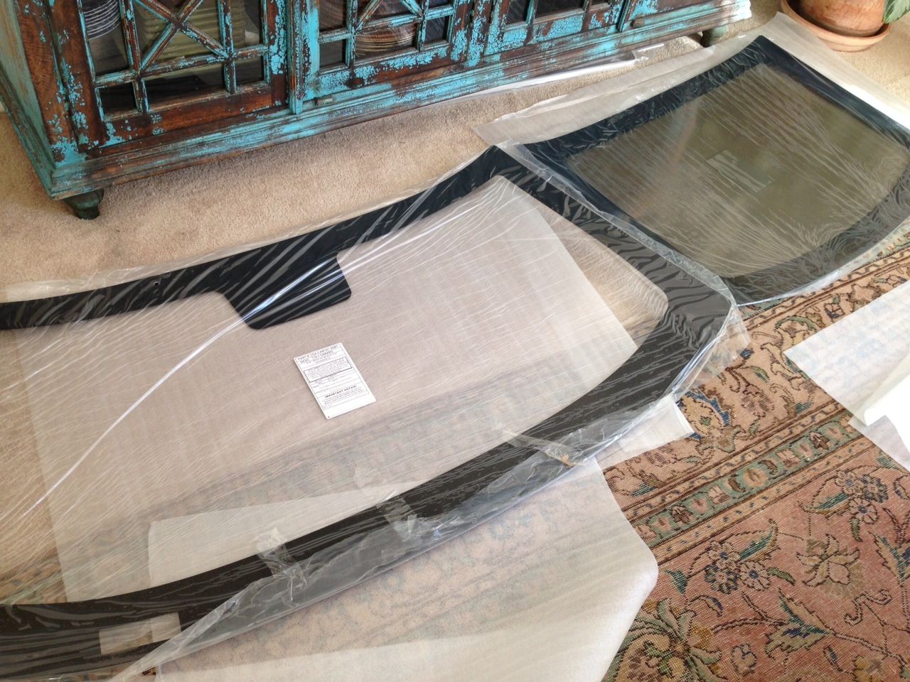

Just received all new replacement glass from Optic Armor. This is really neat stuff as its 50% lighter than OEM and 250% stronger. I didn't realize that this is the same stuff Ring Brothers use on some of their build. The other benefit is that your losing the weight from the top lowering the center of gravity.
http://i1231.photobucket.com/albums/...pse989f49e.jpg

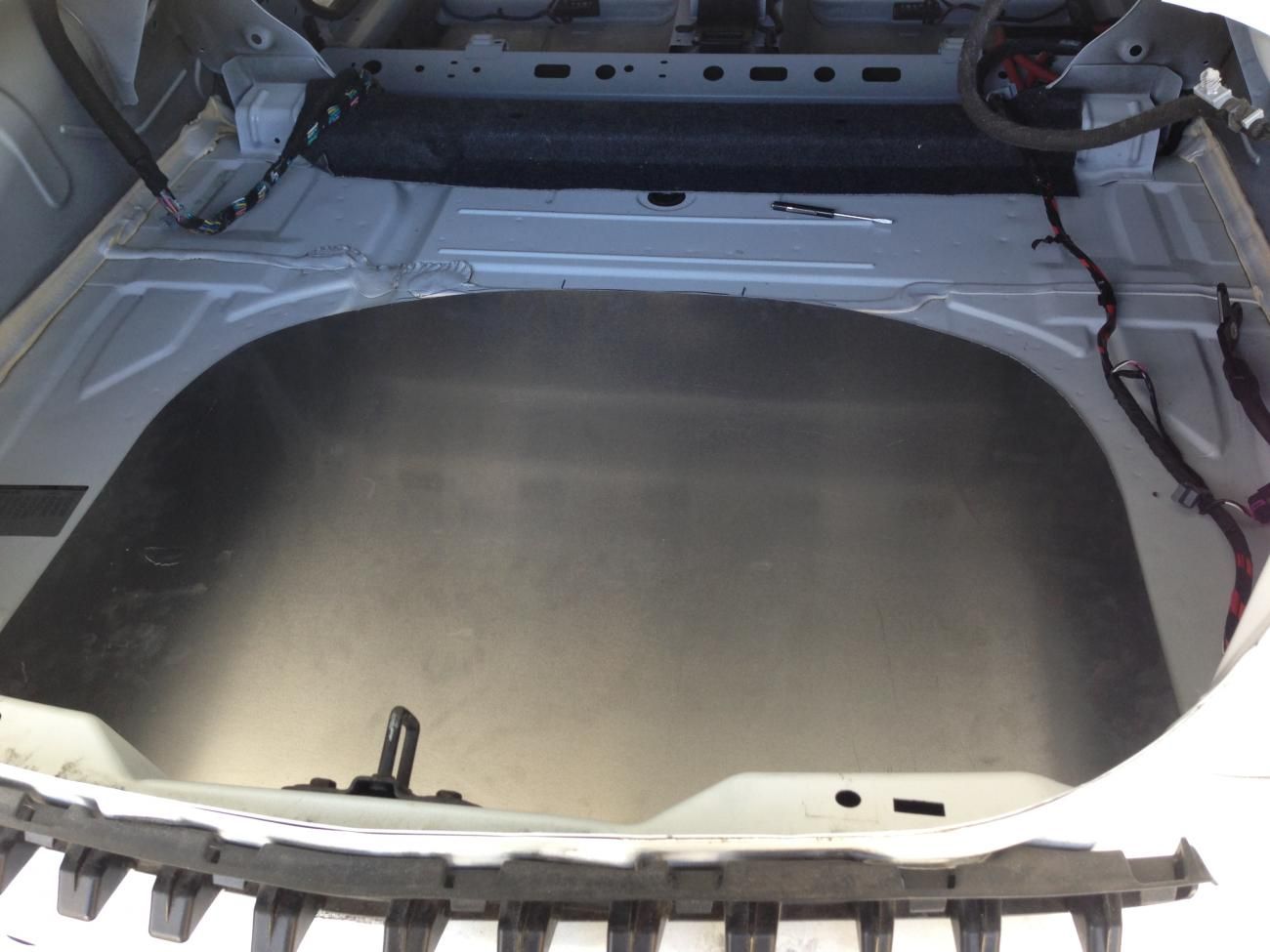

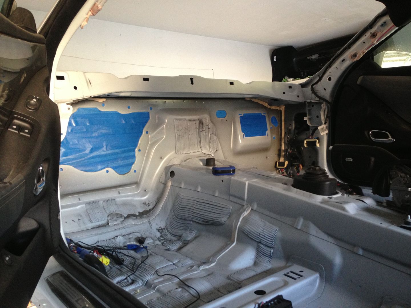

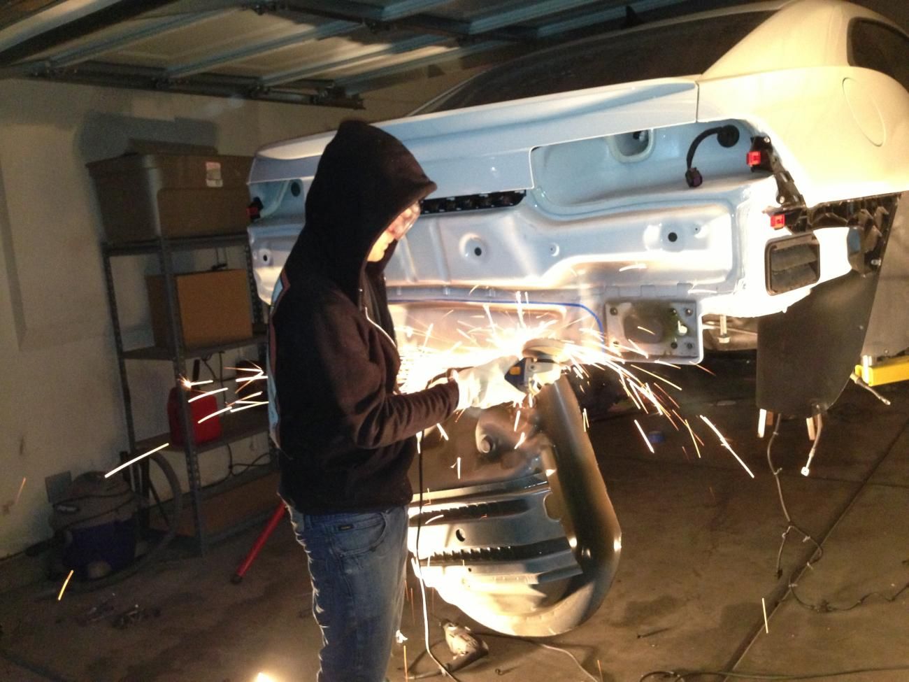

The boys have been working hard at getting rid of as much weight as possible. The goal is now 500 lbs which will bring the car into the 3,300 lbs range with 650 HP should make for a fun ride.

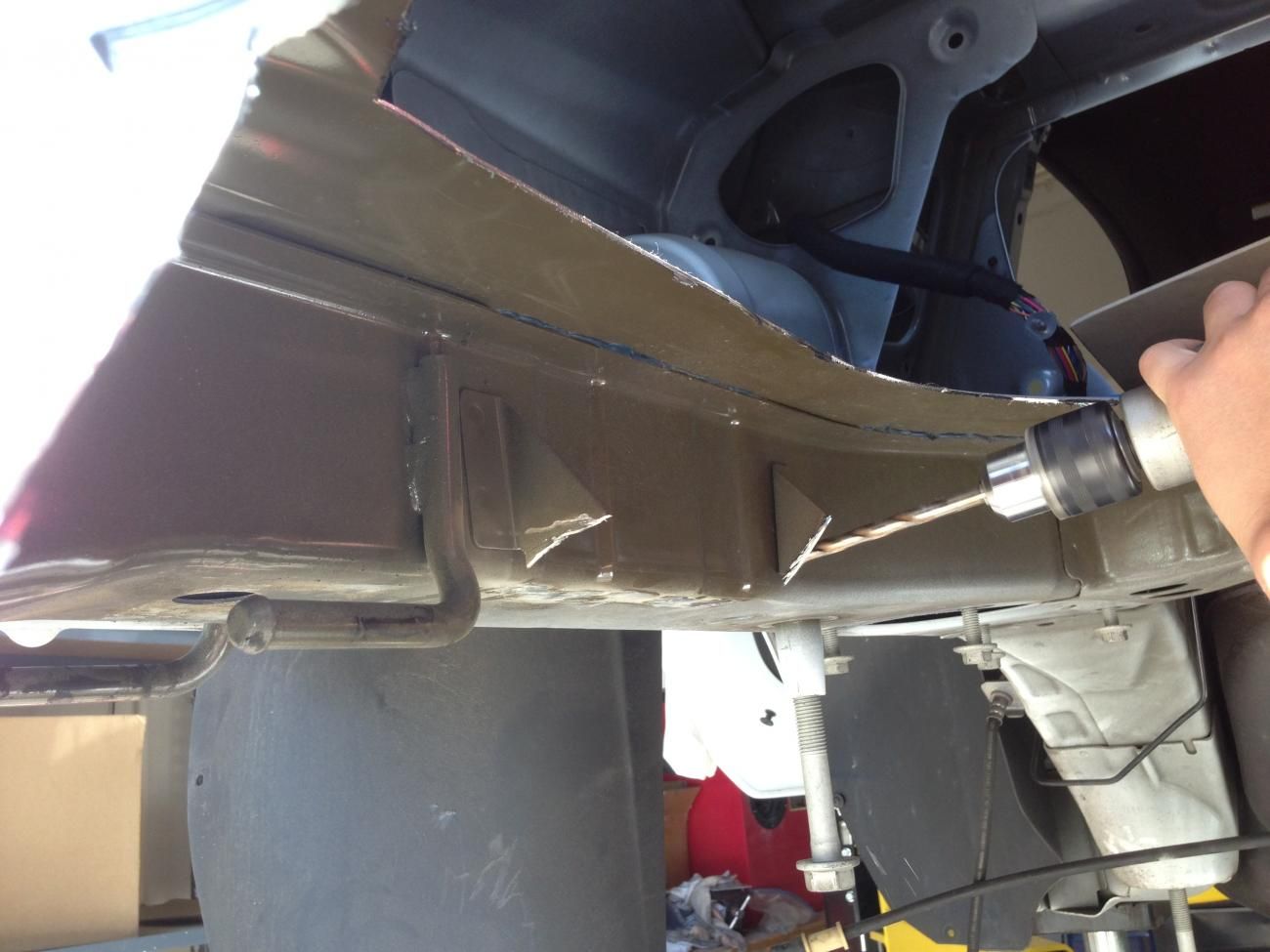

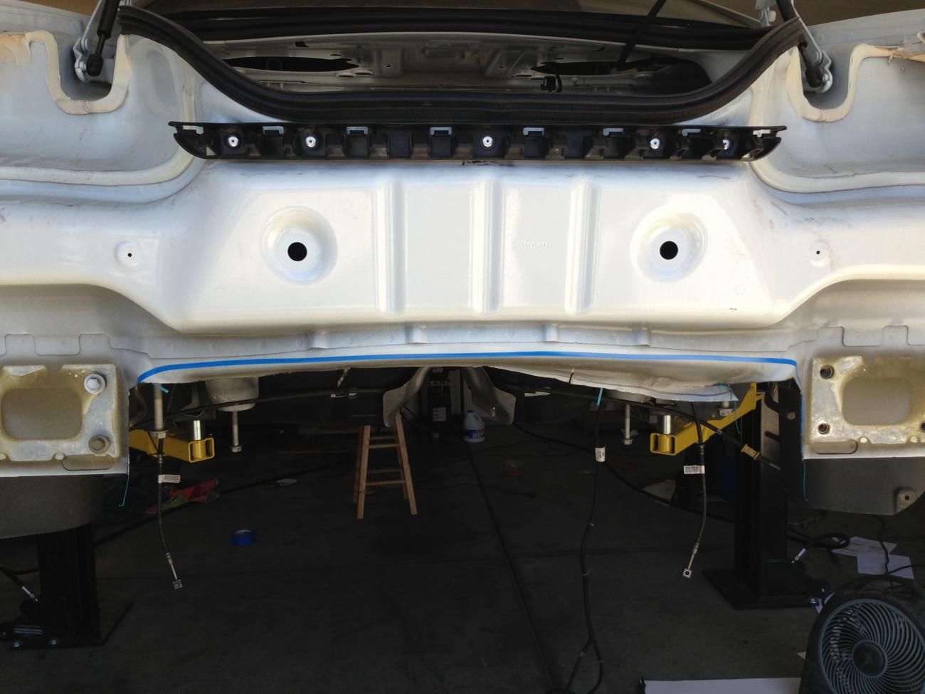

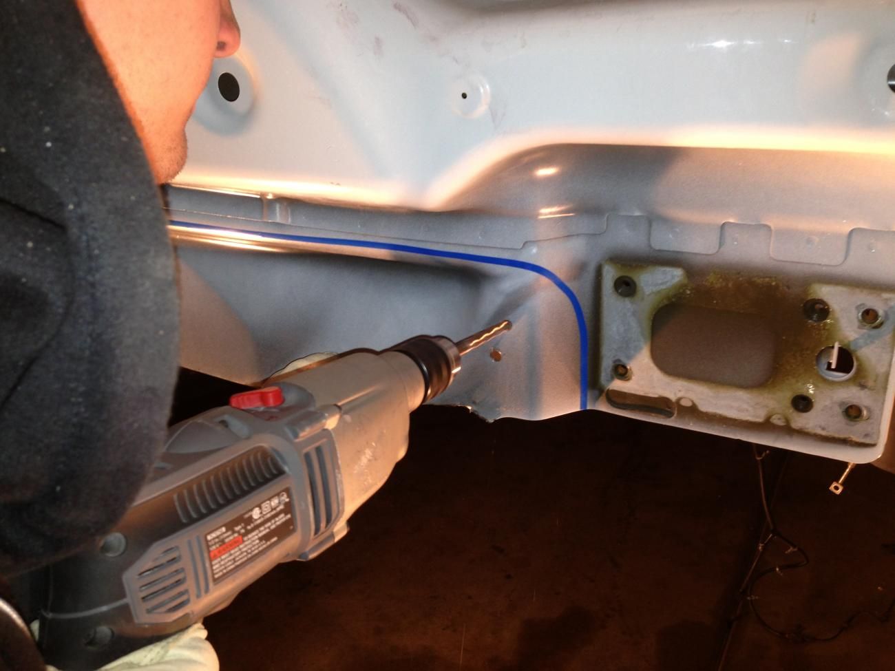

They were cutting out the bath tub in the trunk this last weekend to create a flat floor.
http://i1231.photobucket.com/albums/...ps1963c5c9.jpg
http://i1231.photobucket.com/albums/...ps66215abb.jpg
http://i1231.photobucket.com/albums/...psdb9b36b9.jpg
http://i1231.photobucket.com/albums/...ps6fcaca48.jpg
http://i1231.photobucket.com/albums/...psc728378a.jpg
http://i1231.photobucket.com/albums/...ps578b49e4.jpg
http://i1231.photobucket.com/albums/...psa71b1f15.jpg

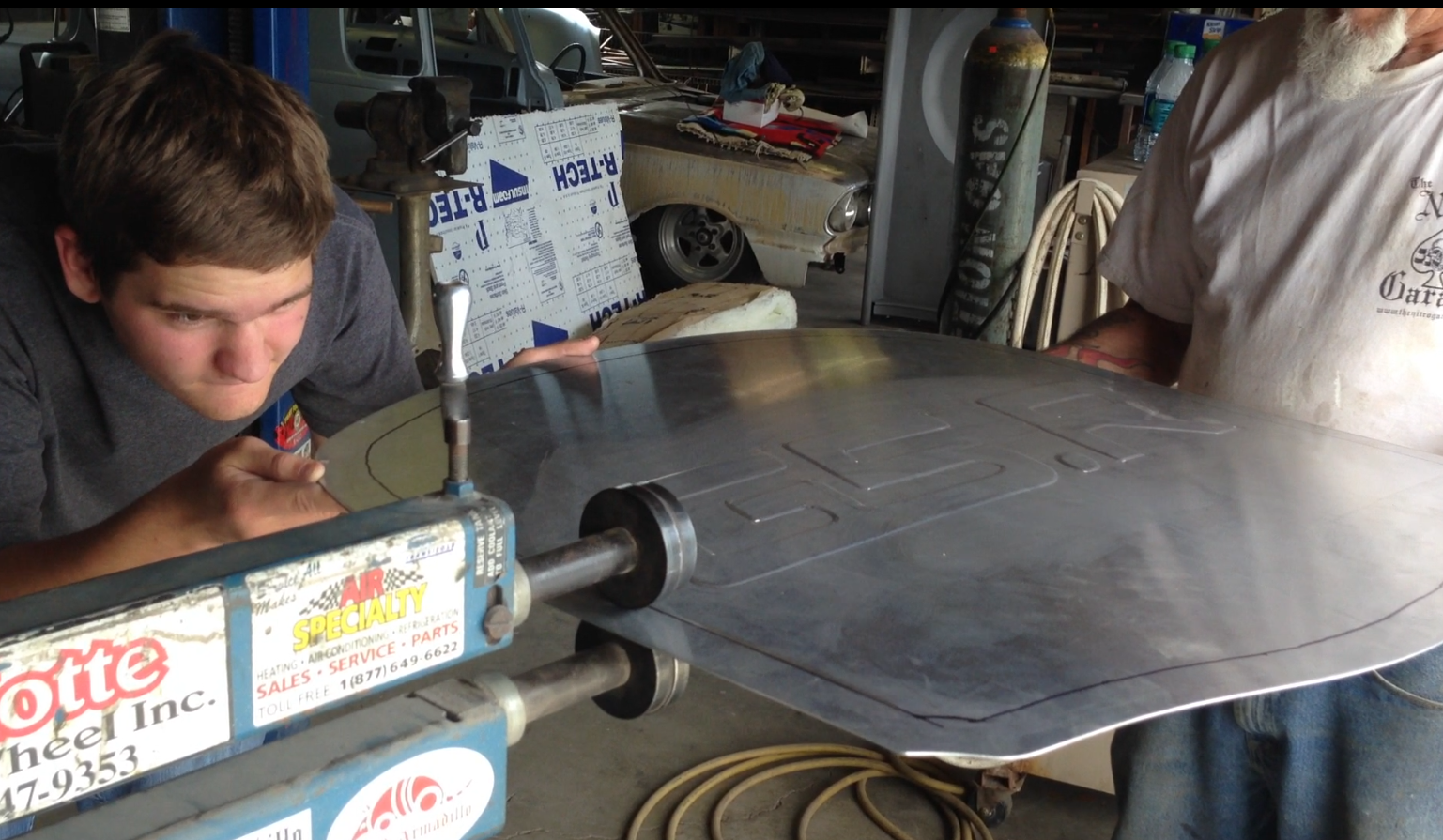

On the trunk pan, they are going to bead roll the logo G5.R
http://i1231.photobucket.com/albums/...psaf0632a9.jpg

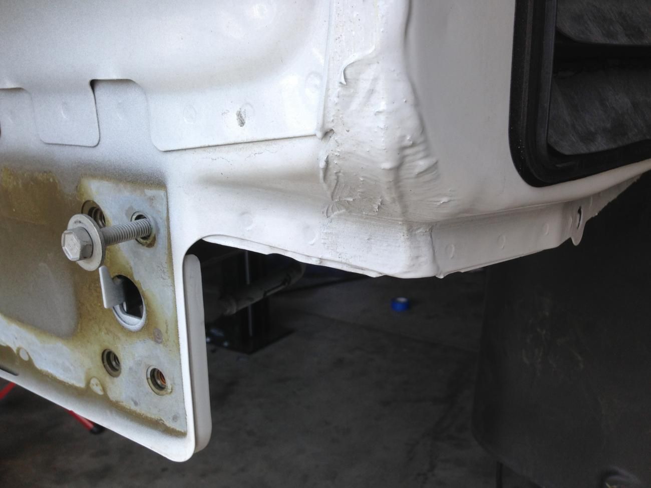

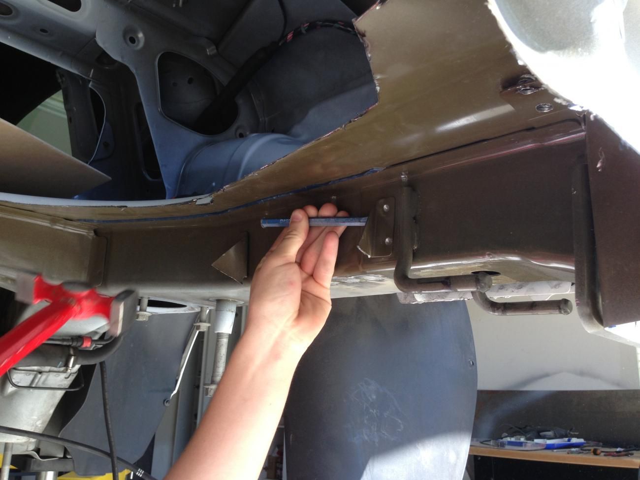

They are even cleaning out all the pinch welds.
http://i1231.photobucket.com/albums/...ps8479d90d.jpg
Much better.
http://i1231.photobucket.com/albums/...psacf3fbe8.jpg
Here where the interior is at this moment. All the wiring is being rerouted inside.
http://i1231.photobucket.com/albums/...ps20009c95.jpg
The neatest part for me is that they have never done any of this before, it's all completely self taught!

The plans is to powder coat the pa text black but giving the letters a brush aluminum finish. Should look cool.
He concentrate better when he bites his lips, LOL.

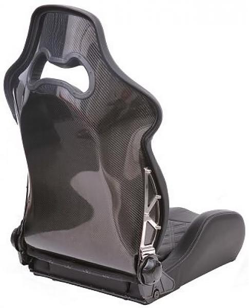

In the spirit of ridding as much weight as possible, the rear seat will be deleted and the two front seats are being replace with Cobra's Misano edition. These are only 24 lbs vs OEM are about 100 combined. Cobra will be embroidering the G5.R logo on the seats.
Attachment 39592
Attachment 39593
Have a bunch of killer update, as I get time I will post what they are doing.

Amituk 05-31-2013 12:20 AM
I love those seats..
I was considering them for my own project too

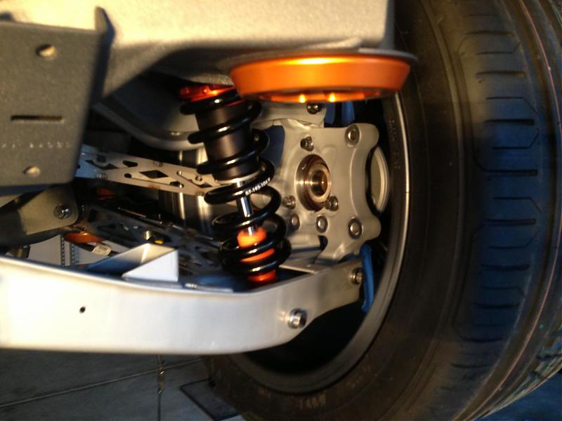

Here is an update from my son Justin

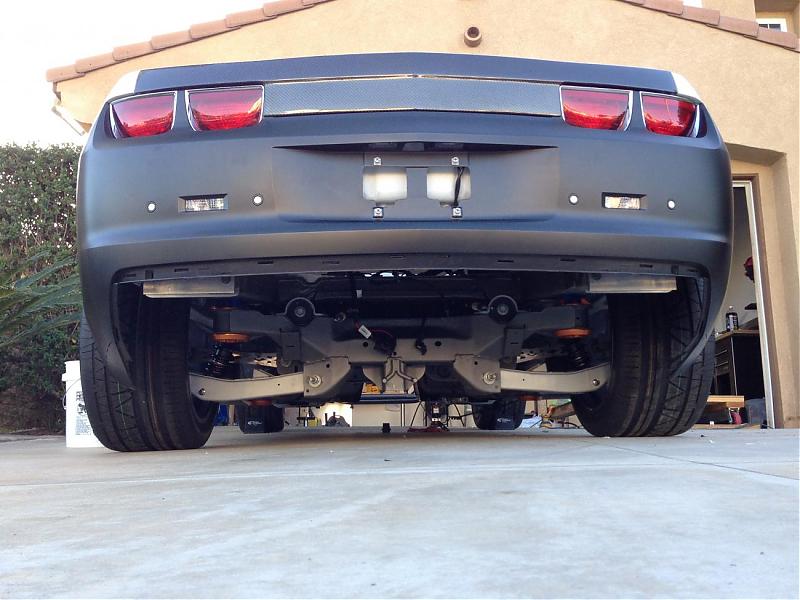

Pfadt Trailing Arms and Tie rods came in a few days ago. Man they look good in their raw form. looks very racey and mechanical.

We almost decided to keep them like that. But to keep with the theme, we started monkeying with them. I took a pic of them side by side, polished and brushed. We both agreed that we like the brushed look better.
http://i1231.photobucket.com/albums/...ps04557543.jpg
Here is a pic of the new custom flex-a-lite radiator with our custom fan shroud mounted on it.
Attachment 39612
the first fan shroud we made had some incorrect measurements. Made another one, and measurements were still wrong .... As the saying goes, third times a charm, and thus the third shroud finally fits perfectly. On Monday I'll get the fan mounts welded to the shroud, and call it done for now. we need to test fit it in the engine bay to make a bracket for the rad to mount to. Once that's done, we'll powder-coat the shroud.
Rick D 06-01-2013 04:45 AM
Man Al your not kidding those arms do look racy for sure, and I would agree on the brushed look for sure!!

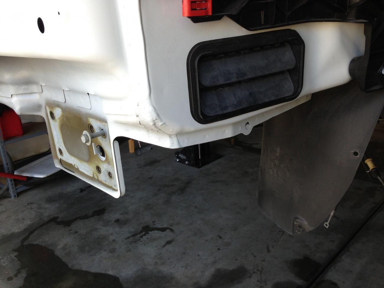

Car is back on the ground as it's going to a fab shop for a full cage and some other work.
Attachment 39726
The original bumper was sacrifice as template in order to make a ZL1 carbon fiber diffuser. The black replacement looks kinda cool with against the white and carbon.
Attachment 39727

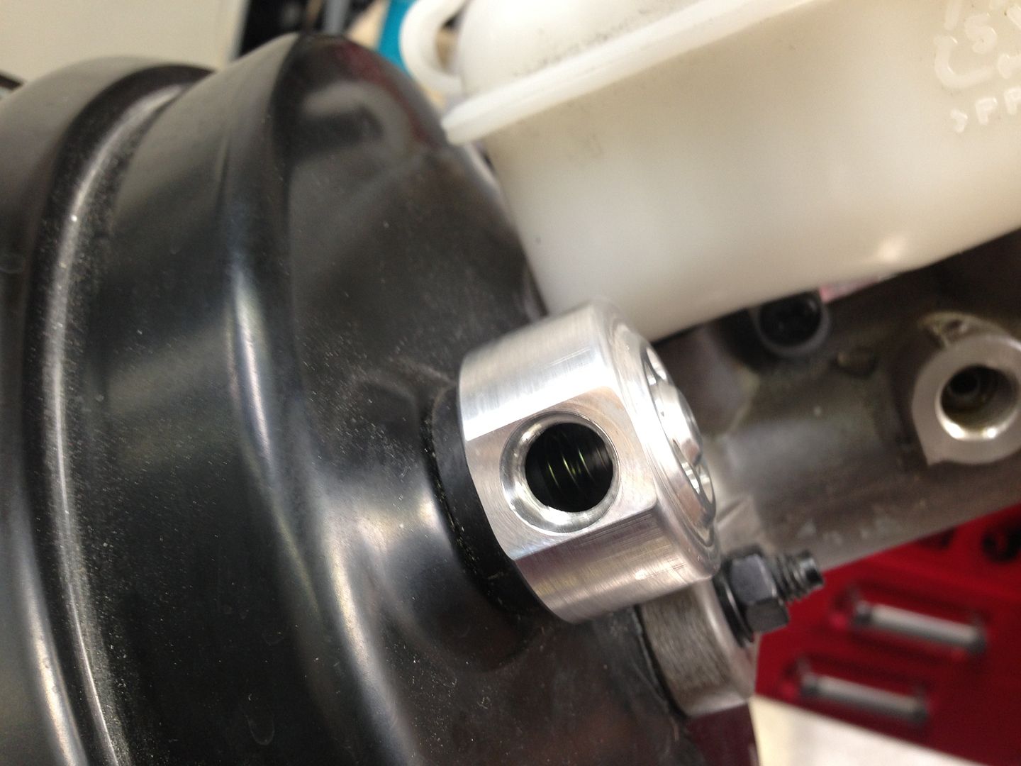

I also has to give props to Cris from JCG! He took 3 hours of his time Saturday morning to the boys and I come by. He reviewed the progress of the project and what still needs to get done to complete it by SEMA. He gave the boys realistic advice and gave them a game plan. In addition, he is going to help them with some custom pieces to take the project to the next level. Some of the stuff will cross pollinate with first gen, so stay tuned.
The attention to detail of what Cris does is just at another level. Check out this neat replacement check valve for the master. It replaced the ugly plastic piece with this piece of functional art! He will also be doing a billet replacement reservoir tank for the master with a built in separate reservoir for the trans.
http://i1231.photobucket.com/albums/...ps0ccd029c.jpg
The amount of engineering that went just into this little piece is amazing.
http://i1231.photobucket.com/albums/...psde5a7ed1.jpg
Thanks again Cris for all the help!

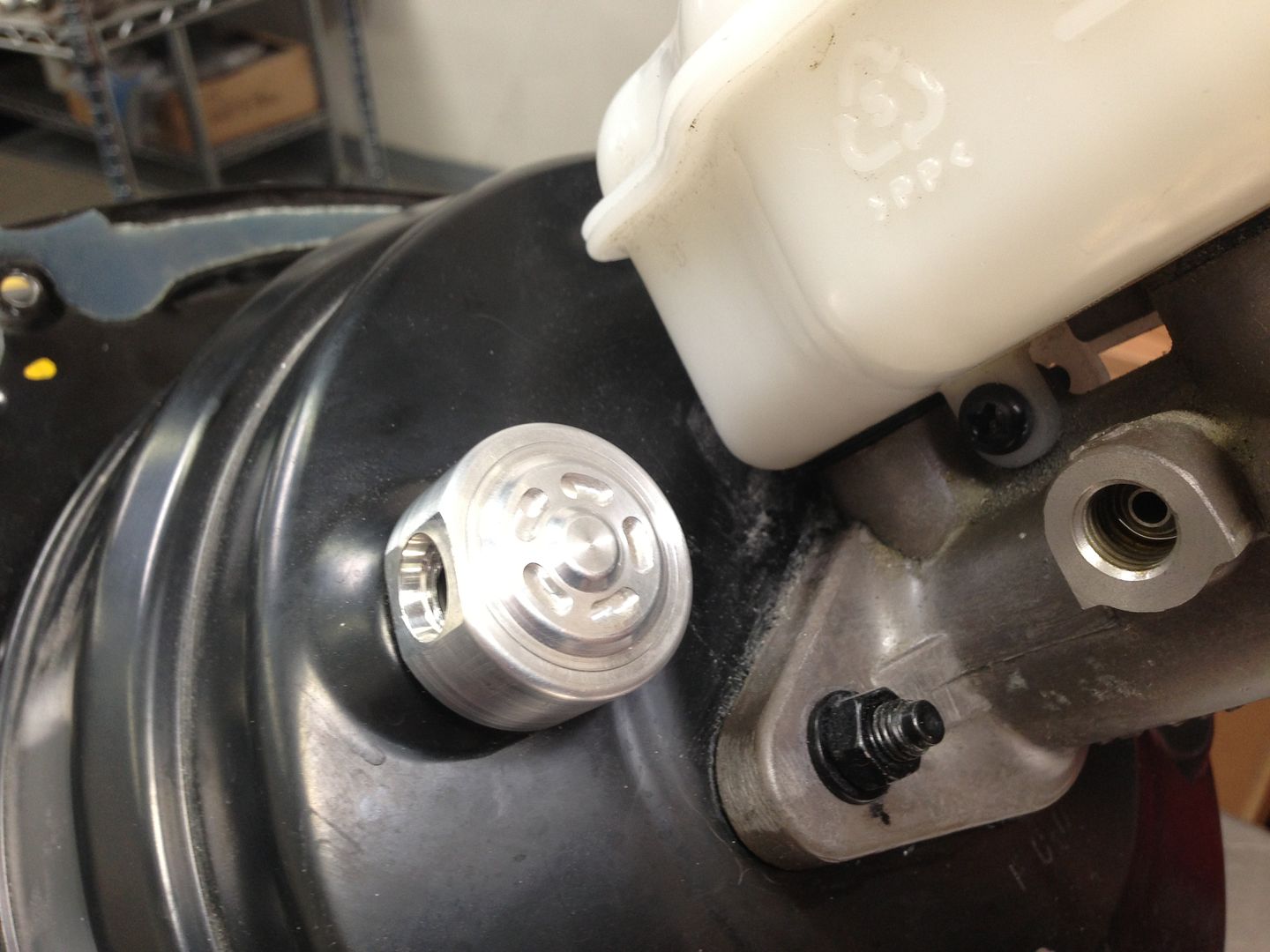

ps looks like I am going to be ordering up this check valve for my car.
