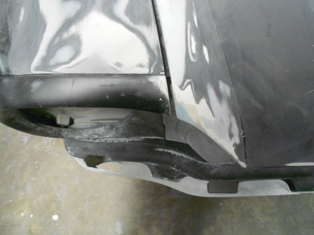

We had a problem with the original fiberglass hood and front valance so we ordered replacements from NPD. The hood required a little work but the front valance fit great and it was a Dynacorn part.
The hood had a low spot in the back and the front corners needed a little fiberglass added to match our front fenders
http://img.photobucket.com/albums/v3...psdyenjzlf.jpg
http://img.photobucket.com/albums/v3...pszuishbgb.jpg

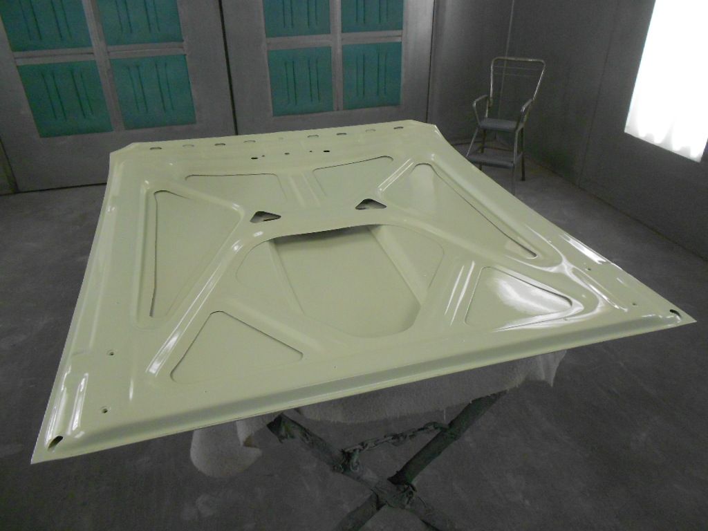

The back of the hood and deck lid was painted Wimbledon white
http://img.photobucket.com/albums/v3...psviydxnu7.jpg

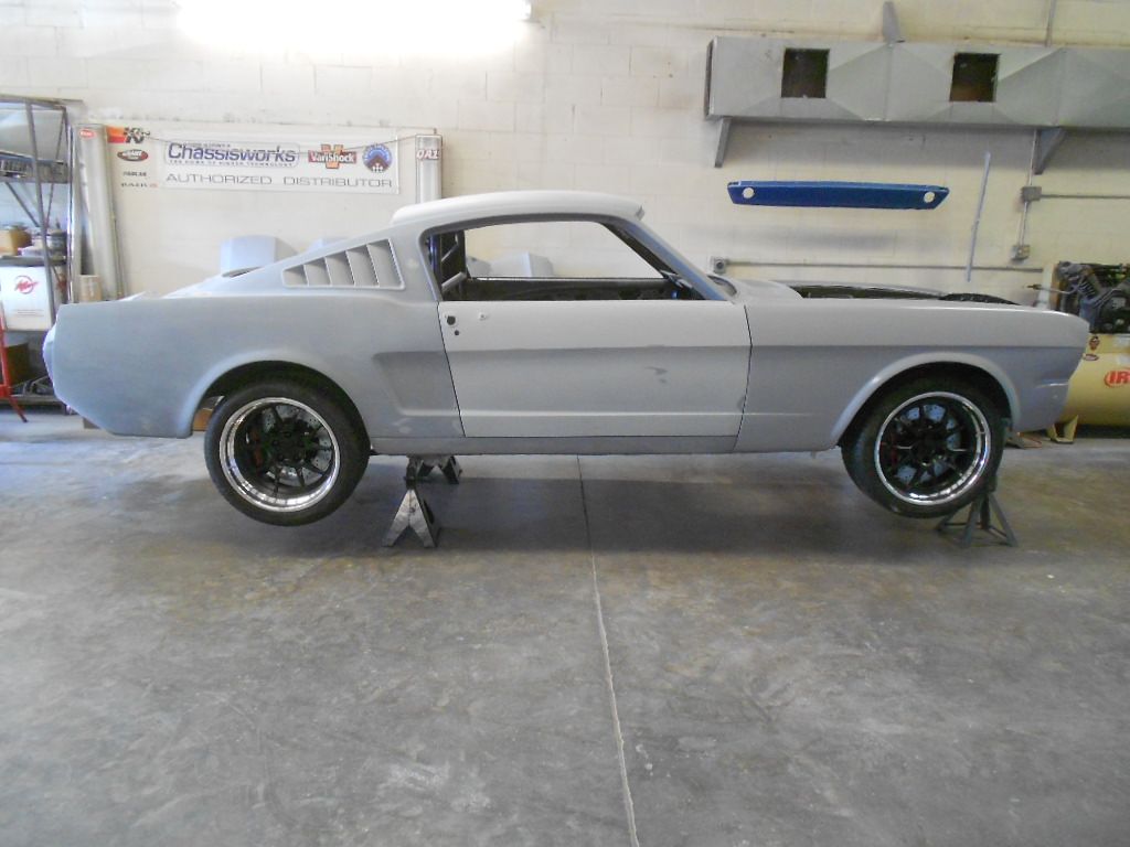

GPR 09-16-2015 06:59 AM
Installing the suspension and brakes and will fit the sheetmetal so when the tires come in we can make sure they fit before painting.
http://img.photobucket.com/albums/v3...ps4pxhgvb2.jpg
http://img.photobucket.com/albums/v3...pstqmc8ytp.jpg

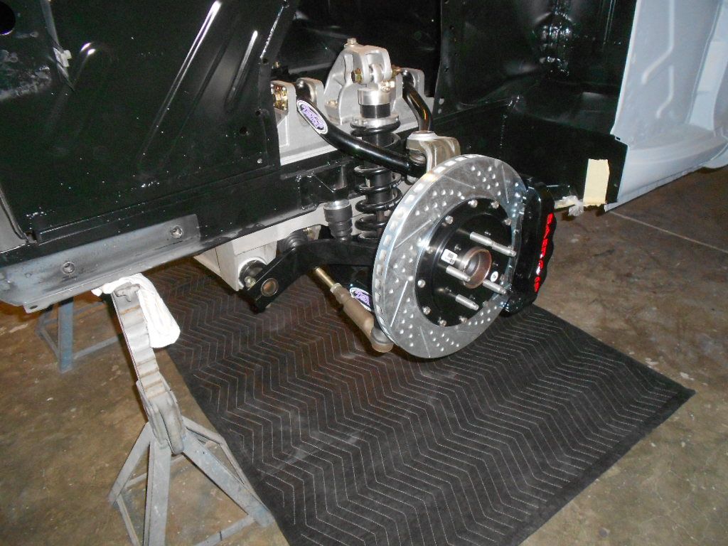

Rear suspension and brakes installed today
http://img.photobucket.com/albums/v3...psv5e0hkoc.jpg

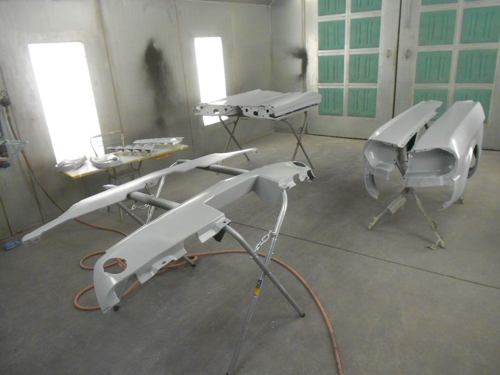

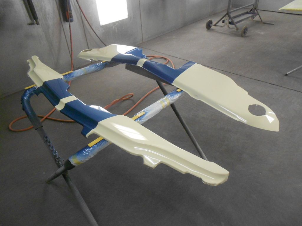

Epoxy primed a lot of pieces
http://img.photobucket.com/albums/v3...pscxqn9yzp.jpg

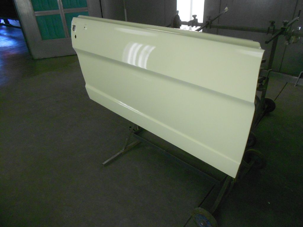

Back of the doors painted matte black
http://img.photobucket.com/albums/v3...psm3iqfw9b.jpg

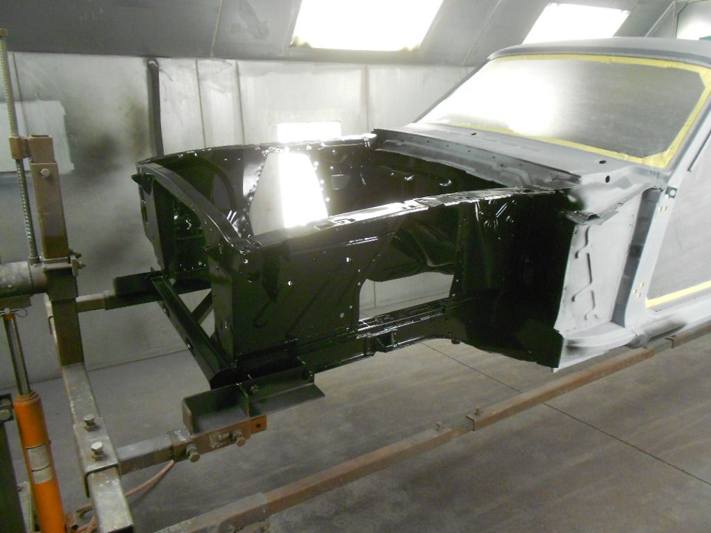

Engine compartment painted
http://img.photobucket.com/albums/v3...psperzekma.jpg
http://img.photobucket.com/albums/v3...psxgj6bzmj.jpg
Painted the fenders and doors
http://img.photobucket.com/albums/v3...pso5qra07h.jpg
http://img.photobucket.com/albums/v3...psmarqg7o7.jpg

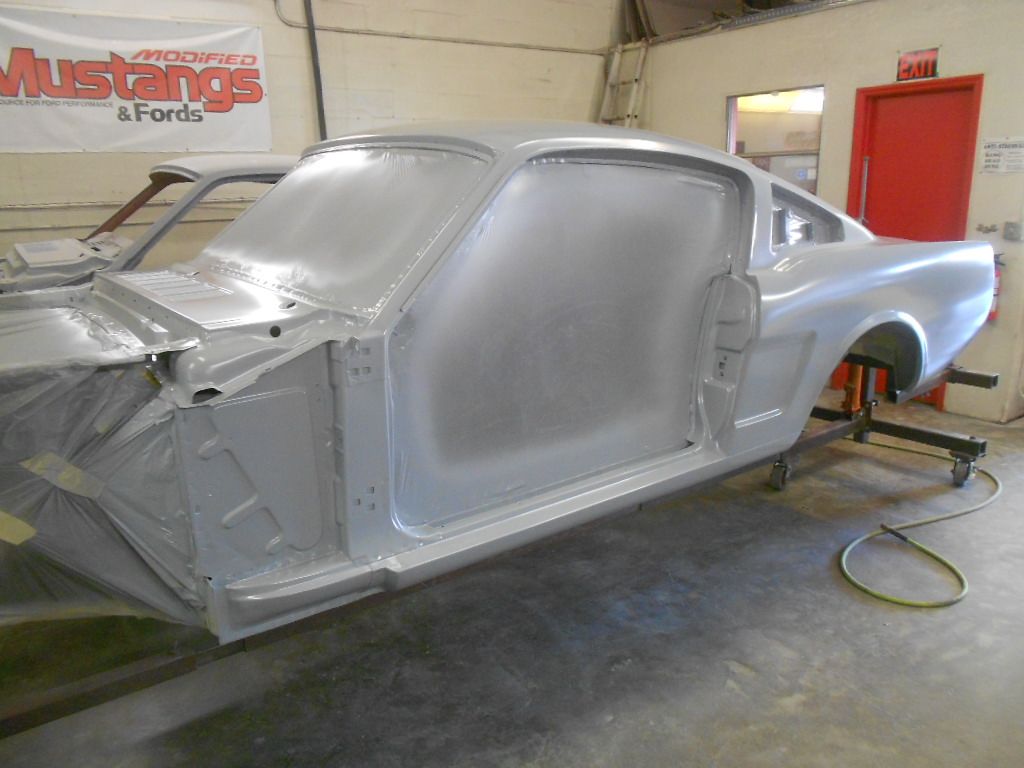

The body was epoxy primed for the last time and wet sanded with 600 before paint.
http://img.photobucket.com/albums/v3...psckrow3bx.jpg

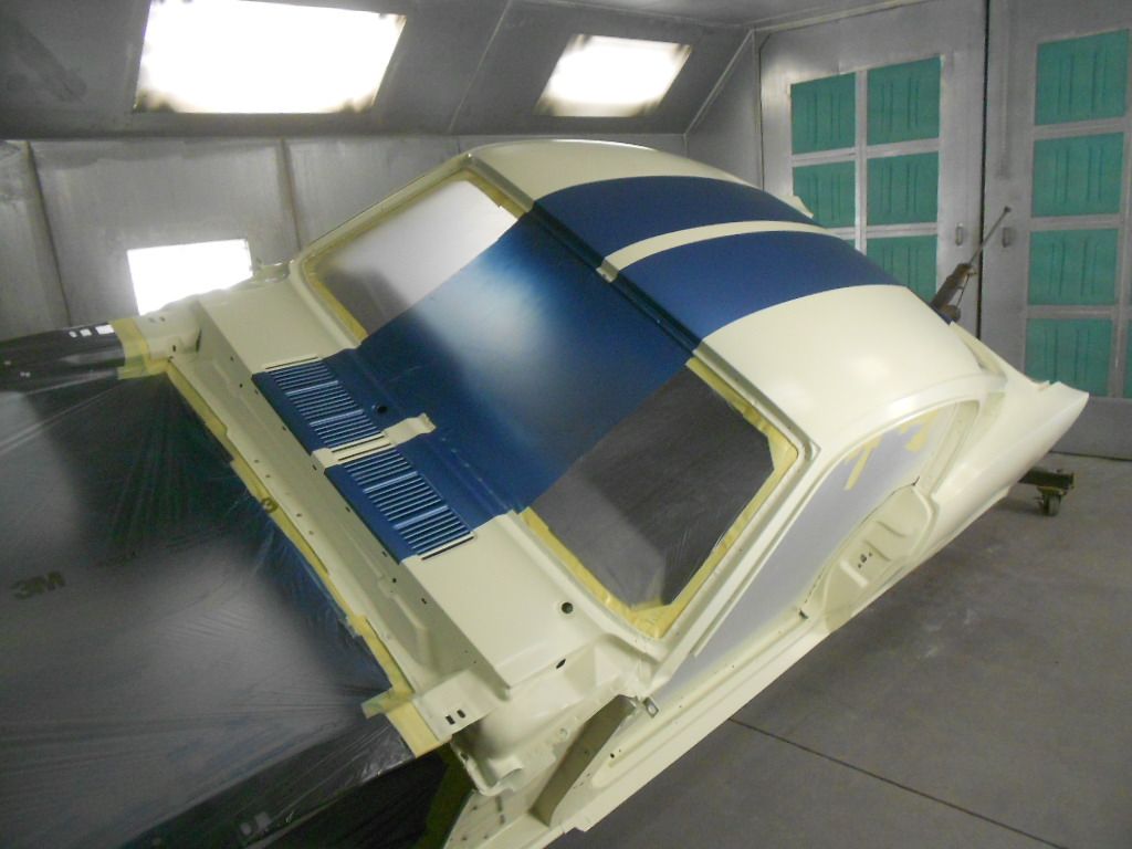

Three coats of Wimbledon white followed with a coat of intercoat clear
http://img.photobucket.com/albums/v3...pszlsfp4ep.jpg

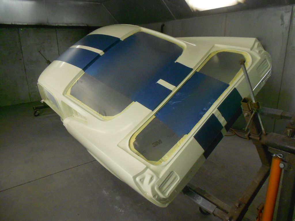

It's not a quick job laying out the stripes and taping the body
http://img.photobucket.com/albums/v3...psadver2ck.jpg
http://img.photobucket.com/albums/v3...pswkxc6z0t.jpg
http://img.photobucket.com/albums/v3...pszlbjlsxp.jpg
http://img.photobucket.com/albums/v3...psxscts04i.jpg

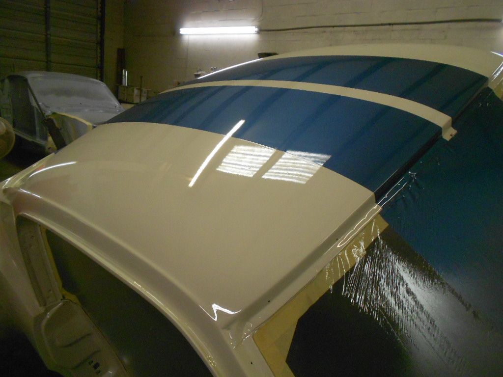

Three coats of Guardsman blue yesterday
http://img.photobucket.com/albums/v3...psin1ijvii.jpg
http://img.photobucket.com/albums/v3...pscmiygc5d.jpg
Brian removed the tape today and tomorrow I will spray SPI Universal clear.
http://img.photobucket.com/albums/v3...psqqdnduwb.jpg
http://img.photobucket.com/albums/v3...psypm7af8p.jpg

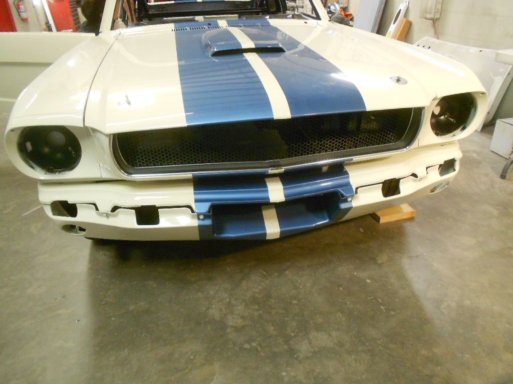

Brian has the front fenders installed
http://img.photobucket.com/albums/v3...pskxdbc6pq.jpg

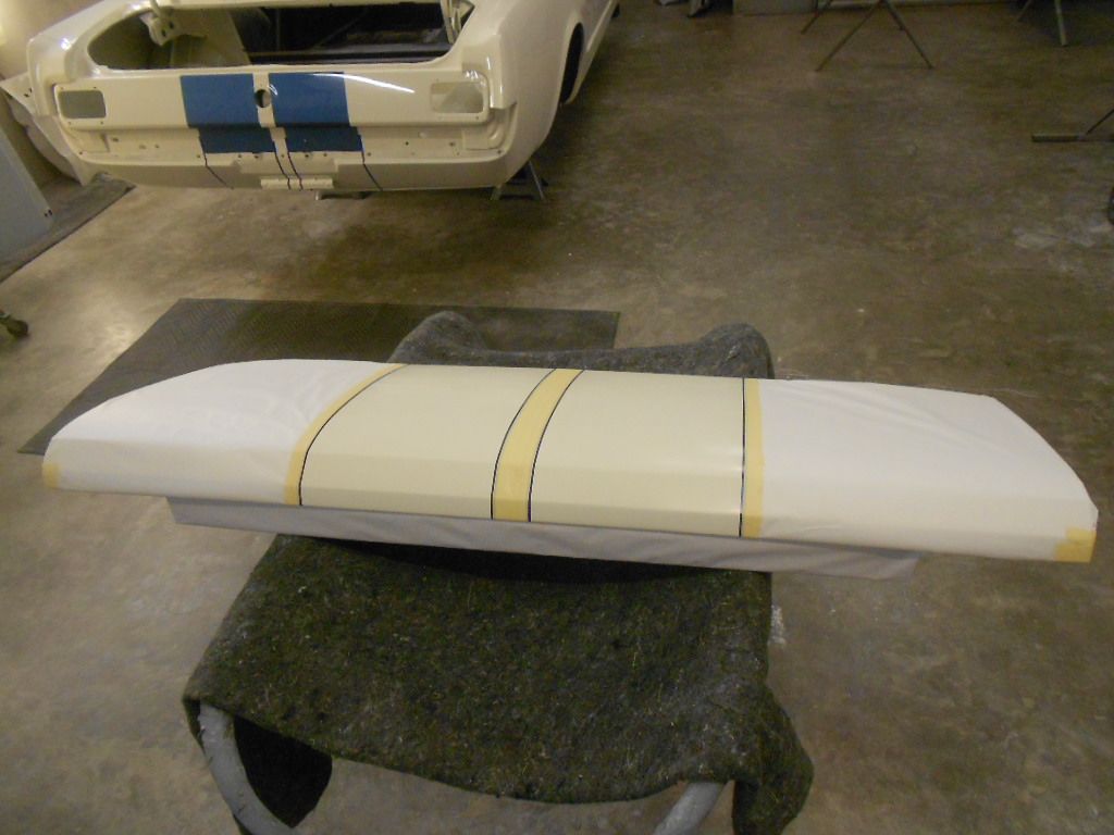

Deck lid taped off and ready for blue along with the rear valance
http://img.photobucket.com/albums/v3...ps5brom554.jpg
http://img.photobucket.com/albums/v3...psfatszkvf.jpg
Removed the tape and clean a little and spray three coats of SPI Universal clear
http://img.photobucket.com/albums/v3...psso1uyuy2.jpg
http://img.photobucket.com/albums/v3...psd3ruscv1.jpg
Getting ready to lay out the stripes
http://img.photobucket.com/albums/v3...psdelrdmbp.jpg
http://img.photobucket.com/albums/v3...psush7jjsr.jpg
Stripes on the hood, grille panel, stone guard and front valance
http://img.photobucket.com/albums/v3...psmcjjzsci.jpg
http://img.photobucket.com/albums/v3...pssepbnizc.jpg
Clear
http://img.photobucket.com/albums/v3...psg33gxmlo.jpg
http://img.photobucket.com/albums/v3...pssrc6vk3t.jpg
Everything wet sanded, buffed and lined up
http://img.photobucket.com/albums/v3...pshaz2fmdu.jpg
http://img.photobucket.com/albums/v3...psdlptntq8.jpg
http://img.photobucket.com/albums/v3...pstvtsb1mc.jpg
http://img.photobucket.com/albums/v3...psgulzkjwv.jpg
