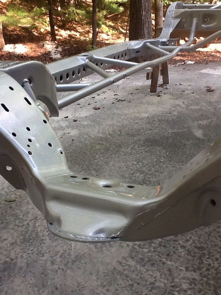

Che70velle 08-18-2013 01:21 PM
And another...

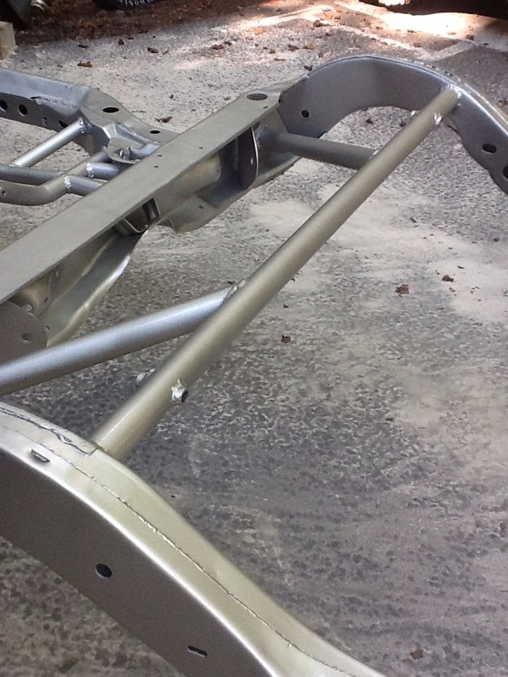

Che70velle 08-18-2013 01:23 PM
Rear view...
http://i1278.photobucket.com/albums/...ps1f029c6c.jpg

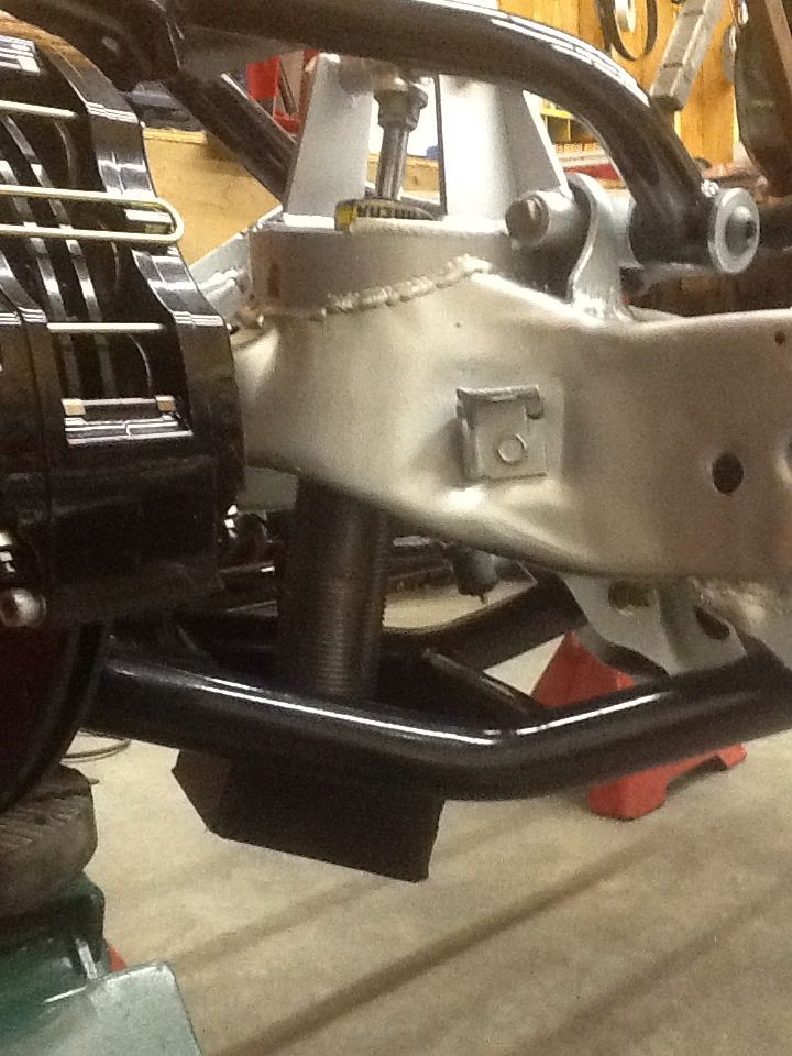

Scott, as always, this thing is looking awesome. I am sure the body and chassis is having fun getting to know each other again. It is fun getting them back together.

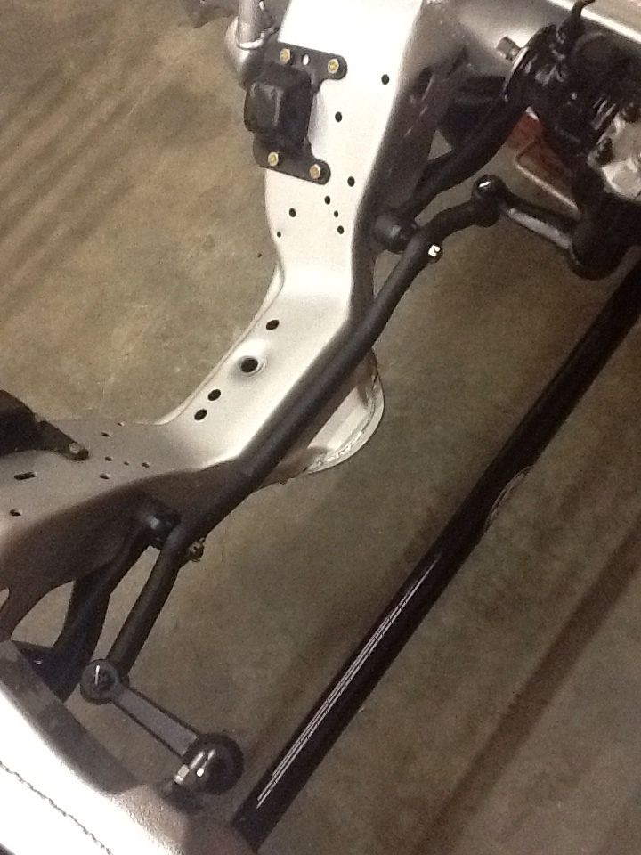

I just read through again, and see that you used the Holley pan. Would it be possible to get a picture of the how close the linkage gets to the pan when turning to the left?
thanks,
HEEP
streetbird 08-18-2013 05:12 PM
love how the frame turn out
Simple and clean
thanks,
HEEP
Heep, when turning to the left, my linkage misses by a hair. What I did was reverse the tie rod ends. I put the inners on the outside, and the outers on the inside. I did this because of the zerk fittings. The inner zerks aim toward the pan, and the outer zerks aim upward. It's the zerk fittings that hit the pan, and a lot of people fill them full of grease, and then cap them off. By reversing them, I can still grease my tie rods, but it requires turning the wheel a little bit.
I will try to get a pic for you and post it up.
Simple and clean
Thank you sir!

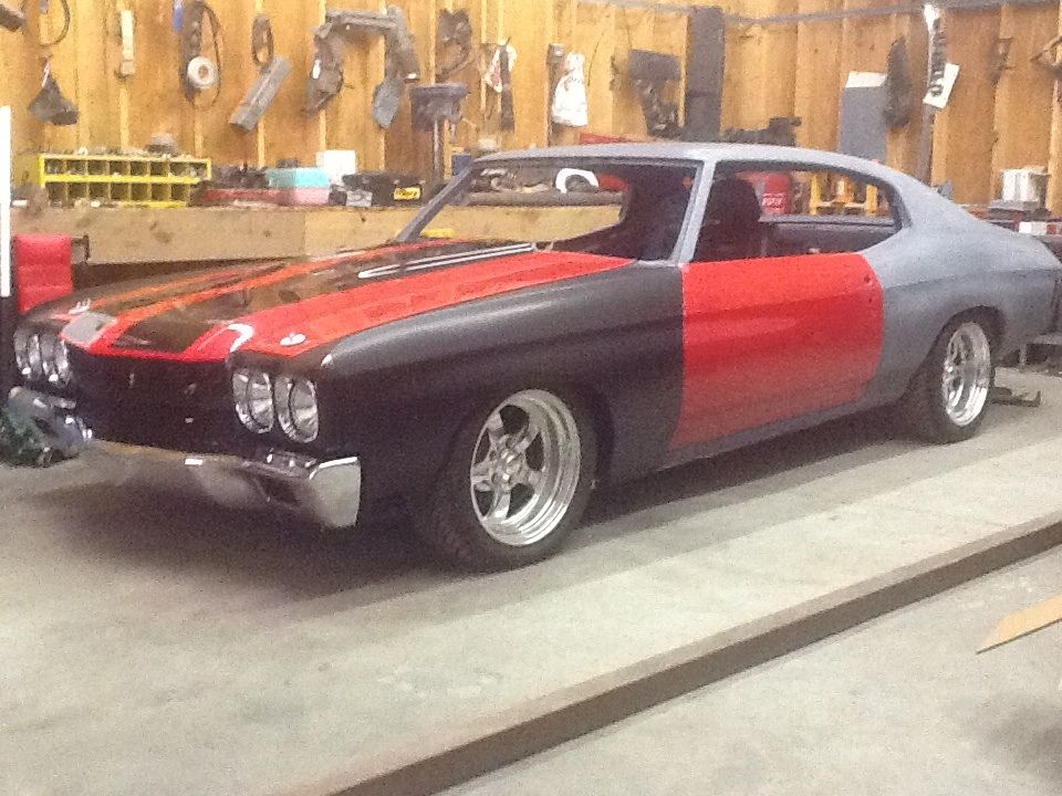

Che70velle 09-15-2013 07:57 PM

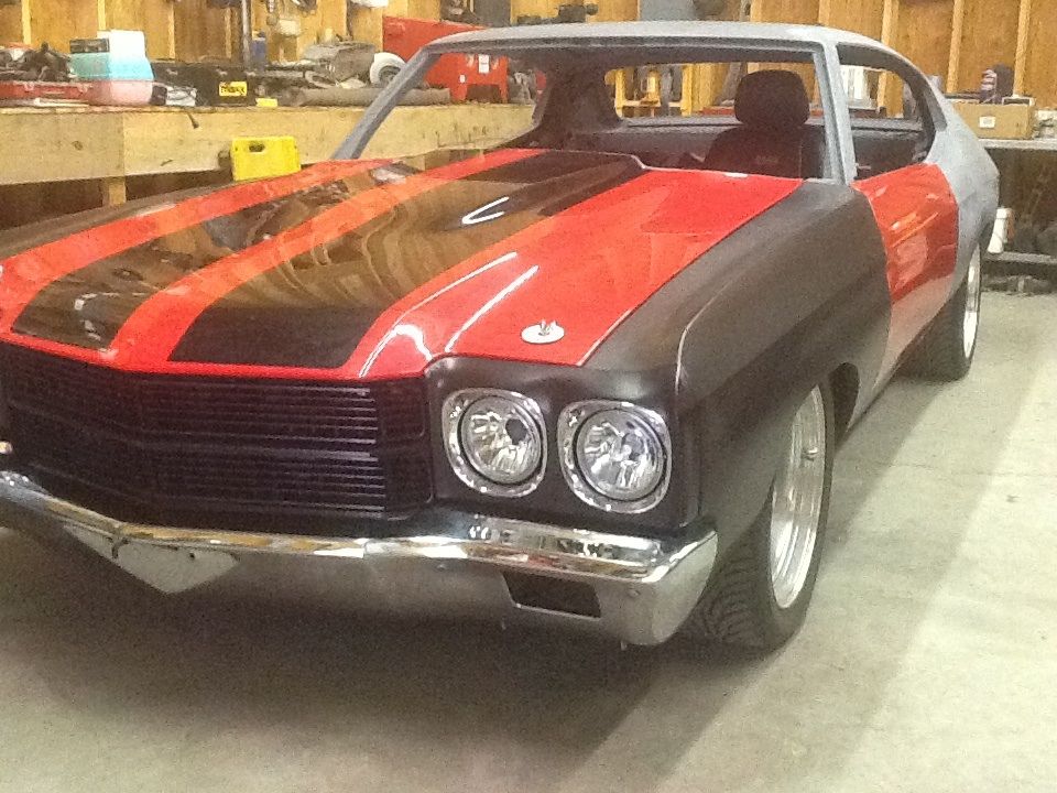

I've got the car assembled for gaping, and pre paint fitment. This is pretty close to ride height. Rear will come down a tad more.

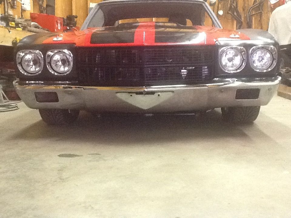

Che70velle 09-15-2013 08:00 PM
Another view...
http://i1278.photobucket.com/albums/...psd88d0990.jpg
Che70velle 09-15-2013 08:06 PM
And another...
http://i1278.photobucket.com/albums/...ps5daf4311.jpg

HEEP 09-16-2013 06:32 AM
I can only dream of mine sitting like that. Great looking car. You are making huge progress. I'm gonna get over there at some point to see it.
:trophy-1302:
HEEP
WSSix 09-16-2013 10:56 AM
Nice progress. Looks good the way it's sitting now I think.
214Chevy 09-16-2013 01:42 PM
Beautiful......just beautiful. It's just sitting there so graceful. :flashie:
Rick D 09-16-2013 04:49 PM
Nice Scott, got love seeing looking like a car again!!
tones2SS 09-16-2013 05:10 PM
That looks killer Scott! Good job.

Thanks trey. I was able to make the rear go down 3/4" and its exactly what I'm looking for. I'm thinking that after glass, fuel in tank, battery in trunk, etc, it will be where I want it.
