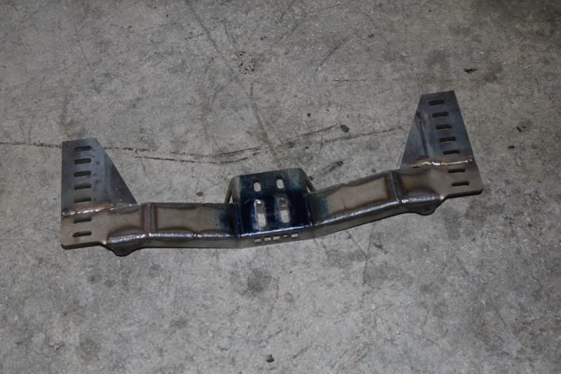

Thanks guys. I finally got some input from HPI on the trans mount not allowing the trans to move back far enough. They are going to redesign their kit and send me some parts to alleviate my issue. Tyler is a pretty good guy in my book.:trophy-1302:

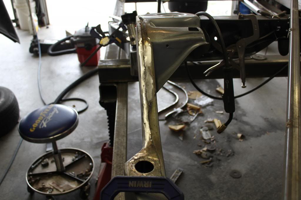

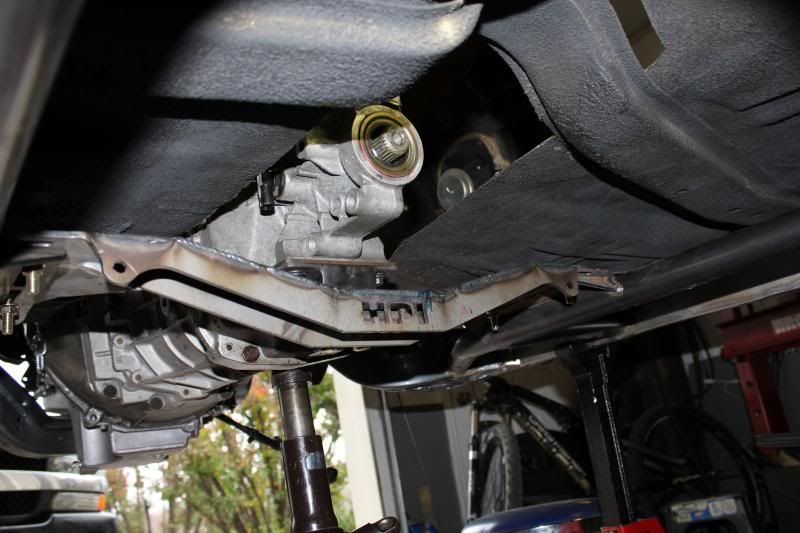

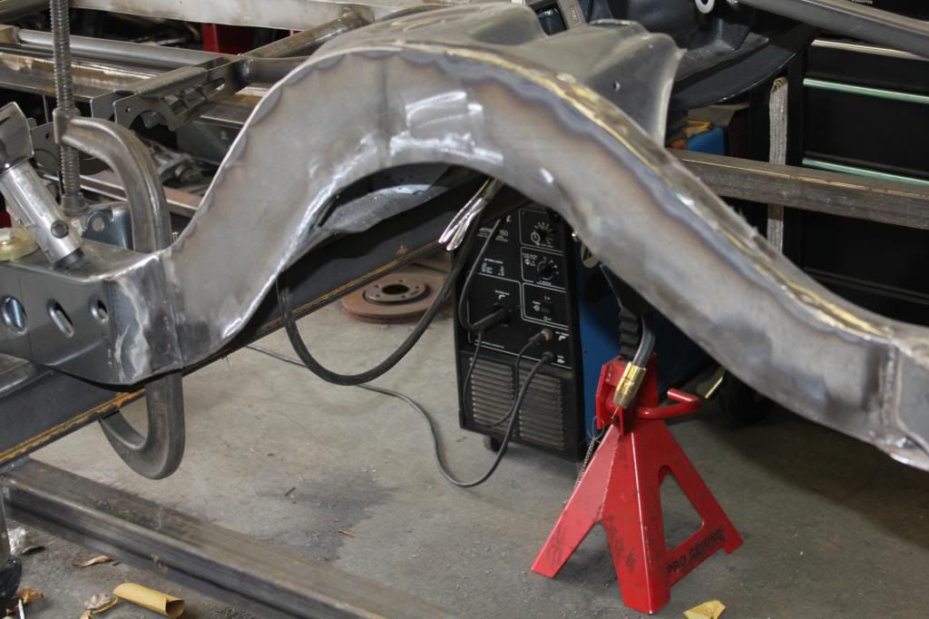

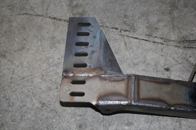

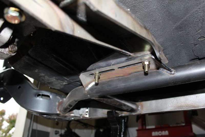

So here is what I have been up to the last couple of days. I had to modify the HPI trans mount. It wouldn't let me slide the engine back where I wanted it at. Tyler was very helpful, send a couple of tube mounts for me to use, but I decided to go a different route. Had some metal cutout and I added it to the crossmember. http://i115.photobucket.com/albums/n...psd5da2547.jpg Of course, I had to do both sides. http://i115.photobucket.com/albums/n...psf2bec27b.jpg Now it fits in there better. http://i115.photobucket.com/albums/n...ps1606c222.jpg It spreads the load over the side brackets better. http://i115.photobucket.com/albums/n...ps2fa0533c.jpg HEEP |

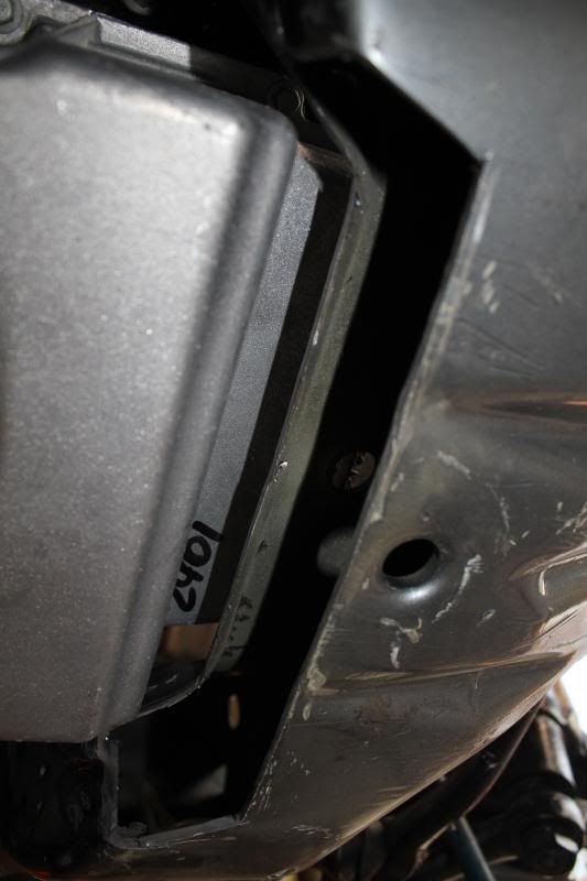

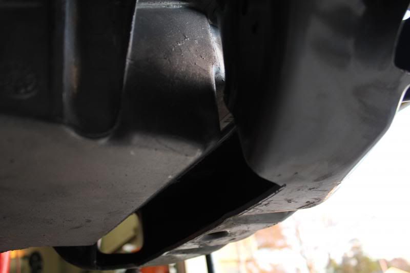

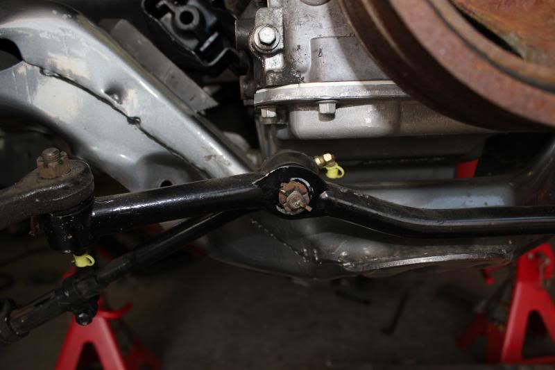

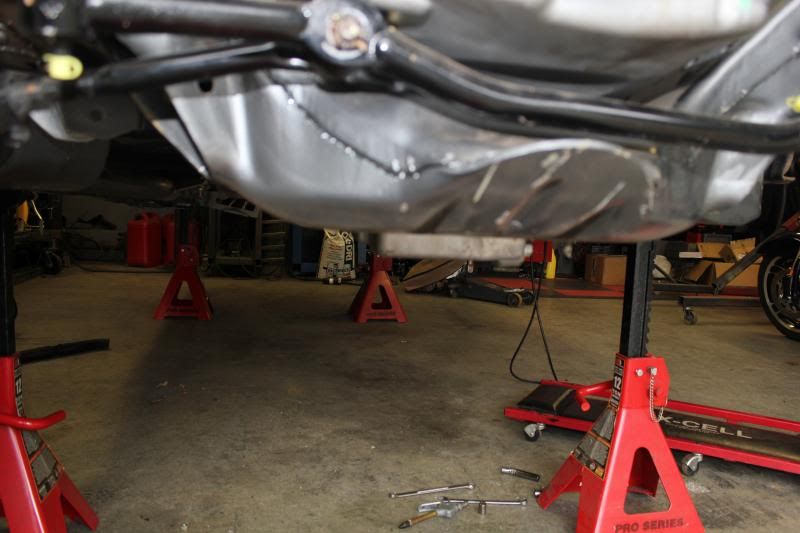

So after buying the "muscle car oil pan", i was not very happy. Most of you that have gone this route weren't either. didn't know that until after I had already purchased it. So I ended up getting a 4th gen pan and going that route instead. I had seen Aaron use this with his 65' so I found the cheapest one I could. found the whole thing for about $260 with free shipping. I went from this

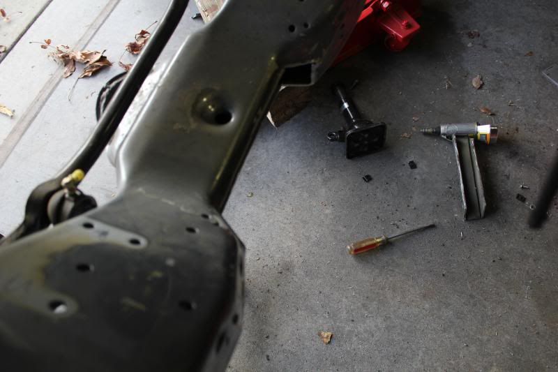

http://i115.photobucket.com/albums/n...psbdc0f555.jpg http://i115.photobucket.com/albums/n...pscc9e4686.jpg Modified the front crossmember http://i115.photobucket.com/albums/n...ps0c0950c3.jpg http://i115.photobucket.com/albums/n...ps95f49c74.jpg http://i115.photobucket.com/albums/n...psdf66705a.jpg So I solved my issue with the drag link hitting the pan. http://i115.photobucket.com/albums/n...psd2167492.jpg And we are not going to drag the pan http://i115.photobucket.com/albums/n...ps5e47ef73.jpg HEEP |

Looking really good! I like the crossmember mods. I would think that the longer mounting tabs would cut down on twisting, but I'm not an engineer.
yes, the longer tabs were needed for the twisting of the trans mount. I will probably hold it in with 3 bolts on each side just for good measure. So after engine mounts, I guess I'll tackle the trans tunnel and firewall smoothing. Thanks, Bill |

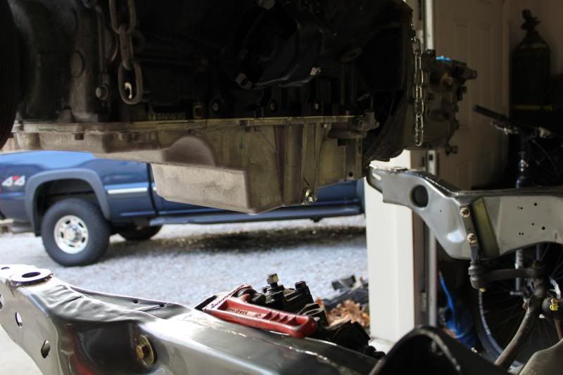

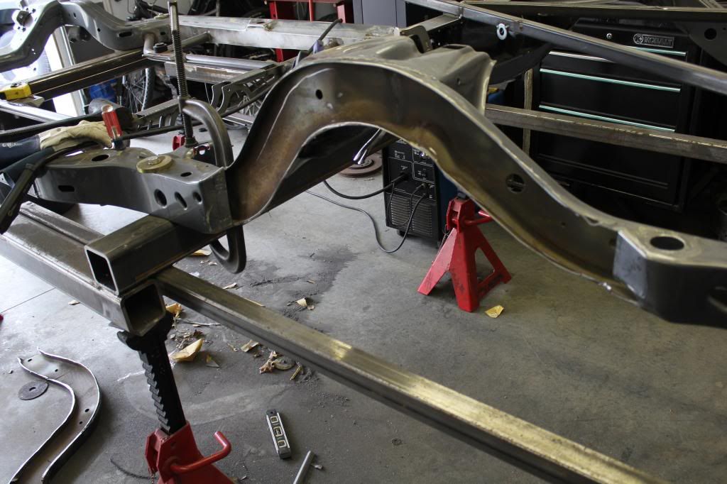

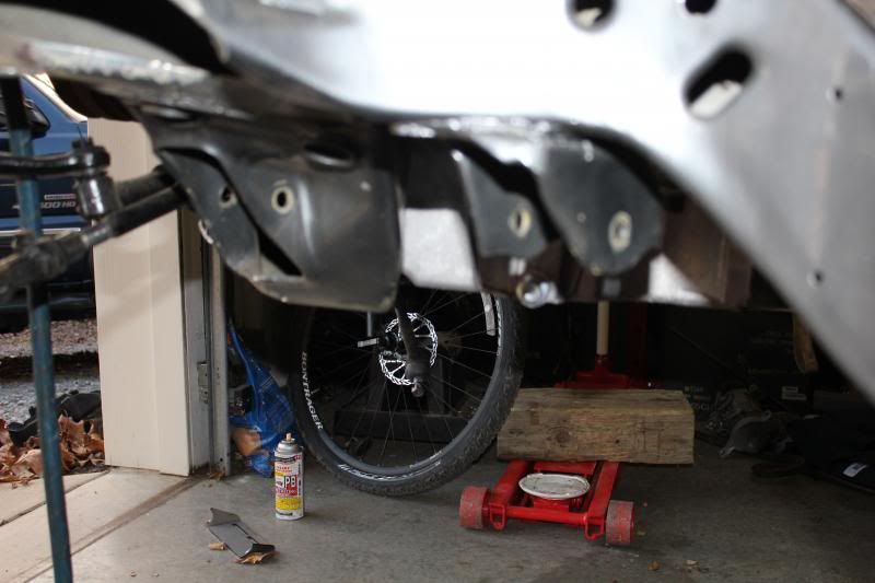

Well, It's time for a little update. Got the engine mounting completed. Kind of like a milestone with swapping the engine out to the late model stuff.
First I took a little tip from FAB53 and built a hanger. This was to get the engine off the spacers I put in when I got it set where I needed it. http://i115.photobucket.com/albums/n...ps9beb42ba.jpg Had some plates made to bolt to the frame itself. Kind of going the Stielow route. http://i115.photobucket.com/albums/n...ps6a10a3cd.jpg Installed the uprights with some spacers to make sure I had enough room for it to slide in. http://i115.photobucket.com/albums/n...psd9689baa.jpg http://i115.photobucket.com/albums/n...psde06771c.jpg Passenger Side http://i115.photobucket.com/albums/n...psddf4b9c1.jpg http://i115.photobucket.com/albums/n...ps26f1e0d3.jpg Finished product http://i115.photobucket.com/albums/n...ps11623757.jpg http://i115.photobucket.com/albums/n...ps6216e6d0.jpg http://i115.photobucket.com/albums/n...ps6f4cd1fc.jpg |

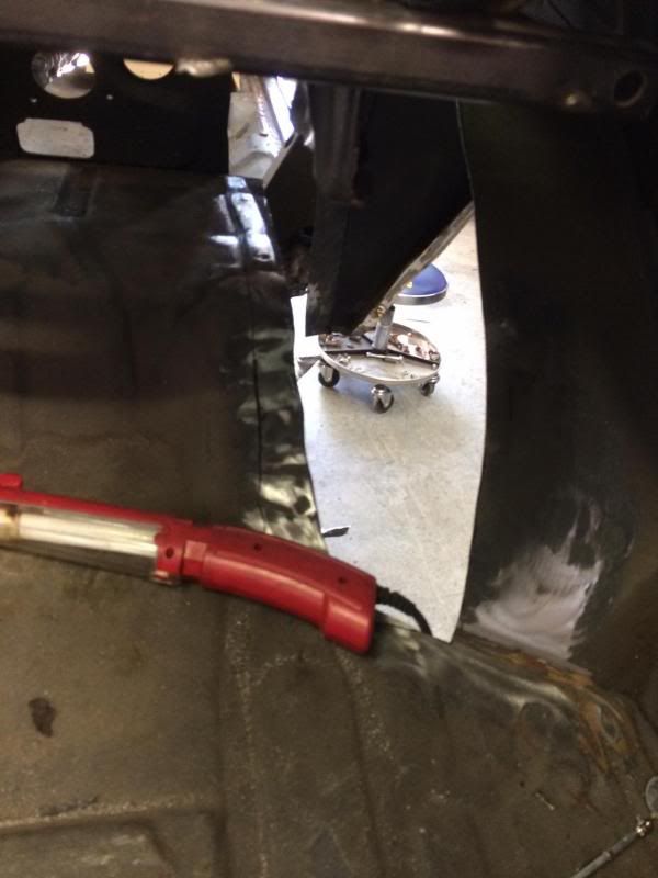

So I finally got to work on the ride today. Got my nerve up to do the rear tub cutting. And of coarse, I hit a road block. I'm cut all the way through to tub itself, except down to the lower area of the tubs front and rear.
http://i115.photobucket.com/albums/n...psc400b93f.jpg http://i115.photobucket.com/albums/n...psaeb5e0af.jpg So the little snag is, where you see the line on the trunk floor that is where I will be cutting back the 2", that is right over the trunk brace in this picture. http://i115.photobucket.com/albums/n...ps72a926af.jpg so. I'm guessing that I need to not cut back so far on my first cut. Then after i band the tub, I can cut back more as I need to. Is my thought correct? Thanks, |

Thanks guys..... I think I am going to call Tony today at ABC to see if he has his tubs ready yet. I think it will be better if I don't try to band them myself.
I was hoping some of the professionals would chime in and steer me a little. |

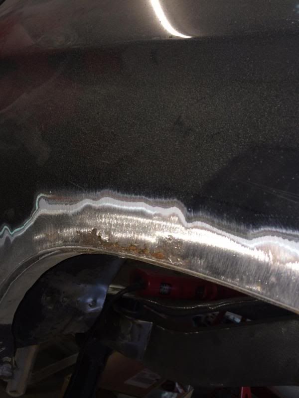

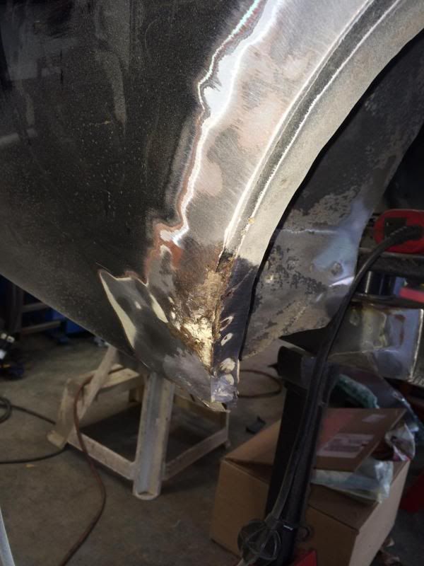

http://i115.photobucket.com/albums/n...psfbe87b26.jpg http://i115.photobucket.com/albums/n...ps449d296a.jpg I do think now that I wil be putting a quarter in this side. That will be anothe daunting task for me. http://i115.photobucket.com/albums/n...ps4e98e07b.jpg http://i115.photobucket.com/albums/n...pse3637b93.jpg http://i115.photobucket.com/albums/n...ps1437221d.jpg The outer tub is also eat up, so that will get replaced also. |

Alright, so I have been pricing metal and found a great deal with Tony G at ABC performance. Before I do the order, I have a question, and I asked this before about the car. Should I have the body blasted before I install this quarter panel? Right now the task is inner and outer wheel tubs and the quarter. Not sure of the other side just yet. I thought it would be better to do one side at a time. Thoughts?:drowninga:

Bill, I agree with what Aaron said. If your going to remove a quarter panel there is no sense in blasting it to throw it out. Clean up the metal behind it and treat it. Weld in some bracing to keep the twist down.
As far as your tubs go, I would give it a shot. It sounds like your thinking of replacing them anyway, so practice with the bad one and see what you think. You might be surprised with how you do! Good luck and glad your moving forward!! |
Bill, just cut out the bad areas of metal, leave all the upper and front and back structure of the qtrs and you will still have lots of strength to keep it from moving around. As stated it doesn't make sense to blast metal that will go to the scraper. Glad to see its coming along. As long as you do "something" on each day it will get done.

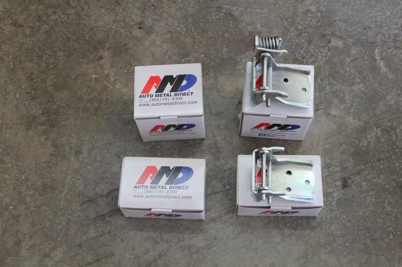

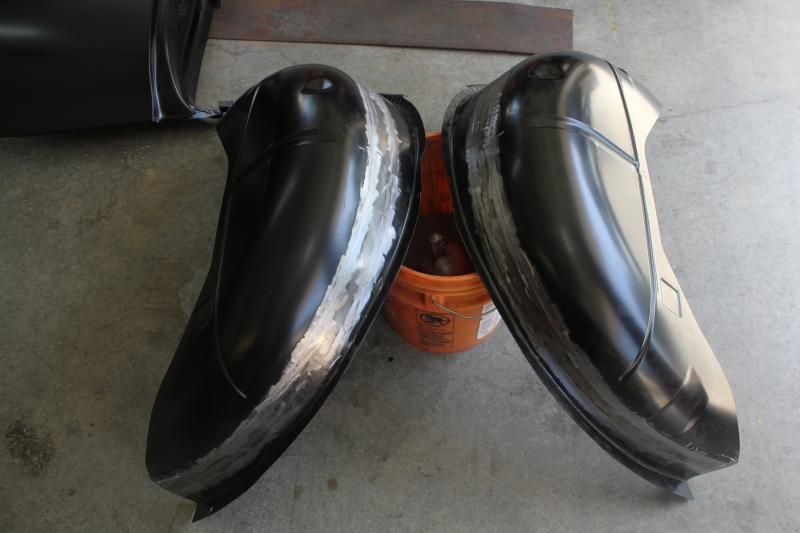

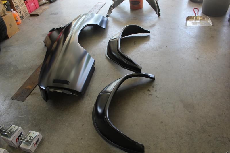

Well, I actually got out there and got a little done. First, I got everything out of the boxes. Bought some new hinges from AMD....
http://i115.photobucket.com/albums/n...psff3c8d7b.jpg Got a RH quarter panel, and outer tubs.... http://i115.photobucket.com/albums/n...psc5ee75fe.jpg Also got a set of the inner fender tubs from ABC performance. Tony does a good job on these.... There is no way I could have done this. http://i115.photobucket.com/albums/n...ps45bb04f3.jpg |
