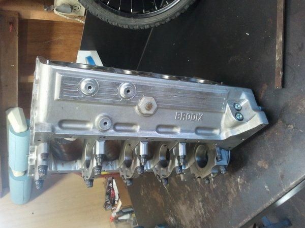

Picked up this block
from a dirt track guy in CA. Was going to use it as a back up motor and never did anything with it. It is used, got it for about 1/3 cost of new. Brodix aluminum block that has been lightened.
http://i1138.photobucket.com/albums/...716762-358.jpg
http://i1138.photobucket.com/albums/...716744-102.jpg
http://i1138.photobucket.com/albums/...-SBC-Block.jpg
Sieg 04-12-2013 06:41 AM
