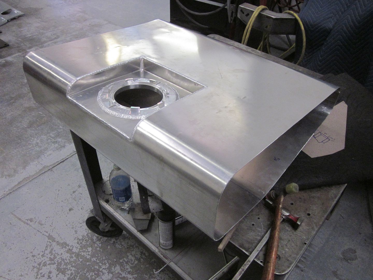

Here is a custom aluminum gas tank we are building to support the LS engine swap..
http://i1015.photobucket.com/albums/...ps26cccb64.jpg

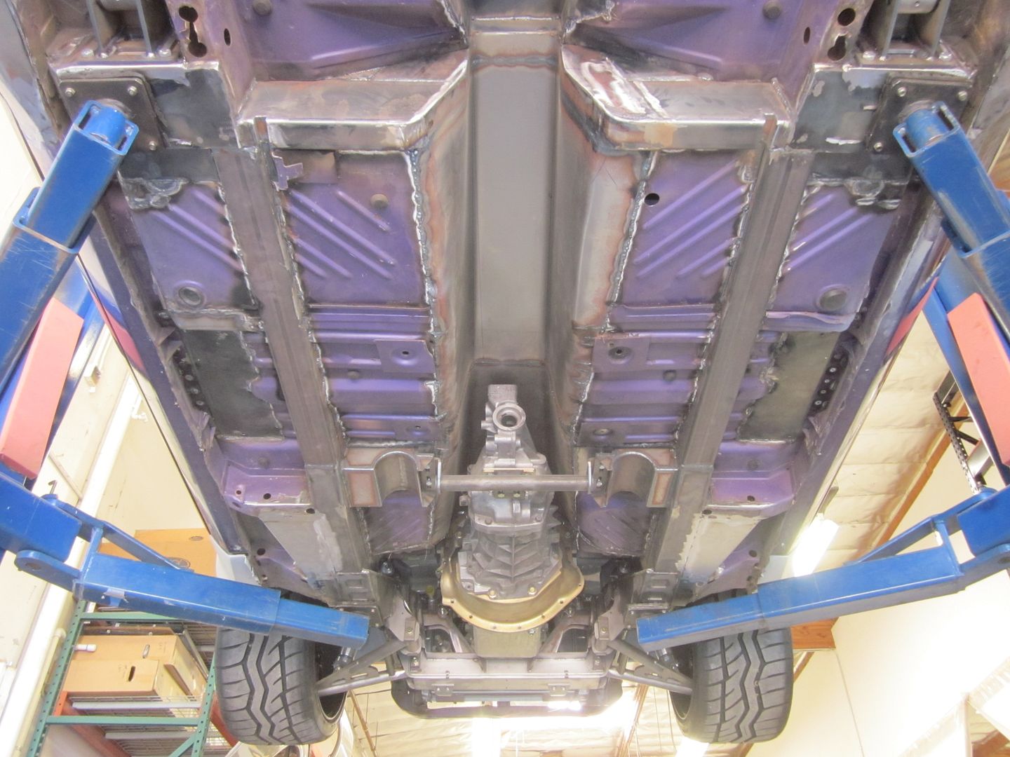

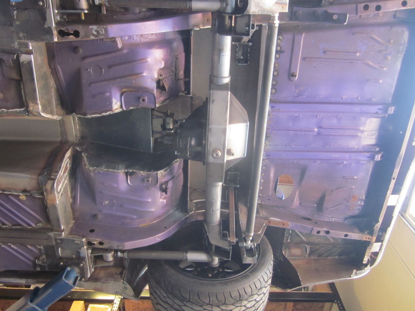

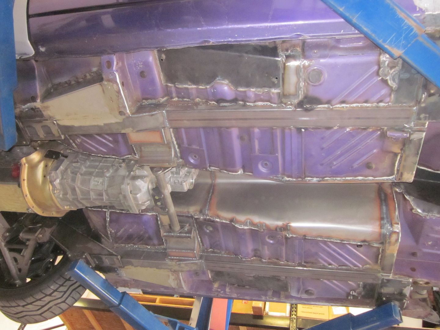

Here is what the underside structure looks like.. The Challenger has torque boxes just like a Mustang… I am really starting to favorite this type of design.. I can really tie in a chassis into the rocker panel & add some rigidity to structure of a car.. We have about 4.50 inches of ground clearance & everything is sucked underneath the car… Nothing hangs below the frame rails..
Please excuse the welding not being clean.. That will be done when the car gets disassembled & undercoated.. Trying not to waste any time.. Car need to be in the body shop late next week..
http://i1015.photobucket.com/albums/...psd233f235.jpg
http://i1015.photobucket.com/albums/...pscfcd7112.jpg
http://i1015.photobucket.com/albums/...ps89583498.jpg
http://i1015.photobucket.com/albums/...psefe87f2e.jpg

The pictures of the underside have me :headscratch: . I'm not used to looking at cars from that view, my jack doesn't go high enough!
I've got a couple questions about the frame rails that tie into the front subframe and the torque boxes.
Near the torque box, is the rail notched and than the TB is plated? TB, frame rail and cross member all tied in together...is that right?
The rail running through the floor, is that just welded to the floor pan top and bottom? Easy cheesy?

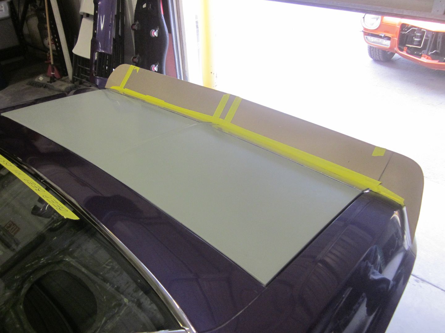

We got the trunk & the rear bumper pcs in fiberglass fitted… Trunk was pretty good fit.. Bumper was not too bad with the new aluminum fabricated mounting brackets.. We also got some rear spoiler concepts that we are playing with.. Yesterday we simulated some wind tunnel drag thru Solid Works.. Also playing around with an idea on active aerodynamics..
http://i1015.photobucket.com/albums/...ps3e7230ed.jpg
http://i1015.photobucket.com/albums/...ps4eadb579.jpg
