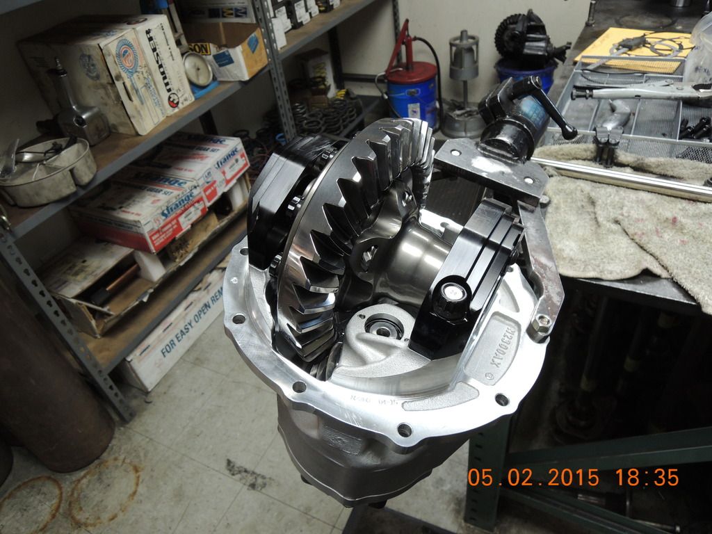

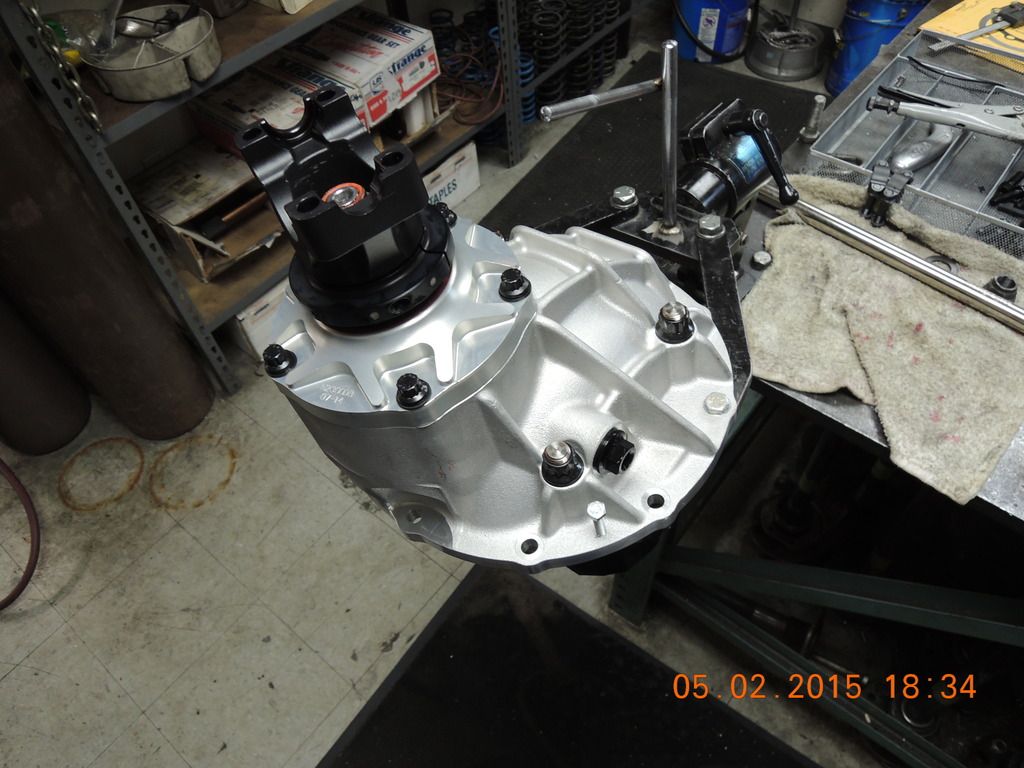

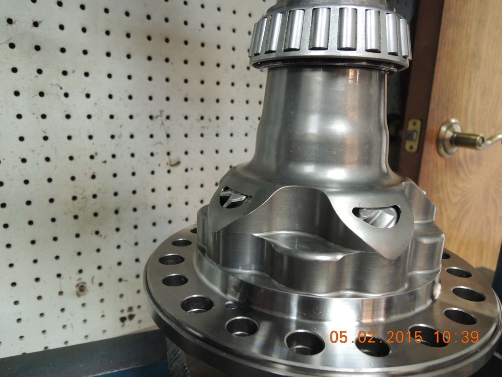

Decided to go with a Strange 35 spline S-track. Have read good things. Anyone running one? Also having REM treatment done to the gears, bearings and chrome moly yoke. Never heard of the process before. The benefits of taking the differential to one of the best race car builders in the country. :G-Dub:
http://www.vacmotorsports.com/blog/r...rem-treatment/
Some of their work in the pic.

Nice! Micro polishing is available as an option on some parts from Strange Engineering, too. It's a neat process.
tumper93 04-17-2015 10:29 AM
I had my gears for my 12 bolt REM'd by G-force, which is a customer of mine. It is amazing what it looks like and how slick it is. I can give them anything and they will throw it in for me.
cjfirstgen 04-17-2015 10:48 AM
Cool stuff. Anyone notice the scalloped ring gears for rotating mass reduction? Won't need that on a street/track car. Those are built for cars where every tenth or thousandth counts.

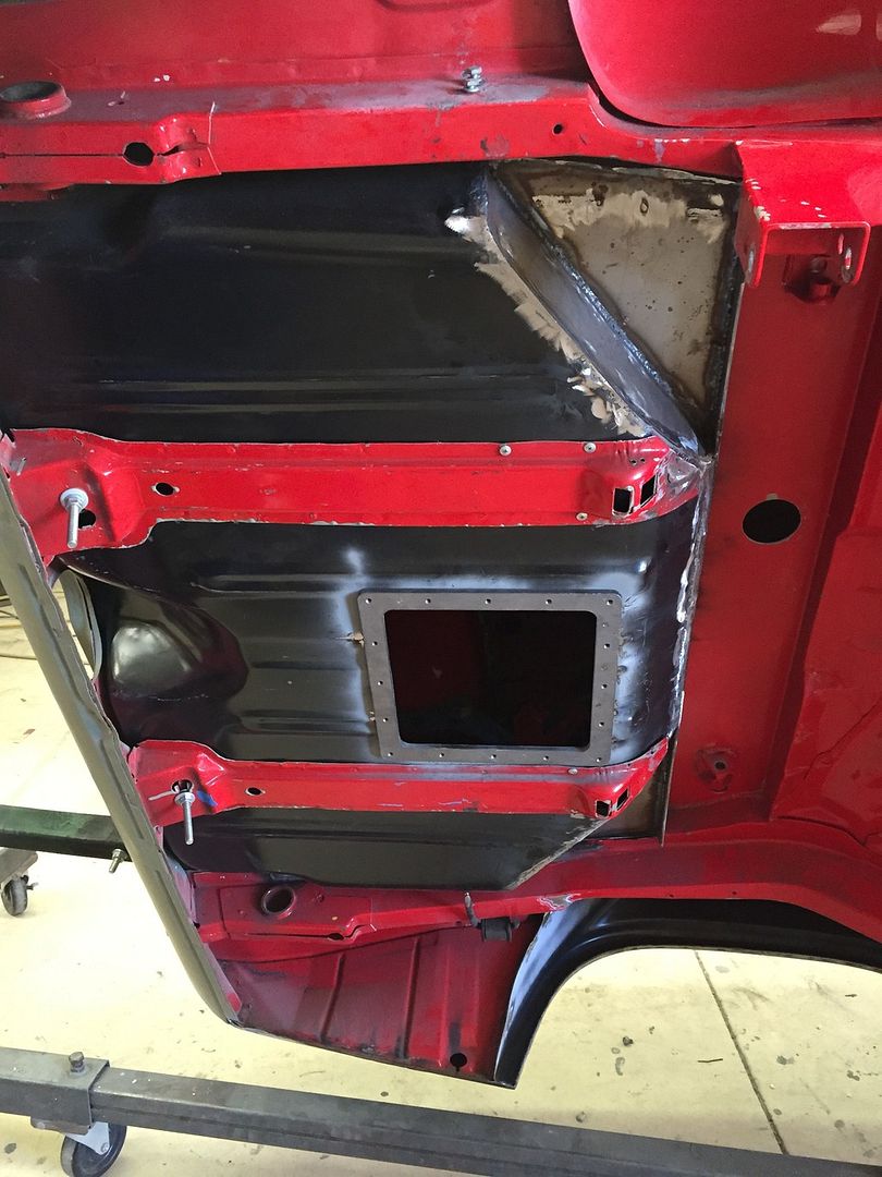

Trans tunnel with access plate.

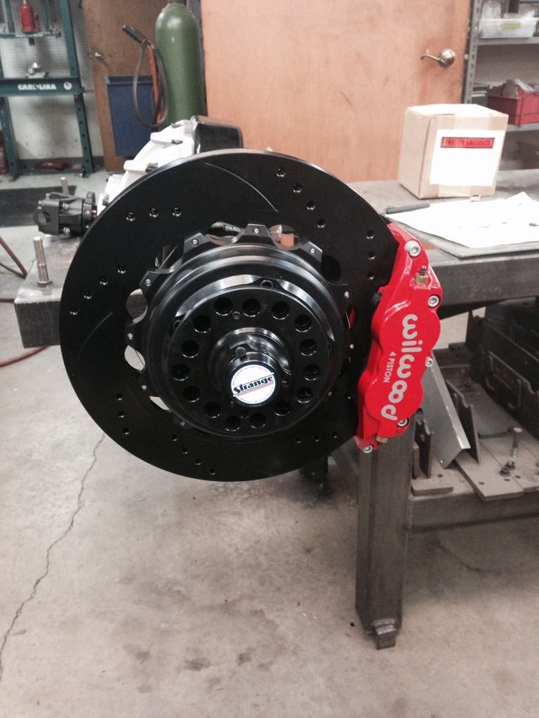

Center section complete including the REM treatment aka Isotropic Superfinish on diff, gears and bearings.
http://i305.photobucket.com/albums/n...pswzdw3ryy.jpg
http://i305.photobucket.com/albums/n...psl0sp5vuk.jpg
http://i305.photobucket.com/albums/n...ps6xodzxh3.jpg

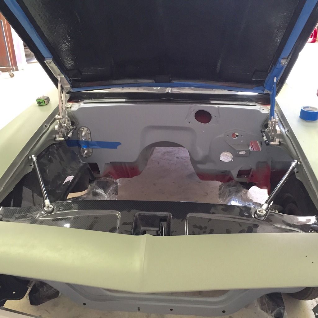

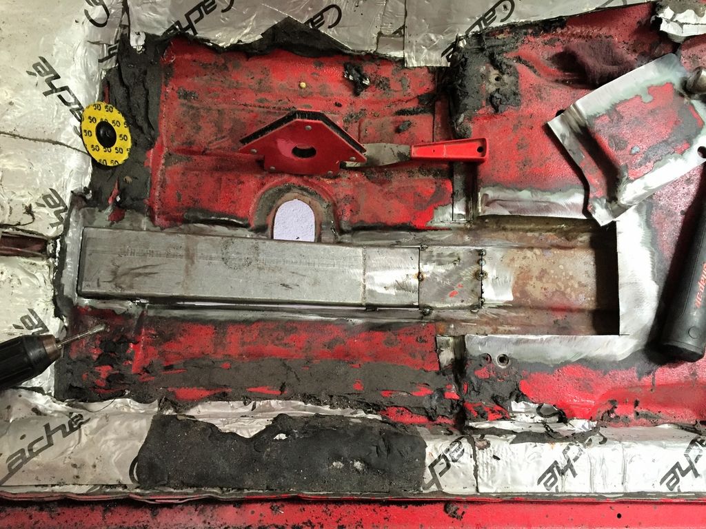

DSE subframe braces. Still need tig welded. Seat pan was in great shape after 46 years. Nothing a little POR 15 can't handle for another 45 years. Then some cleanup and reapplying some dynamat.

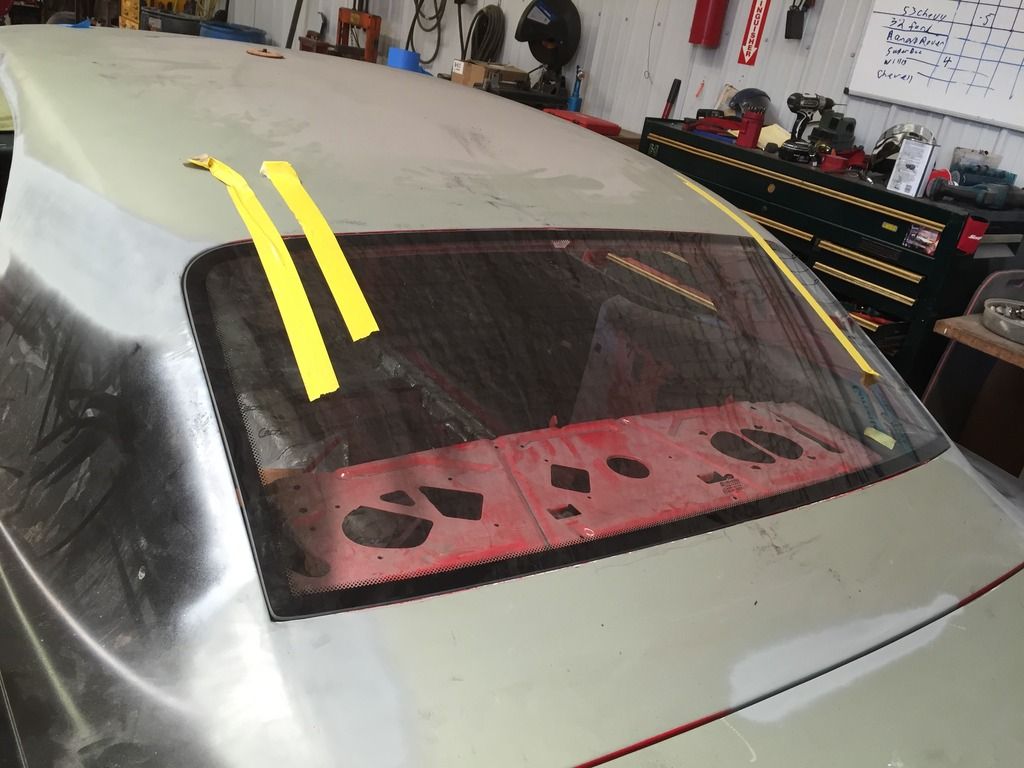

Test fit on the flush glass. Not much gap work needed. Following what was done for the gaps on the Goodguys Camaro.
http://i305.photobucket.com/albums/n...psqq9pep5e.jpg

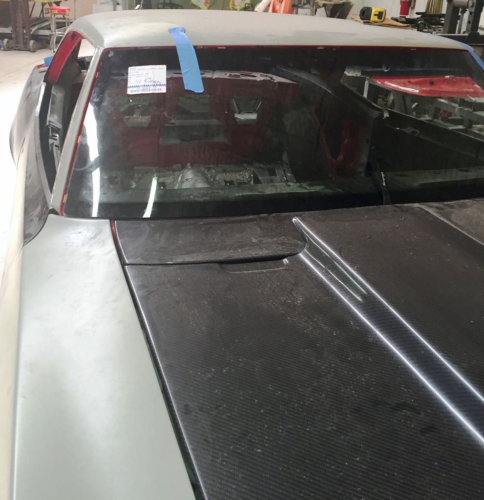

cjfirstgen 09-01-2015 07:54 PM

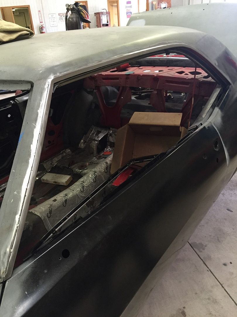

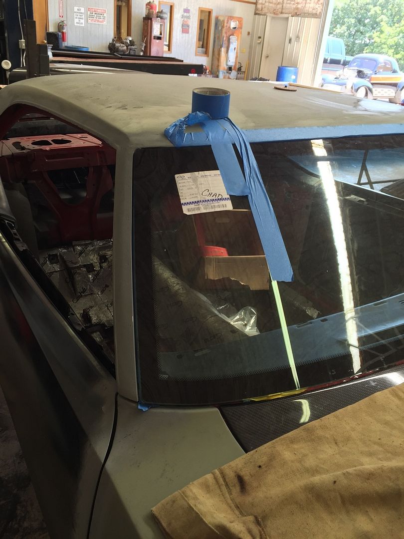

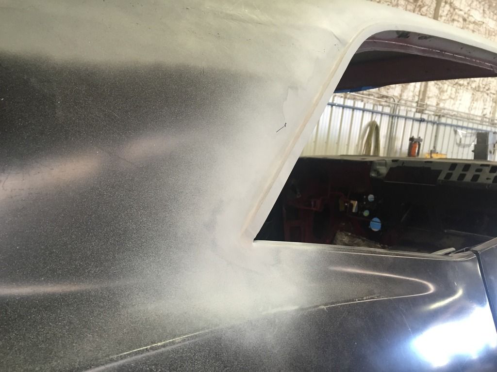

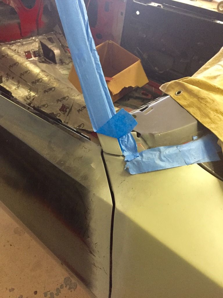

Getting close on the flush glass fitment. Extended the A-pillar and changed the body line on the fender. Needs finishing but happy with the results.

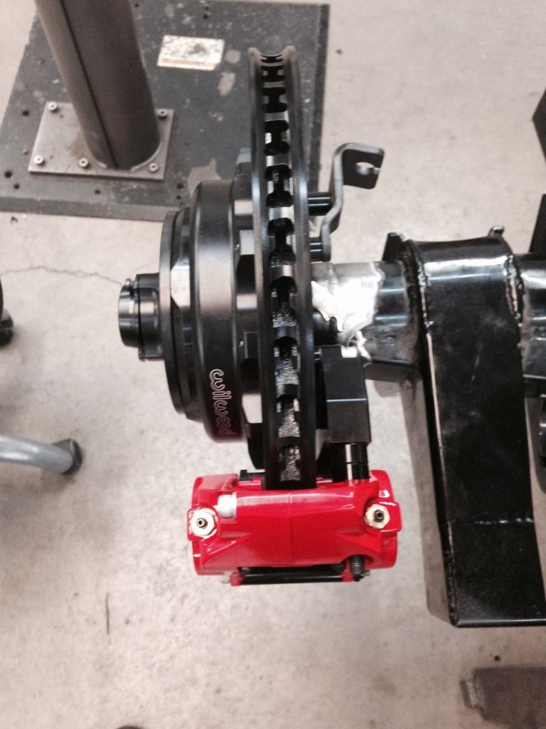

cjfirstgen 09-11-2015 02:03 PM

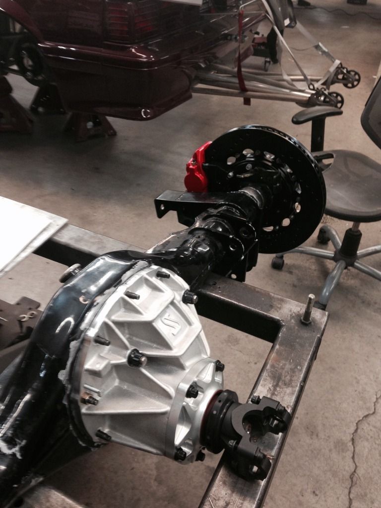

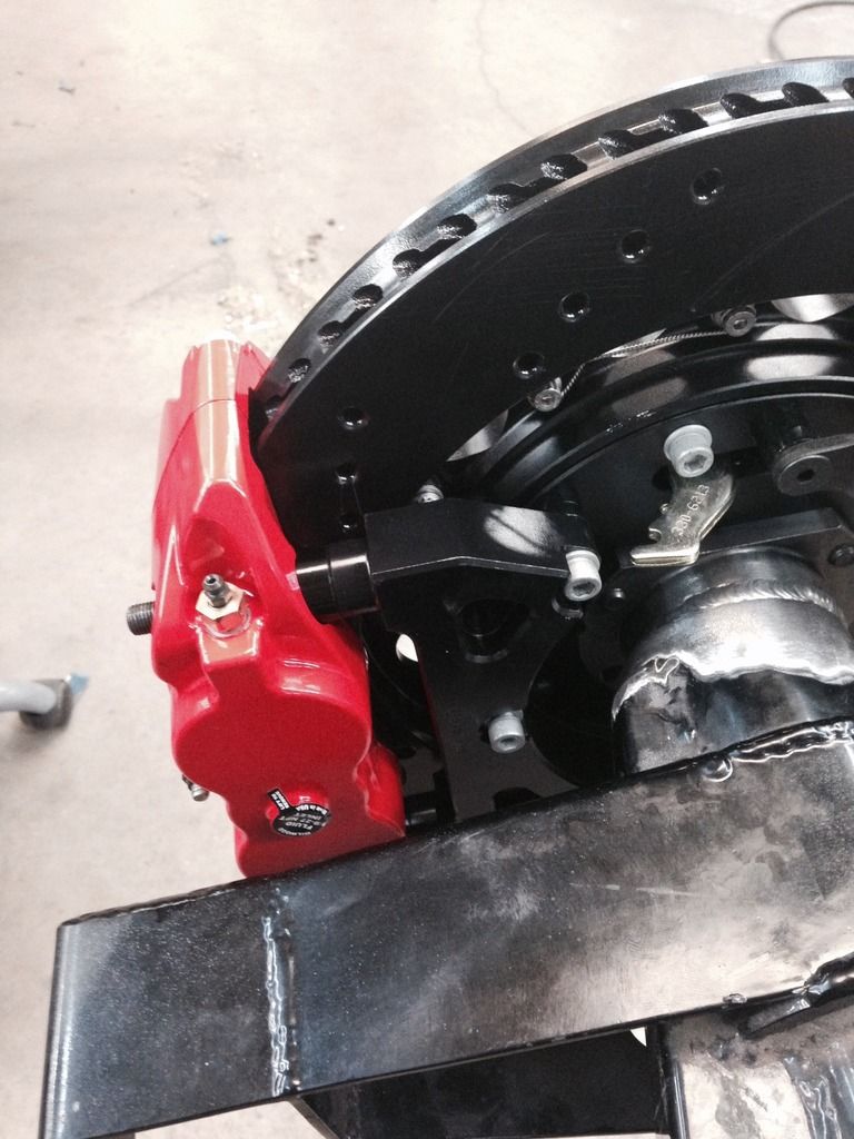

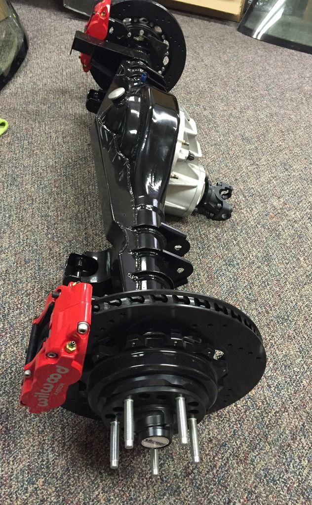

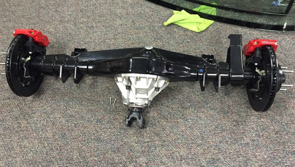

Some final test fitting of the floating axle and brake kit before powdercoat.
http://i305.photobucket.com/albums/n...psdhjxmwc8.jpg
http://i305.photobucket.com/albums/n...psrezzyqlc.jpg
http://i305.photobucket.com/albums/n...psqr05zgnx.jpg
http://i305.photobucket.com/albums/n...psinlogwbh.jpg

Getting closer on the semi - shaved drip rails. Or at least that is the best way to describe them. The finished result will be more of a body line feature but also functional where it mostly hides the window seal.

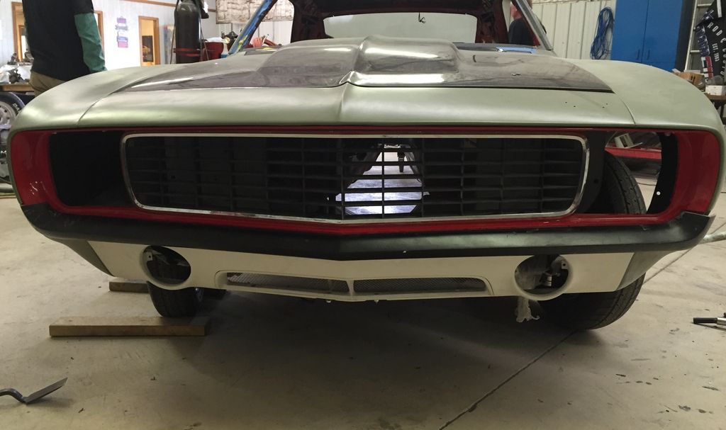

cjfirstgen 11-04-2015 03:23 PM
Not a bad starting point. Passenger side needs some metal work while the driver side needs both bumper and fender modification. Will look good when finished.

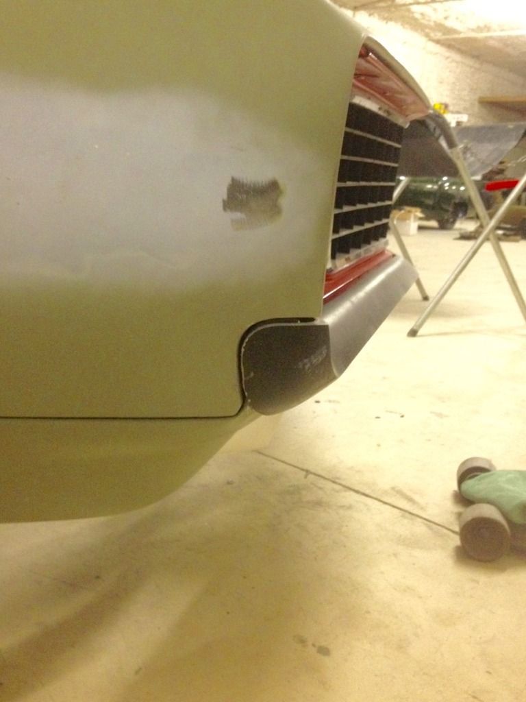

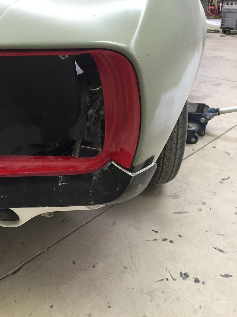

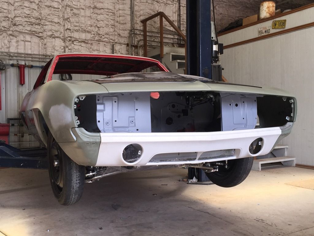

Little bumper adjustment.
http://i305.photobucket.com/albums/n...psmeukggll.jpg

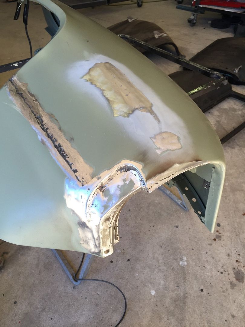

cjfirstgen 11-06-2015 02:16 PM

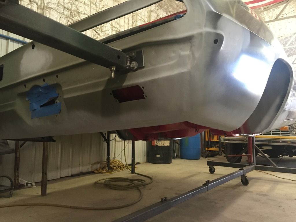

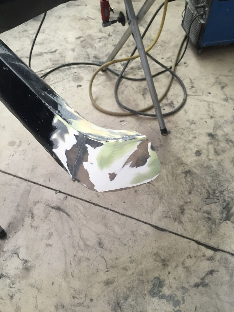

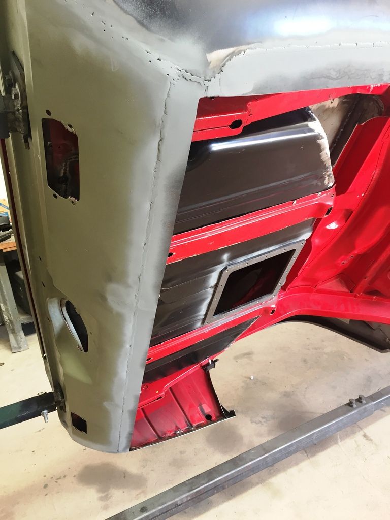

Some fender modification. Fender extension welded along with some body line adjustment for bumper fitment. Will finish welding with the Tig and silicon bronze filler rod then blend.
http://i305.photobucket.com/albums/n...ps4govgfc5.jpg

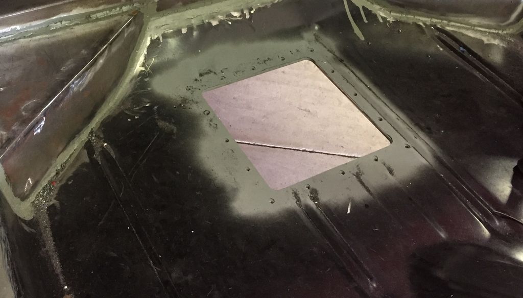

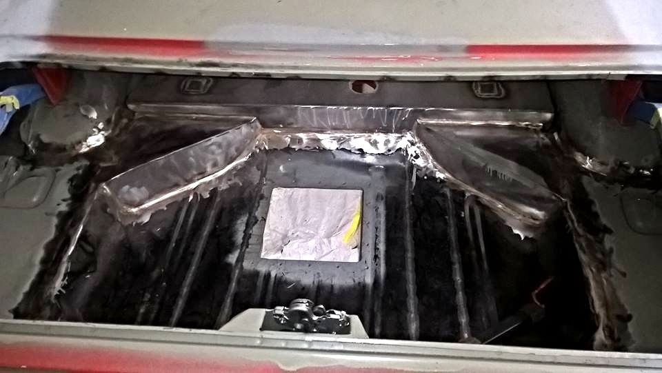

cjfirstgen 11-06-2015 02:21 PM

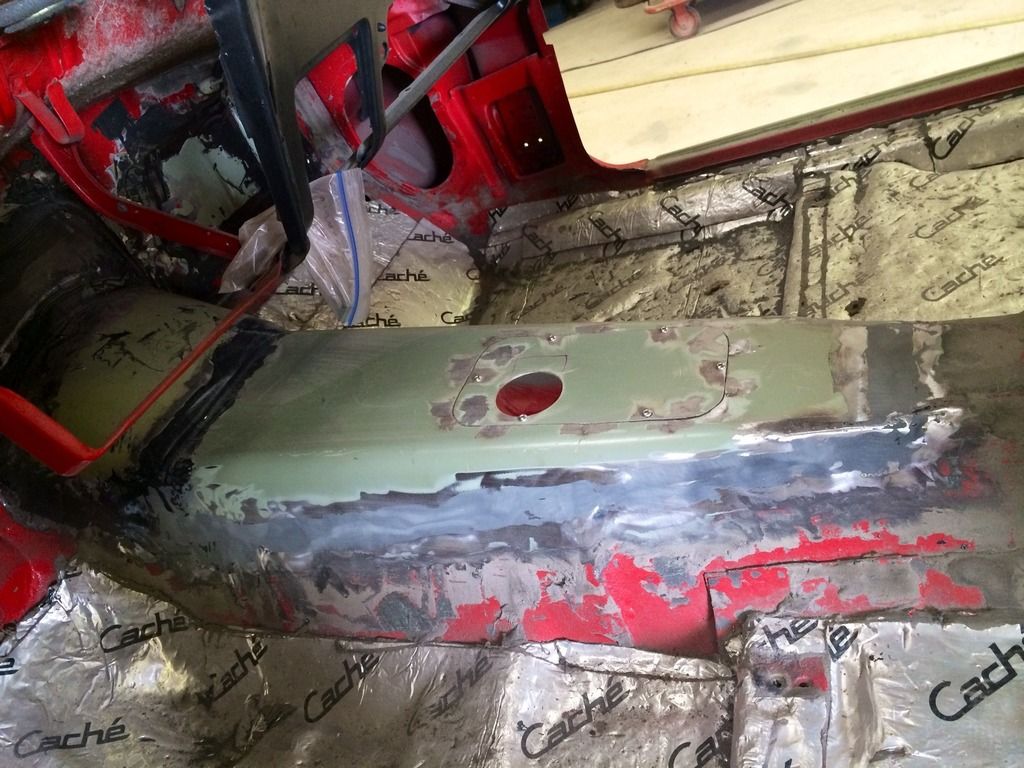

Function over form for the fuel pump access panel on account of being centered over the pump as opposed to the trunk pan. It will be covered by carpet anyhow. Then back on the rotisserie for more finish welding with the tig.

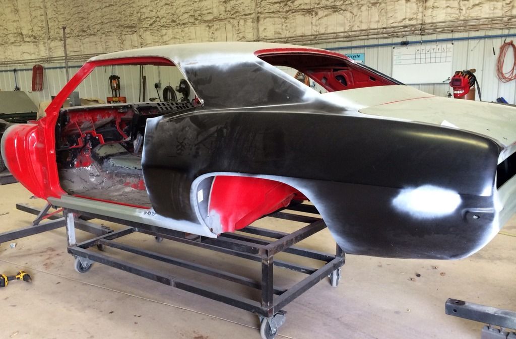

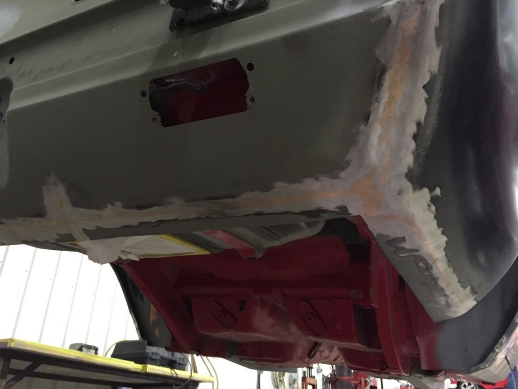

Roughed in some rocker sections on the tailpan and rear quarter. Should make for some clean body lines.
http://i305.photobucket.com/albums/n...psfl4o79qo.jpg
http://i305.photobucket.com/albums/n...pspllq5m8h.jpg

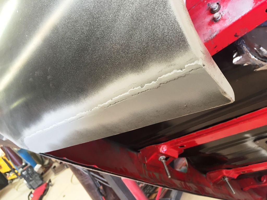

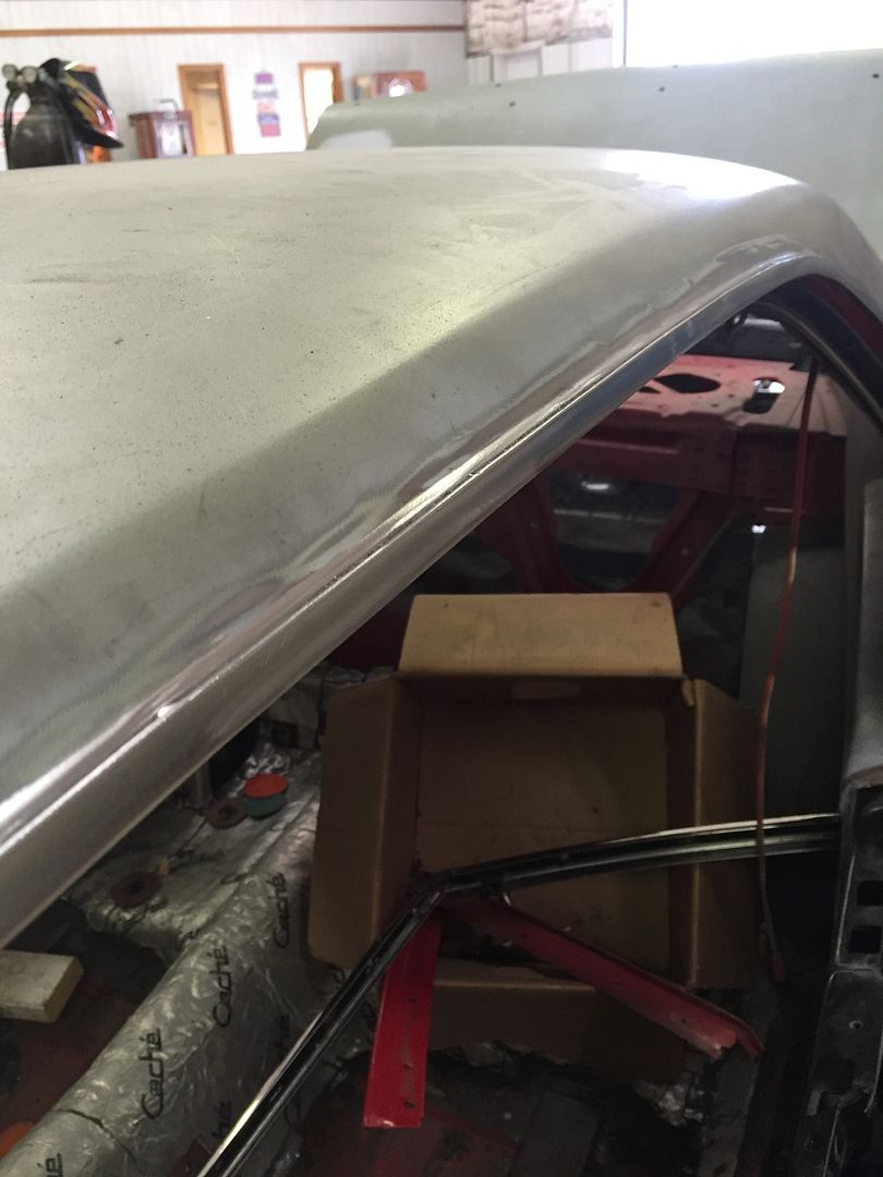

Drip rail metal work completed. The edge will be more subtle once it is body worked. Cleaning up the rest of the metal work. The quarter and tail panel rocker extensions turned out great. Subtle but a great finished look.
http://i305.photobucket.com/albums/n...pspj7m36lh.jpg
http://i305.photobucket.com/albums/n...psq6fmplhu.jpg
http://i305.photobucket.com/albums/n...ps4ivekubo.jpg

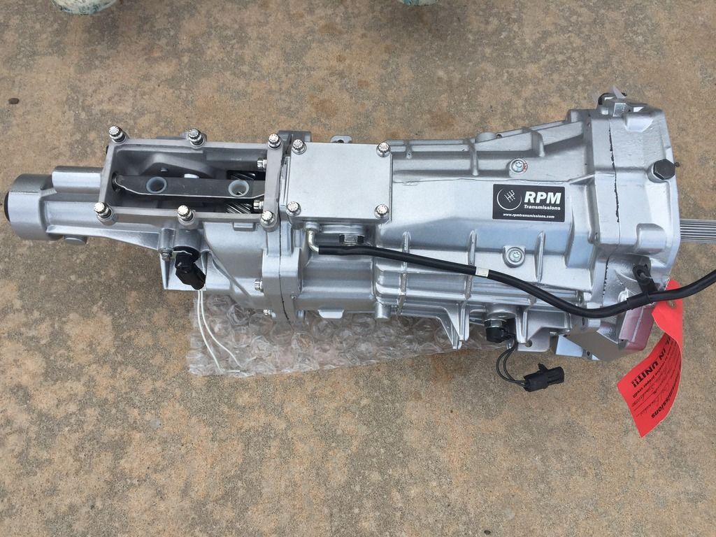

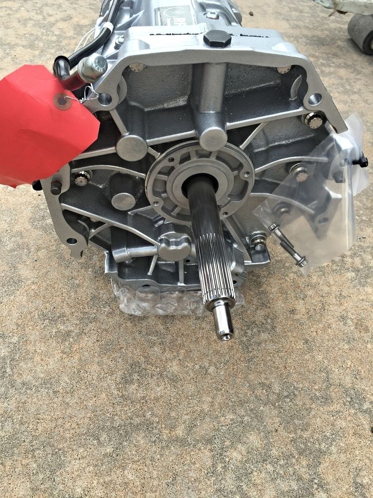

Quick turn around on the Stage VI treatment for the T-56. Powder coated case, ARP hardware upgrade, REM treated gears, bearings, billet input/output shafts, and other goodies.
