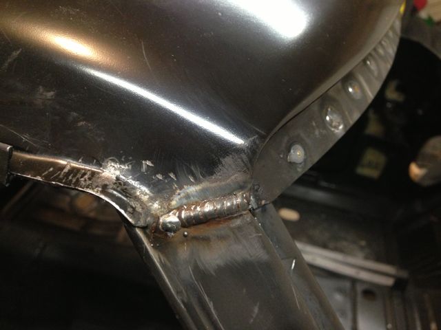

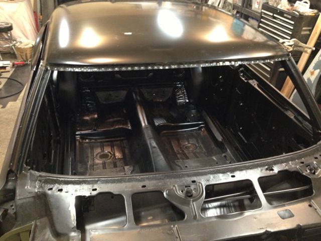

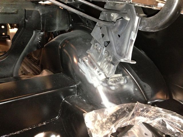

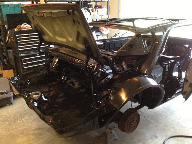

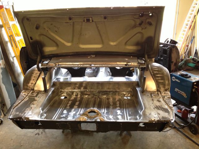

Everything's permanently welded from the seat pan back. Thankfully all the fitting and refitting paid off. Seat pans are level!

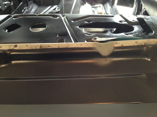

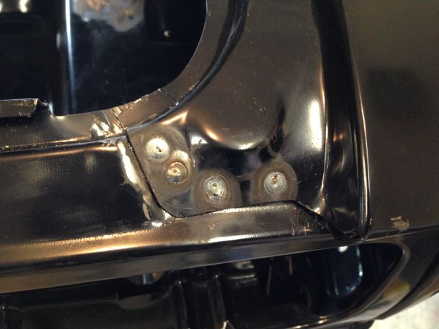

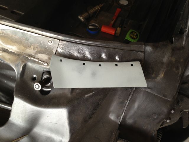

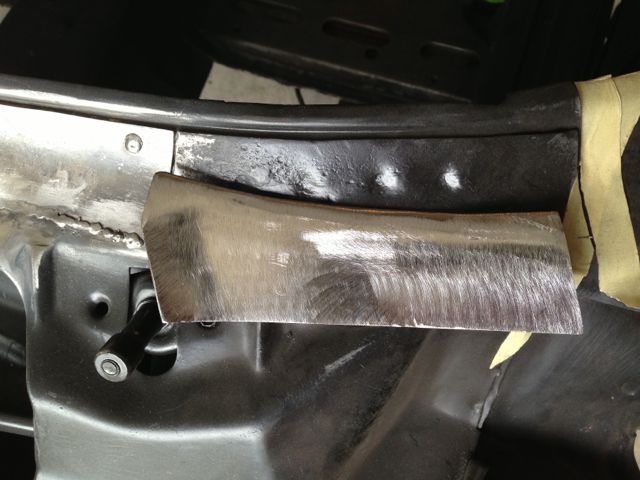

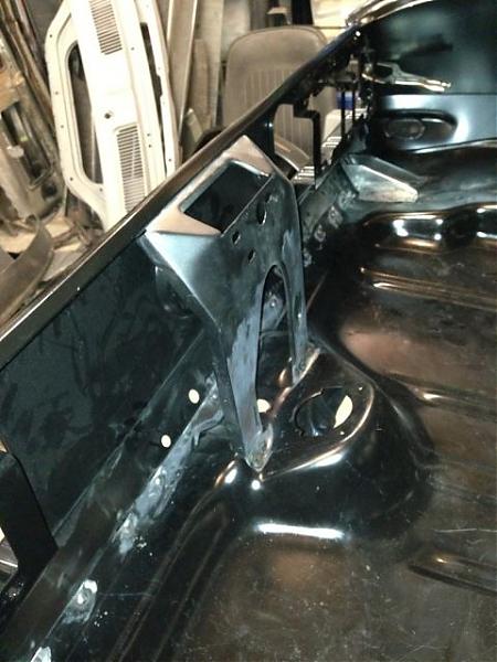

Firewall was torn where e-brake mounts. I made a thicker patch out of 16ga.
1 Attachment(s)

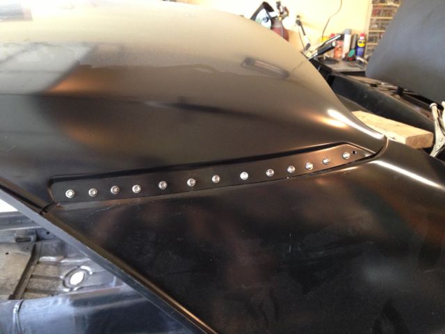

The original tore where the metal was thinner around each stamped recess so I made one recess out of heavier gauge metal. I'll finish this up when I finish the cowl box.

Awesome job on the patch I would never have know you did anything there.

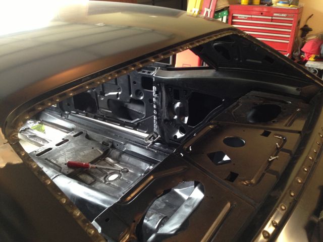

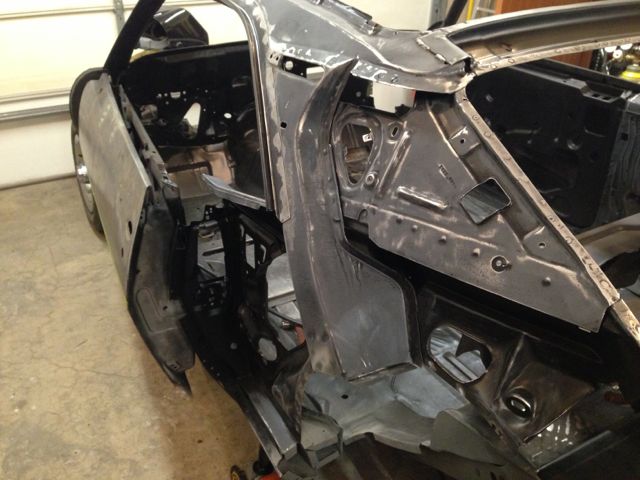

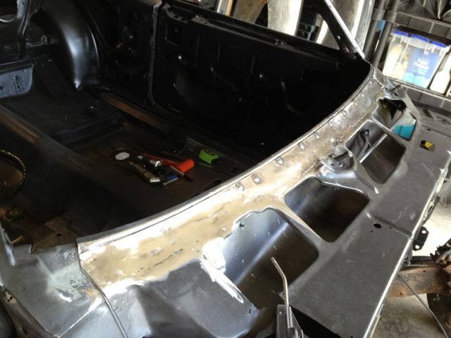

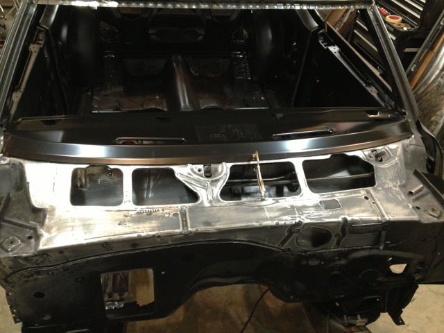

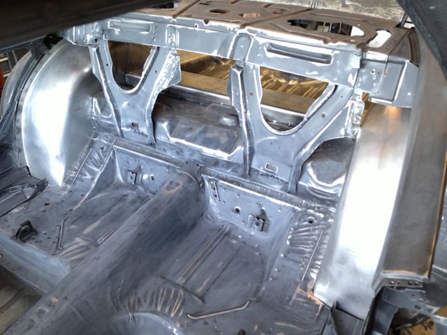

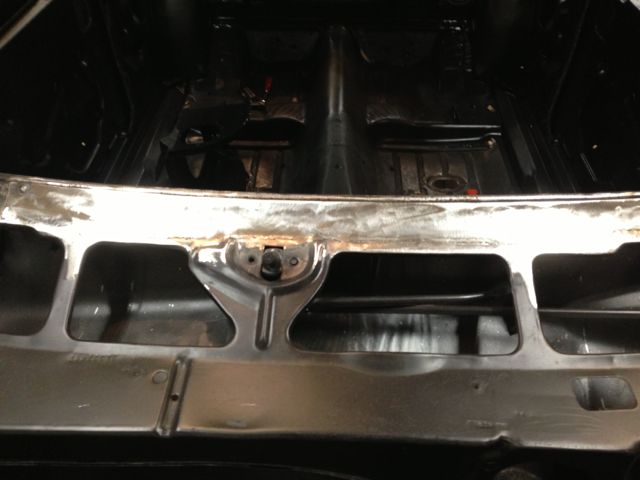

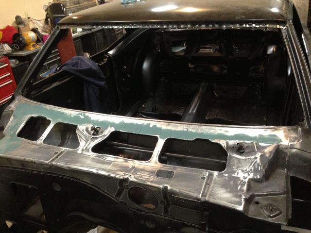

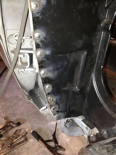

Drivers side cowl box was way off. I had to reshape the radius that meets with the upper cowl and lower it about 1/2". I sliced each side and hammered it into shape. Once I had it the way I wanted I welded in pie shaped pieces to fill the gaps.
1 Attachment(s)
Fits a lot better now.

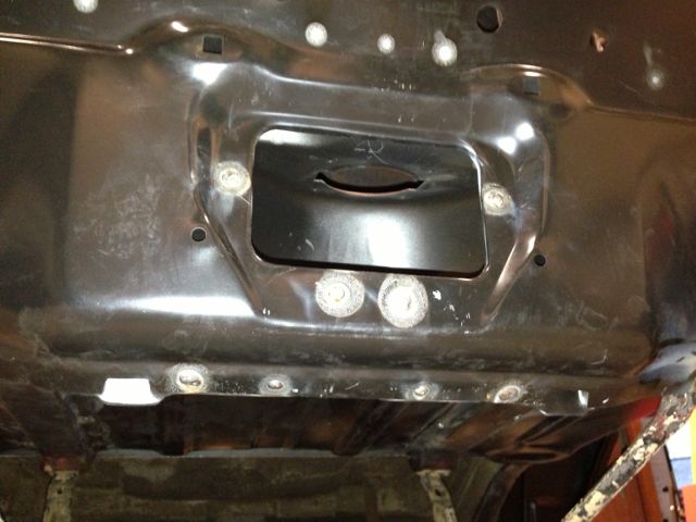

Finished grinding plug welds and sanding the interior. I sprayed the floor in black SPI epoxy.

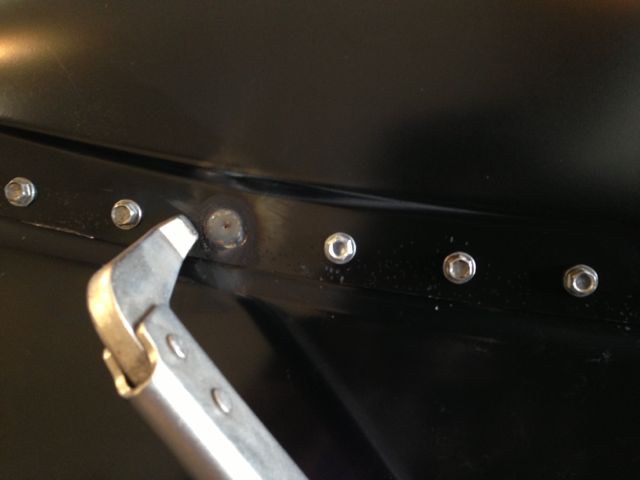

I also sprayed the cowl box kick panel area so I can weld the cowl box in. The passenger side is ready to be seam sealed so I'm trying to catch up on the drivers side. 2k epoxy in a spray can would be handy for areas like this.
