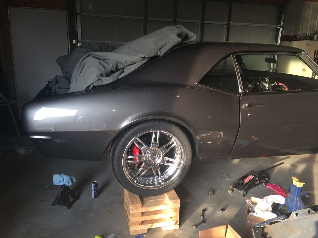

Got the wheels and tires mounted up for some mock up for the moser rear and 4 link next week...:relax:
http://i802.photobucket.com/albums/y...pstkgq8m7w.jpg
http://i802.photobucket.com/albums/y...pstr6k76hz.jpg
http://i802.photobucket.com/albums/y...psrb3s2u9e.jpg

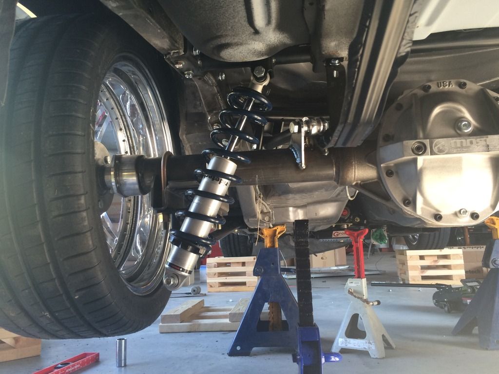

Smitty68 05-07-2015 07:41 PM

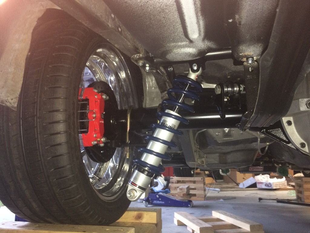

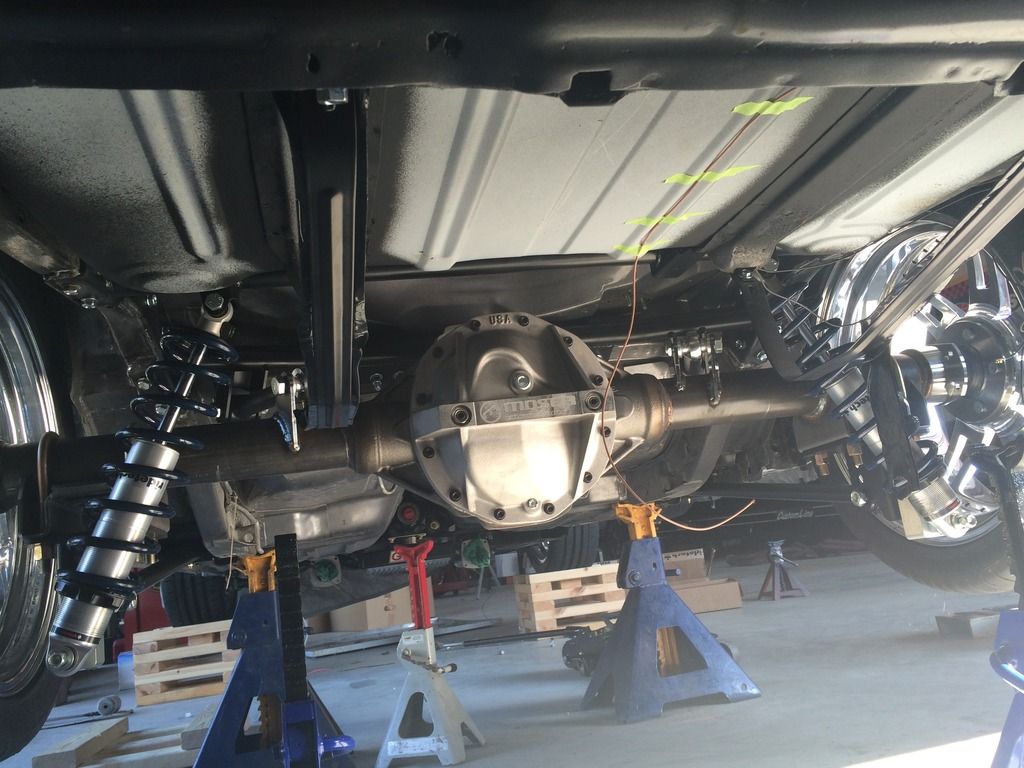

Finally got a few things done this week. Got the Moser 12 bolt and Ridetech 4 link installed. Got to take it back out for paint but going back in should be easier than the first time....:gitrdun:
http://i802.photobucket.com/albums/y...psk5w6qm4h.jpg
http://i802.photobucket.com/albums/y...psyhiiqjdc.jpg
Brakes should be here next week!
paulk68 05-08-2015 04:08 AM
Looks awesome, I am about to start with my ridetech bolt in 4 link, how hard was the install? also how hard was getting the brackets welded on the rear end? Is it a stock width rear or did you shorten it?
tubbed69 05-08-2015 06:42 AM
Nice choice on the wheels,looks perfect with the color:trophy-1302:
Smitty68 05-08-2015 07:10 AM
It was a straight forward install. These old cars being assembled by hand gives a little bit of trouble from time to time with the cradle not seating into place like mine did. But with a couple of jacks and effort it slid right into place. The tabs weren't a big deal either. Just follow the instructions to a T and you will be fine. And the length on the rear end is stock with multi leaf perches made to order already welded up. I also went with the big ford ends for larger bearings and bolt in axles. If you want it narrowed I think they will build it to any lengths for no extra charge.
I called Matt and Kim at Matts Classic bow ties and they took care of me with everything.

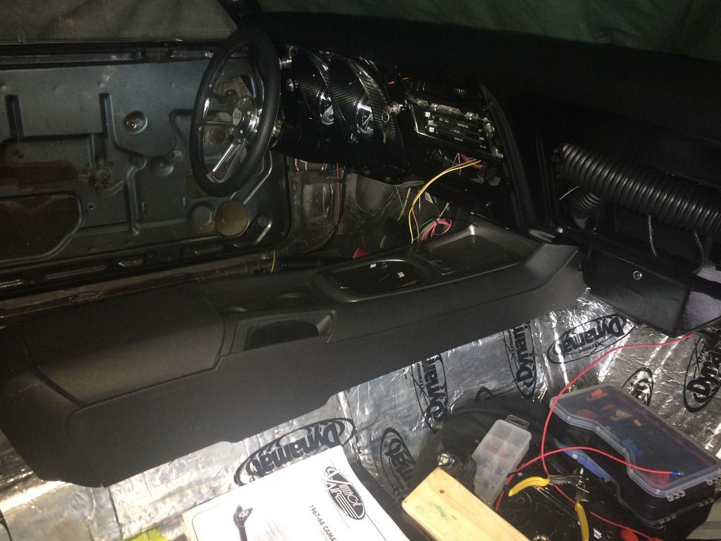

Love the way the gen 5 consoles looks in these cars so I had to try one out..:headspin:
http://i802.photobucket.com/albums/y...psbow5rpuj.jpg
Smitty68 08-22-2015 04:52 AM
Got a few more things to button up with the heater hoses and other misc. plumbing ..etc.. and apply the Hose Candy skins and should be done for first fire up of the motor.
http://i802.photobucket.com/albums/y...pstk4c137a.jpg
jwcarguy 08-22-2015 08:35 AM
Smitty,
You will be happy with the 5th Gen console!
I love mine!
Maybe swap out the plastic lid for a leather covered one??
I love the carbon fiber gauge housing too, Anvil part?
Jeff
Smitty68 08-22-2015 02:44 PM
Yes they are Anvil.
http://i802.photobucket.com/albums/y...pssryfg8tw.jpg
I plan on getting a boot and a cover like yours.

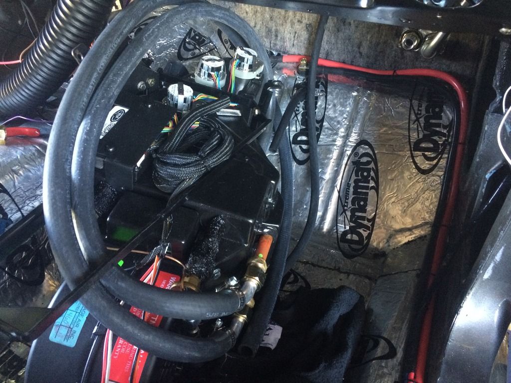

Get this caught up a bit since I haven't posted in a while. Got the A/C all buttoned up.I used the DSE mount along with the VA mount.
http://i802.photobucket.com/albums/y...psny9j3xw3.jpg

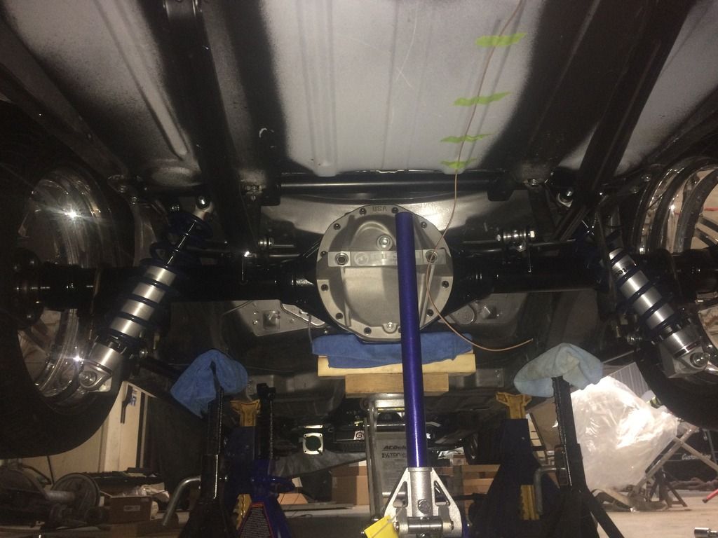

Got the rear end painted and brakes installed.
http://i802.photobucket.com/albums/y...psjdd2zbob.jpg
http://i802.photobucket.com/albums/y...psbohakmbm.jpg

randy 11-02-2015 08:06 PM
i thought the dse vintage air unit was only for the 69? Any issues with our 67 and 68 camaros?
http://www.detroitspeed.com/1967-196...V-bracket.html
Smitty68 11-02-2015 08:12 PM
It has to be modified a bit and doesn't take too much thinking to do. If you need pics I have some of it before installing.
randy 11-02-2015 08:13 PM
pretty simple to do ? I would imagine so since it only mounts on 3 spots on the car. Thank you
Smitty68 11-02-2015 08:18 PM
Here are a few pics Randy if they help. These things have been done many different ways and mine isn't any better than the others it's just the way I chose to mount it.
http://i802.photobucket.com/albums/y...psweiqokli.jpg
http://i802.photobucket.com/albums/y...pskakxo9cq.jpg
randy 11-02-2015 08:23 PM
thank you. Not sure what i see that you changed but I'm sure when i start mocking it up it will jump out at me.
Summit racing thanks you lol
Smitty68 11-02-2015 08:37 PM
Yes the smaller piece that bolts to the main part of the bracket I didn't use. I cut part of it and used the smaller pieces that came in the kit to make the two you see on the left side. The one that's curved towards the passenger side of the unit bolts to the radio brace in the dash. And the one that points straight up towards the cowl will bolt through the cowl inside the wiper transmission pocket. Just let me know if you need any other info.

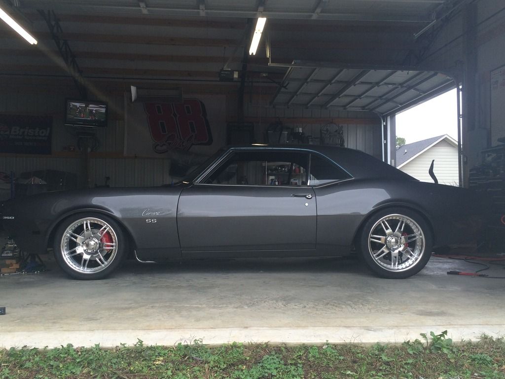

Smitty68 11-05-2015 06:44 PM
Finishing the front end tomorrow to fire the motor Saturday hopefully!
http://i802.photobucket.com/albums/y...pshikjdzyo.jpg
DEIGuy38 11-05-2015 09:46 PM
Car looks really good, love the wheels and stance. Good luck on the motor fire up.
