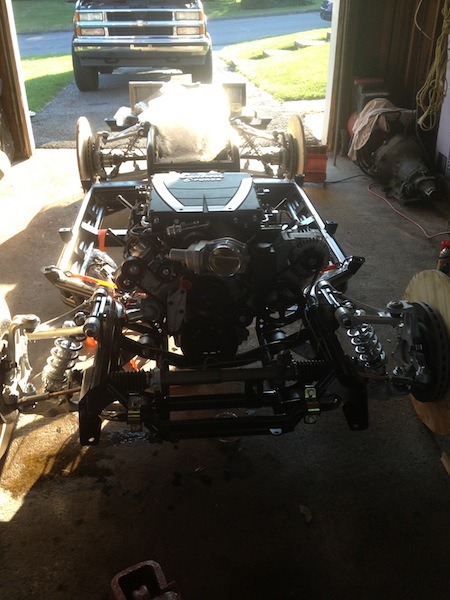

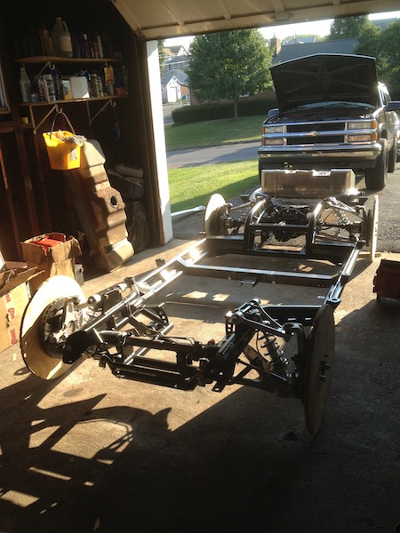

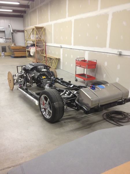

SRIII Motorsports custom frame c6 corvette suspension LS9
9 Attachment(s)
SRIII frame and c6 corvette suspension, Custom gas tank, removable crossmember
Attachment 41450

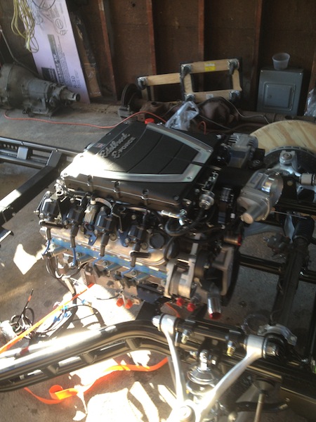

Ls9 on engine hoist in background
Attachment 41451

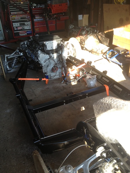

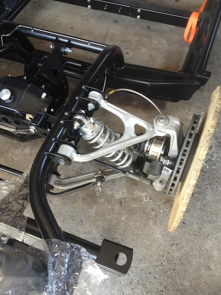

Ls9 added to SRIII frame
Attachment 41452
Attachment 41453

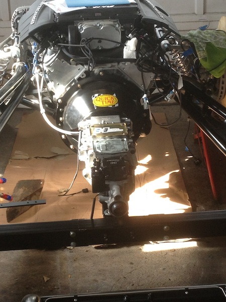

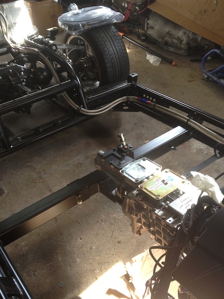

Will add Transmission this week-
had to cancel Keisler SS700 since no one can tell me a definite ship time. Will be using the Hurst TKO600
Attachment 41454

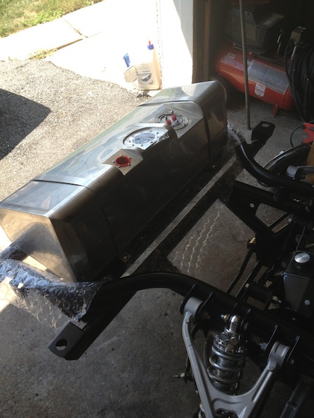

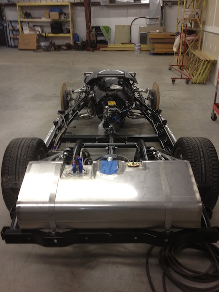

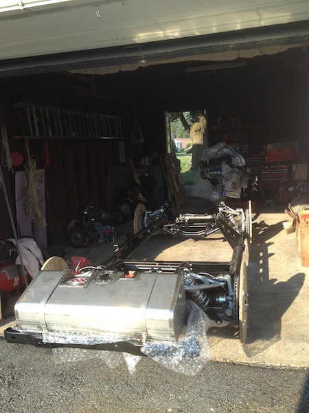

Custom gas tank
Attachment 41456

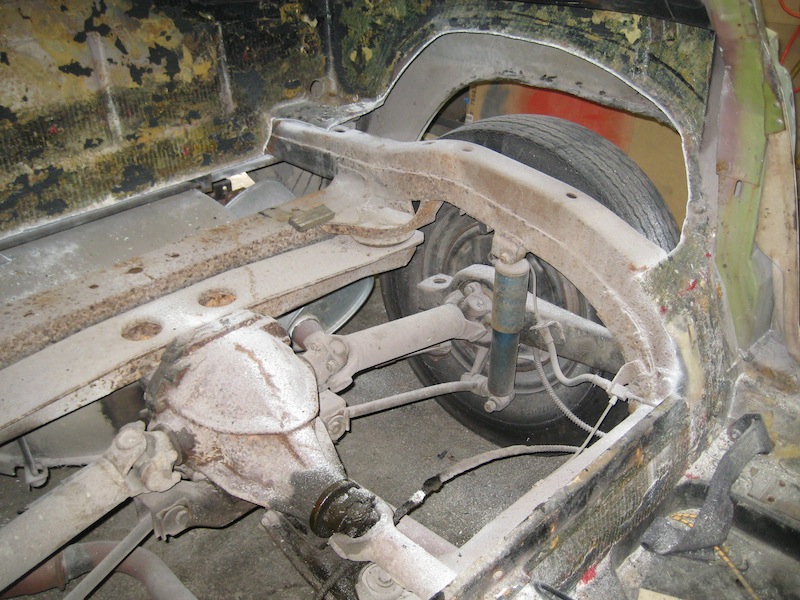

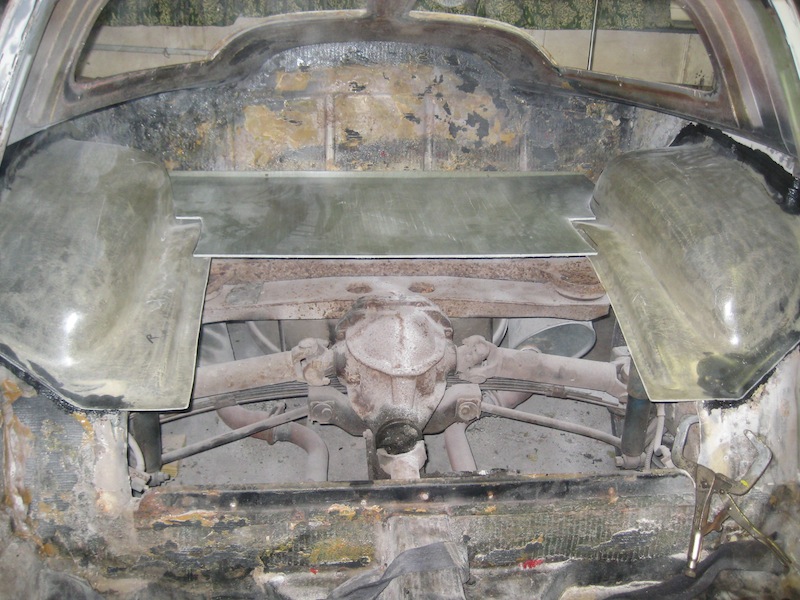

cutting the rear of the floor so that c6 suspension etc fits
Attachment 44763
Attachment 44764
Attachment 44765
Attachment 44766

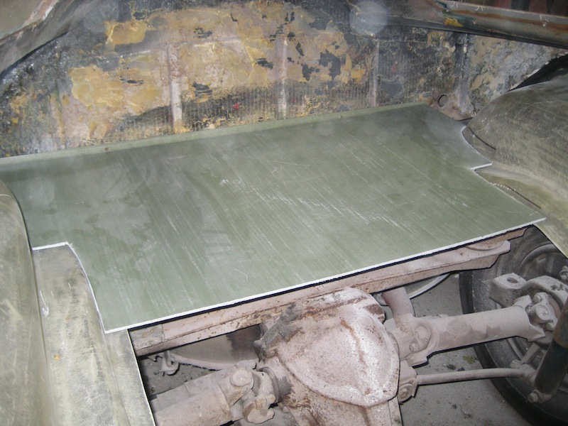

getting idea for placement of fiberglas tubs
Attachment 44767
Attachment 44768
getting idea for new fiberglass floor placement
Attachment 44769
Attachment 44770
Attachment 44771

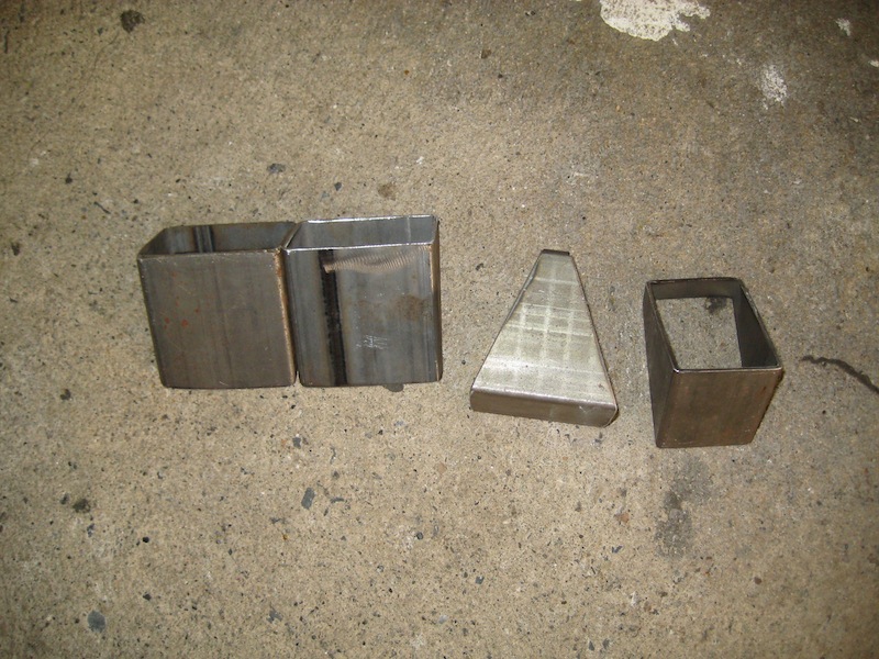

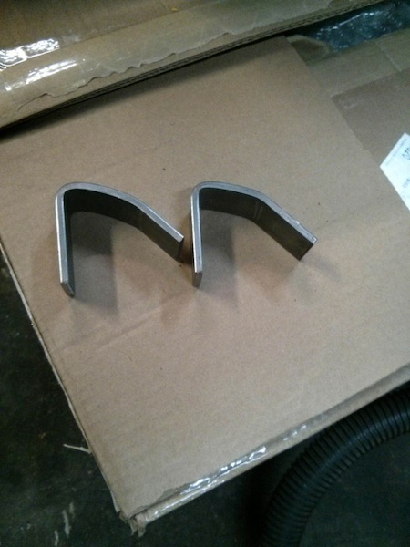

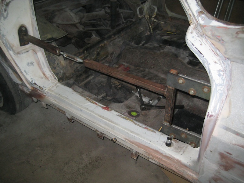

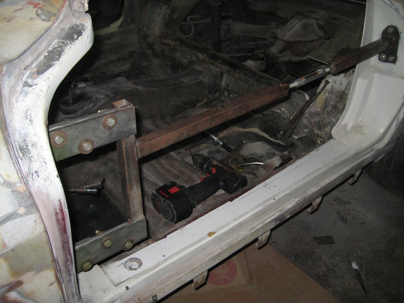

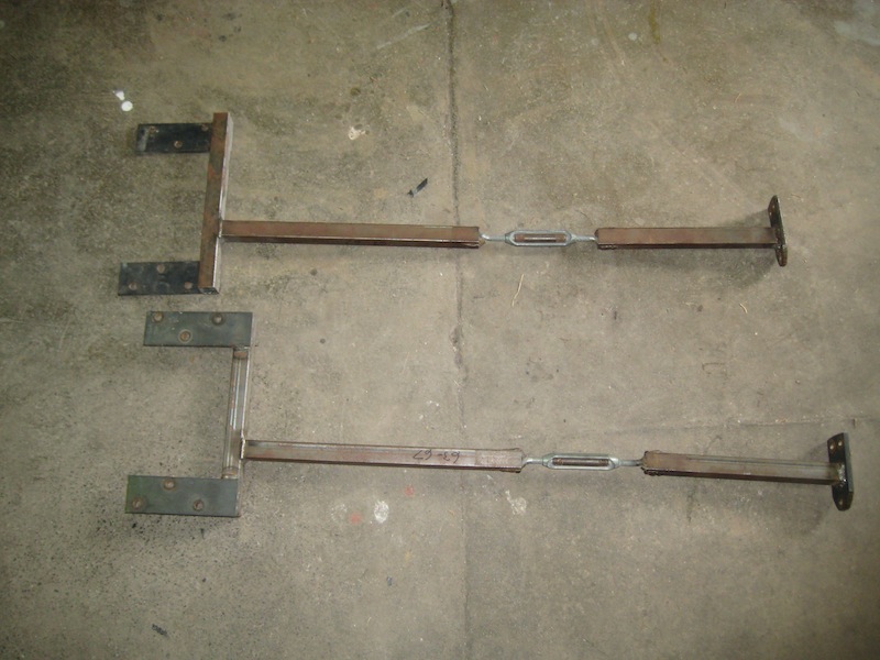

making brackets to go in door jambs to keep body from flexing and will provide additional lift points for when moving body off old chassis to new
Attachment 44772
Attachment 44773
Attachment 44774

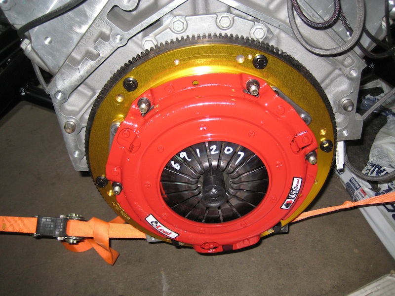

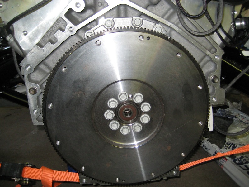

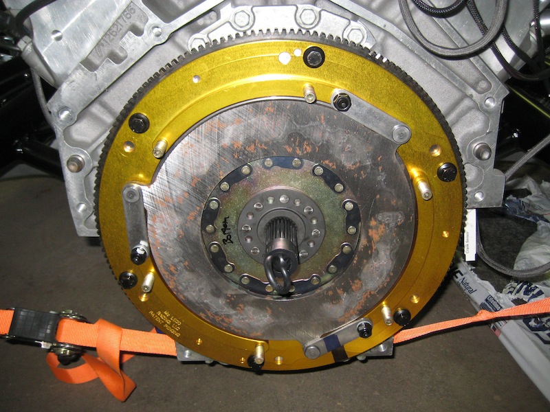

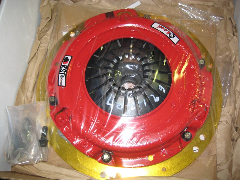

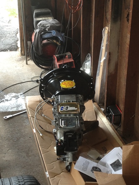

tko 600 transmission Hurst driveline direct fit for corvette with Hurst sidewinder II side mount shifter. Flywheel bolt kit for LS9 (9 bolt). Quicktime SFI TKO scatter shield , McLeod RST Twin Disc Clutch-700HP +
Attachment 44775
Attachment 44776
Attachment 44777
Attachment 44778
Attachment 44779

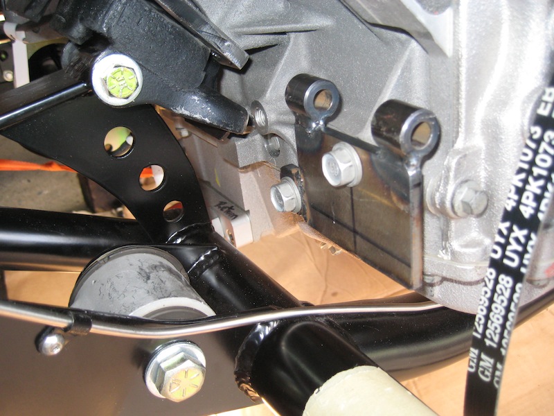

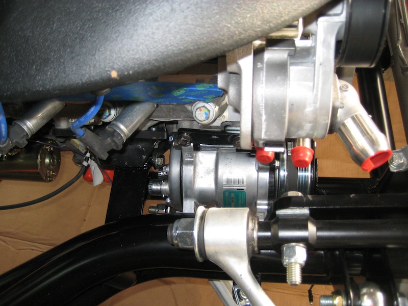

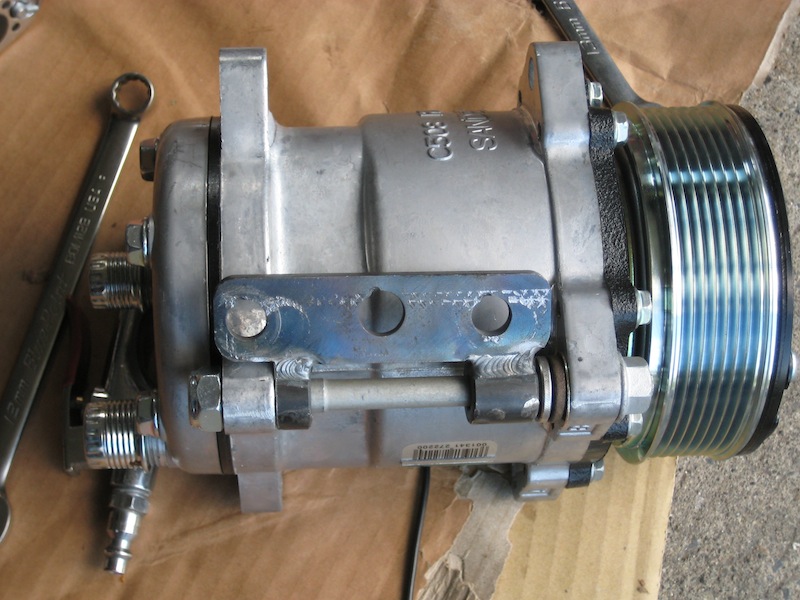

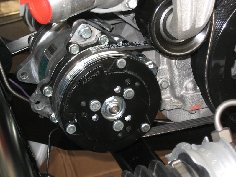

custom bracket made for attachment of AC compressor so that it can be placed in stock location for better look.
Attachment 44780
Attachment 44781
Attachment 44782

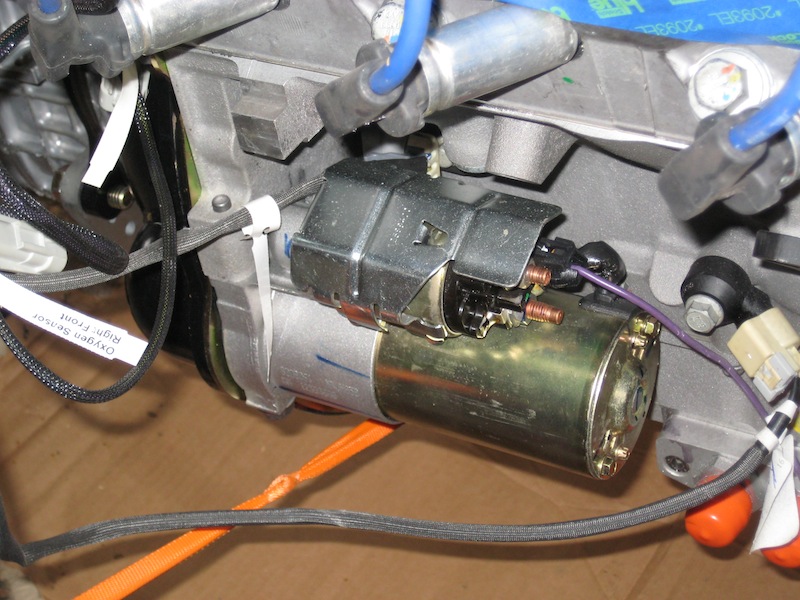

starter put in place
Attachment 44783

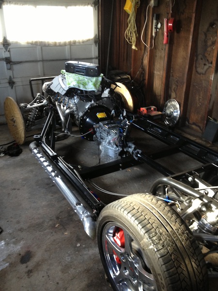

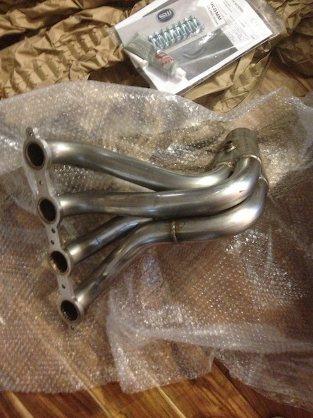

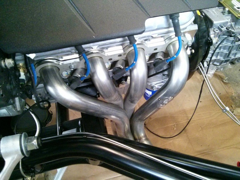

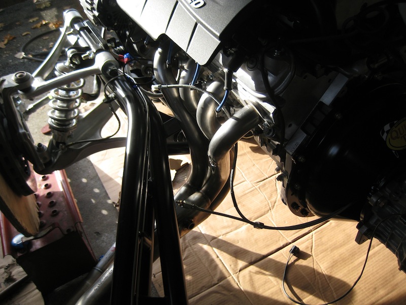

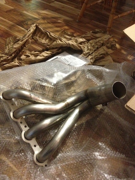

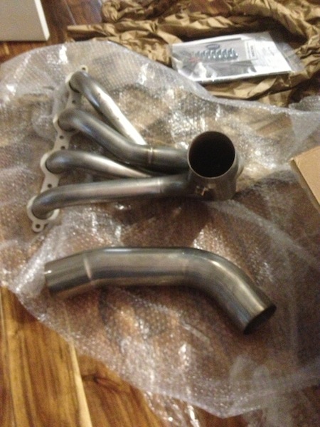

stainless works headers
Attachment 44785

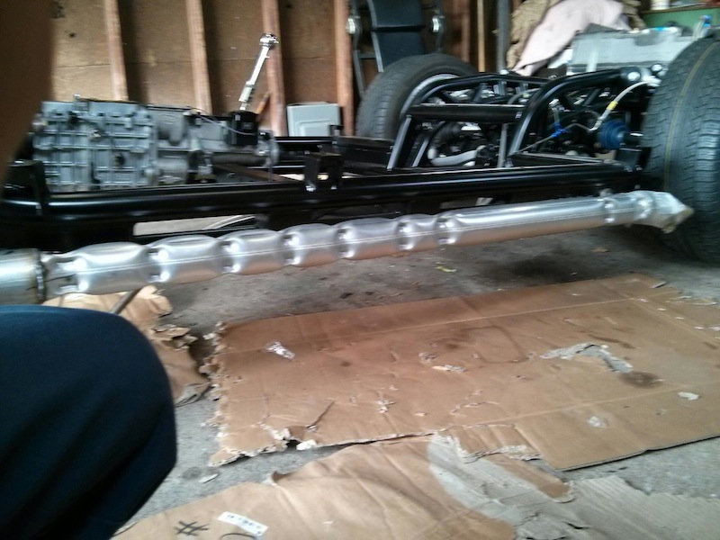

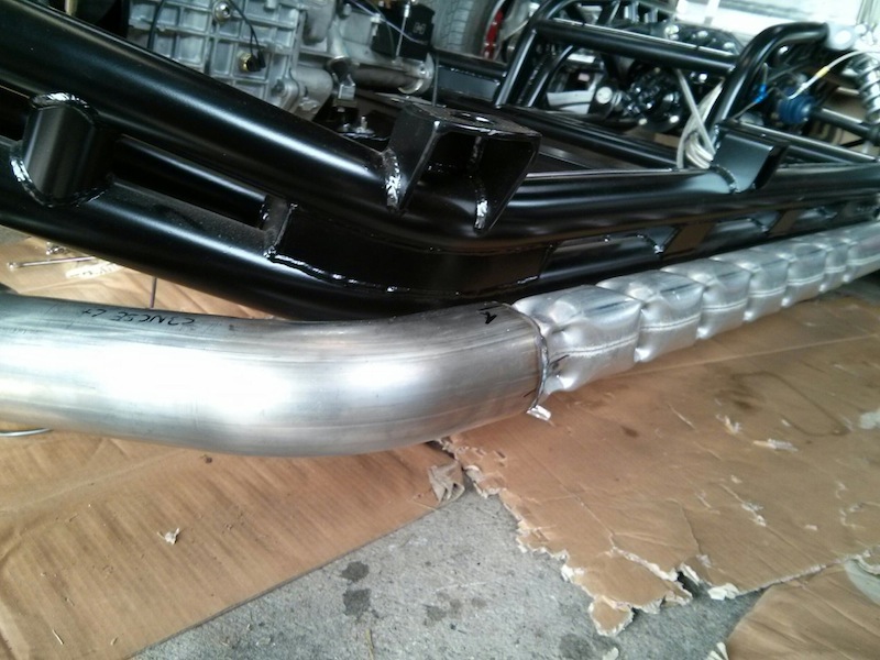

Side exhaust put into place. Fabricating custom brackets to hold side exhaust
Attachment 44786

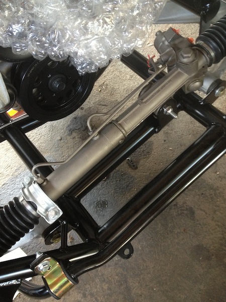

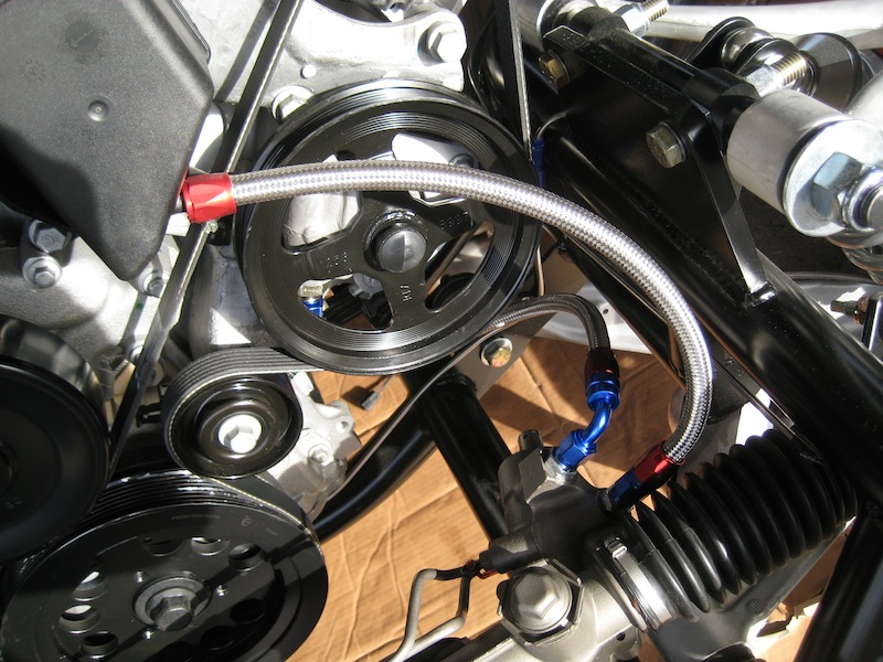

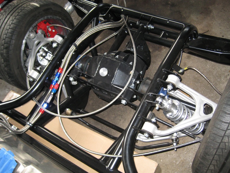

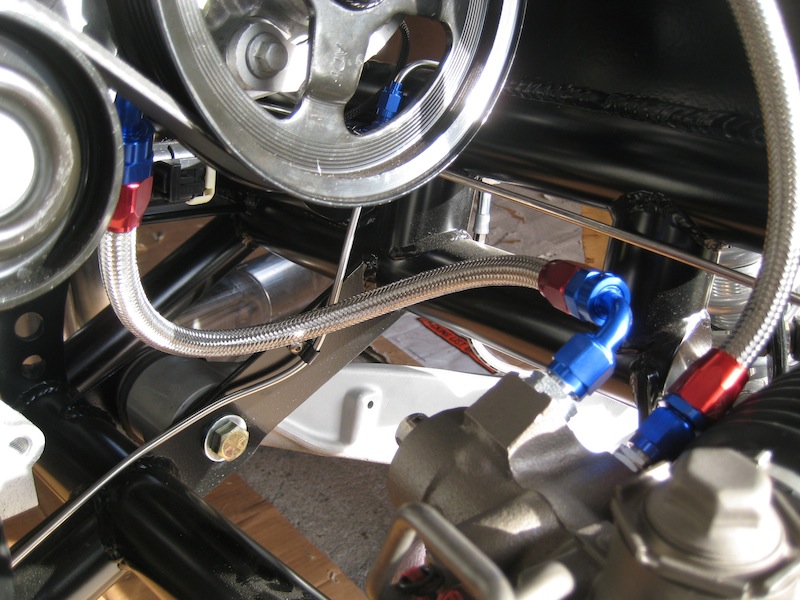

power steering braided lines
Attachment 44787
Attachment 44788

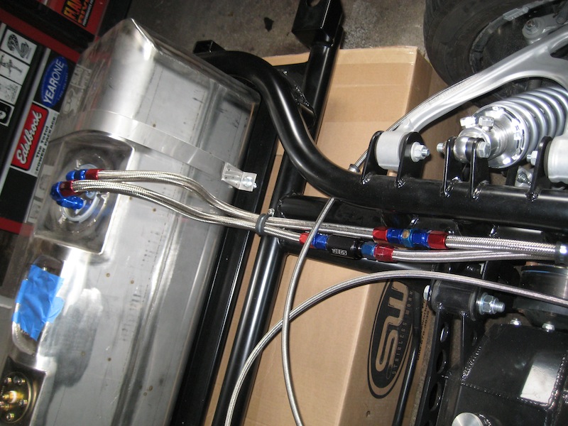

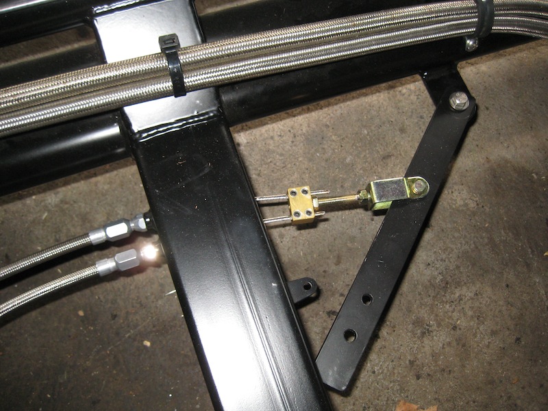

Gas lines brake line
Attachment 44789

e brake lines ran with custom setup
Attachment 44790

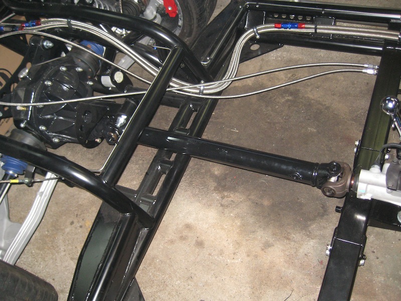

gas lines from tank
Attachment 44791

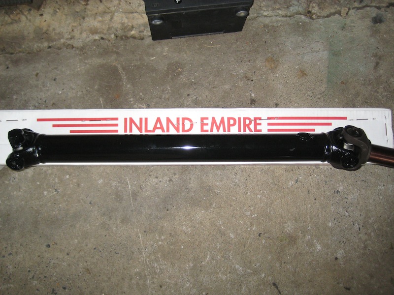

custom driveshaft from inland empire- chrome molly
Attachment 44792
driveshaft installed

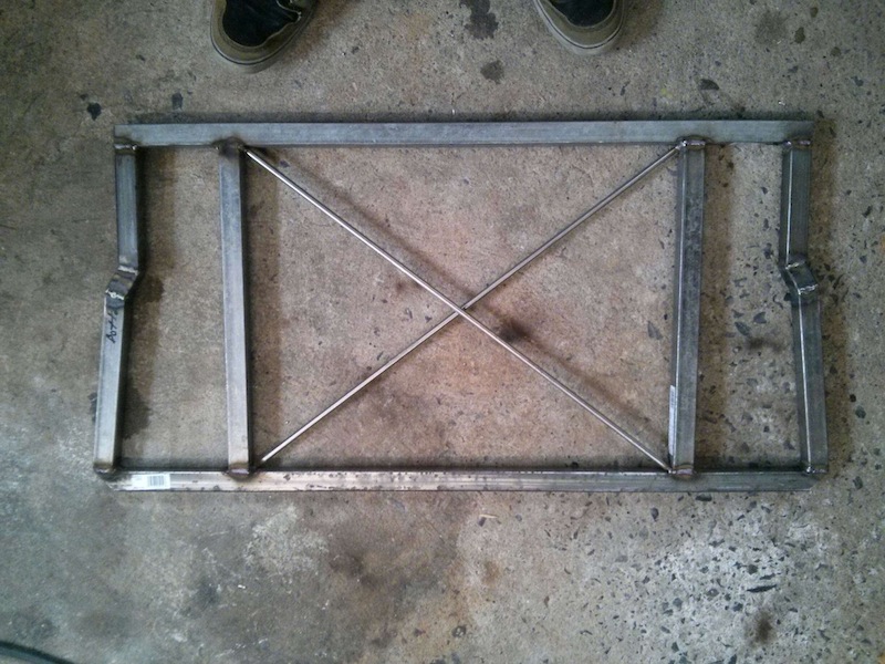

beginning of fabrication of radiator support
Attachment 44794
brackets fabricated to attach radiator support
Attachment 44795

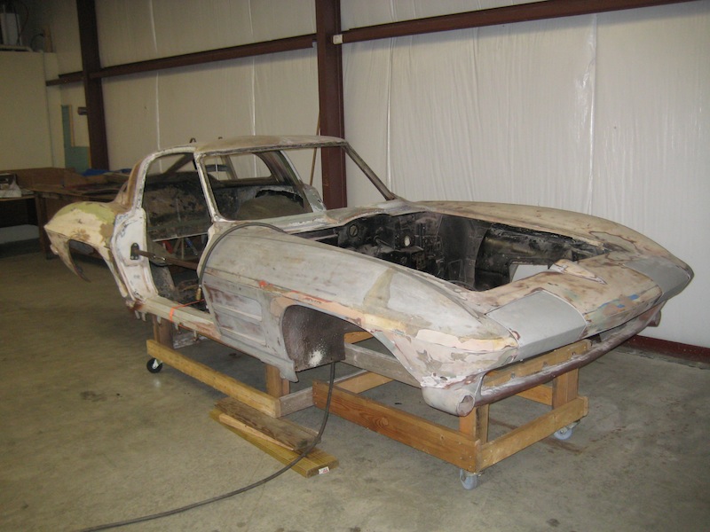

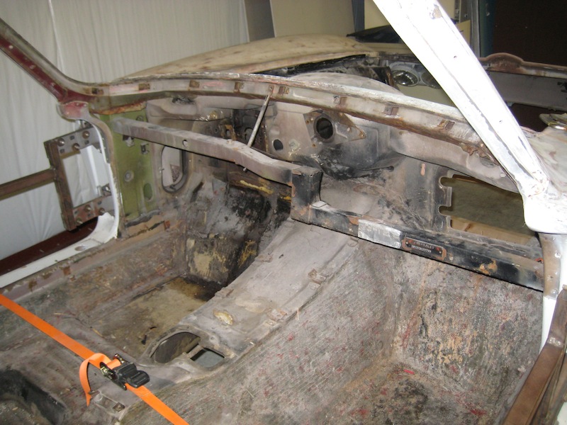

body off old chassis on dolly
Attachment 44796
Attachment 44797
cut to fiberglass to get body to fit new chassis-rough cuts for now
Attachment 44798

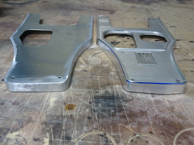

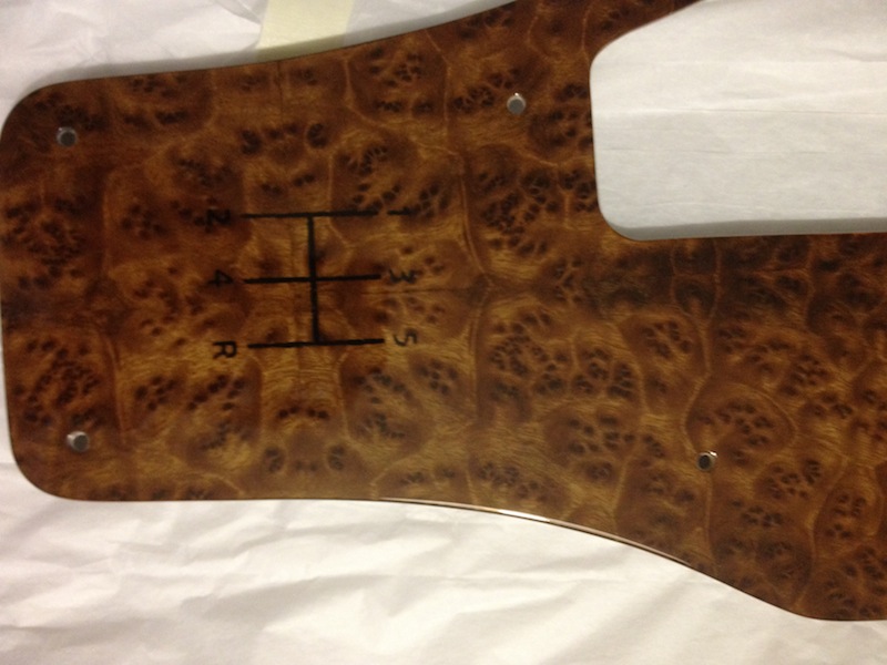

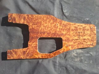

work on shifter console
7 Attachment(s)

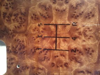

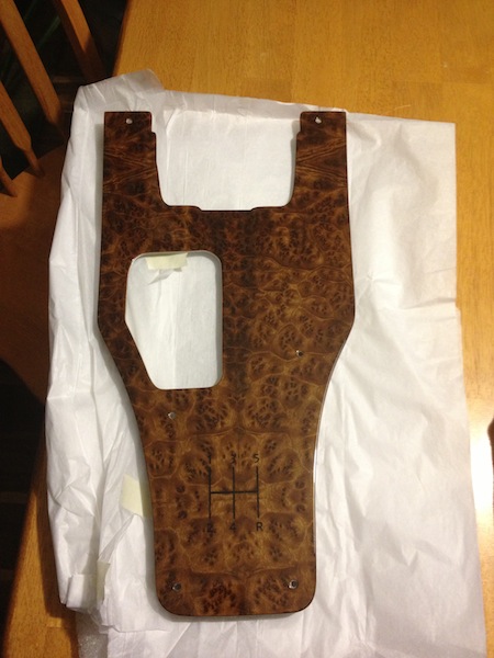

original 63 shift console and fabricated one

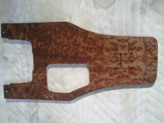

Attachment 44853
burlwood added with laser cut 5spd shift patten
Attachment 44854
Attachment 44855
Attachment 44856
Attachment 44857
Attachment 44858

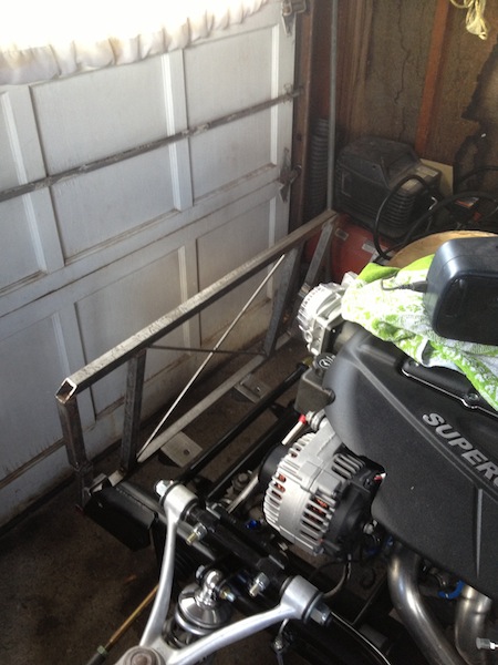

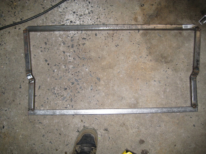

Attachment 44867
Attachment 44868

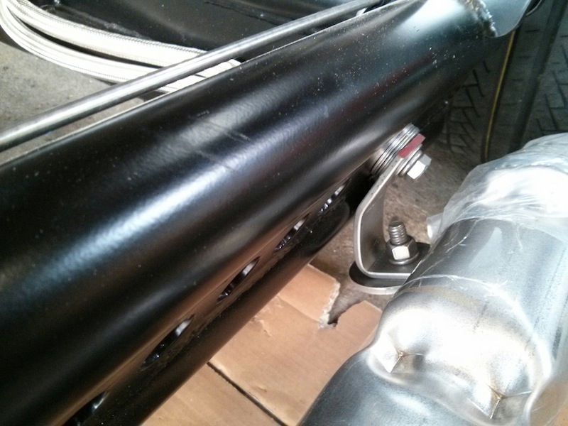

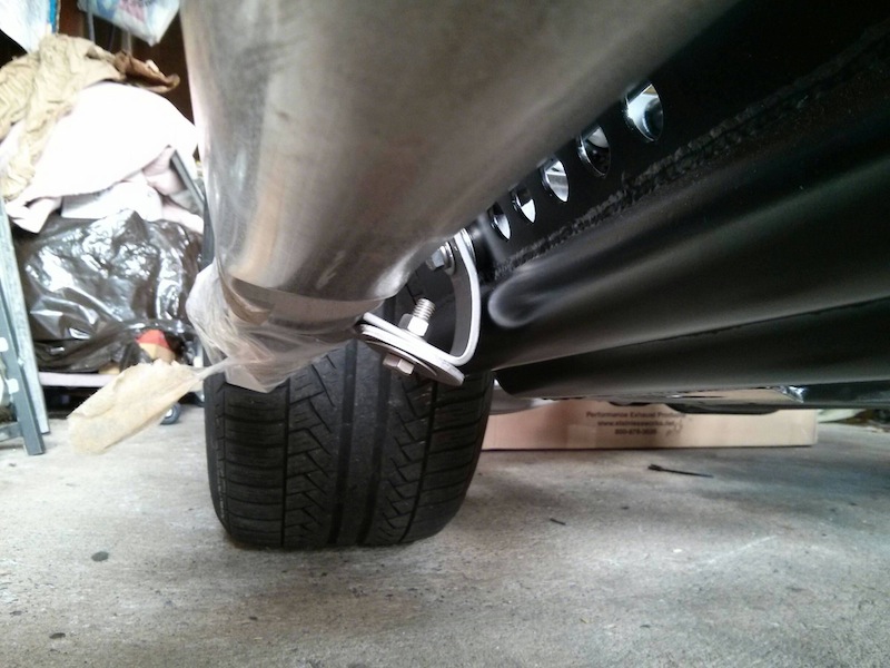

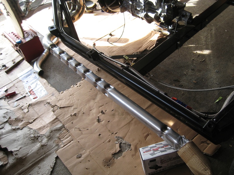

brackets fabricated for side exhaust attachment
Attachment 44869
Attachment 44870
Attachment 44871
Attachment 44872
Attachment 44873

Stainless works headers
Attachment 44874
Attachment 44875
Attachment 44876
Attachment 44877

Tko 600
Attachment 44878
Attachment 44879
Attachment 44880
Attachment 44881
Attachment 44882

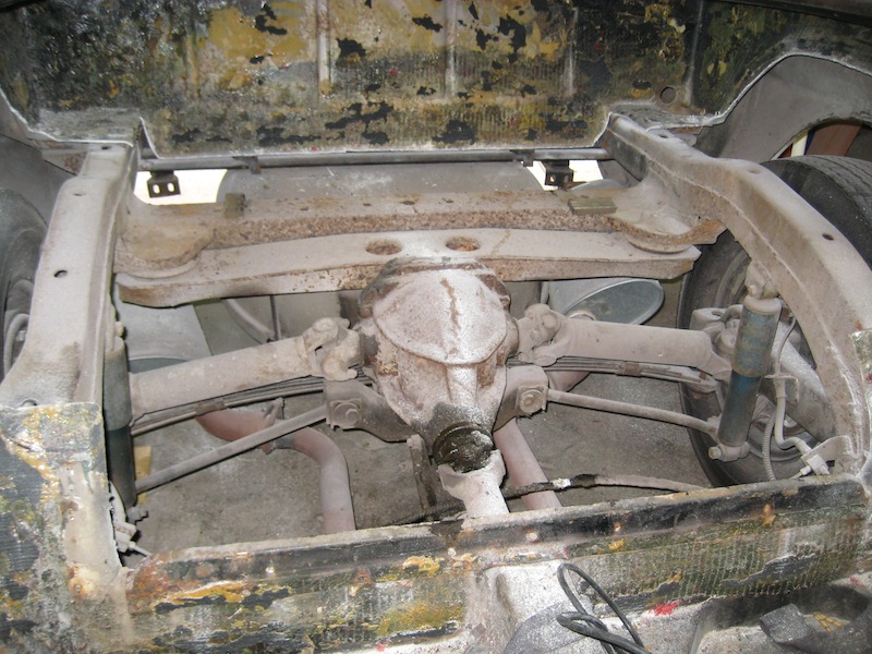

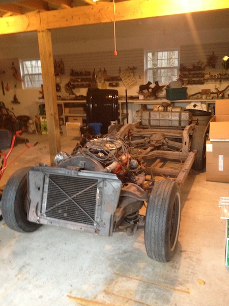

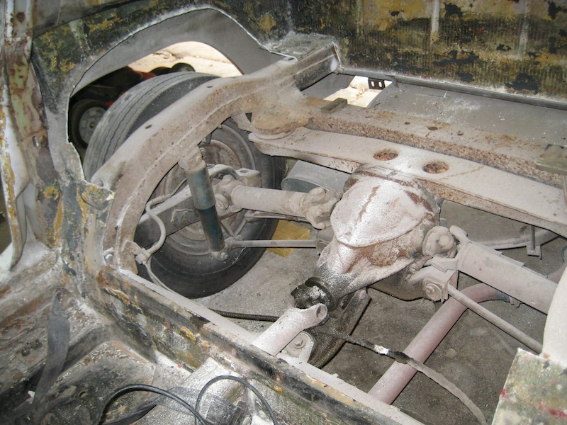

5 Attachment(s)

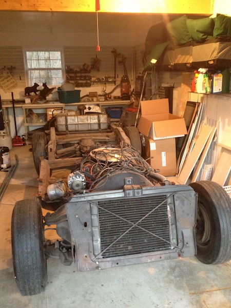

old chassis
Attachment 44883
Attachment 44884
new chassis
Attachment 44885
Attachment 44886
Attachment 44887

FLYNAVY53 01-19-2014 10:01 PM
Wow...nice project! Are those Stainless Works side pipes available, or was that a one off piece? Will they work with the factory frame?

Semel1 01-20-2014 11:47 AM
They are available. When I had SRIII make frame I had him modify so that we could use side exhaust.
http://www.stainlessworks.net/1963-8...t-headers.html
Not sure if they will clear stock frame.

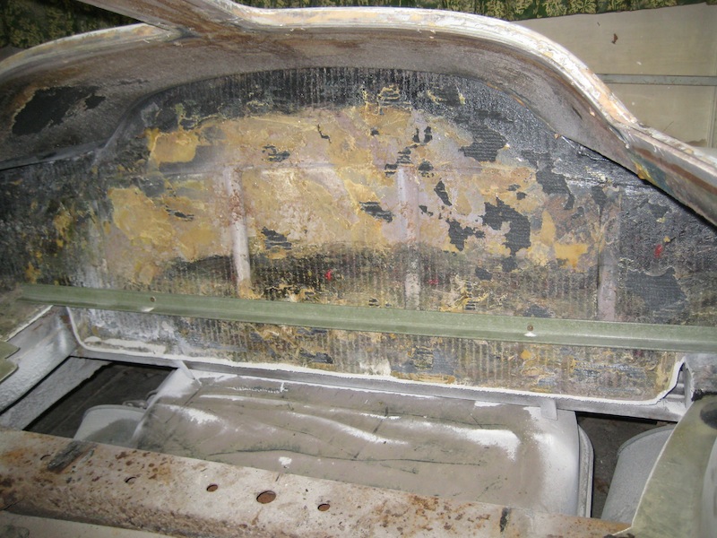

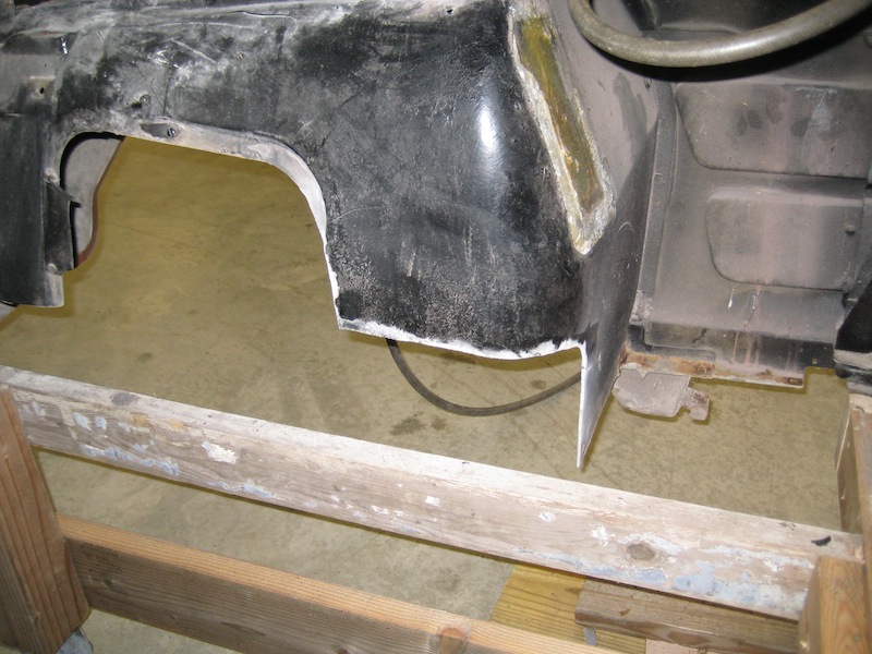

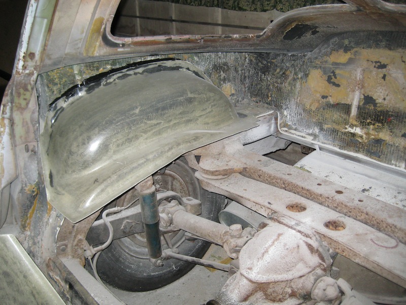

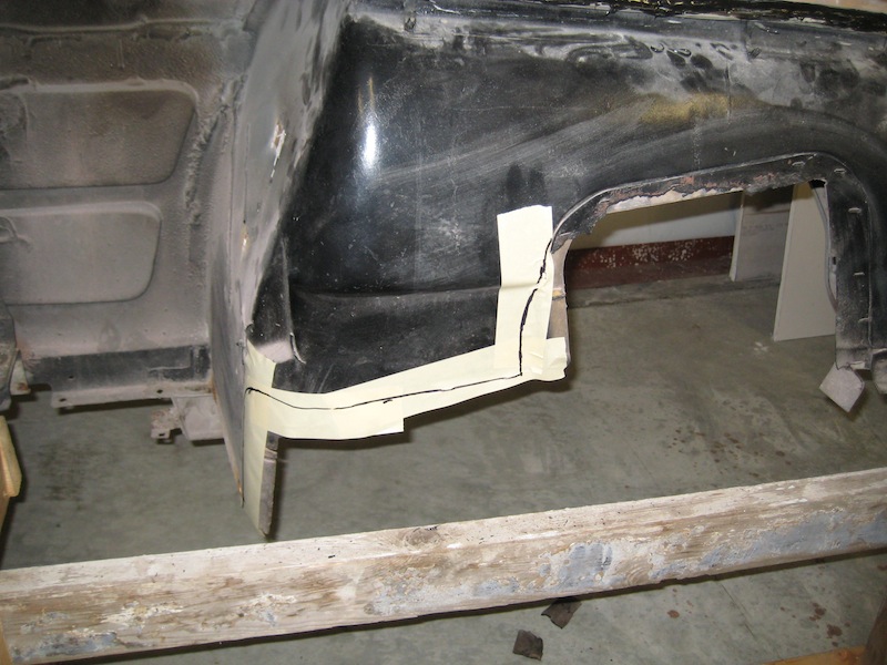

Well it has been some time since I was able to make a post. Some metal work was needed in the birdcage on the passenger side, which slowed things up. Mike Hacker at Outcast Precision Muscle Car did a fantastic job.
Original piece in rear fender well
Attachment 47550
New piece of fiberglass
Attachment 47551
Attachment 47552

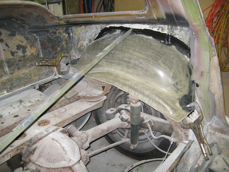

Fiberglass to cover metal piece in birdgage
Attachment 47555
Attachment 47556

Old fiberglass repair that was not done correctly
Attachment 47560
