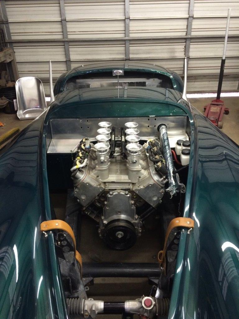

Motor back in.
Pappy
Attachment 55365
Attachment 55366

FLYNAVY53 08-24-2015 03:35 PM
Originally Posted by mfain (Post 609992)
Out of the body shop - time for the final LS install and some plumbing.
Attachment 54803
What size are the wheels and tires? I feel like you're building the Jag equivalent of the '69 Vette Im going to start working on this winter! British racing green (actually fathom green) and I have a stock 2003 LS6 that Im seriously considering the stack injection. Also planning on running those ET wheels but haven't settled on a size/tire combo yet. Great work so far....definitely one of my favorite builds in a while!!
mfain 08-24-2015 08:24 PM
275 on 17X9 up front, 315 on 17X11 in the rear.
Pappy

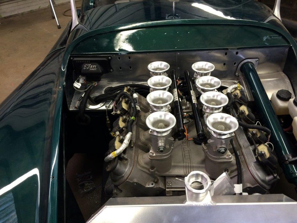

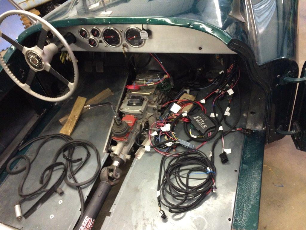

mfain 09-18-2016 04:56 PM
2 Attachment(s)
After an interruption (or two) for other projects, Robert is finally finishing the Jag. Ron Davis radiator installed and wiring going in.
Pappy
Attachment 59928
Attachment 59929
Kcrain 10-26-2018 02:34 PM
Any updates on the finished car?
mfain 10-26-2018 02:41 PM
Car is pretty much done, except for a reliable ECU. After 2 FAST controller failures and 3 harnesses, Robert is giving up on that product and is having another ECU/harness system built. Should be done soon and I will post some photos of it on the road. It looks great!
Pappy

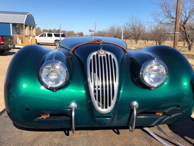

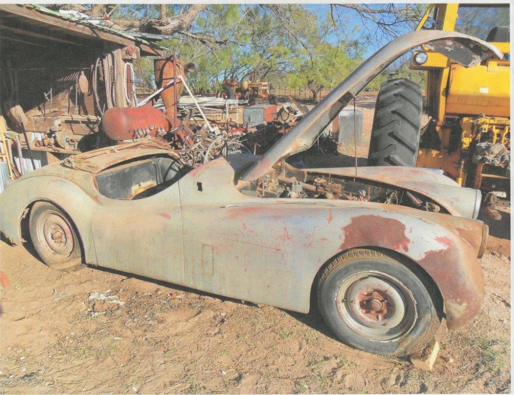

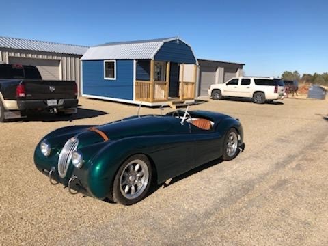

mfain 12-31-2019 12:10 PM
4 Attachment(s)
Long time since I posted photos - brother Robert's car is complete and looks/drives great!
From rags......
Attachment 70994

KiwiStarChief 12-31-2019 01:51 PM
That looks stunning, and such a beautiful colour.
WSSix 12-31-2019 03:13 PM

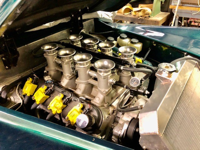

Congrats! The car looks amazing. Do you have any finished under hood pictures you could share, Pappy?
mfain 01-11-2020 07:43 PM
1 Attachment(s)
Here you go Trey.
Pappy
Attachment 71065
WSSix 01-12-2020 05:16 AM
Very nice! Thanks, Pappy.

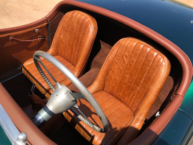

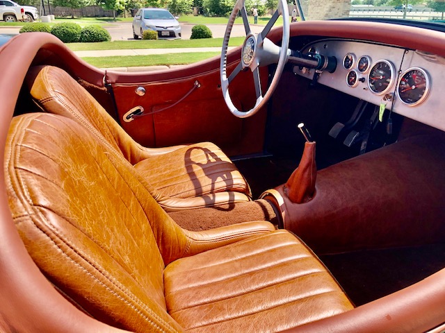

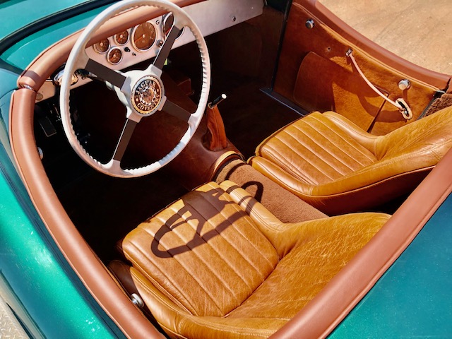

mfain 07-21-2020 10:14 AM
3 Attachment(s)
A little update - interior done.
Pappy
Attachment 72645
Attachment 72646
Attachment 72647
