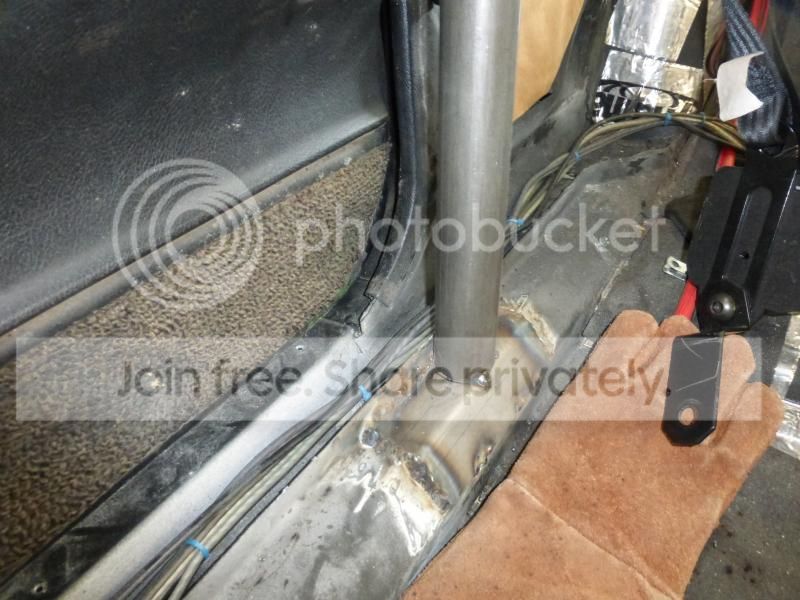

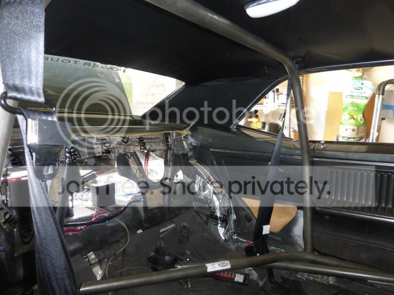

Removed the dynamat and welded on the floor plates.
http://i616.photobucket.com/albums/t...ps12d098a5.jpg
http://i616.photobucket.com/albums/t...psca037f8b.jpg
Main hoop tacked in place.
http://i616.photobucket.com/albums/t...ps6c4b8ee7.jpg
Main hoop and down bars tacked welded, removed as one unit, and fully welded. As usual, my prettier welds won't be seen.
http://i616.photobucket.com/albums/t...ps5d79d128.jpg
Mocked up and welded on the harness bar.
http://i616.photobucket.com/albums/t...psa67bf442.jpg
rickpaw 08-25-2014 06:18 PM
With the package tray opened up for the down bars, it was flexing a little, so I tied the package tray to the down bars.
http://i616.photobucket.com/albums/t...ps554a112a.jpg

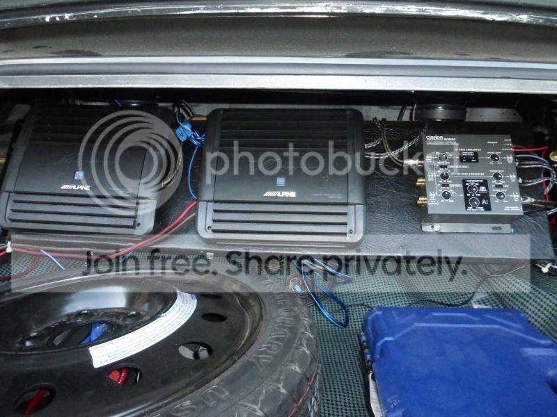

I also made an amp tray that mounts to the down bars in the trunk, similar to several builds on here.
http://i616.photobucket.com/albums/t...psfc03d20b.jpg
Not as pretty as some builds going on here, but the amps are off the trunk floor.
http://i616.photobucket.com/albums/t...ps0ddade2c.jpg

SSLance 08-26-2014 07:01 AM
Very nice work, thinking of something like this for my car as well. You were able to slide the whole thing in place as one unit? That is good to know...Nice to be able to do the majority of the welding outside the car.
rickpaw 08-26-2014 07:47 AM
Yes, I was able to slide the whole thing in and out as one unit. In fact, the DSE instruction mentioned it. It was tight though. There maybe 1/8" of clearance at the window opening, and I had to jack the car up so I can maneuver the main hoop down on the ground.

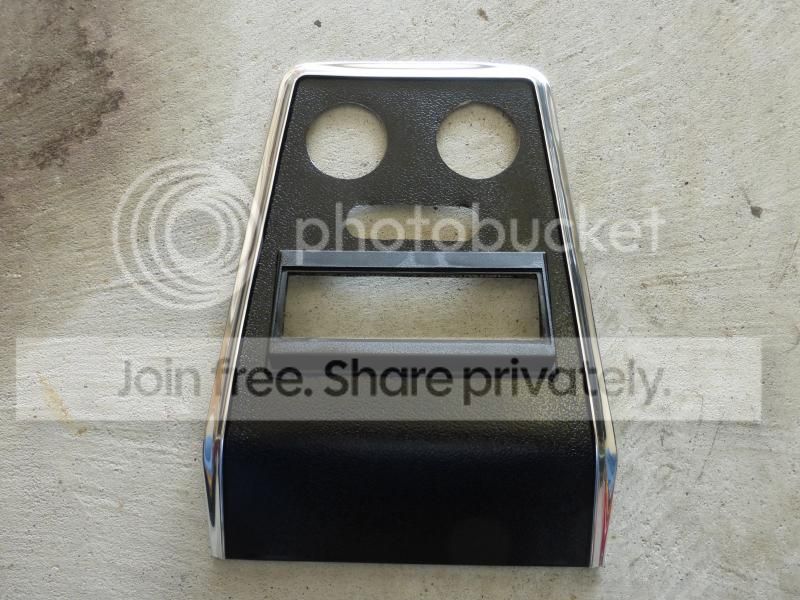

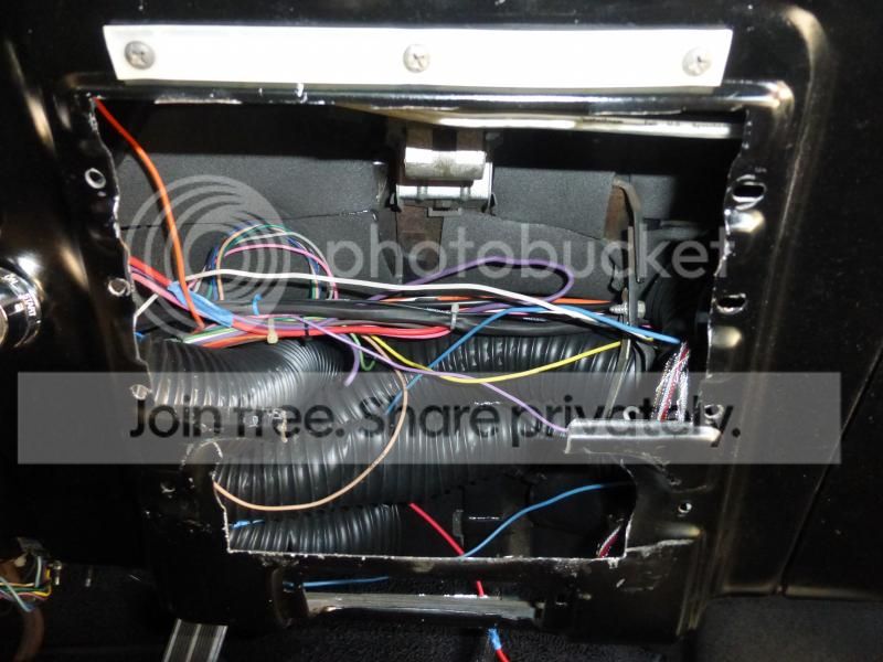

I never liked the layout of the center dash on 67-68 F-body so I decided to make some changes.
Bought a blank dash insert from Classic Industries, and cut out the openings for the AC vents, VA controller, and a single DIN stereo. The cut outs made the panel looked like a smiley face. :)
http://i616.photobucket.com/albums/t...ps83a32e08.jpg

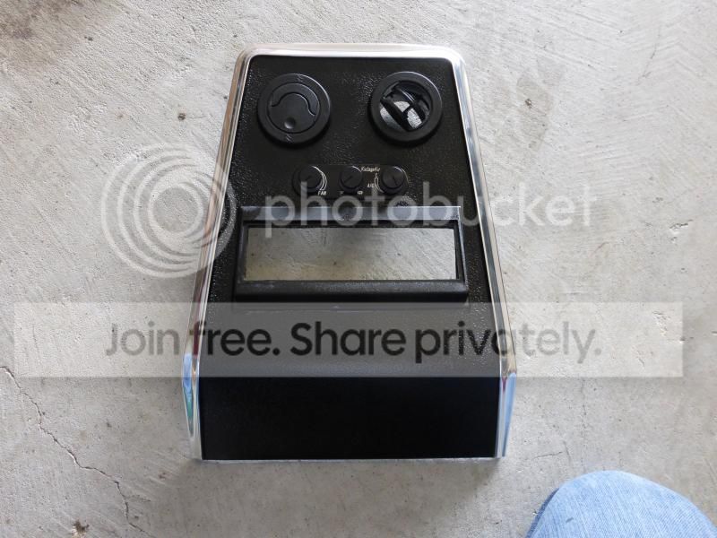

Got a stereo insert for a Volvo, and epoxied it in the panel.
http://i616.photobucket.com/albums/t...ps176fde38.jpg
I was having reservation about cutting up a perfect dash, for just a second. One minute later with a body saw, I had this.
http://i616.photobucket.com/albums/t...ps4d87e7ff.jpg
Vents/ac controls mocked up.
http://i616.photobucket.com/albums/t...ps902b8fef.jpg
And installed.
http://i616.photobucket.com/albums/t...ps242f56f6.jpg
Now just had to charge my Optima red top. It's completely dead. Put it on a charger, and it shut off after 6 mins, with a voltage of only 6V. I put in on battery tender to see if it's holding a charge overnight. It's a tad over 4 years old so maybe it's time for a new battery. :G-Dub:

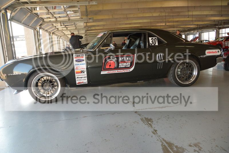

rickpaw 03-16-2015 06:32 AM
With Jason's help (n77nxc), I found a place in SW Houston that has a touchless tire machine. Brought the new Formula 43 wheels down to them, and had the tires mounted. Last weekend, the weather was nice enough so I rolled the car out of the garage, and snapped a couple of pictures with the new wheels.
http://i616.photobucket.com/albums/t...psnkqfvkbc.jpg
http://i616.photobucket.com/albums/t...psl1inlww2.jpg
Since I signed up for USCA event in Texas, a helmet was needed. My 6 year old daughter couldn't wait to try it on, right out of the box. G-force carbon helmet.
http://i616.photobucket.com/albums/t...pszzryy1yt.jpg
Now I just have to get the car aligned, nut/bolt check then I should be ready to go.

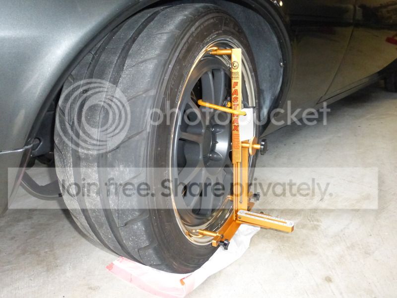

Spent about 90 minutes yesterday to go over the front end alignment.
Adjusting the toe.
http://i616.photobucket.com/albums/t...psy7pjkfjy.jpg
Checking camber/caster.
http://i616.photobucket.com/albums/t...psmvm8evsr.jpg
I went with -0.5 degree camber, 0 toe, and pos 5 degrees caster.

rickpaw 04-01-2015 05:35 AM
Attended USCA Texas event at Texas Motor Speedway this last weekend for the first time, and had a blast. Got to meet fellow lateral-g members (carbuff, gerno, grabbergt, chichirone), and checked out some really cool cars.
Some pictures at the event. I'm still looking for some action shots of the car.
http://i616.photobucket.com/albums/t...pss8yrorst.jpg
Lining up for tech/check in.
http://i616.photobucket.com/albums/t...pscovrnepg.jpg
All stickered up and ready to go.
http://i616.photobucket.com/albums/t...pswihrfe2e.jpg
Got to park next to 2 really cool cars (carbuf's Firebird and gerno's Camaro) in the hotel parking lot, at the early morning hour.
http://i616.photobucket.com/albums/t...psvq22andn.jpg
Mechanically, the car did great. I knew the car is low in power, compared to the rest of the cars at the event, and this showed in the road course. The stock transmission would up shift half way thru the apex, and that killed the acceleration. My current seats sucked, and those will be changed out before I do another track event.
For those who's been contemplating about attending this event, do it. It's well run, and the instructors provided by Jet Hot were invaluable.
Overall I finished 13th out of 19 entries in my class (vintage-GTV) which was surprising. Guess I did not do too bad for a complete newbie who has never done a track day before.
Hope Optima brings back the event to Texas next year.
