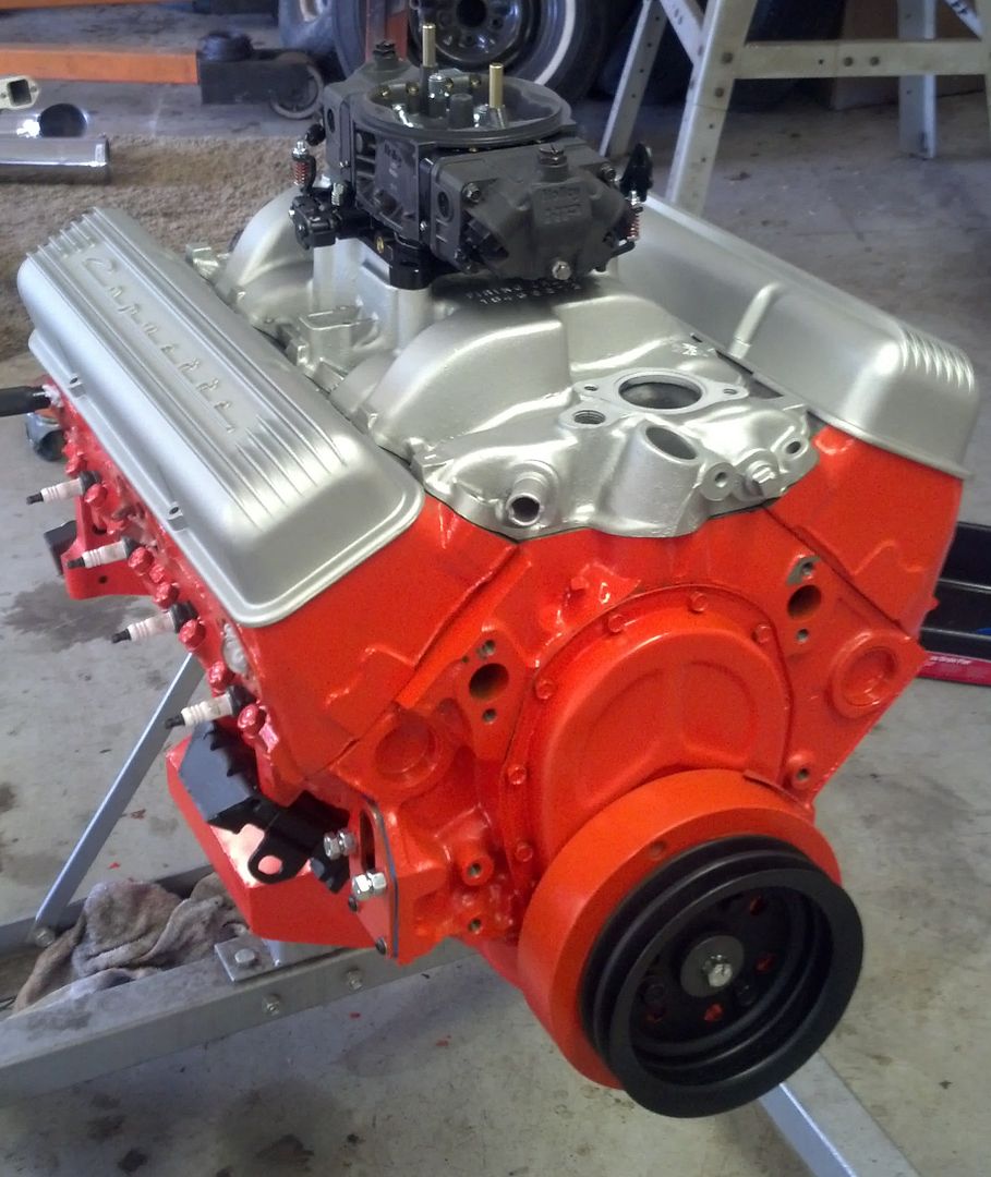

The motor is all cleaned up and painted and pretty much ready to go back in. We went with a new Holley HP carb, that things looks awesome. I havent' had a carb on a car in over 20 years I think, lol. Haven't done anything with the transmission, but are considering going thru it just to be safe.

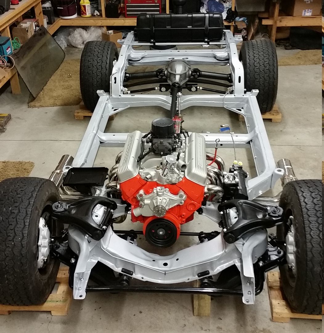

We've been hard at it last couple of weeks. Making progress, but not without challenges along the way. Ok, every step of the way :headscratch:
Few pics:
http://i1207.photobucket.com/albums/...psd72c12a3.jpg
new jute:
http://i1207.photobucket.com/albums/...ps4jvb7fsa.jpg
carpet:
http://i1207.photobucket.com/albums/...ps51c4984f.jpg
http://i1207.photobucket.com/albums/...ps4290be6f.jpg
http://i1207.photobucket.com/albums/...ps5a475b29.jpg
Engine and trans back home:
http://i1207.photobucket.com/albums/...psfb30fa8a.jpg
http://i1207.photobucket.com/albums/...ps1ca457b7.jpg
Zoomin 07-07-2014 05:10 AM
What a perfect base for a project like this!
Where did you (eventually) get the chassis?
Your valve covers and intake look really nice - how did you refinish those?
65_LS1_T56 07-07-2014 06:28 AM
The chassis came from Vette Products, Lake Orion, MI. Made with the original GM tooling and welding fixtures supposedly.
The intake, covers and bell housing were media blasted and painted with Eastwood Alumiblast. That paint looks killer and sprays very good.

65_LS1_T56 07-10-2014 03:17 AM
Little more progress :)
http://i1207.photobucket.com/albums/...psw7bwnylz.jpg
Geez, I know, I need to clean my shop up :shakehead:
http://i1207.photobucket.com/albums/...psurfjhjcb.jpg
Getting close to putting the body on the chassis, maybe next week. Fingers crossed.
http://i1207.photobucket.com/albums/...ps7fb5ec83.jpg
