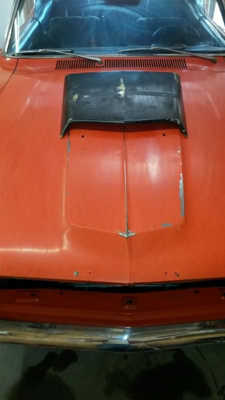

Deciding on a location for the Cyclone scoop, and prepping it. It was boogered up and needed glass in the corners, and holes filled.
Had to cut a hole in the hood a few inches smaller than the seal.
http://i144.photobucket.com/albums/r...s67c64aad.jpeg
http://i144.photobucket.com/albums/r...s964ea094.jpeg
http://i144.photobucket.com/albums/r...ps9b1bed26.jpg

Started working on the Ram Air inlet modifications to the inside of the hood. I had to cut out some bracing, form a ring from 18 gauge, weld it back in to strengthen the bracing, etc.
http://i144.photobucket.com/albums/r...ps3ea6985c.jpg

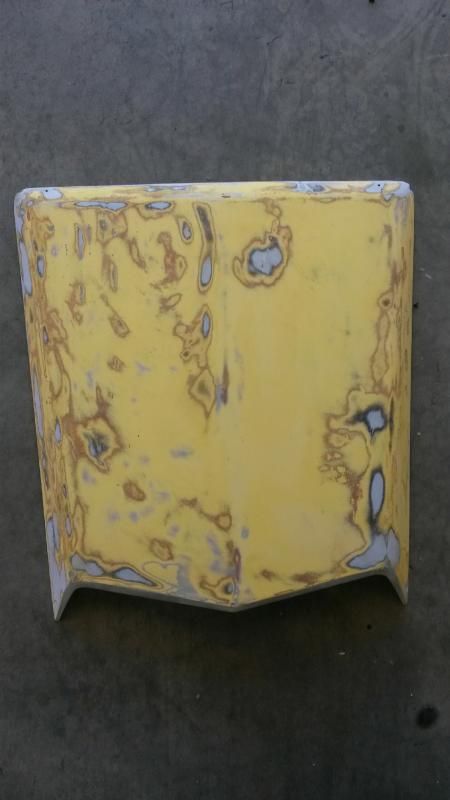

Working on the outside of the hood now,it was dented up, and fixing the glass on the Cyclone scoop.
http://i144.photobucket.com/albums/r...pse88ba75a.jpg
http://i144.photobucket.com/albums/r...pse20fe749.jpg

Well since last time I reported I have been block sanding that hood, filling spots I thought were fixed, priming, and block sanding some more.
Almost there is a relative term :bigun2:
Joe

jarhead 09-14-2015 03:58 PM
almost completely stripped now, ready for metal work. Anyone still watching ?
http://i144.photobucket.com/albums/r...ps5yc9ernj.jpg
Tincup 09-14-2015 06:21 PM
Yup, still watching, coming along nicely....
RodZZilla 09-14-2015 06:43 PM
nice!
torino420 09-14-2015 08:00 PM
Of course I'm still watching, always! Great work as usual Joe.
