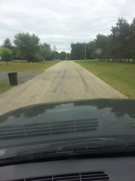

Oh, and this ones for Ron.....
Attachment 49370
Still giving you a chance man. No actual "Video evidence" yet.
Ron in SoCal 07-25-2014 11:40 AM
A ten footer, eh? C'mon cupcake :drive: :lol:
Vince@Meanstreets 07-25-2014 11:45 AM
what? I'd say his brakes are working just fine.
OBeer-WAN-Kenobi 07-25-2014 11:51 AM
10ft? That's gotta be around 30'! No wonder it took so long to get your car done. 10 years? Nah, that was only 5! Lucky the guy that did your body gaps had better depth perception than you. :poke: :D
Originally Posted by Vince@MSperfab (Post 562775)
what? I'd say his brake are working just fine.
Yeah, who says you need 32" wilwoobrembobears!
Hmmph....I need to find a cheap set of used tires as backups.....

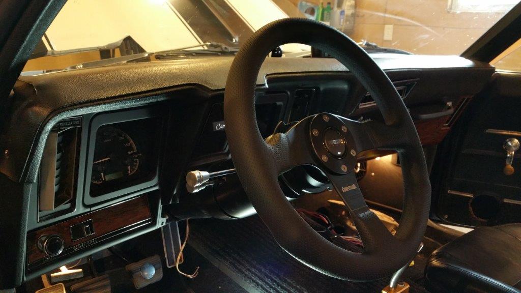

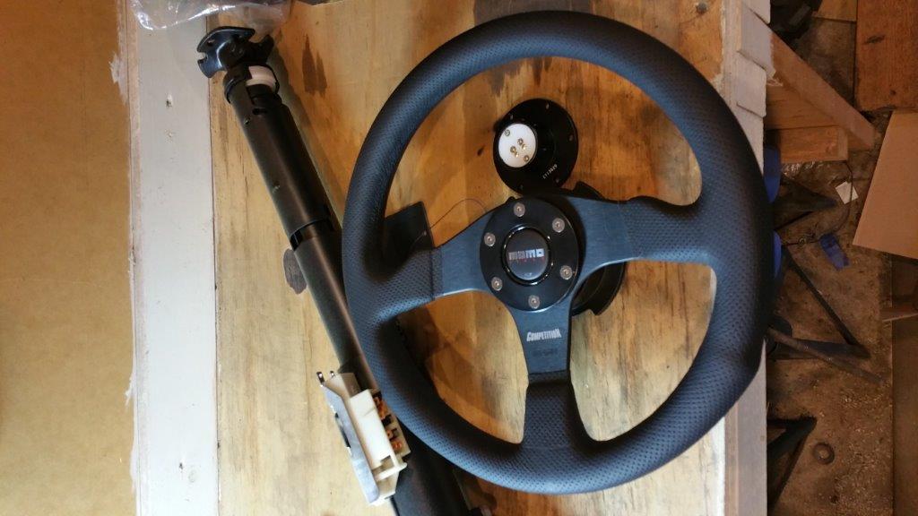

I've been really busy the last few weeks both with work and with my car. I have several things "in process" but have only completed my column and steering wheel.

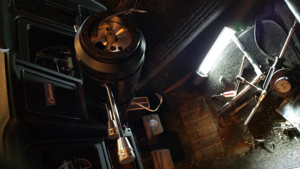

Anway, I thought I'd post some pictures of ongoing stuff and especially some of my NRG steering wheel quick release so you guys that might be thinking of one can see how much aditional length it adds and what it looks like.
So, without further ado here's some column and steering wheel pictures:
Attachment 54144
Attachment 54145
Attachment 54146
Attachment 54147

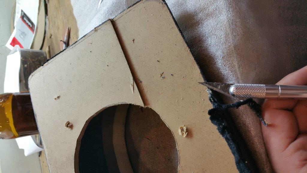

Next,

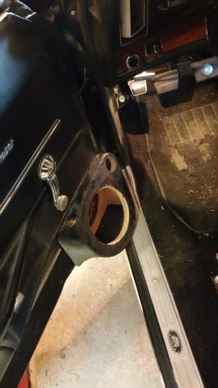

I've got some work done on the front door speaker pods.

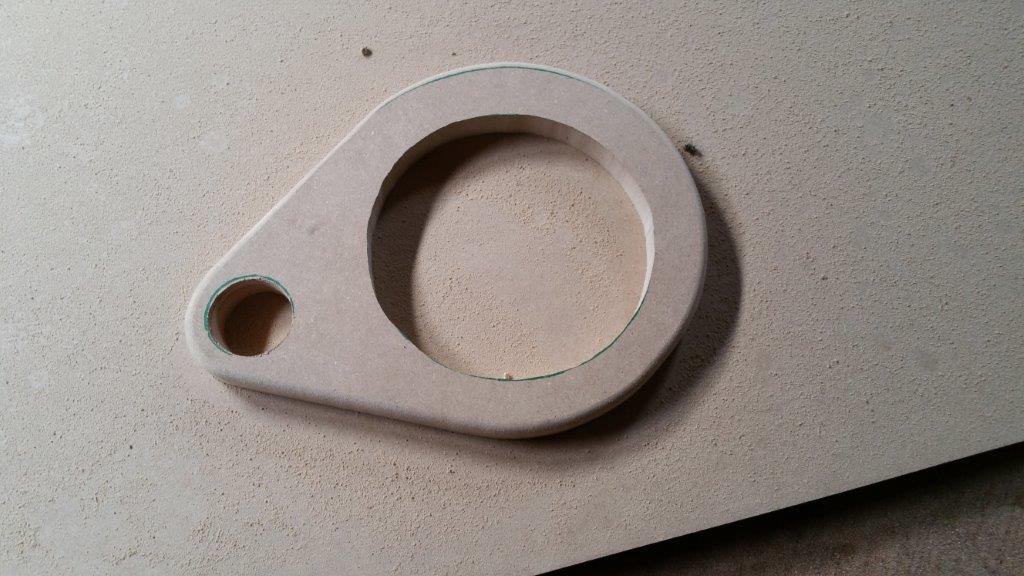

Step 1, make the template form out of 3/4" MDF.
Attachment 54148

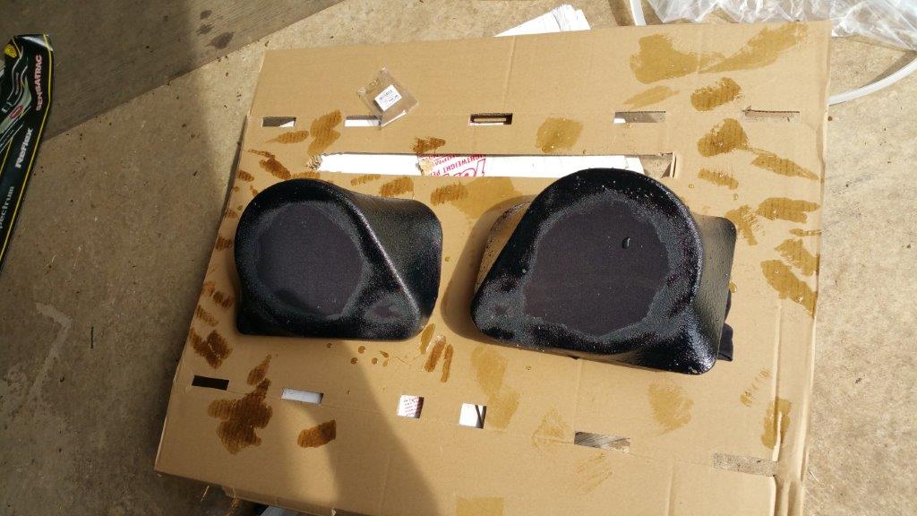

Step 2, make copies of the above form with my POS Home Depot router table and some flush trim bits.
Step 3, attach them to a backing plate with some wedges and hot glue. (sorry, no pix)

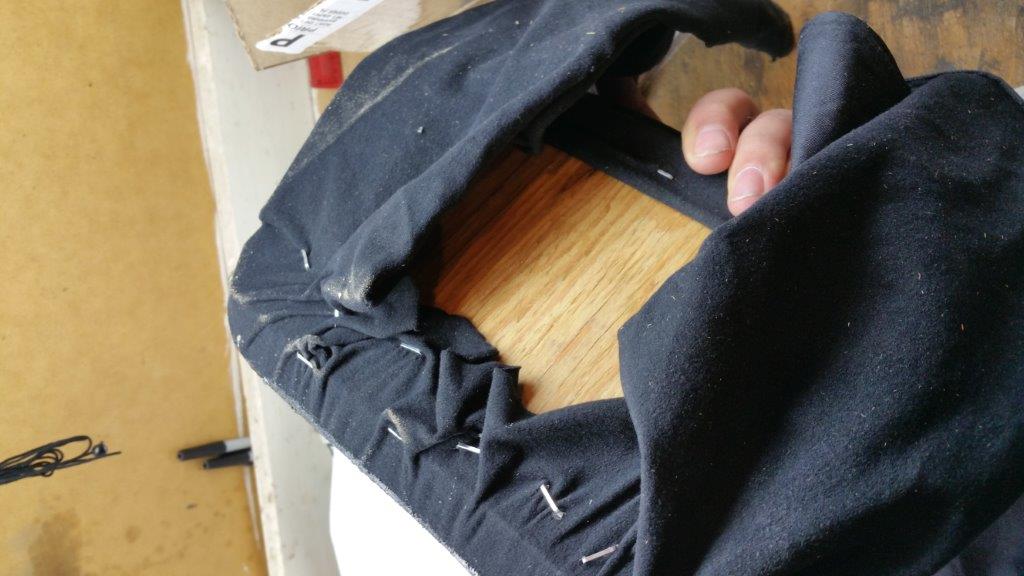

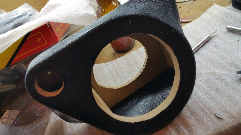

Step 4, get some fleece, two-way stretch, or preferably four-way stretch fabric and stretch it over the form so there are no wrinkes (no wrinkes on the front, you can have as many wrinkles on the back as you want!). You can staple it on the back as shown.
You'll end up up with a very organic looking flowing form as seen below after step 5.
Attachment 54149

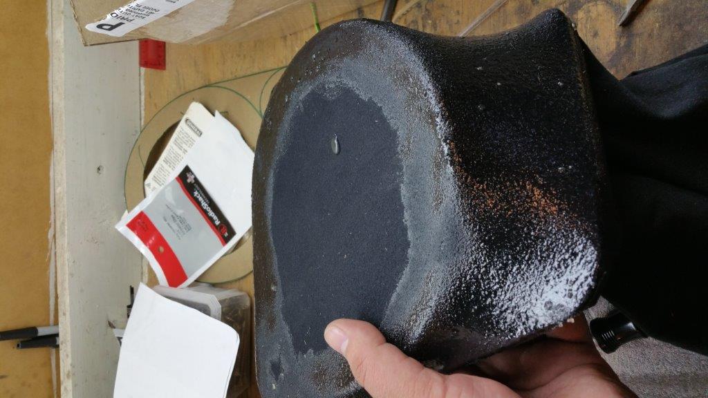

Step 5, fiberglass resin.
Attachment 54150
This would be a lot smoother but my old resin decided to set too quickly and get a little thick....
Attachment 54151
Step 6, trim excess fabric.
Attachment 54152
Step 7, admire your -still as not yet completed- speaker pods.
Attachment 54153
Attachment 54154
I have a little sanding to do and I may reinforce them with actual fiberglass on the inside later. The general idea though is to cover them with vinyl when they are sufficiently smooth. I think they'll turn out really well and should look like they are made for the car.....afterall, they are.

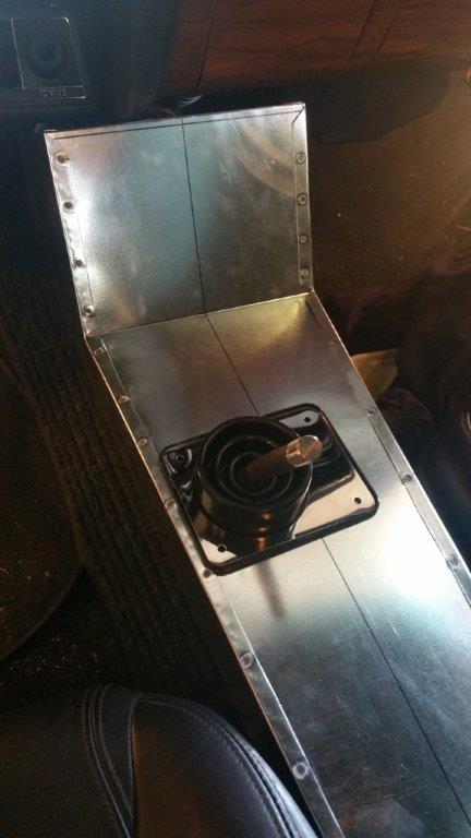

Here's a sneak preview of my super-secret console build.
This is a mockup out of some thin sheet. The basic shape is there but there will be some changes in height off of the floor and places for my double-din, 2 cup holders and a cell phone. I'm also planning on adding charging ports somewhere.
Attachment 54155

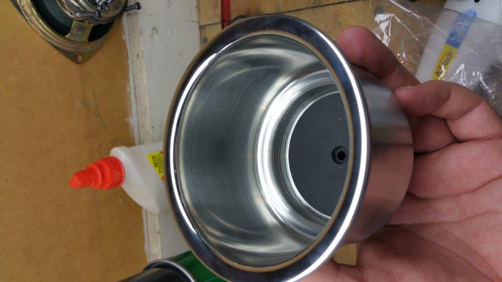

Here is one of the cup holders I'm going to use. It's pretty nice. Stainless steel, two different diameters, and has a cushy bottom. Also, I think they were about $12 a piece, so resonable too.
Attachment 54156

Where'd you source the cup/drink/beer holders? Like it
OBeer-WAN-Kenobi 05-06-2015 01:38 PM
Looks like they are $13.48 instead of $12. :D
http://www.boatoutfitters.com/3-5-st...eel-cup-holder
These also come with a self adhesive foam sealing strip attached to the flange.
The nipple on the bottom is a plastic screw on compression fitting for connecting a drain hose (meant for a boat....so). You can just saw it off if you don't like it. I'm going to use the hole to bolt down the console and cup holder at the same time.
cwylie 05-06-2015 07:27 PM

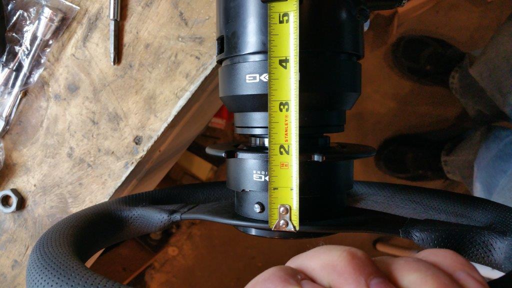

What do you think about the extra length added by the NRG adapter. What version did you end up using?
OBeer-WAN-Kenobi 05-07-2015 05:03 AM
Version 2.5 I believe.
I needed the extra length so I was more than happy with it. I had to move my seats way back so that my legs would fit. That caused me to be too far from the steering wheel. This is much more comfortable.
The stock wheel has quite a dish to it, somewhere over 3 inches, so with the Momo wheel that has barely any dish the location of my wheel is actually only around 1"closer to me.
So, if you are thinking about the NRG system, just watch the dish on various wheels compared to your current wheel.

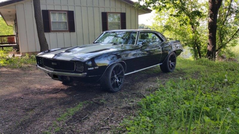

I've been working a lot on the car lately and have a few updates. I was able to get the new wheels and tires on permanently, finally. I posted the below in my wheel thread as well.
275/40R19's don't really fit which is why it took me so long to make an update to this thread.
I knew I'd have to trim the outer fender lip a little in the rear and that went off without a hitch. Unfortunately, I found that my choice of a 245/40R19 for the front was a bit agressive. It was the diameter that was the problem and it would rub on the back of the outer wheel well opening. Instead of messing with that, I just ordered 245/35R19's which fixed the problem.
Well, I thought I was home free but I then noticed some squeaking during fairly mild cornering and there was a definite rubbing going into driveways and such. It turns out that the rear tires were rubbing on the inner fender when the car was off square. So, if one wheel traveled downwards and the other traveled upwards, the higher tire would rub on the inner fender.
I thought maybe it wasn't too bad and I could do a little "massaging" but I found it was pretty bad actually, bad enough that I had to "micro tub" it, (at least that's what I'm calling it). Basically we cut out a portion of the inner fender and then I tested it by putting a 4" thick block of wood under a front tire and then jacking up the rear axle on the spring perch diagonally from the front tire with the block of wood. This showed how bad it really was. I didn't want to mess with a mini tub just yet as there are other panels I'd like to replace when I do that so we did the best we could.
Long story short, we were able to move the shock inwards by about 3/4" on each side and this allowed us to cut out enough metal to get around 1" more out of the inner fender. It's enough, but it's barely enough.
For those wanting to stay stock I can not recommend this tire size. As a matter of fact, I can't believe that you wouldn't have trouble with a 275/40R18 as well. Maybe if you had a lot stiffer suspension and a sway bar? I'm not sure. If you didn't run the chrome/stainless moldings on the outer fender well lip and trimmed it futher and rolled it, you may get the 18" tires to work with a backspacing that moves them out another 5/8" or so....but the 19's? I don't think so.
Anyway, the finished product looks really good:
Attachment 54705
It does need to go lower though. However; I might have to minitub at that point....so I might as well wait until I have more money for suspension and brakes.

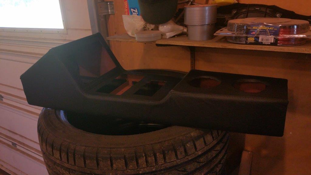

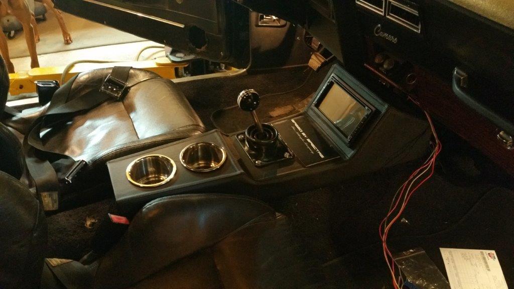

OBeer-WAN-Kenobi 06-22-2015 11:33 AM
3 Attachment(s)
With all the other stuff going on; including having to replace every single joint in my front end due to inferior quality garbage, I finally had some time to work on my stereo some more.
Here's the console that we built, no longer naked. I took our finish bent and welded console to a local upholsterer to have it wrapped in leather.
Attachment 54710
Here's a picture of it installed with my Android powered head unit:
Attachment 54711

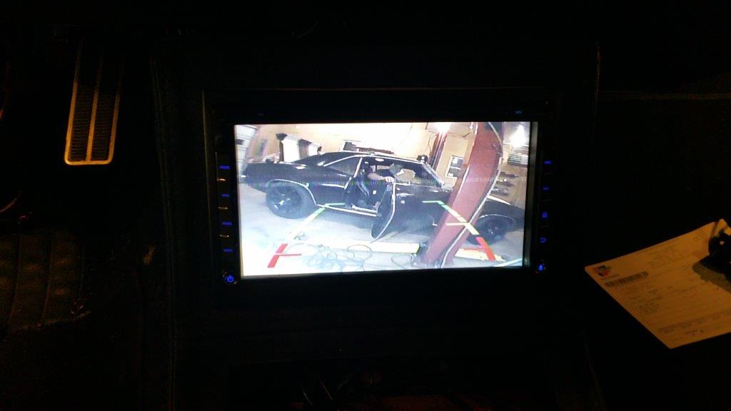

Here's some fun with my wireless backup camera. I put the car in reverse while it was sitting on the bench (connected to my 12V power supply). It took video of me and didn't break, so it must be decent.
Attachment 54712
I stayed up really late last night trying to get all that stuff (minus speakers and amps) installed. I was still at it at 1AM and just after I buttoned up the dash and everything else I thought I was done. Then I closed the door and the stupid dome and courtesy lights stayed on! Man, I was not in a good mood. I tried to track it down but it was late and I wasn't happy which isn't a good way to get anything done. So I went to bed.
Of course, I couldn't sleep because I was thinking about the wiring all night. I woke up at about 5:30AM had some coffee and got back at it. With a fresh start I found the problem fairly quickly. I used a ground that I shouldn't have. Once I ran a new one I was fine. Of course, then I had to go to work at my real job........sigh.
Hopefully I can get on to the speakers and amps next. After ANOTHER front end alignment and a couple good nights rest anyway.

I was also having some trouble getting the front facing camera to record but that was just some settings that had to be just right. Now I've got that working as well
The video isn't the greatest but this isn't a gopro or anything, it's more of a CYA camera in case you need some evidence. That being said, it's still fun to watch the videos and anytime something interesting happens you can just tap the screen and it will save the last so many seconds of video (you can designate how much) in your permanent memory so that it doesn't get deleted.
The sound from the external mic could probaby use a little work also. I'm not sure if it's the position on the dash that's the problem or just the mic itself. HOWEVER; even with the mic problems you can get an only slightly distorted idea of how the exhaust sounds. (skip to 1:25) I continue to be impressed with the Magnaflow exhaust, particularly with how it is quiet at cruising speed but beastly sounding when you get on it.
I bench tested the head unit before I ever installed it but haven't yet installed speakers in the car to comment about sound quality. Maybe I'll have time this weekend to finish up my speaker pods and at lest get the front stage installed.

When I purchased it, the backup camera was part of the deal, as well as the external mic. I paid extra (but it was pretty cheap) for the front DVR camera which plugs into one of the USB ports on the head unit. I just thought that if I bought it from the same seller, hopefully it would work without much difficulty. Otherwise, there's no reason you couldn't try another USB camera.
This guy does a good video review of the same unit I have, and below his youtube video is a link to the XDA dev forum thread on this type of unit.
https://www.youtube.com/watch?v=TIeQHTiuHSM
It's a few months since I've purchased this thing and there may be a better/faster/sexier one out there now so you might want to check into that as well.
Also, I did install the rooted firmware on my unit so I'm not running the stock ROM at the moment.
I guess the biggest thing to remember with these type of head units and Chinese electronics like this in general is that there will be glitches and it won't be as refined as other options out there; however, knowing that going in, it's still well worth the trials and tribulations for the number of cool features you get.
ETA: Oh! If you do buy it, make sure to get the mounting "cage" from them too. I hear that it's just a little bit different in size from a standard double din and that getting the mounting kit from them will save you some headaches. I bought their mouting kits and I still had to sand a little on the cage to get my head unit to slide nicely in and out.
