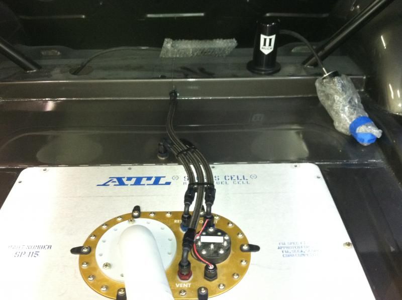

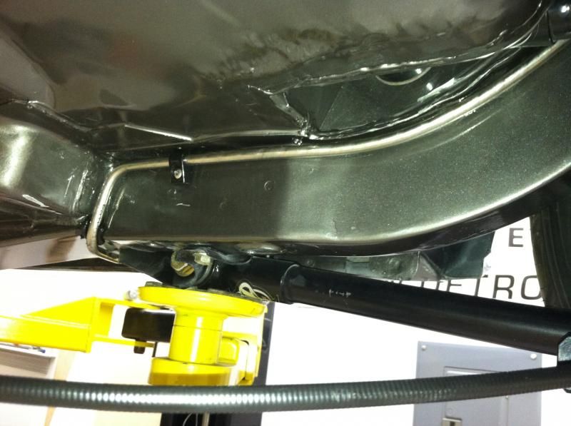

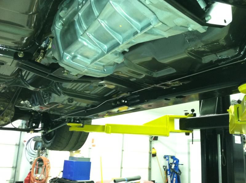

1coolC2 06-14-2014 05:53 PM

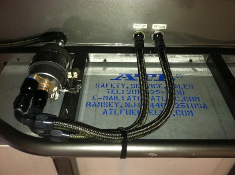

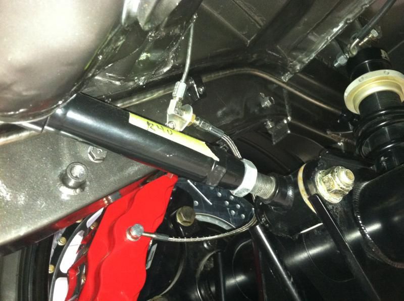

While I have not had much...more accurately, no time to work on the Nova...my buddy Matt has managed to fabricate all of the brake and fuel stainless hard lines and make up all of the Earls soft lines and fittings for the fuel system and brakes. Let's just say when he was willing to take on the projects at his shop, I was like....:y0!: HECK YA!! His efforts have really saved me some time and basically just left the wiring and exhaust before firing this thing up. Maybe LS Fest will be possible????
R/
Jeff
Fuel cell lines , regulator and vent. Need to order the second vent to accommodate the diff
http://i29.photobucket.com/albums/c2...ps2d0335de.jpg
http://i29.photobucket.com/albums/c2...ps43cec1da.jpg
Fuel lines
http://i29.photobucket.com/albums/c2...ps386f6bc6.jpg
http://i29.photobucket.com/albums/c2...ps7930d79e.jpg
http://i29.photobucket.com/albums/c2...ps9e84c836.jpg
http://i29.photobucket.com/albums/c2...ps3d5e2d27.jpg
http://i29.photobucket.com/albums/c2...ps105edc21.jpg
http://i29.photobucket.com/albums/c2...pse3e19135.jpg
http://i29.photobucket.com/albums/c2...ps3f3bd149.jpg
http://i29.photobucket.com/albums/c2...psc301e7c0.jpg
Vince@Meanstreets 06-14-2014 10:26 PM
Very nice work. I love the cell box.
The fittings on the regulator are crossed. The feed is the larger outer port. Learned that the hard way.
1coolC2 06-15-2014 02:37 AM
You are correct sir, I'll have to bust on him for that :poke: , ha ha. There are some pics on the web that show it reversed, he may have looked it up and found one of those....he's a ford guy and primarily builds drag race stuff, he did not like the idea of that regulator to start with :shakehead: . Hey, they work fine for our little 600-700 horse engines!! Thanks again for the good eye!

Vince@Meanstreets 06-15-2014 10:07 AM
No problem Jeff,
That picture you mentioned popped a bunch of guys. A few even replaced fuel pumps and PCM's trying to find out why they didn't have fuel at the rail.
I love using those regulators, cheap, compact and easy to mount.

1transam 06-16-2014 10:45 AM
Love the bending of the lines, its very clean!

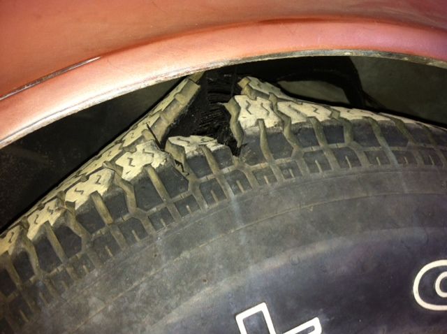

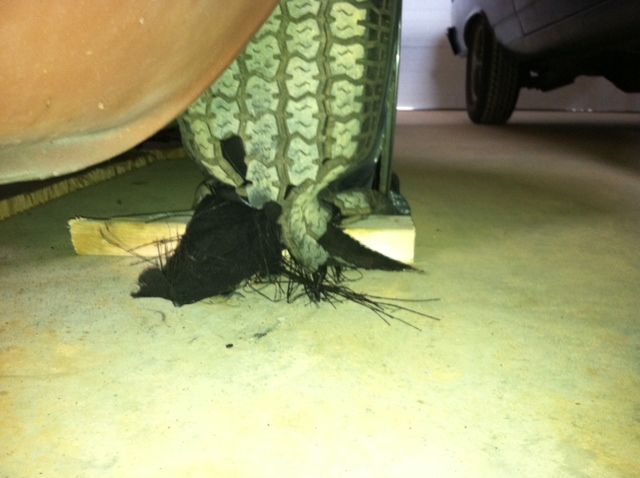

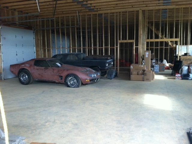

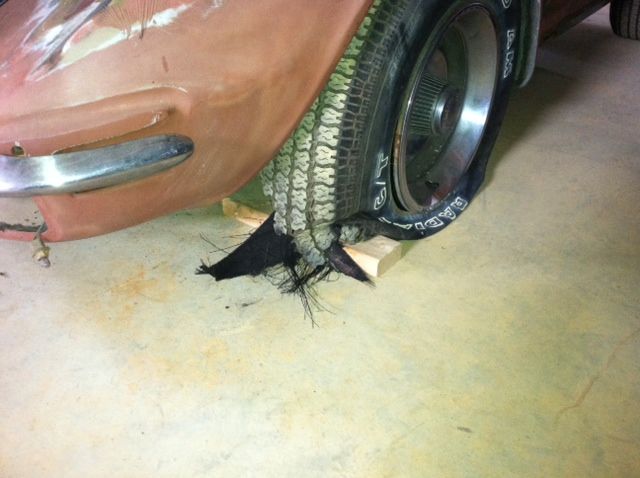

1coolC2 06-30-2014 02:57 AM
When Projects Sit Too Long!!!
Went up to my new shop building this weekend to drop off a bunch of stuff from my current garage (doing the moving thing) and saw that my 72 Corvette coupe was sitting a little low in the front...I mean like on the ground low. I saw the front right tire was flat and thought, dang it has a leak. Leak!!, that's an understatement, it had a hole about 2" across blown slam out of it!! This car has been sitting around for 20+ plus years on the same tires and they are dry rotted pretty good I guess. As I went around to the left side it got even better, the entire tire delaminated and had blown all apart.
That might be a clue to get around to actually do something with the car!!
R/
Jeff

65_LS1_T56 06-30-2014 03:11 AM
Weird both blew out on their own.

Hum Jeff, how long has been sense you were at the shop?? Also nice shop lets see some more of it please!!

1coolC2 06-30-2014 03:11 PM
More importantly, that '64 needs some love! :superhack: + :weld: + :morepower = :bigun2:
Ya, guessing once one blew the other was right behind it. Must have made a big boom LOL.

The car has only recently been moved to the new building....not even done yet. I'll post some pics of the outside of the building later. It's 45 X 80 with 14' ceiling and a 16 X 80 storage room upstairs to store all of the parts :ups:

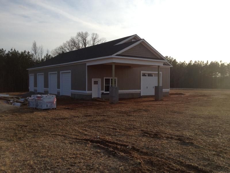

1coolC2 07-01-2014 02:52 AM
Here is a shot before the outside was completed. Bottom is stone and front has craftsman style posts.
http://i29.photobucket.com/albums/c2...ps6be46159.jpg
Rick D 07-01-2014 04:46 AM
Now that is a nice building!!!
bonecrrusher 07-01-2014 04:52 AM
Nice looking shop man!

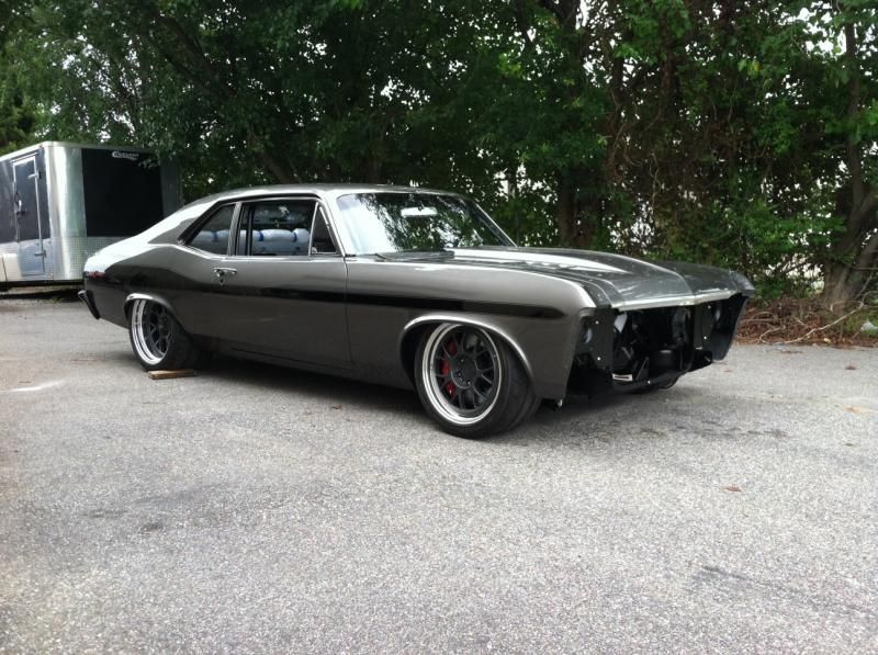

1coolC2 08-19-2014 05:30 PM
Originally Posted by jeds (Post 556203)
What hardline clips are those?
Sorry,
forgot to get back and post this :sieg:
https://www.made4uproducts.com/cart/...hp?prod=10-188
Updated pic of the car :-)
http://i29.photobucket.com/albums/c2...ps56a4dce9.jpg
R/
Jeff
Ron in SoCal 08-19-2014 07:49 PM
Smokin hot Jeff! :thumbsup:
Ricochet 08-19-2014 07:52 PM
That thing is just sinister!
Rick D 08-19-2014 07:59 PM
Bad azz!!! That just looks sooooooo mean!!
tom091074 08-19-2014 09:25 PM
Your car looks AMAZING! I'm jealous.
Jr 08-19-2014 09:30 PM
Very clean fuel cell and lines! The car doesn't look too bad either.
Moabdude 08-20-2014 12:21 AM
Wheel / tire sizes
Amazing car!
I love the stance.
What size wheels and tires are those?
Tried to look it up it but couldn't find it.
