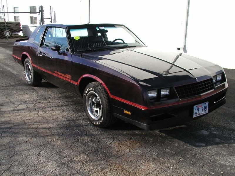

SSLance 09-01-2015 08:51 AM
Didn't anyone ever tell you guys... "Buy the body, build the drivetrain"
:buttkick:
2007
http://img.photobucket.com/albums/v3...S/Outside5.jpg
2015
https://lh3.googleusercontent.com/cU...e=w960-h637-no
:gitrdun:
