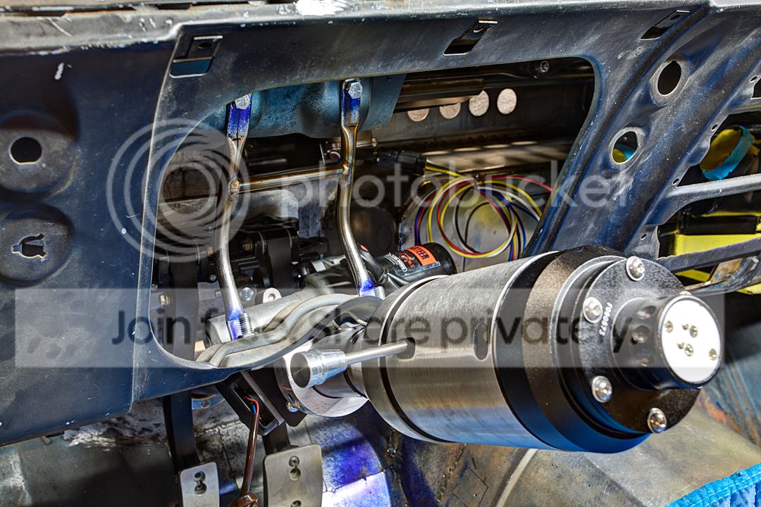

We have everything mounted under the dash. The Large Lt4 ECU, the EPS controller, the Raingear wiper system, the Vintage Air Gen4 unit, the Tilton pedal assembly with Throttle pedal and the EPS equipped steering Column. We had to recess the firewall in the middle to allow access to some connection on the back side of the engine and not have to move the engine forward. Things are very tight under the hood and under the dash.
http://i616.photobucket.com/albums/t...2016%20014.jpg
http://i616.photobucket.com/albums/t...2016%20021.jpg
http://i616.photobucket.com/albums/t...2016%20019.jpg
http://i616.photobucket.com/albums/t...column-01l.jpg

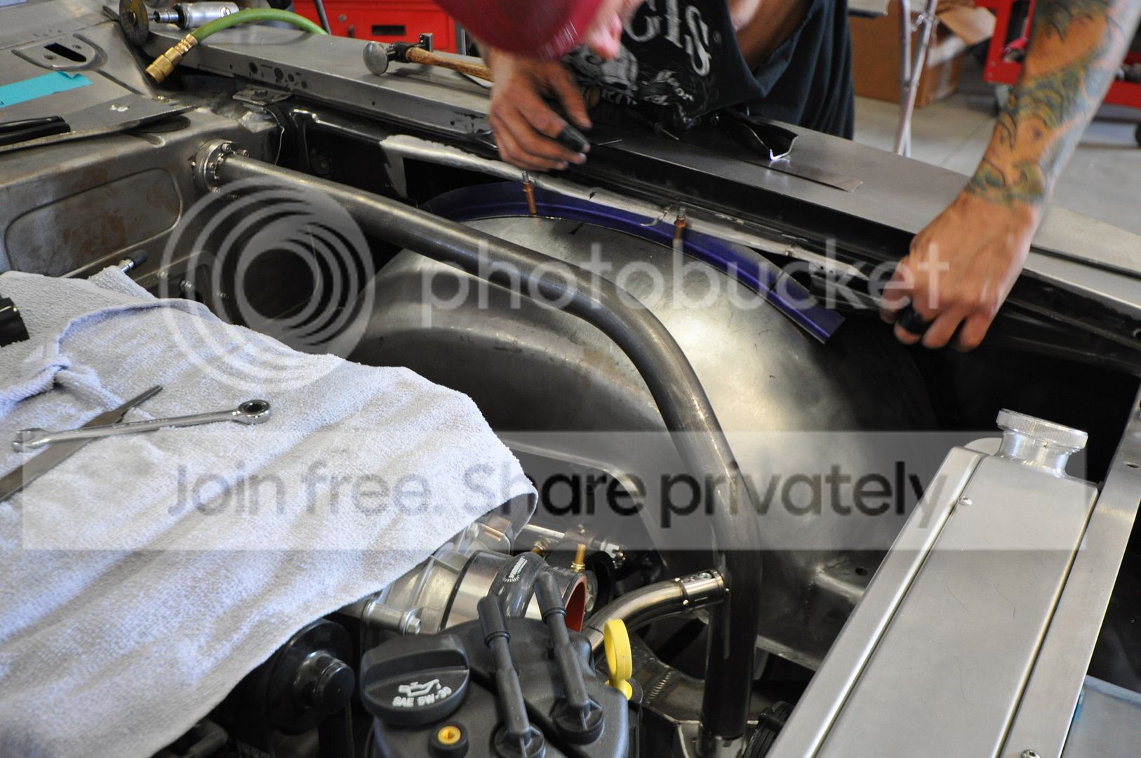

The engine compartment is also pretty tight. The large wheel tubs pretty much kill any room around the wheels with the 19x11 Forgeline wheels. We also made an intercooler tank shaped to the curve of the inner fender to increase capacity as much as possible. The shocks on the Ring brother hood hinges needed to be relocated to the firewall down bars as they no longer cleared the wheel tubs.
http://i616.photobucket.com/albums/t...2016%20035.jpg
http://i616.photobucket.com/albums/t...2016%20011.jpg
http://i616.photobucket.com/albums/t...airway-01l.jpg
http://i616.photobucket.com/albums/t...2016%20025.jpg
http://i616.photobucket.com/albums/t...2016%20009.jpg
We modified the under structure of the hood for the vents and the aero latches.
http://i616.photobucket.com/albums/t...2016%20005.jpg
