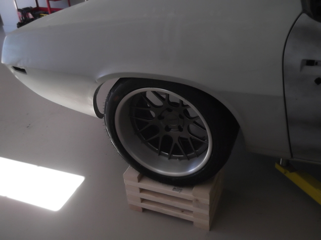

Here are some more pics of the rear flares and tail section mods. The bumper is on just so I could template it for the sheet metal bends. Will keep the original shape everywhere it's possible. I moved the bumper out 1/2" and then straightened out the upper portion of the fender/tail piece to remove the downward curve. Can't really see it in these pics, will post some better ones while doing the other side.

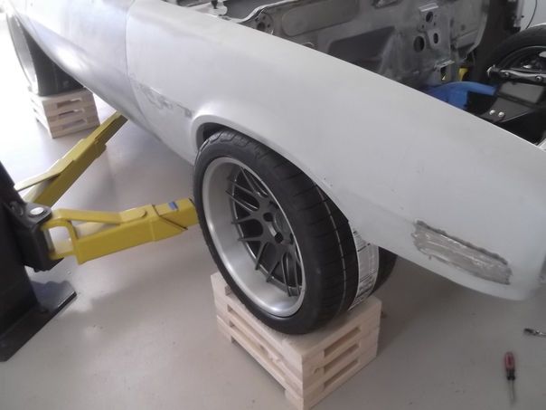

After the rendering was complete, it became clear that I needed to move the front of fender flare out so the front spoiler would flow right.

Subscribed. Amazing metal work. Really really nice. I see you've got a side splitter in the rendering, what are your plans there? I'll be doing something similar with my 80Z.

I'm in that weird zone were every desired action has some roadblock because something else should be done first and truthfully I didn't do a good job of predicting this so I'm waiting for parts (fiberglass hood and deck lid). I really need both to move forward with confidence on the significant changes to the rear end/bumper area as well as the front spoiler.
Thus I will likely do the side skirts/splitter next. My plan is bend up a new side skirt that runs the entire length (means modifying the front fender). My plan is to basically follow the second to last body line and mostly just continue that line down which mostly just eliminates that complete roll under of the factory side skirt. Then I will make an aluminum side splitter that bolts to the new side skirt and sticks out about 1-2". I will include some pictures next week, would appreciate your input!!

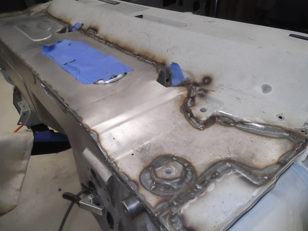

Space for the mufflers created.

Nice job as usual. I'm planning to do something similar with mine for more exhaust clearance. Thanks for posting the detailed pics.

Looks great. I thought about doing that as well but decided I'd make slim mufflers instead. I'm only running 2.5" exhaust so I don't need a thick muffler. That and I don't have the equipment to make it as pretty as you did. Keep up the good work!
Thanks. Don't hesitate to PM me if you want more detailed pics, glad to share what I did. Certainly, I'm appreciative of others here (and DSE of course) paving the way on this detail.

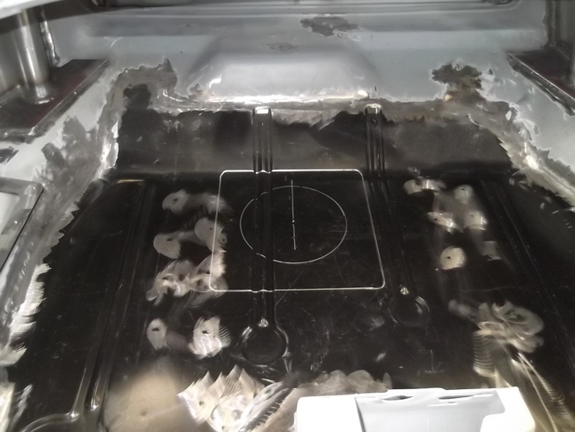

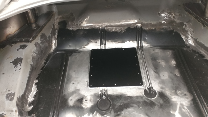

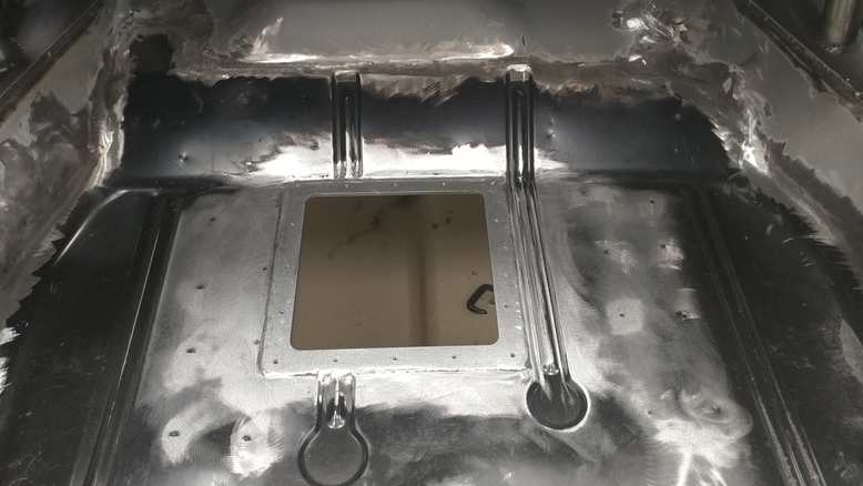

Installed the DSE fuel pump access panel. No surprise that it's a really nice piece with a cool anodized aluminum cover. It's not big enough to provide access to the pump and the level sensor but I spoke to the guys at Rick's and they said not to worry about the level sensor, it's pretty stout and should live a long life so no access should be necessary. Attachment 62048Attachment 62049Attachment 62050
Fab'd up the new bumper that will of course be hidden underneath the body work that will mimic the bumper..more to come soon on that. Attachment 62051
