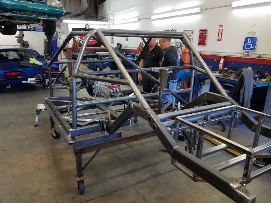

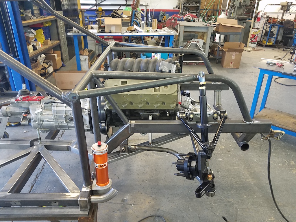

The first photos here show the new steel inner rocker panel Randy builds for the fiberglass body. They utilize nutserts. The frame will have matching holes to bolt the rocker panels to the frame. It will also attach in 6 other locations. The body "can be" removed in about an hour or so. The goal is not to make the body come off quickly, nor often, just if need be to make repairs.
http://www.pro-touring.com/attachmen...9&d=1522088739
http://www.pro-touring.com/attachmen...0&d=1522088926
http://www.pro-touring.com/attachmen...2&d=1522088958
http://www.pro-touring.com/attachmen...3&d=1522088980
http://www.pro-touring.com/attachmen...4&d=1522089011
http://www.pro-touring.com/attachmen...5&d=1522089038
The odd braces are to keep everything true until the roll cage is installed.
http://www.pro-touring.com/attachmen...6&d=1522089104
http://www.pro-touring.com/attachmen...7&d=1522089138
http://www.pro-touring.com/attachmen...8&d=1522089177
Off to get the roll cage installed at Tolle Fab, a few doors down.
http://www.pro-touring.com/attachmen...9&d=1522089229
http://www.pro-touring.com/attachmen...0&d=1522089257
http://www.pro-touring.com/attachmen...1&d=1522089276

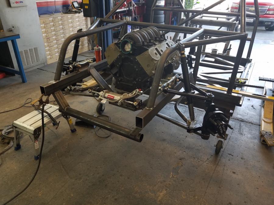

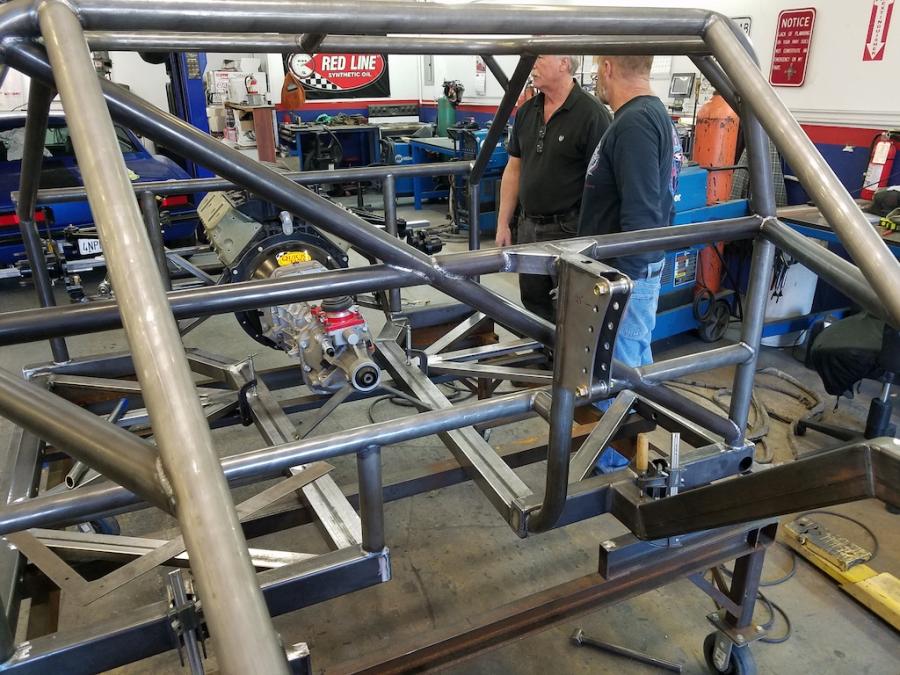

I know there's some guys that are quite worried about the speed at which my car is being built -- but then -- they're on the 10 year + plan.....
This is less than a week.....
Attachment 65093
Attachment 65094

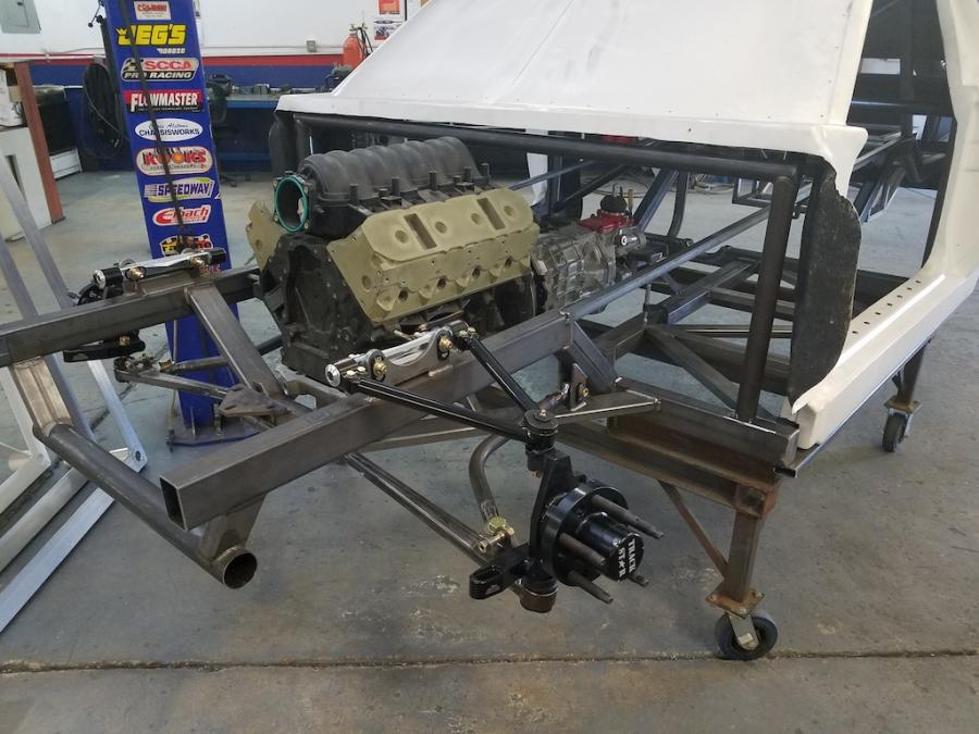

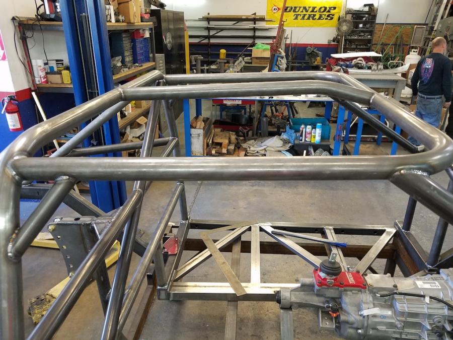

Note that it's fully welded not just tacked...... LOL
I'd say Sutton knows how to get a race car built -- maybe 'cause he's done this a time or two??
Attachment 65095
Attachment 65096
