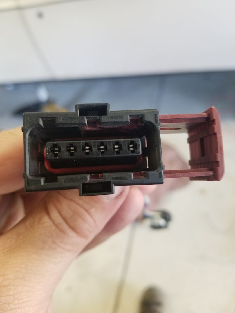

Managed to track down the van only accelerator pedal plug that I needed and got it wired into the harness. Note to peeps, Vans have a different plug on them =)

There is not many newer vans in wrecking yards around here. My search took me to the most sketchy wrecking yard I have ever been too. Super nice guys but sketchy. They had some super cool cars in there, stuff you dont see in wrecking yards that are on the beaten path.

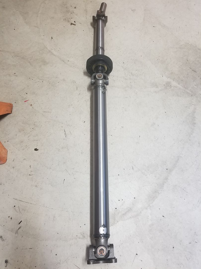

Still waiting for rear brakes to show up, driveline is done, just need to pick it up in Portland. Have one wire to terminate and I can check to make sure it turns over and stuff, pull program from ECU so that we can work on programming.
