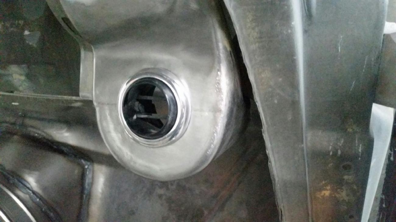

Kurt also fabricated housings into the lower sides of the dash to mount round air vents, similar to what has been done on a number of first gen Novas built by DSE and others here on the forum. Front seats were test fit and seat brackets installed.

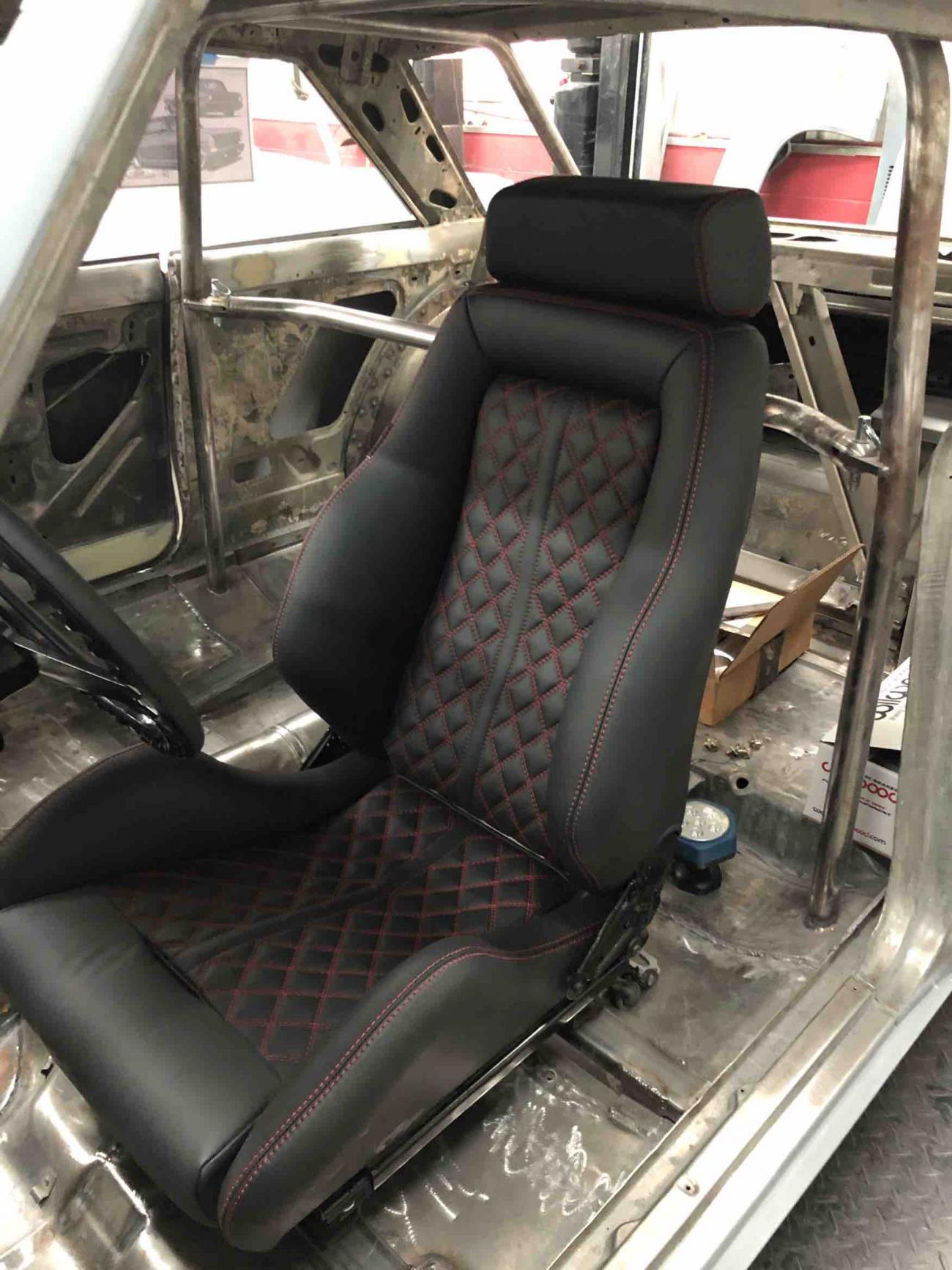

What model are the Recaros? They look great!

bkswede 02-13-2020 05:43 AM
Thanks! They are Recaro model LS-C seats... produced by Recaro from early 80’s to early 90’s... I bought these and had them completely rebuilt, with new foam bolsters, etc. and was then able to custom cover them in the pattern I wanted.
Sent from my iPad using Tapatalk

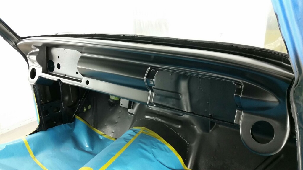

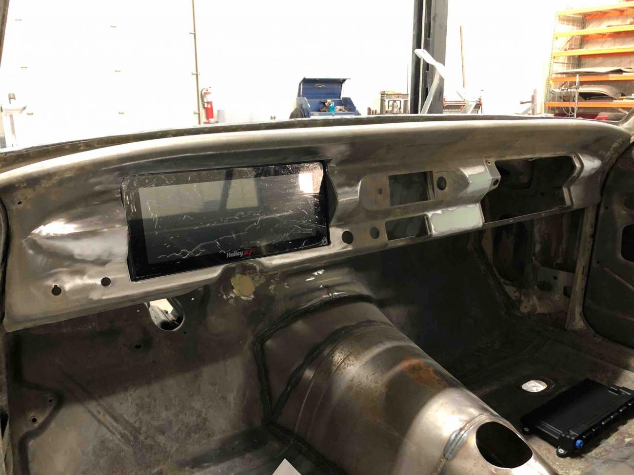

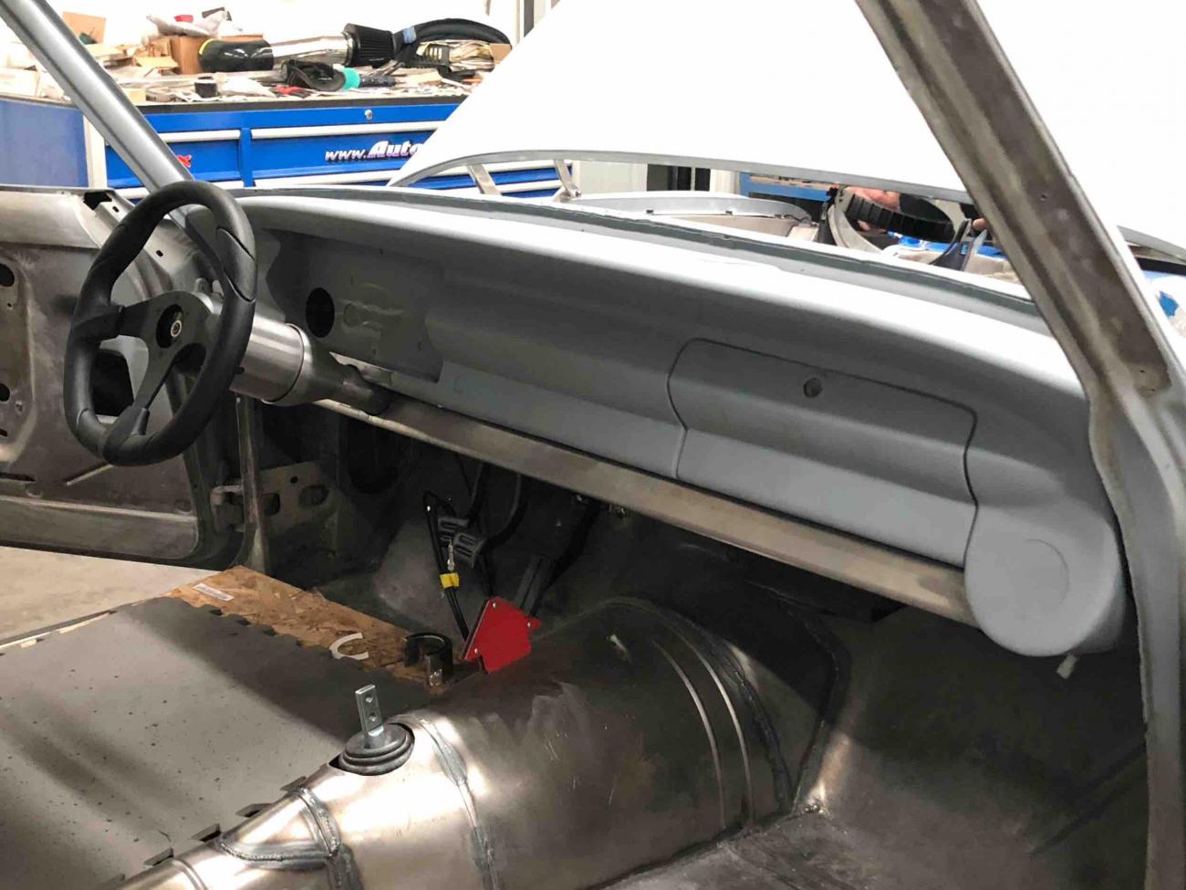

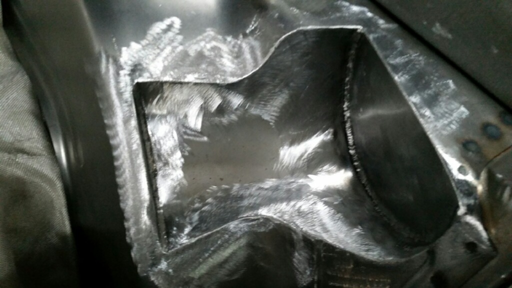

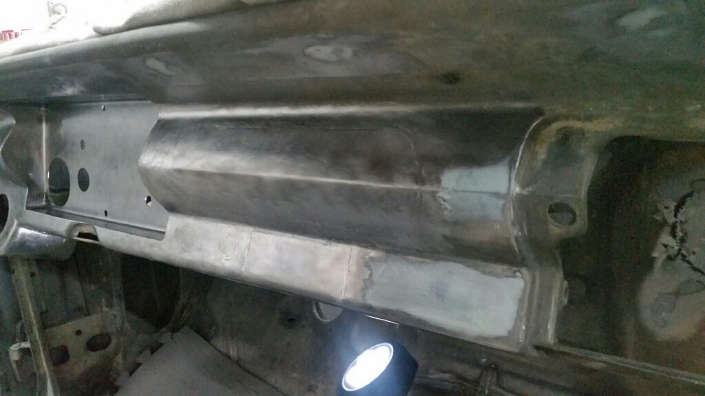

Drove to Eau Claire on Saturday to meet Kurt. He’s been busy mocking up various things: vintage air unit, clutch and brake pedal assemblies, making bracket for drive by wire throttle pedal, installing seat brackets, steering column, etc. He wanted me to stop by and check out seating position. Everything felt great, although we’re going to take 1/2” of height out of the seat brackets. We also mocked up the digital dash to make sure we head a clear line of sight. Took some pictures to give you an idea of things. The steering column in the attached pictures is not set completely in place - it will be about two inches closer to the firewall than shown here. The steering wheel is not what I’m using, either, but an extra that Kurt had lying around the shop.
In this picture, you can see the work he did to fill in the dash where the factory radio and ash tray were located.
Attachment 71467
Here is a shot from the driver seat... digital dash is going to work awesome!
Attachment 71468

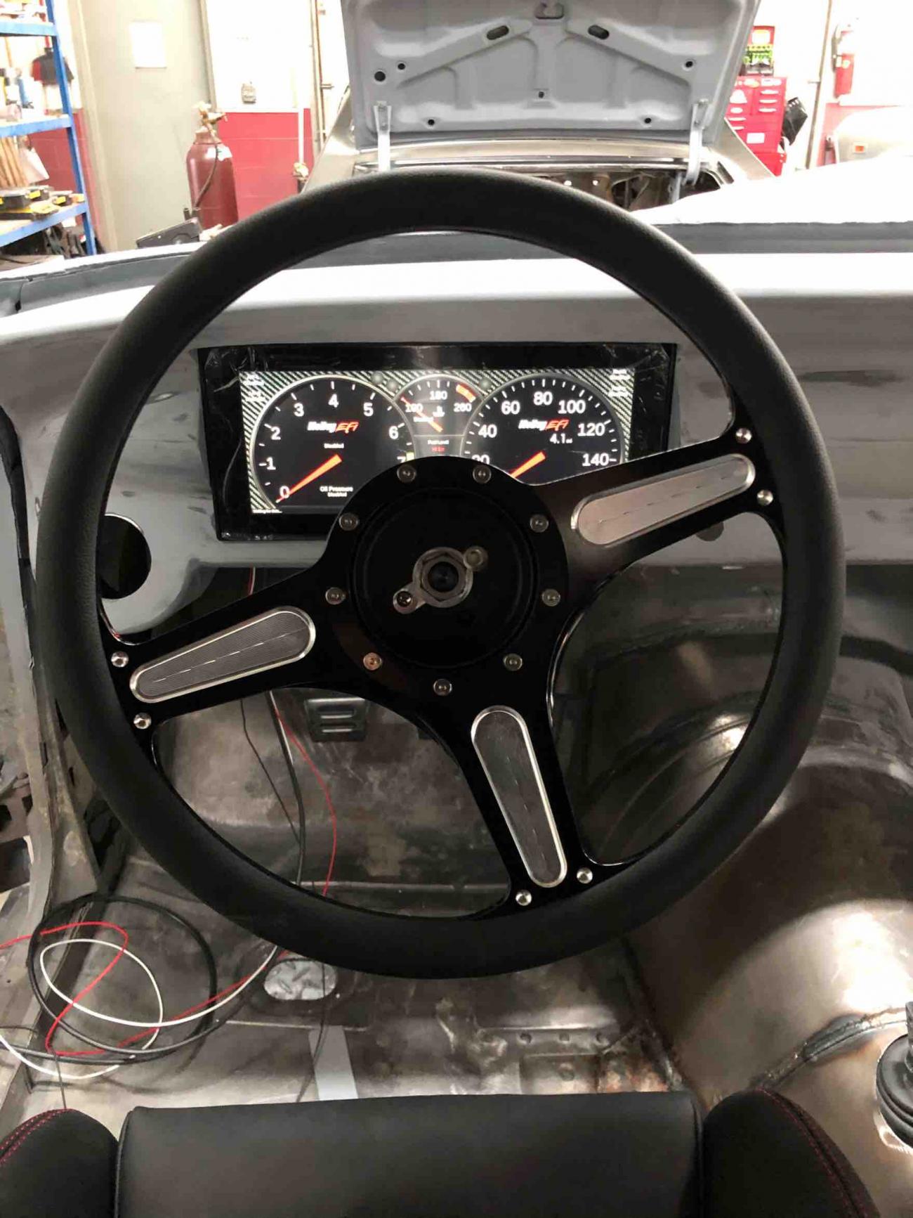

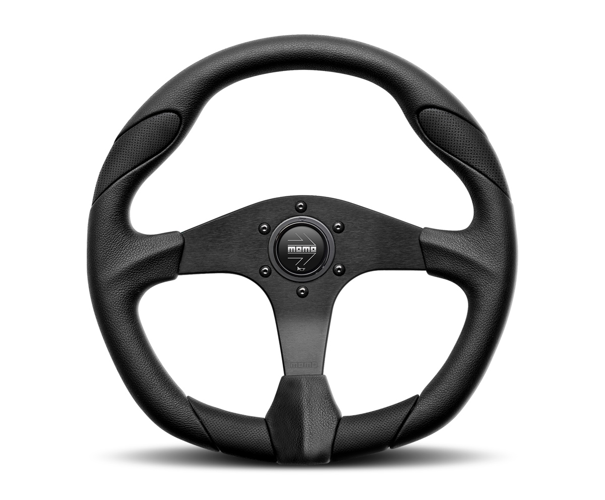

Here is a picture of Momo wheel that I’m using...
Attachment 71470

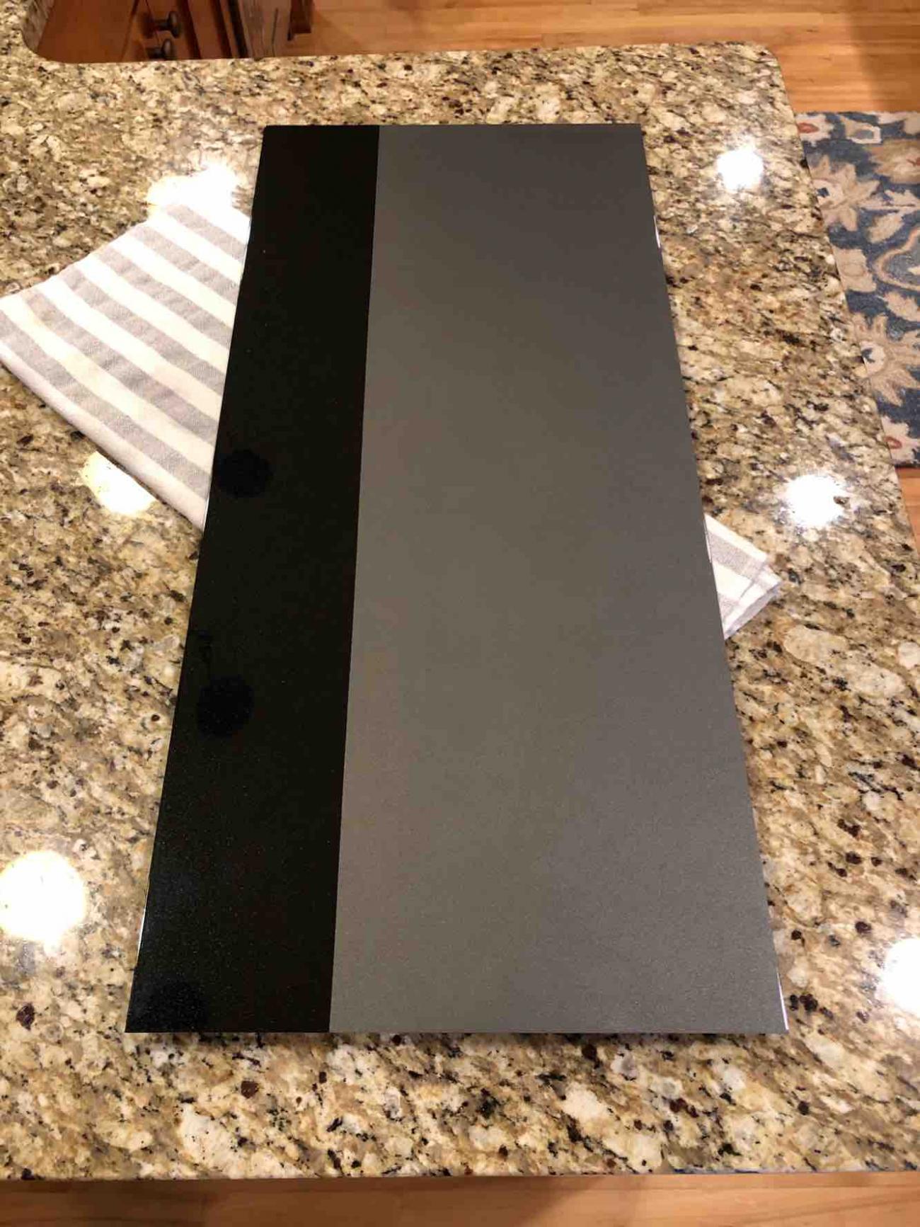

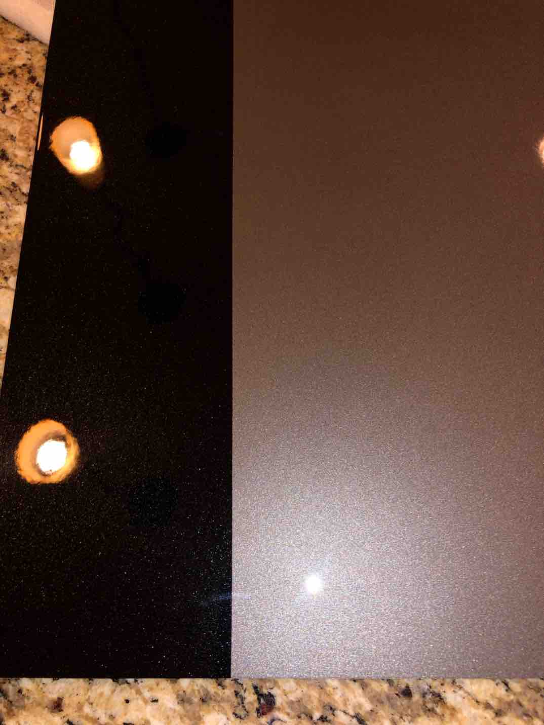

Kurt also sprayed out a test panel for the body color (shark gray metallic) and trim (carbon flash metallic). I really love the colors and can’t wait to see them on the car.

Below are some pictures of the test panel that Kurt sprayed. A little tough to capture on my phone’s camera, but took a few different pictures with and without flash to try to better show the metallic in the colors. Attachment 71607
Attachment 71608
Attachment 71609

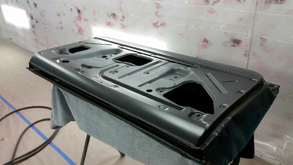

bkswede 04-25-2020 10:07 PM
‘63 Chevy II Pro-Touring Build
10 Attachment(s)
I hope everyone is safe and making the best of the unique situation we find ourselves in now... unfortunately, the stay at home order in Wisconsin has slowed progress on my build, and we’re not as far along as I hoped we would be at this time. Nevertheless, Kurt and team have continued to make progress and we get closer to paint. He’s finished with mock up of drivetrain, radiator, condenser, a/c drier, vintage air unit, catch can, PWM module for fans, routing of oil cooler lines, and test fit of all front end pieces. He’s also got the bumpers finished, having welded the mounting brackets to the back of the bumpers, welded up the bolt holes, smoothed everything and primed them. The drivetrain was removed, front subframe removed and working now on final welding/smoothing of the firewall. The rear suspension will come out early next week and then he’ll put the car on the rotisserie. We need to smooth some welds on the bottom and get it prepped for Upol... should then be ready for paint. Here are some pics of progress. I haven’t been able to drive over and see the car due to the stay at home order, so relying on pictures from Kurt to see progress.

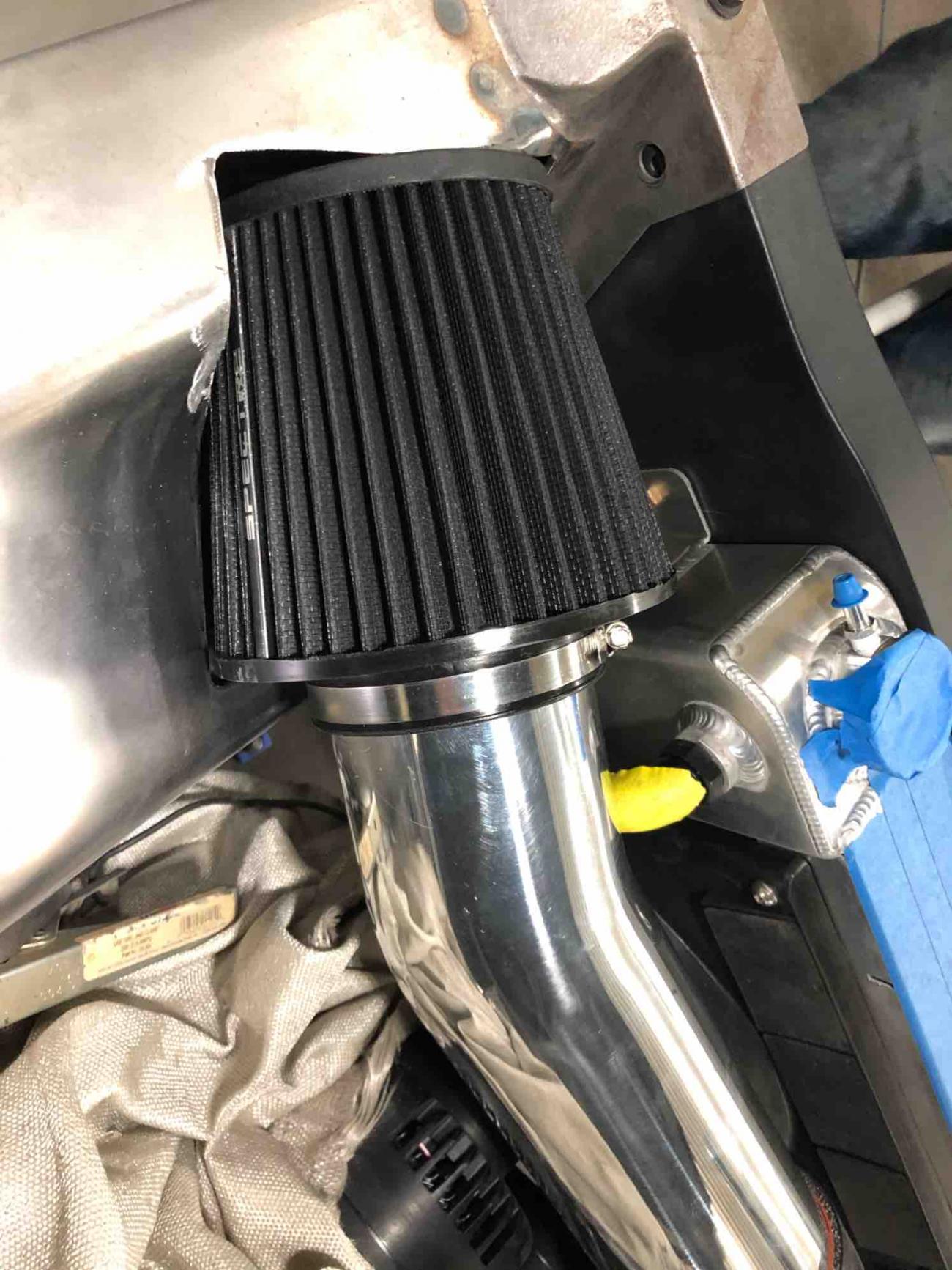

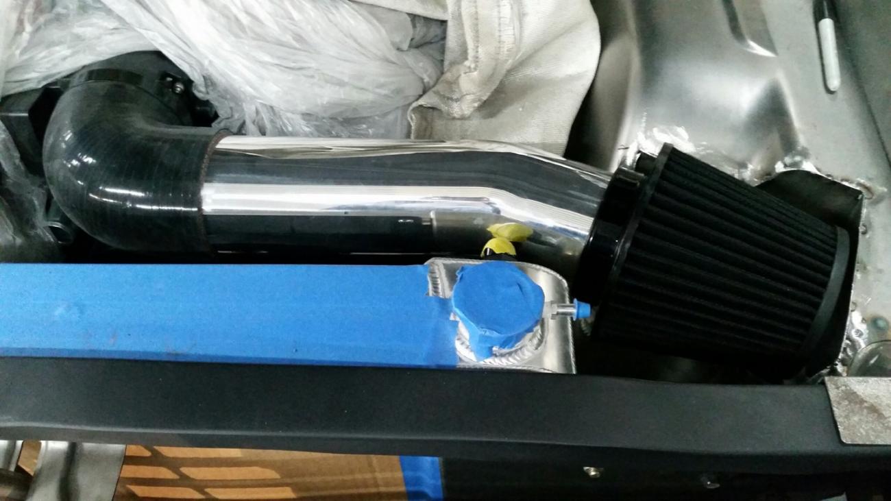

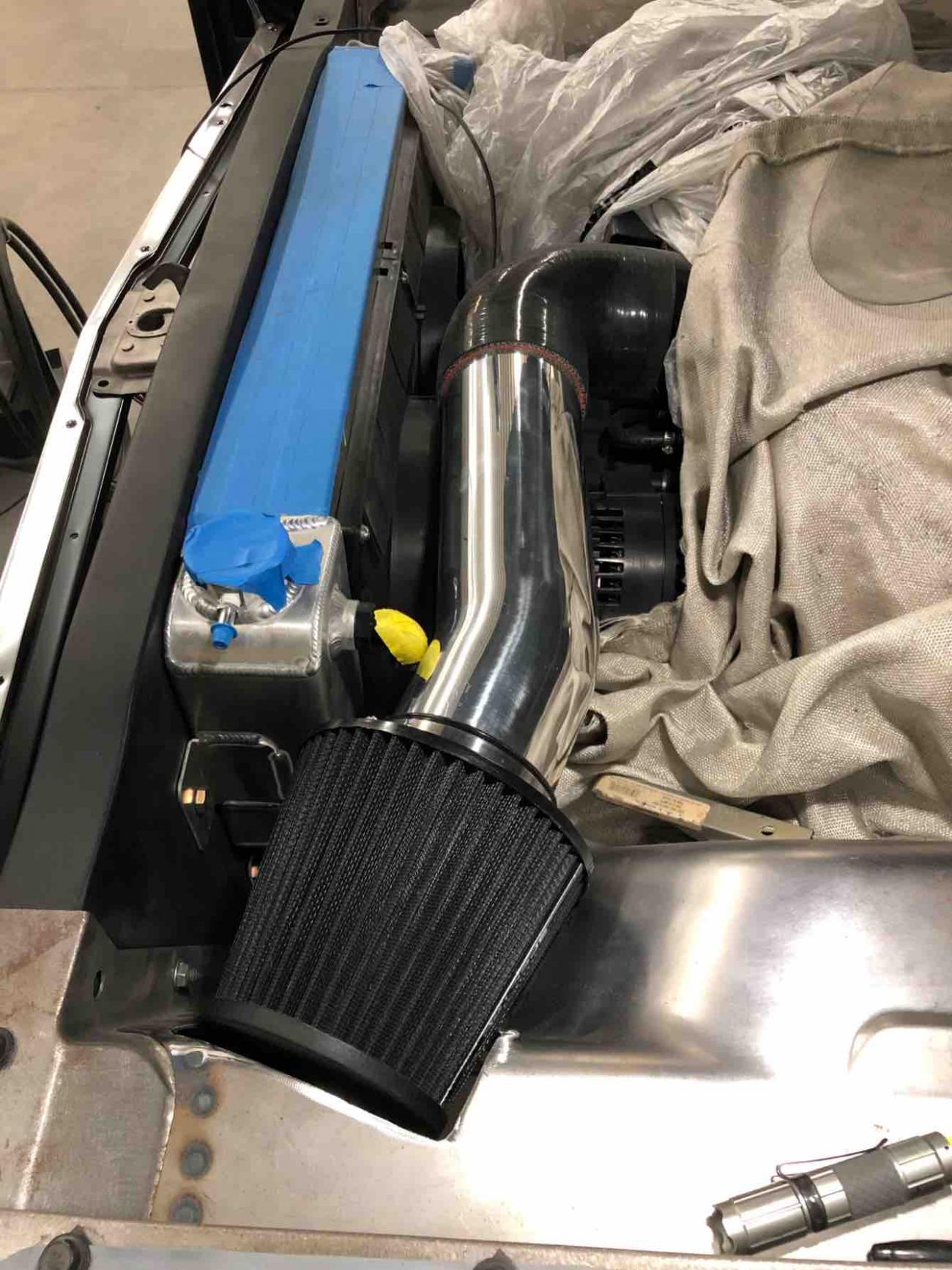

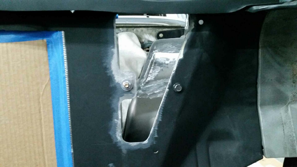

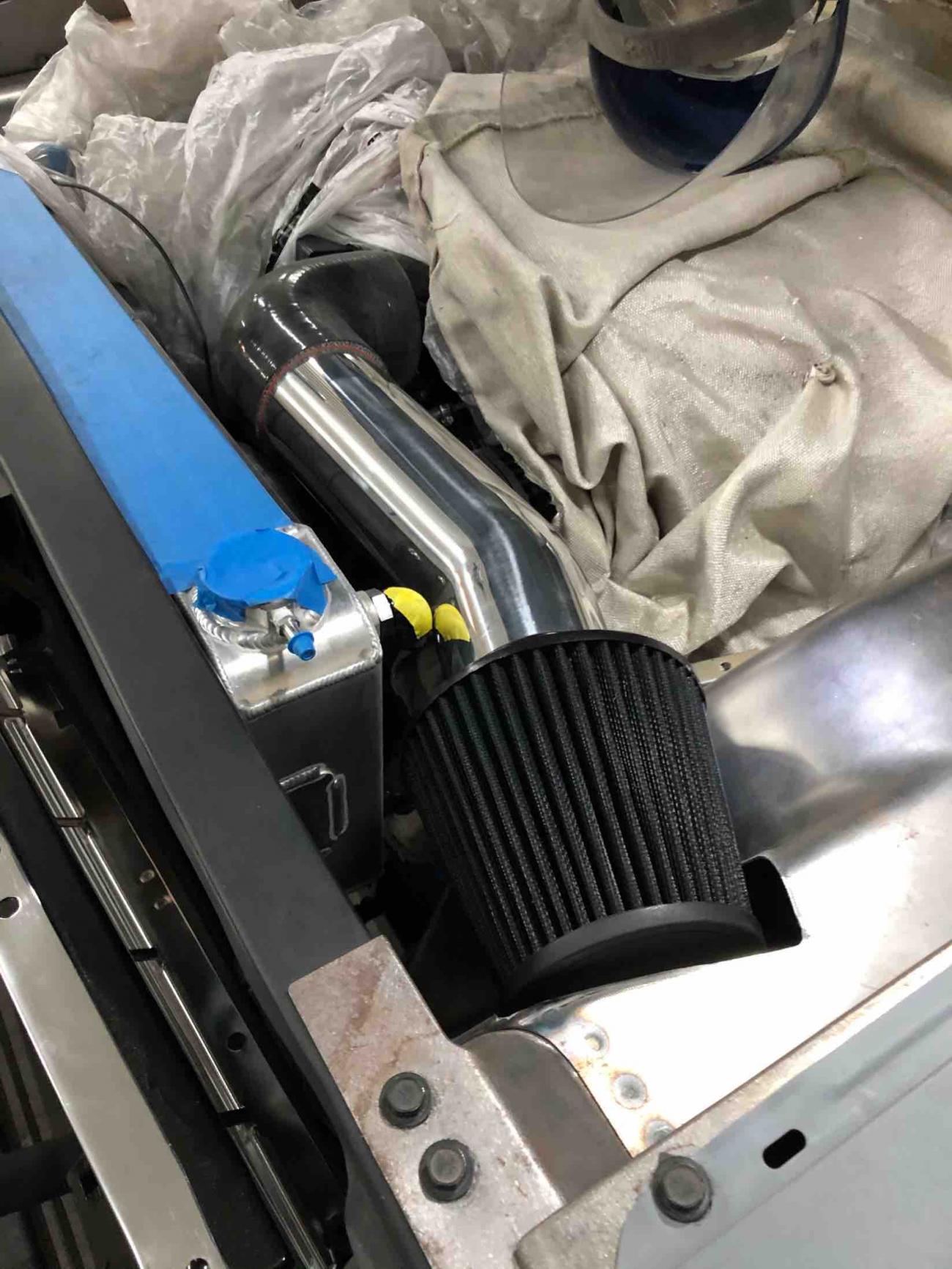

Here are finished shots of the work we did for the cold air intake. We had to cut a pocket out of the driver side inner fender for the air filter to sit into. We then opened up the filler panel in the radiator core support, which will allow cool air through the grill to be funneled directly to the air filter.
Attachment 71949
Attachment 71950
Attachment 71951

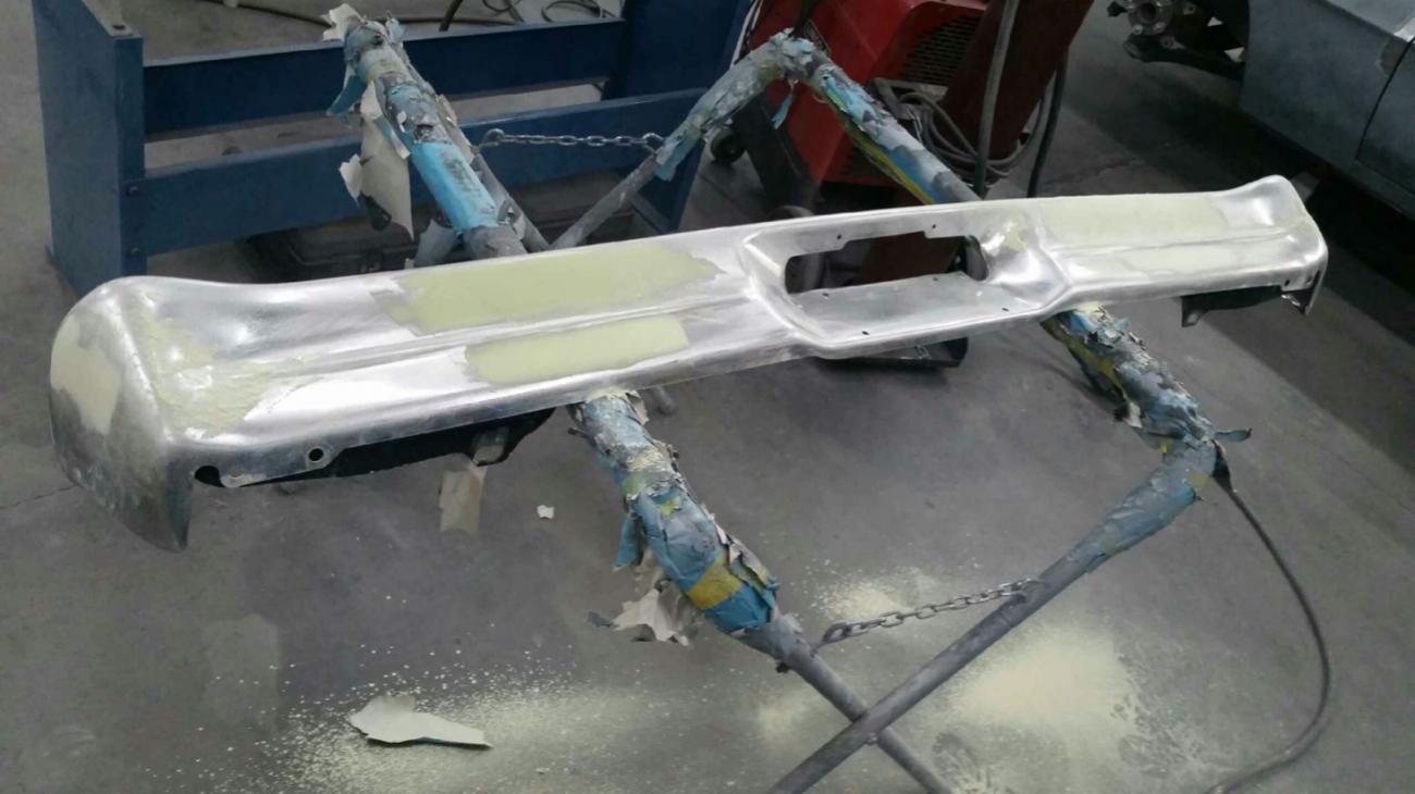

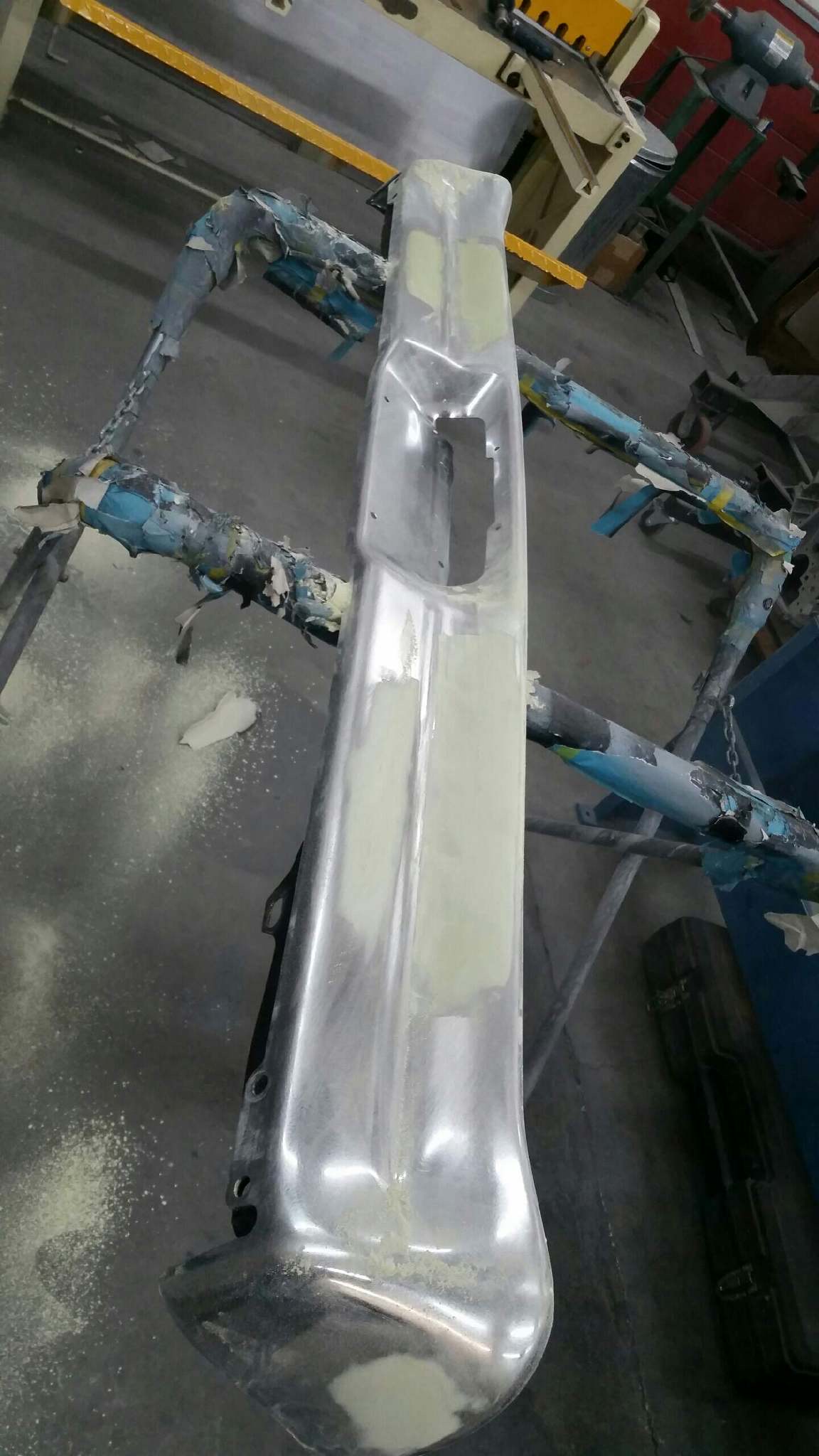

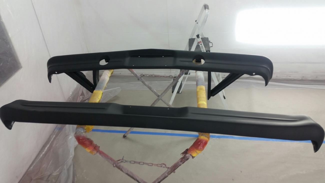

Here are some shots of the work done on the bumpers, which will be painted carbon black metallic:
Attachment 71952
Attachment 71953
Attachment 71954

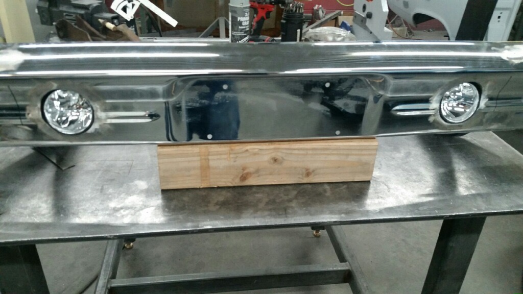

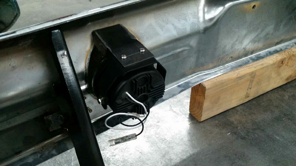

We installed LED driving lights in the front bumper, and Kurt fabbed up some mounting brackets that were welded to the inside of the bumper:
Attachment 71955
Attachment 71956
Attachment 71957
Here are some shots showing mock up of the condenser and drier. The drier was mounted in the passenger side inner fender well. We’re running all a/c lines and heater hoses through the inside of the passenger fender well to keep the engine bay as clean as possible.
Attachment 71958
https://uploads.tapatalk-cdn.com/202...312a4c89b3.jpg
My car didn’t come with a rear seat and I’ve been considering a number of alternatives, including the TMI custom molded rear seat that is basically two small buckets seats. That seat is super expensive, which doesn’t make much sense in that the seat will rarely be used. As I was doing research, I noticed that the rear seat from newer 3 series BMWs is a near perfect match in size. I got a great deal on one on eBay. I will have it recovered in the same leather as my front seats, with similar pattern. The two side pieces on the seat back will fit over the wheel tubs nicely, but need to be trimmed a bit, which is why they’re not shown in the photo. It fits really nicely. We’ll need to fab some mounts for it and trim a bit around the driveshaft tunnel, but it should look great when done.
https://uploads.tapatalk-cdn.com/202...b6c13ca552.jpg
https://uploads.tapatalk-cdn.com/202...68cb1a24a4.jpg
https://uploads.tapatalk-cdn.com/202...1b764c2359.jpg
I also got my driveshaft built during mock up - went with a QA1 custom carbon fiber shaft. It’s a work of art and a shame it won’t be seen under the car.
https://uploads.tapatalk-cdn.com/202...d399942a02.jpg
Underside of deck lid and hood primed and ready for paint:
https://uploads.tapatalk-cdn.com/202...b8c0e3d10a.jpg
https://uploads.tapatalk-cdn.com/202...4855371d01.jpg
Rear package tray that Kurt fabricated to replace the original one. Speakers will under mount. https://uploads.tapatalk-cdn.com/202...1aa8a8bf3e.jpg
Front end all test fit and adjusted. I bought some LED lights with halos. The halos are white as day time running lights, but will blink amber with turn signals.
https://uploads.tapatalk-cdn.com/202...f7a29d2b50.jpg
https://uploads.tapatalk-cdn.com/202...b45794c5ed.jpg
For the rear spoiler, I decided to use the aluminum spoiler produced by Ring Brothers. This is a picture of it on a Mustang they built:
https://uploads.tapatalk-cdn.com/202...db5175fac.jpeg
https://uploads.tapatalk-cdn.com/202...f259df8f1.jpeg
This is a picture of it sitting on the deck lid. This isn’t the actual mounting position, but gives you a sense of width of the spoiler and size on the deck lid. The spoiler will be painted the same black as other trim on the car.
https://uploads.tapatalk-cdn.com/202...b9d4c9db81.jpg
https://uploads.tapatalk-cdn.com/202...8f8bf29dd9.jpg
https://uploads.tapatalk-cdn.com/202...32a9cebc56.jpg
Be well and stay safe... Brian

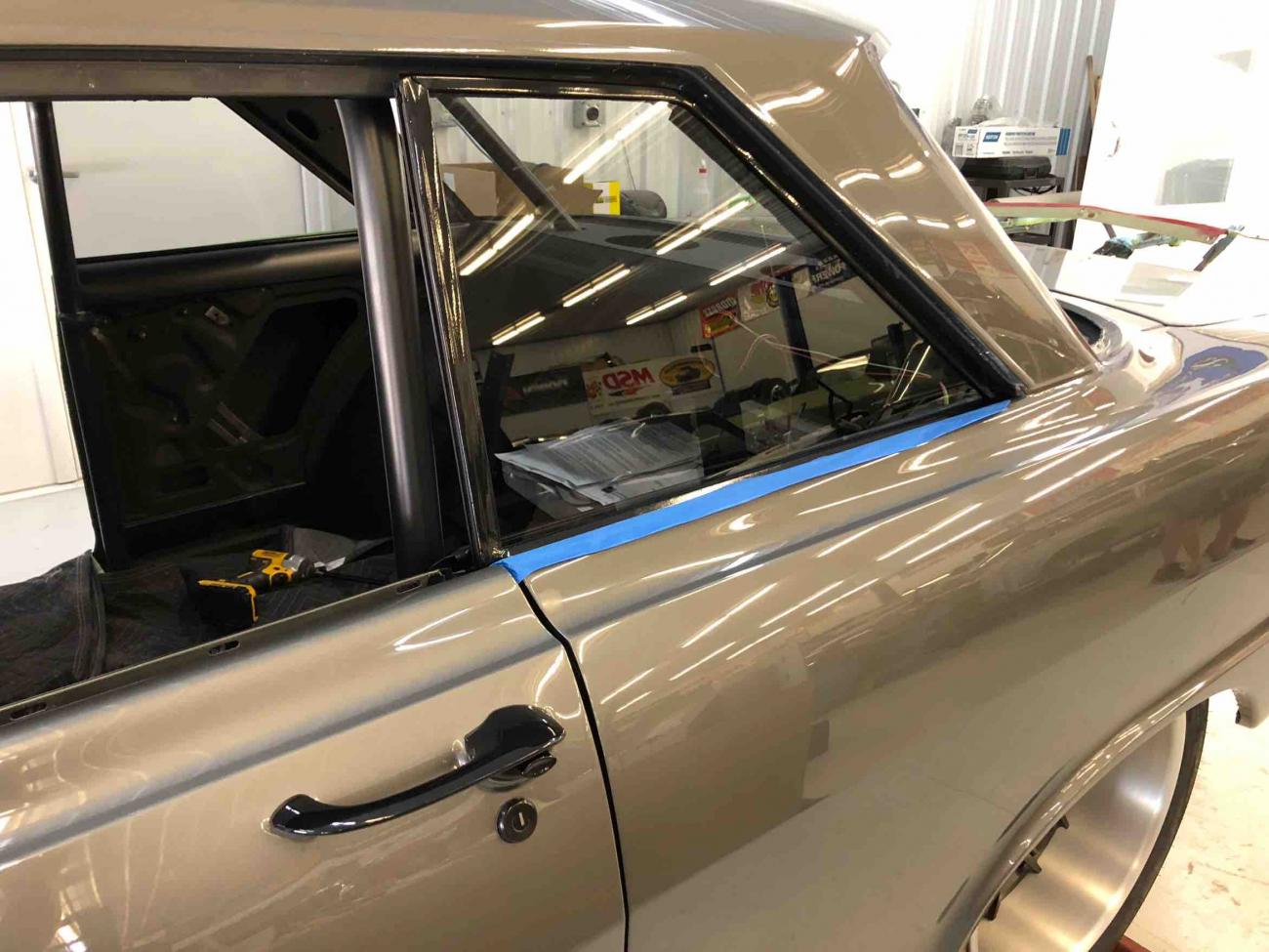

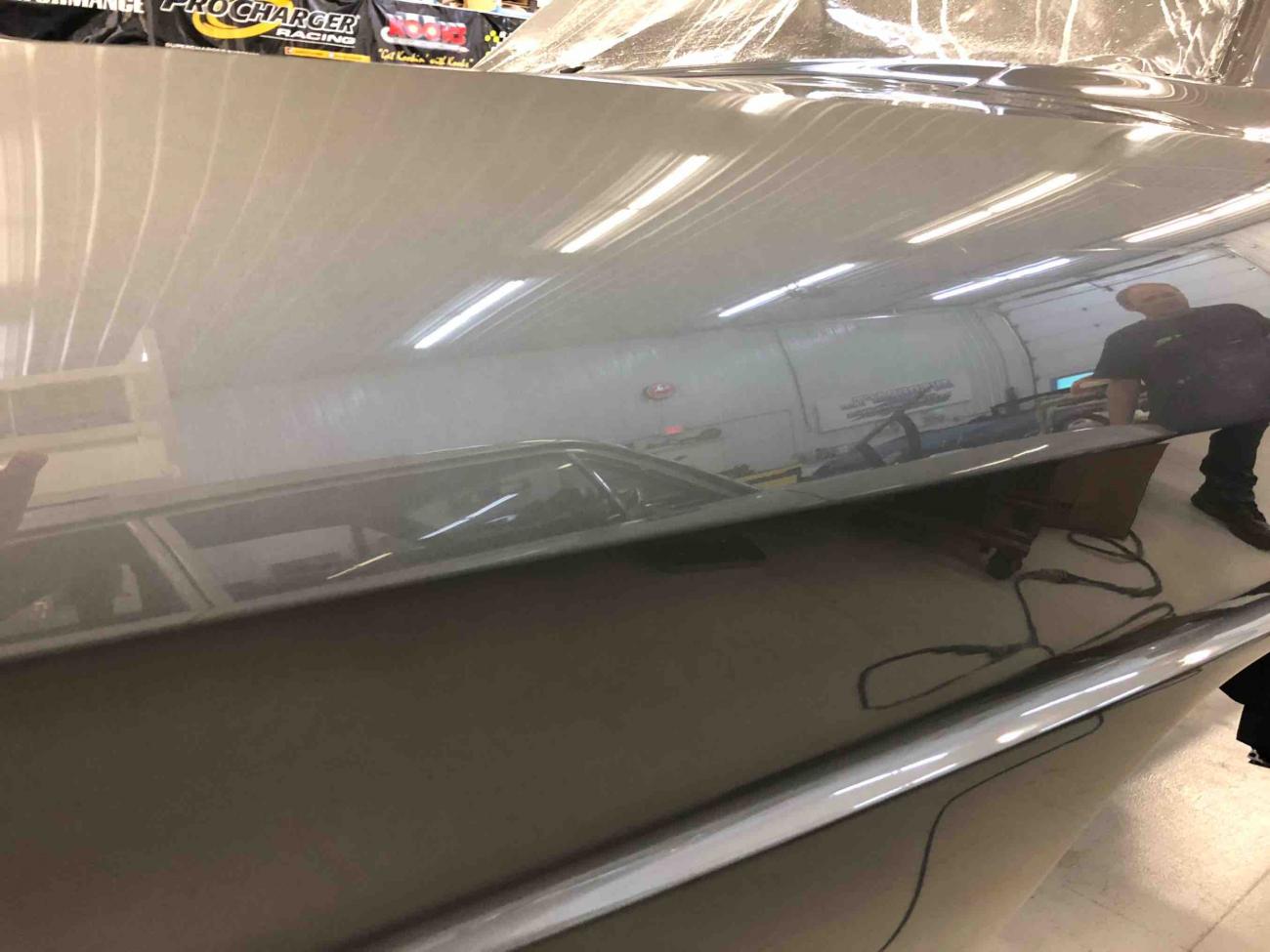

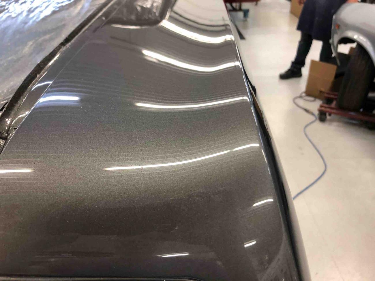

bkswede 05-14-2020 08:26 PM
10 Attachment(s)
Finally was able to make a trip to WI today to see, first hand, progress on the Nova... been a long time - almost six weeks!
Last week, Kurt sent me some pictures of the Nova... he was able to get the interior primed and painted (just floors and other areas of the interior that won’t be visible when the car is finished).
Attachment 72181
Attachment 72182
Attachment 72183
Attachment 72184
Attachment 72185
He also was able to get the underside of the car finished in Upol...
Attachment 72186
https://uploads.tapatalk-cdn.com/202...f5e9bd646f.jpg

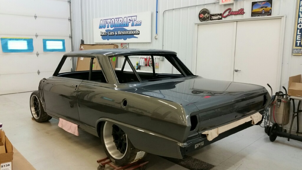

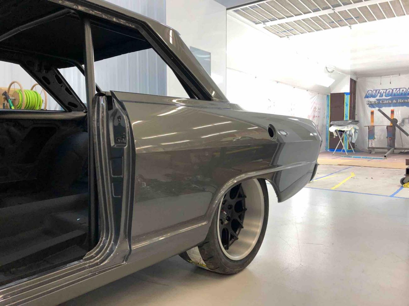

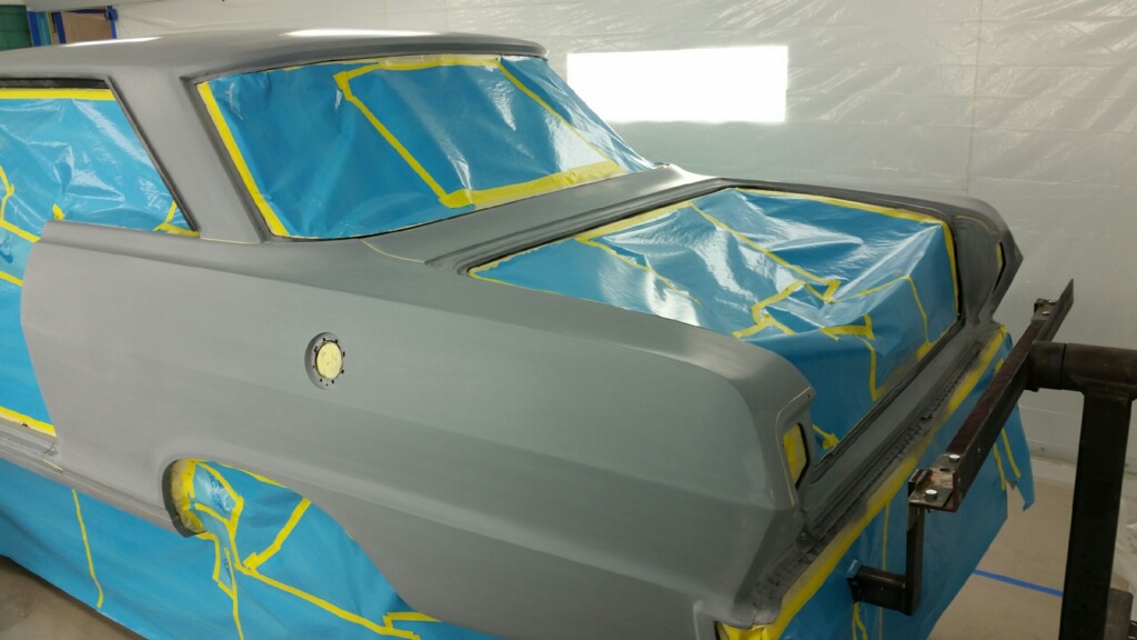

Drove over to WI today and was surprised to see that he had the car painted and was well into wet sanding... looked great! Color is stealthy for sure... as always with paint, pics don’t really do it justice. Appears a little darker in pictures than it actually is. Hope to be done with wet sanding and buffing early next week, then can start assembly... been a long time coming [emoji16]
Attachment 72188
Attachment 72189
Attachment 72190
Attachment 72191
https://uploads.tapatalk-cdn.com/202...683c609d70.jpg
https://uploads.tapatalk-cdn.com/202...b006a04355.jpg
https://uploads.tapatalk-cdn.com/202...f4883e9567.jpg
https://uploads.tapatalk-cdn.com/202...628b6b6c84.jpg
https://uploads.tapatalk-cdn.com/202...0aa3b49676.jpg
https://uploads.tapatalk-cdn.com/202...325971b61c.jpg
https://uploads.tapatalk-cdn.com/202...c3d39653e1.jpg
https://uploads.tapatalk-cdn.com/202...dab77187c2.jpg
https://uploads.tapatalk-cdn.com/202...ba4f04ce4e.jpg
https://uploads.tapatalk-cdn.com/202...ad8eb1025e.jpg
https://uploads.tapatalk-cdn.com/202...d4f66ddade.jpg

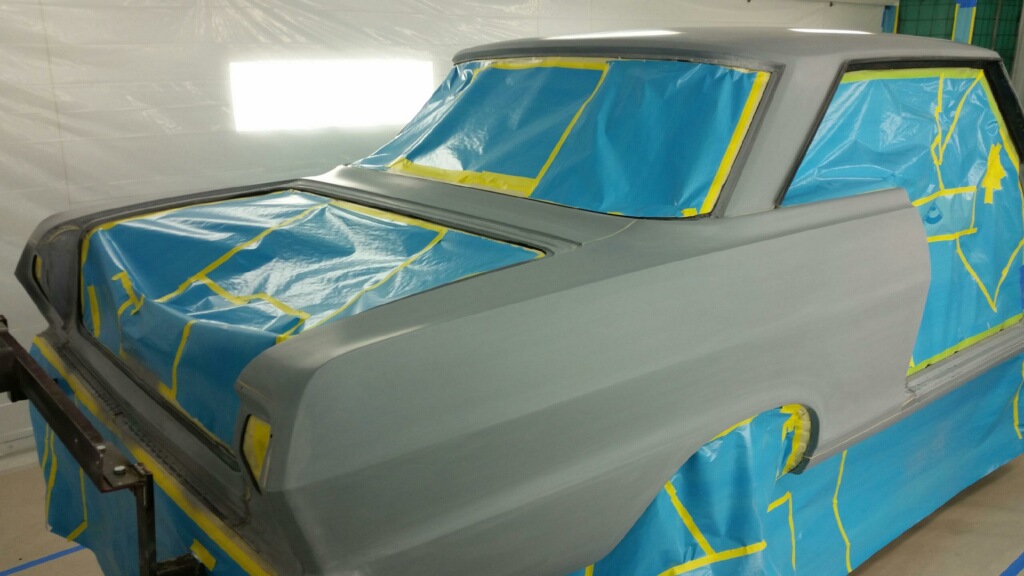

After wet sanding and buffing, inner fenders, firewall, core support, etc will be sprayed a satin black. Then exterior trim, bumpers, etc all painted carbon black metallic. Interior will be sprayed later, likely a darker charcoal gray metallic. I’m really excited to see the progress and can’t wait for the final assembly to start!

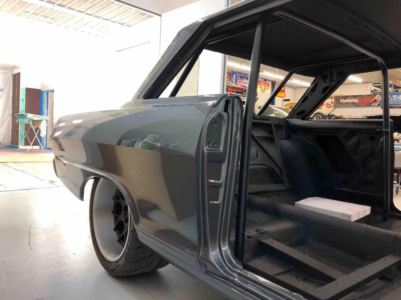

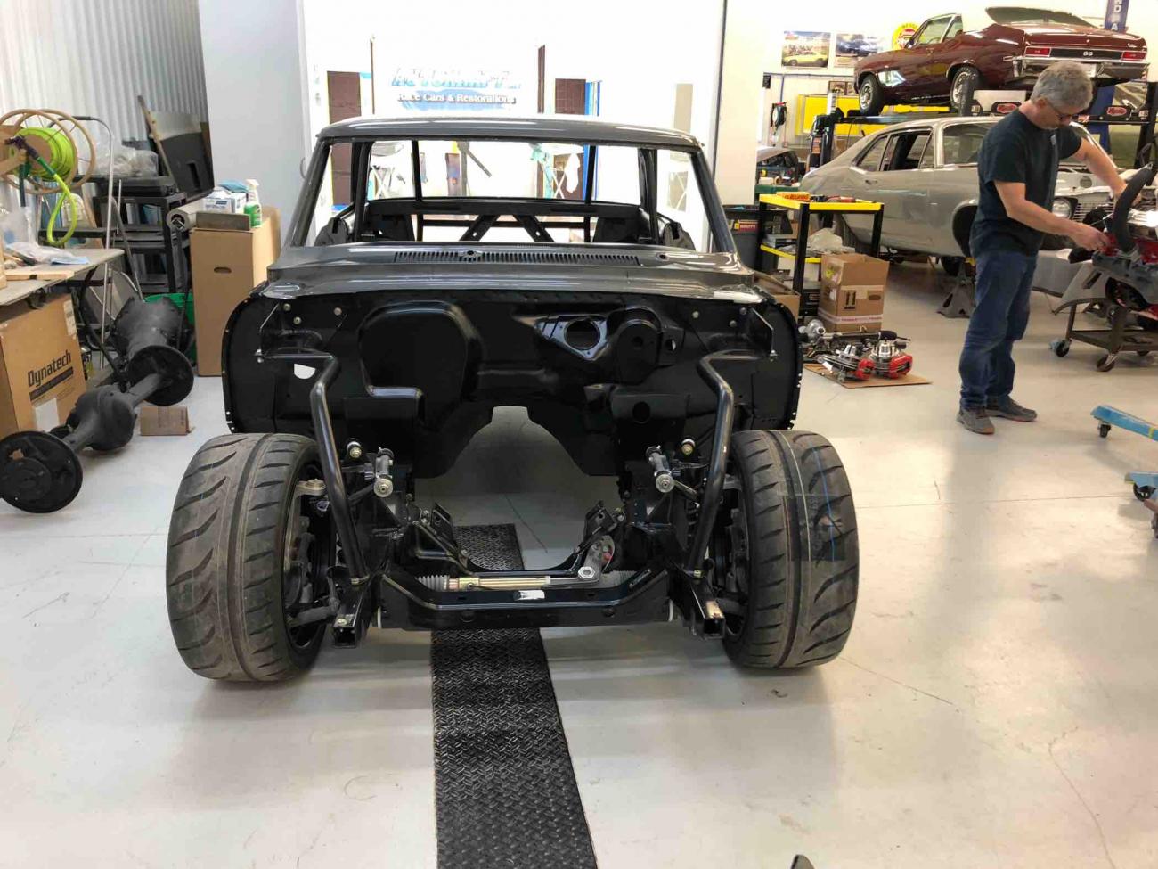

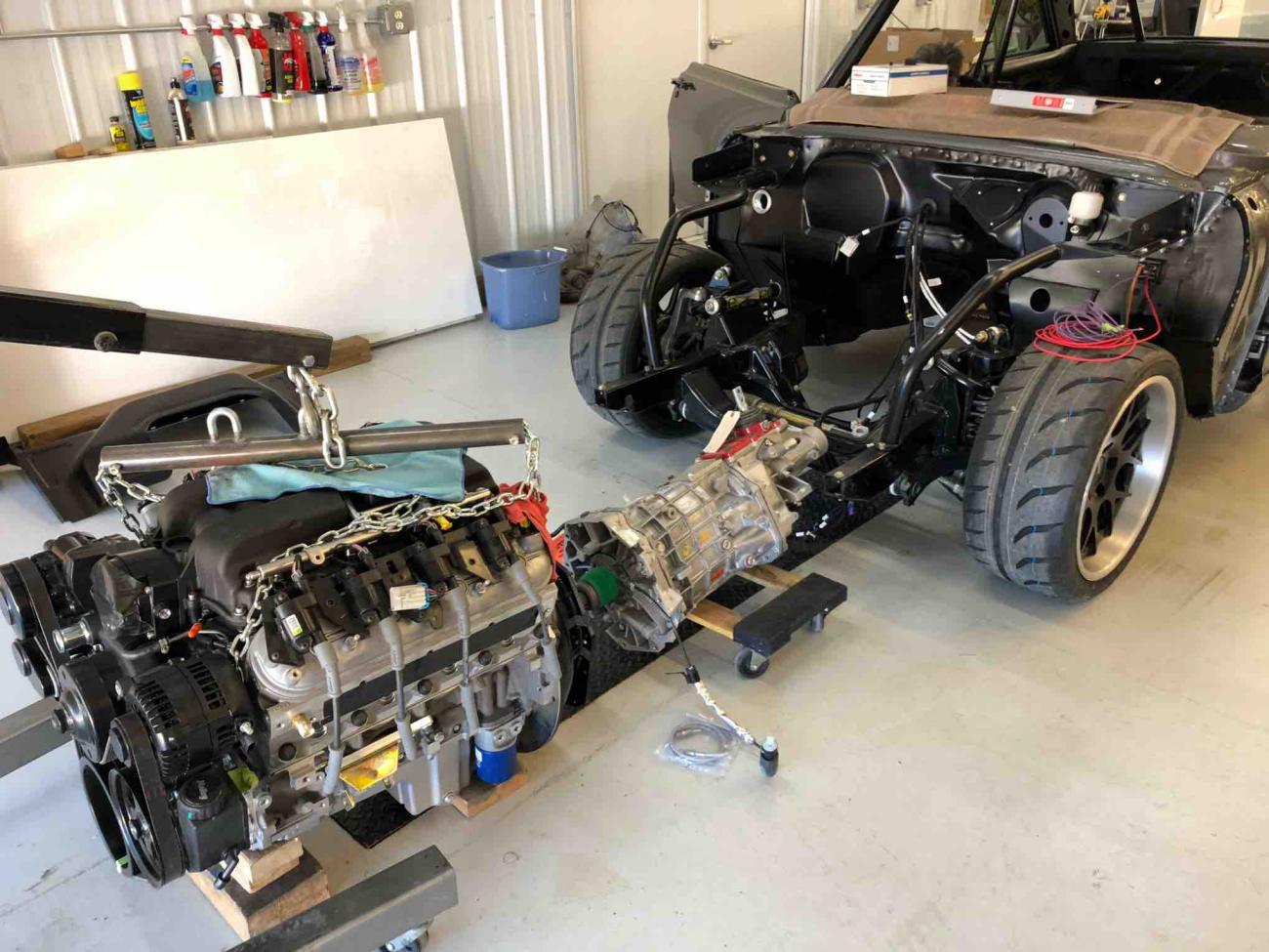

bkswede 06-18-2020 06:43 PM
10 Attachment(s)

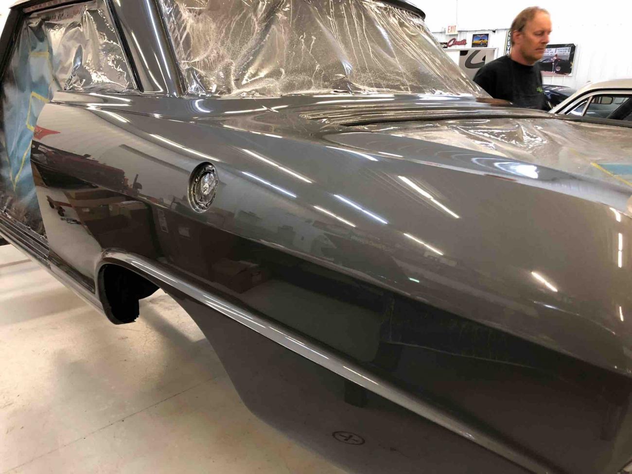

Quick update on progress made on the Nova over the last few weeks. Kurt was able to finish wet sanding the exterior and has buffed the body. Doors, front fenders, hood and trunk are wet sanded, but still finishing the buffing process. Due to scheduling issues in the shop, Kurt wanted to focus on getting the interior painted, sound deadener sprayed, and firewall painted before finishing the final buffing on other panels. Attached are some pictures of the body that I took when I visited last week. He does three levels of buffing/polishing (each with a successively finer polishing compound and pad). These pictures were taken after the first level of polishing.
Attachment 72452
Attachment 72453
Attachment 72454
Attachment 72455
Attachment 72456

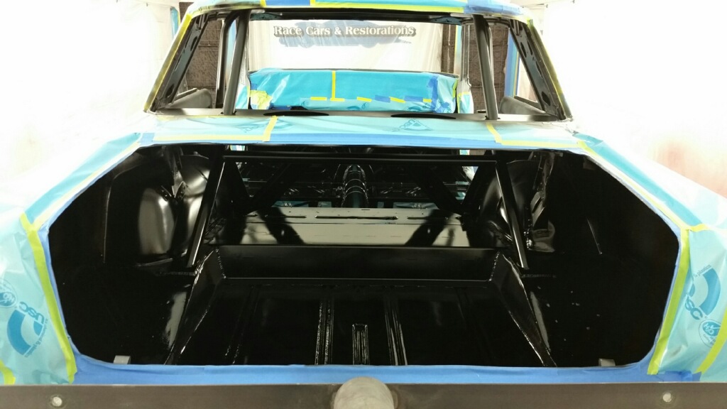

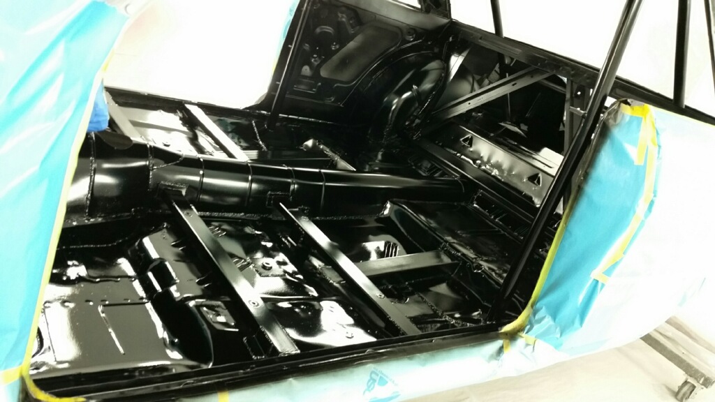

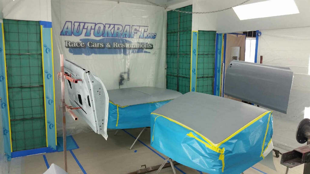

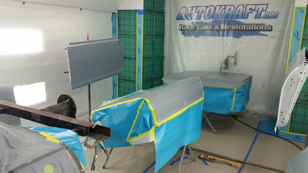

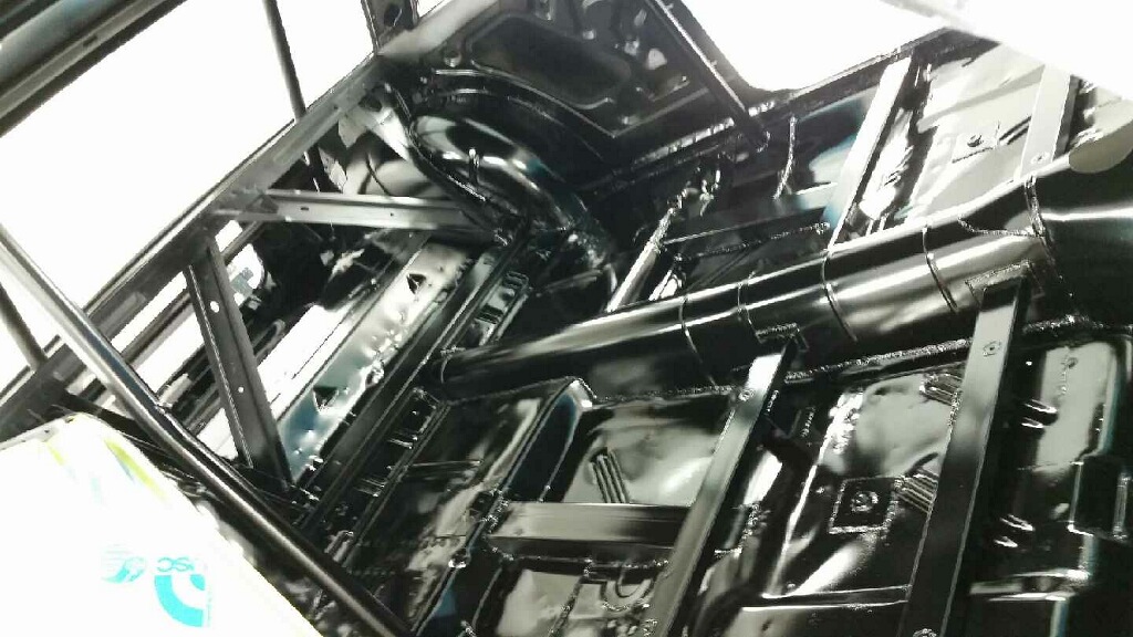

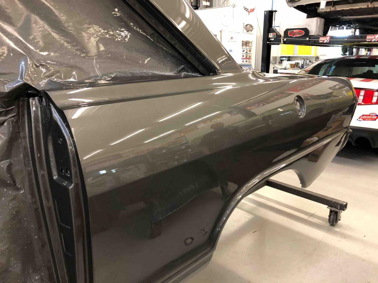

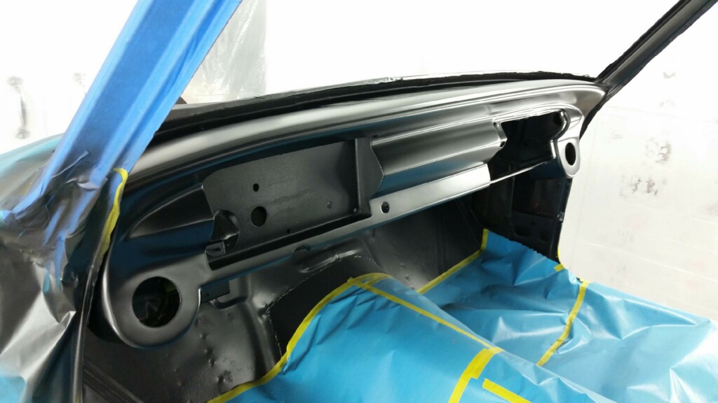

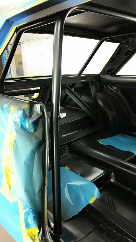

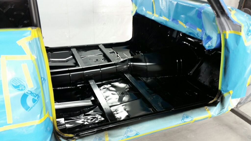

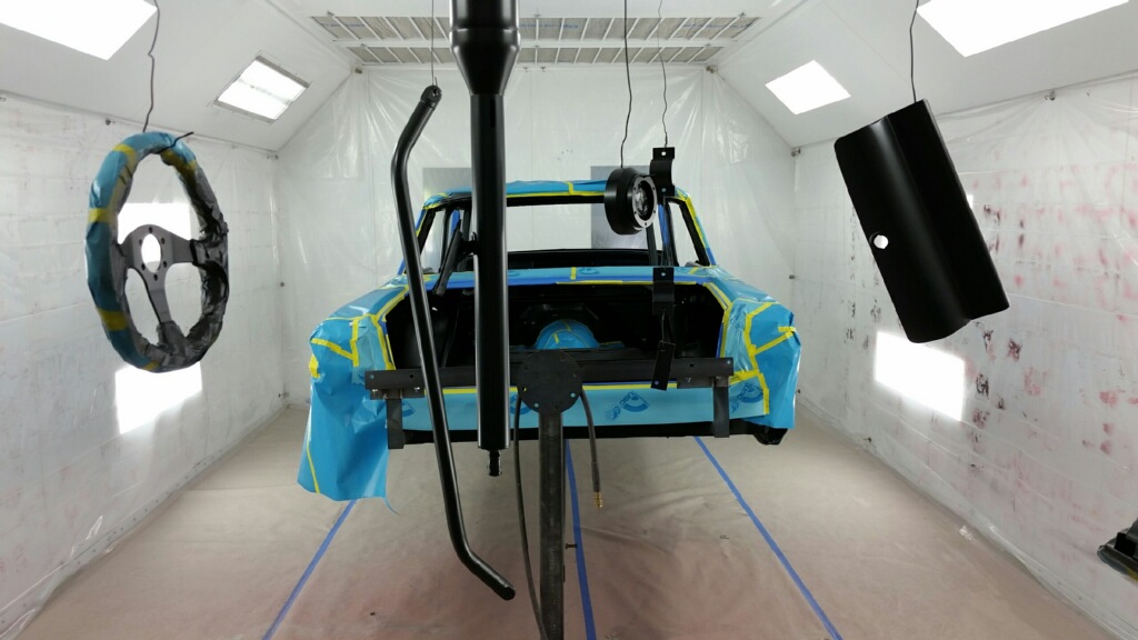

After completing the polishing on the shell, Kurt masked the body off to paint the interior. We ended up using Nightfall Gray Metallic, a color that’s a middle ground between the Shark Gray Metallic body color and the Carbon Black Metallc that the trim, bumpers, etc will be painted in. I’m a big fan of the Nightfall Gray Metallc... almost ordered my 2017 ZL-1 in that color. We wanted a little contrast to the body color and the darker color goes better with the color of the leather for my seats. Kurt also painted the steering wheel column, steering wheel, steering column mount, glove box, etc. Some photos below.
Attachment 72457
Attachment 72458
Attachment 72459
Attachment 72460
Attachment 72461
As a reminder, here are my Recaros I had custom done...
https://uploads.tapatalk-cdn.com/202...cc8bd9ecd7.jpg

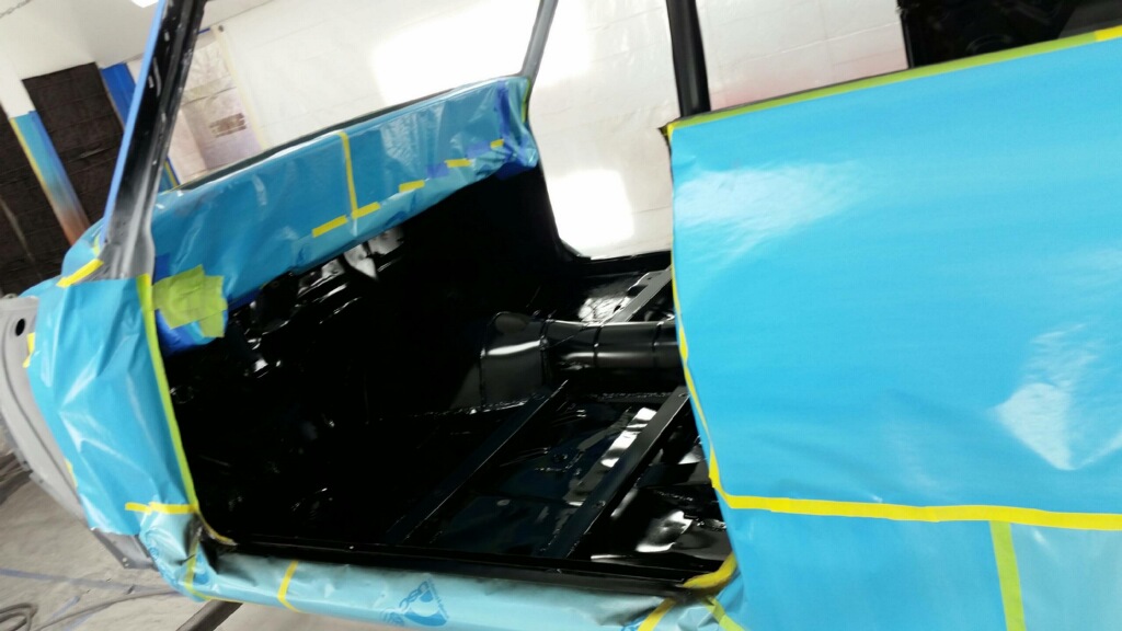

After we got the interior painted, Kurt masked off the freshly painted interior areas and we sprayed sound deadener on the floors, roof, inside the doors, inside firewall, inside rear quarters, trunk, etc. We used a product from Second Skin audio called Spectrum. Really helps to eliminate resonance and noise from vibrations inside the car. Sprays on a bit like a bed liner. Kurt has never used it before, but was excited to try it and thought it went on really well. We did three coats, approximately 1 mil thickness each.
https://uploads.tapatalk-cdn.com/202...6d1705255d.jpg
https://uploads.tapatalk-cdn.com/202...a480cb2210.jpg
https://uploads.tapatalk-cdn.com/202...81e459471a.jpg
https://uploads.tapatalk-cdn.com/202...f15502e17e.jpg
https://uploads.tapatalk-cdn.com/202...a6c88e0378.jpg
https://uploads.tapatalk-cdn.com/202...59d805092f.jpg

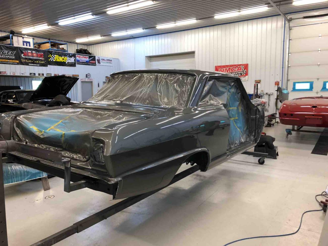

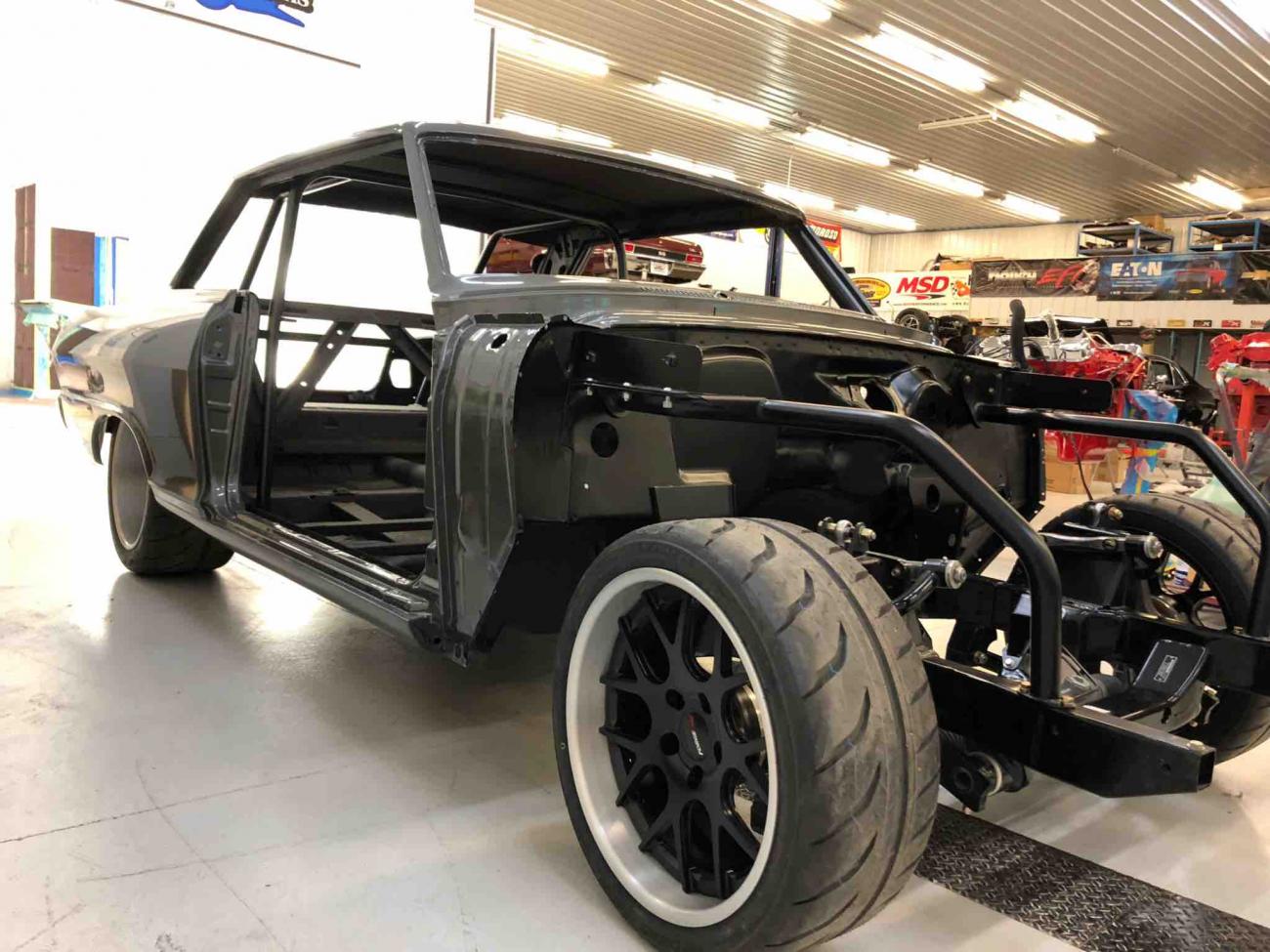

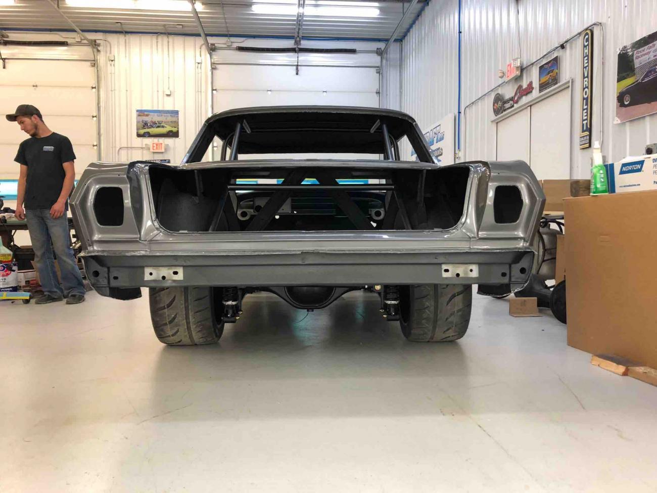

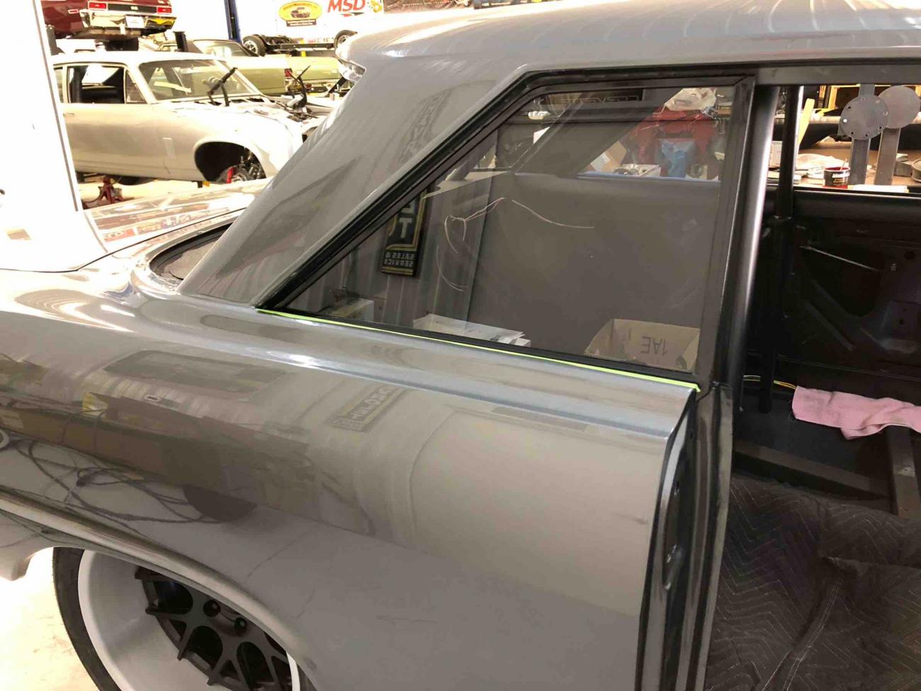

Finally, after finishing the interior, he was able to get the shell off the rotisserie and on a cart where he was able to spray the firewall in a satin black. Inner fender panels, underside of the hood, core support, etc. will be painted in the same color.
https://uploads.tapatalk-cdn.com/202...185c9d68c9.jpg
https://uploads.tapatalk-cdn.com/202...b46a1ffc36.jpg
Next week, the guys will be installing suspension back under the car, as well as the engine. It’s really exciting to see the progress and can’t wait for assembly to start! Hope all is well,
Brian

Awesome. Would you mind sharing who did your custom seat upholstery?

I purchased my seats from a gentleman in Poland, who is a Recaro specialist. Was referred to him from others on pro-touring.com and lateral-g... he is truly a craftsman at what he does. Fantastic quality and a reasonable price, even considering shipping from Poland. His website is: http://www.amx-performance.com/
His Facebook page is @AMXperformance. You can see a portfolio of his work there. Communication was excellent and quality was exceptional.

Goosesdad 06-30-2020 04:02 PM
Awesome - Thanks for sharing!!

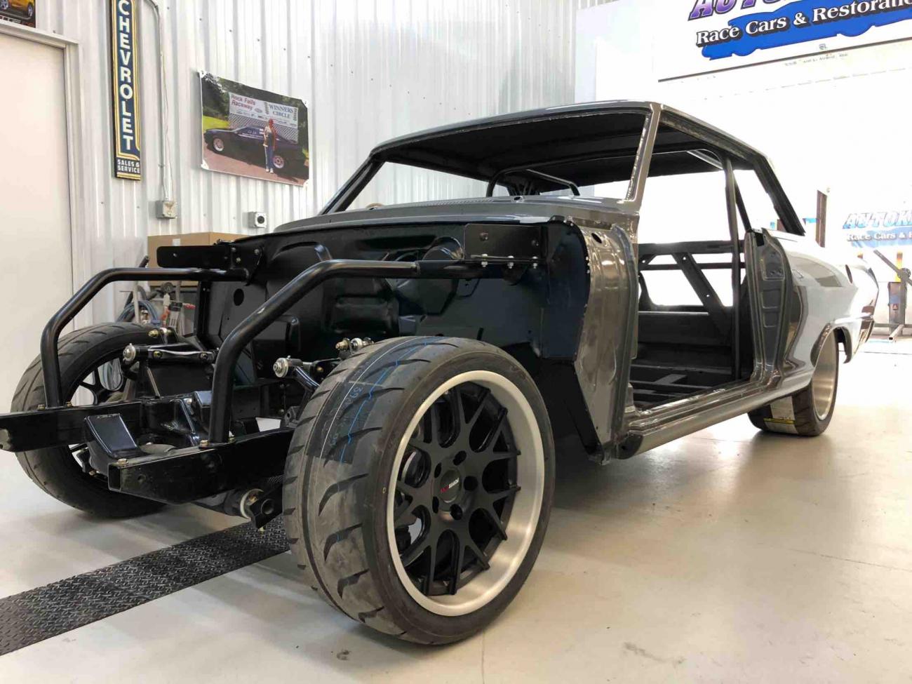

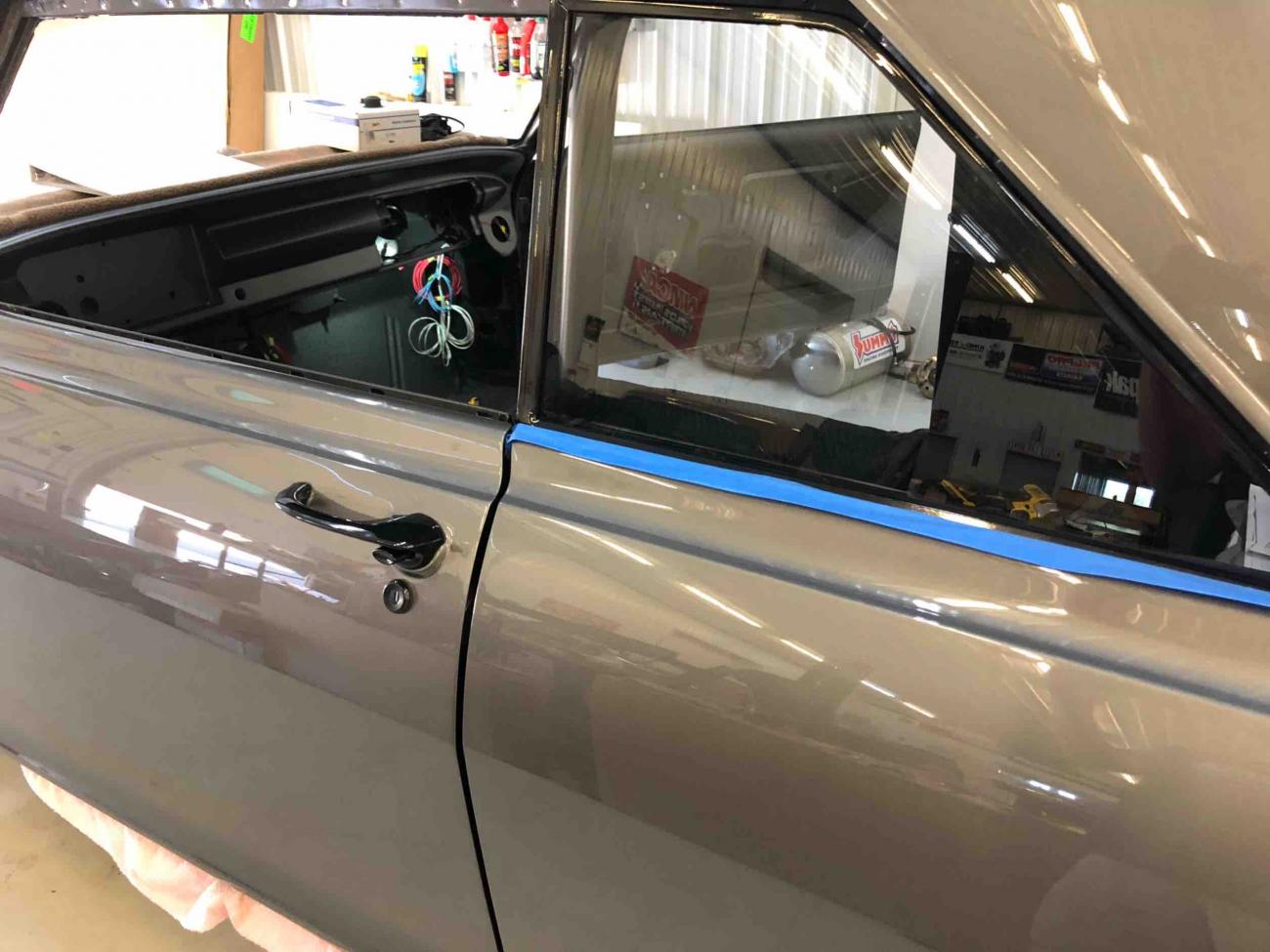

Doors and deck lid hung today, and Kurt sent a couple of pictures... starting to look a little more like a car. Can’t wait to see it in person next week
Attachment 72546
Attachment 72547

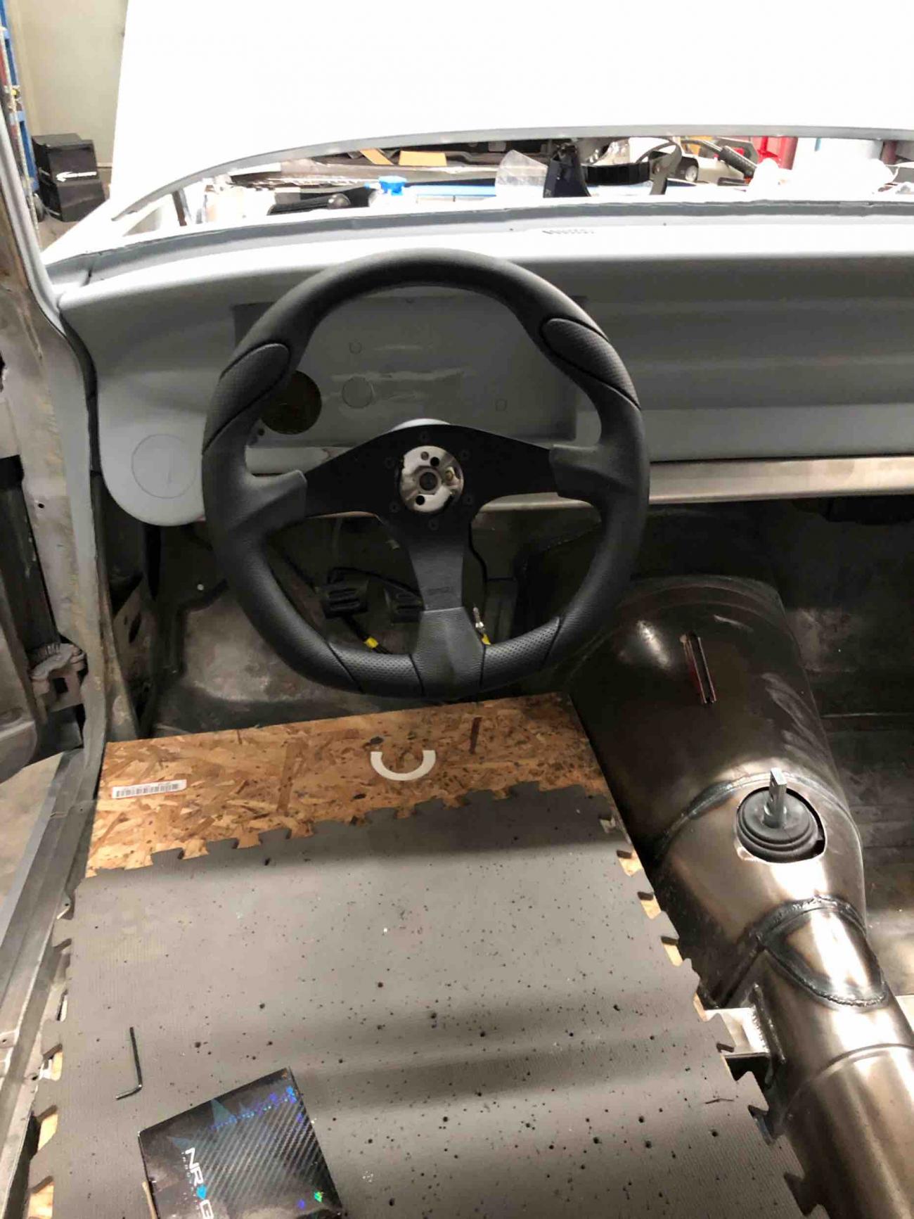

Made a quick run to Eau Claire today to check in on the Nova. Engine and transmission should go in on Monday. Kurt ordered a clutch bleeder from Tick Performance and the fitting was for the wrong slave cylinder, so he had to reorder. New one came in today, so driveline should go in Monday.
Attachment 72707

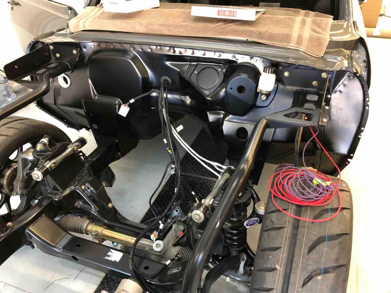

They’re also deep into wiring, which is going to be a big job. I’ve got a new American Autowire wiring harness that they’re installing, but they’re adding to that the Holley Dominator ECU harness, the Holley drive by wire harness, the Holley digital dash harness, various input/outputs for the ECU and dash (oil temperature, left/right turn signals, high beam, fuel level sensor, second wideband oxygen sensor, pulse width modulation fan control, etc), Vaporworx PWM fuel module control, Digital Guard Dawg keyless entry, PWM control for the dual Spal fans, etc. It’s a maze of wires - glad that Kurt and his team are as conscientious as they are!
Attachment 72708
Attachment 72709

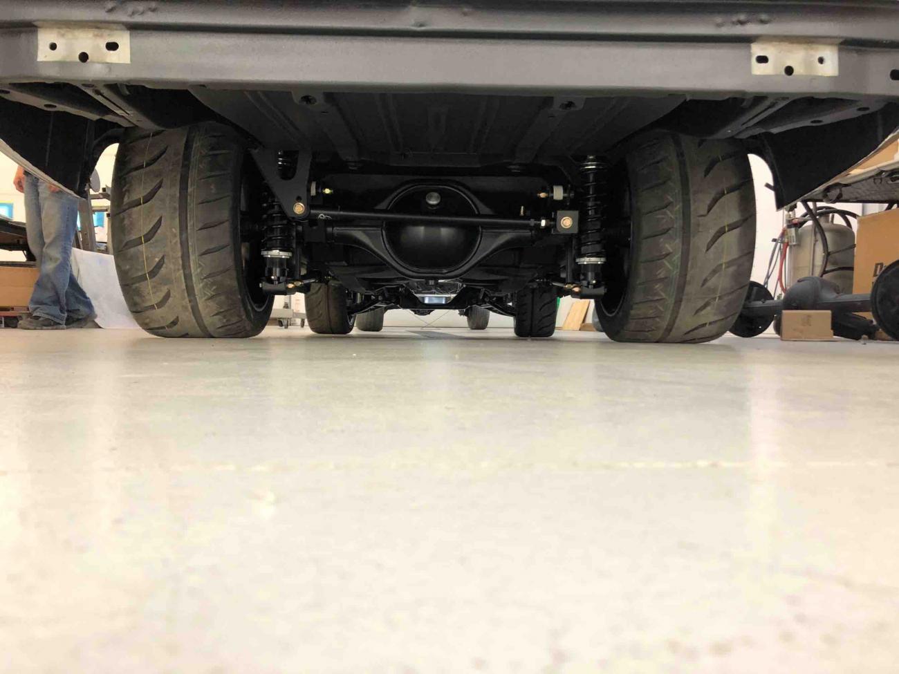

They’ve got the rear windows in, too. Side windows and vent windows will go in next week - just waiting for some vertical rigid channel for the front windows, which should be in sometime next week. Door handles were painted black, as was trim around the windows. Windows have a smoked gray tint - pretty subtle, but, man, does it look great in person with the gray body color and the black trim.
Attachment 72710
Attachment 72711
Attachment 72712
