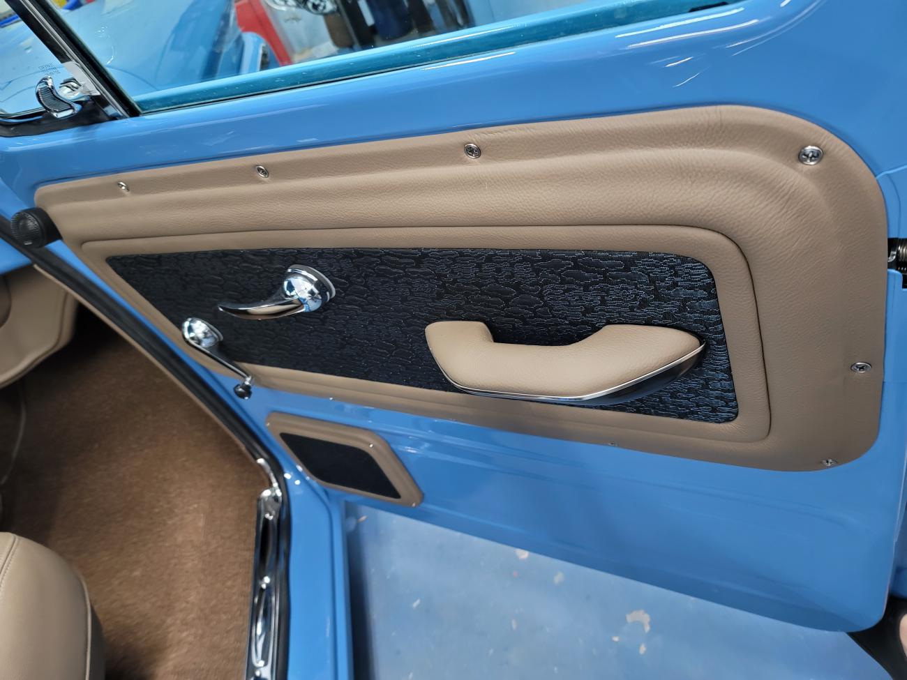

Door speaker grills. Look similar do the door panels.

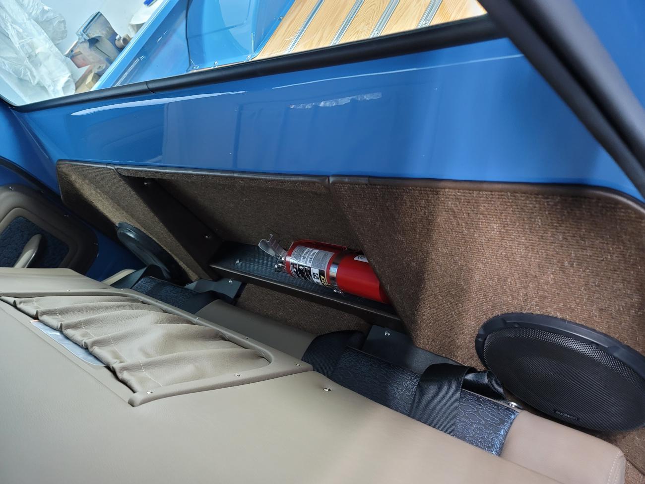

I wanted a premium sound system, but wanted more of an "original" look. Had Larry at Woods radio convert my original radio with Aurora design components that have all the latest features. Then purchased a Audison amp/dsp with 10" subs and 6" mids and tweeters. Big shout out to Mitchel at Next level audio in Nanaimo for working with me doing the final tune on the system. System has great "center stage". Best sound in a vehicle I've had.

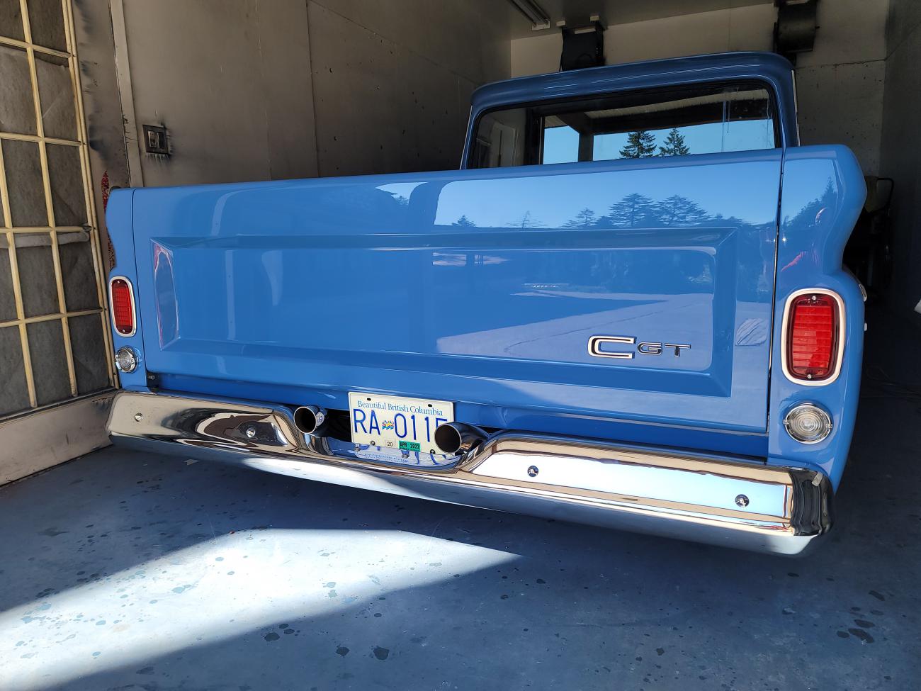

Ass shot
1 Attachment(s)
Finally got some emblems.

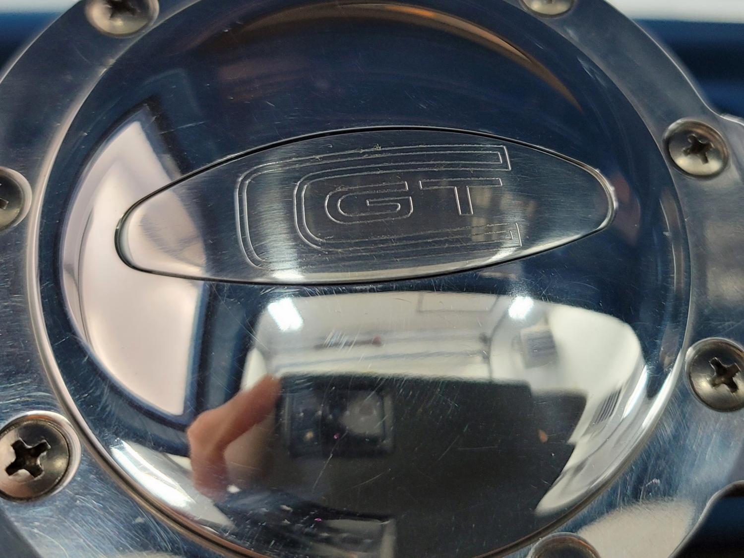

Detail on the Cgt horn button

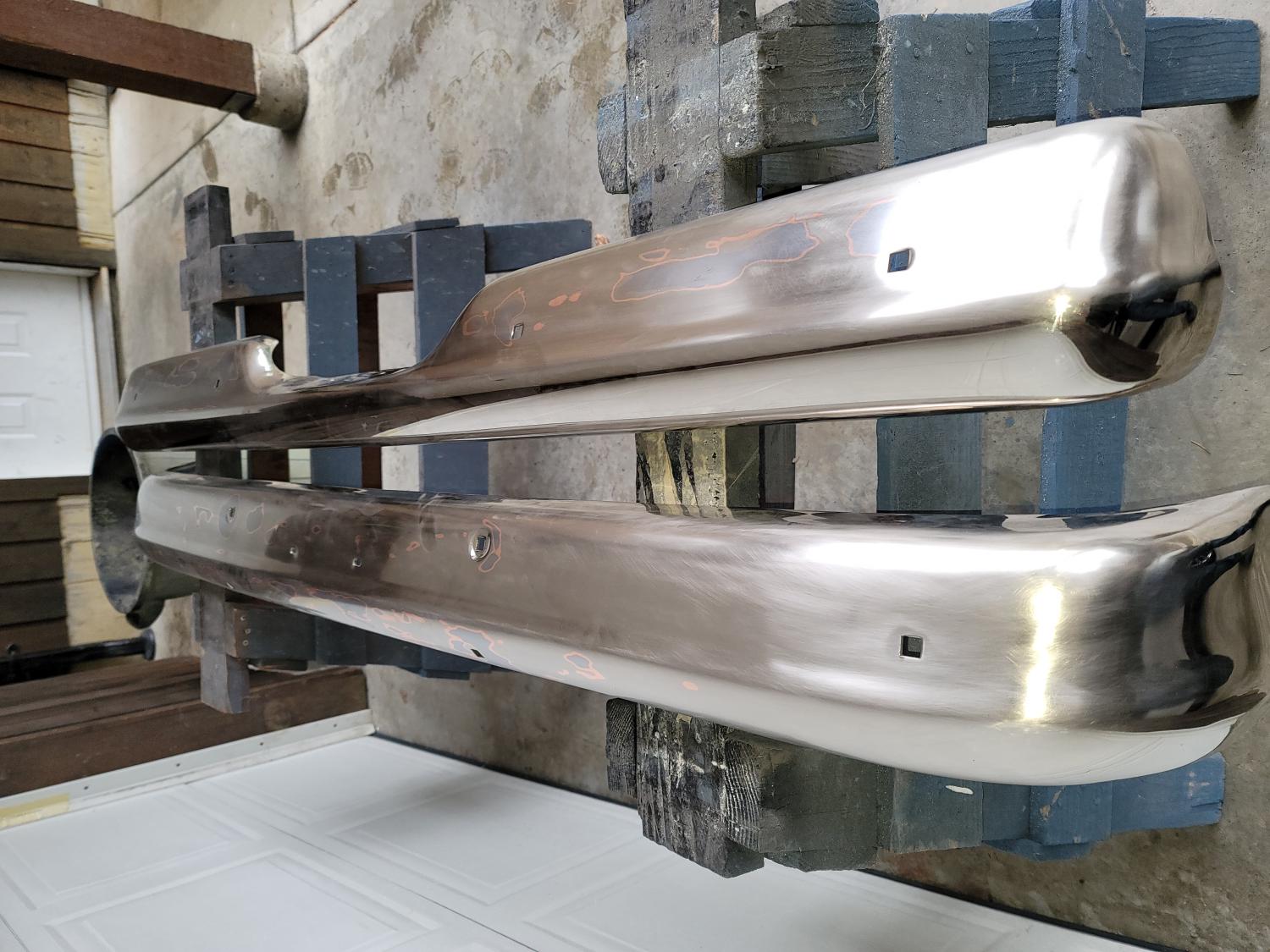

1 Attachment(s)
Have dealt with a Chrome shop for years. Had them rechromed my bumpers. Installed them but just couldn't live with the waves. Talked with the shop and decided a course of action. I took back and while I waited they removed the chrome. I then took them home and spent a week blocking the nickel and copper. 80 grit up to 400. Much straighter. Their now back with the shop to get copper, nickel and then chromed
