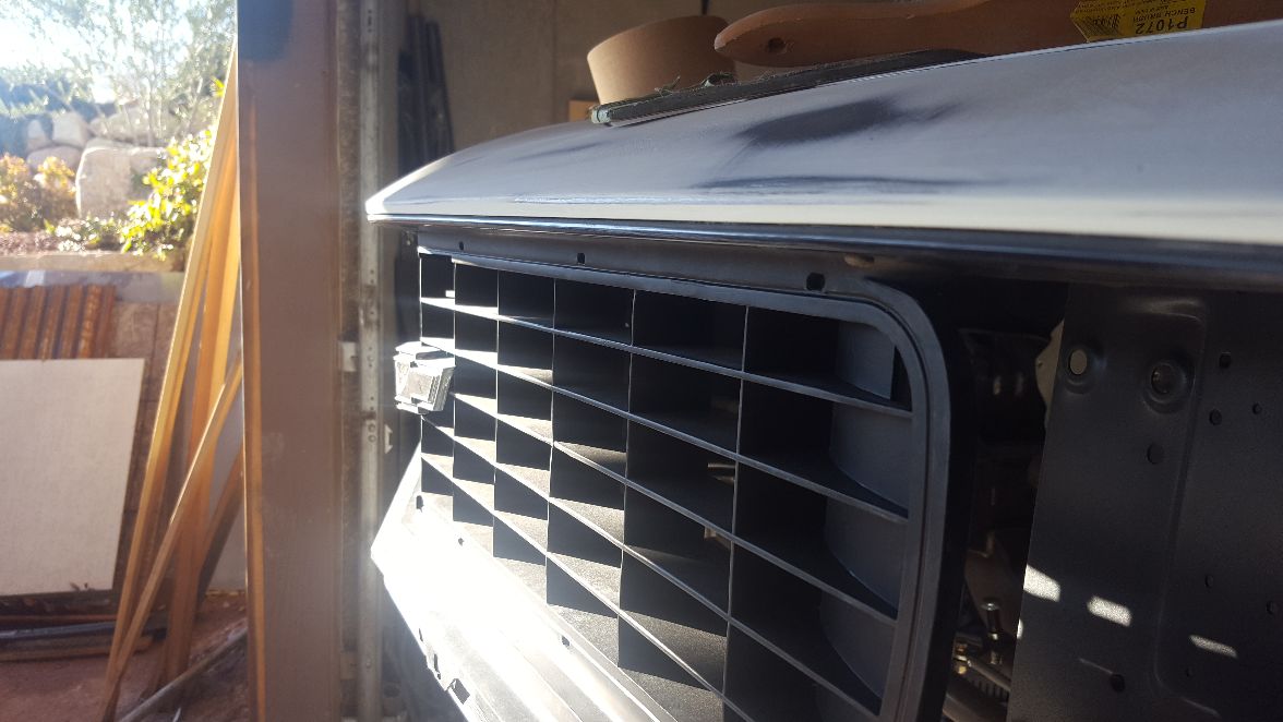

5 Attachment(s)

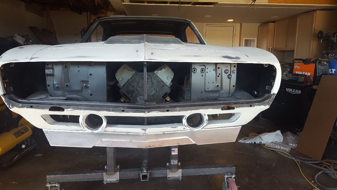

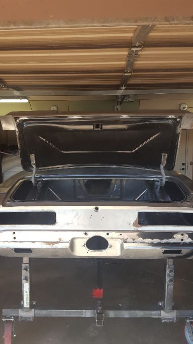

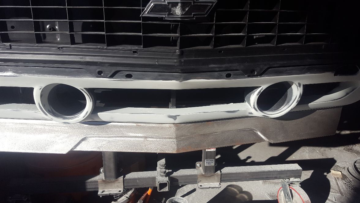

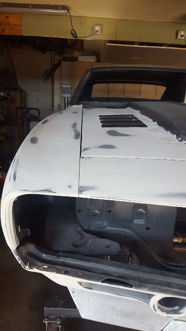

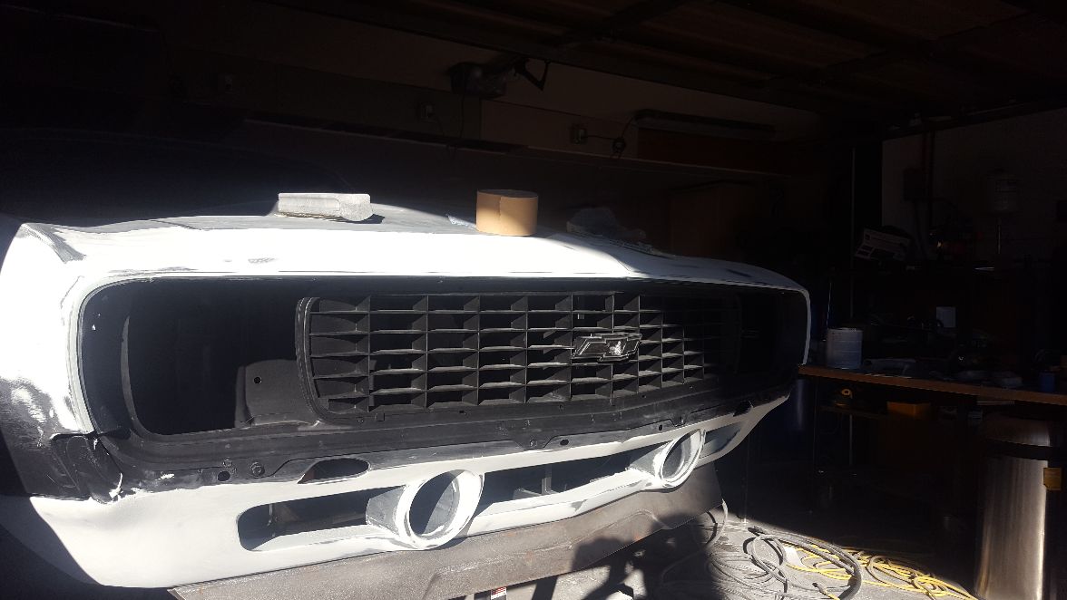

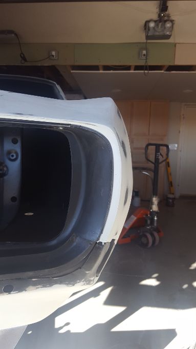

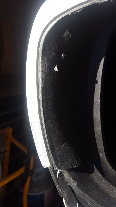

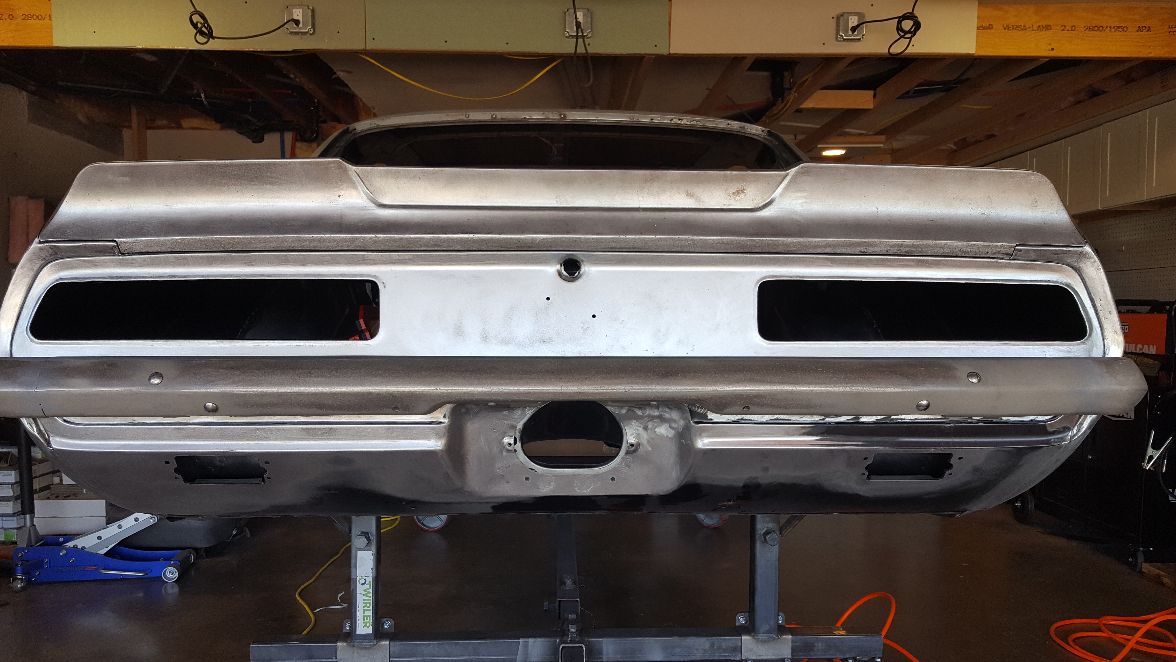

Friend from Cali came back for a few days. Spent the entire time getting the front end dialed in and the making the RS grille fit correctly. Not an easy task.

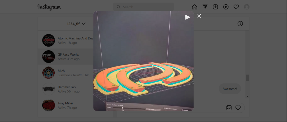

4 Attachment(s)

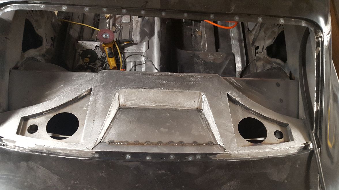

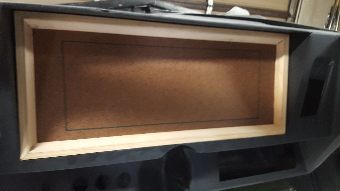

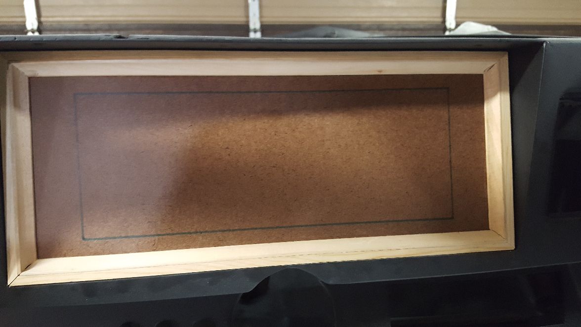

Not really feeling the flat panel I had made for my Holley 12.3 Pro Dash. I am making a mock up piece to send to Atomic Machine. Going to give it a little more character and some depth to it. TJ will be able to work some CNC magic on my crude mock up.

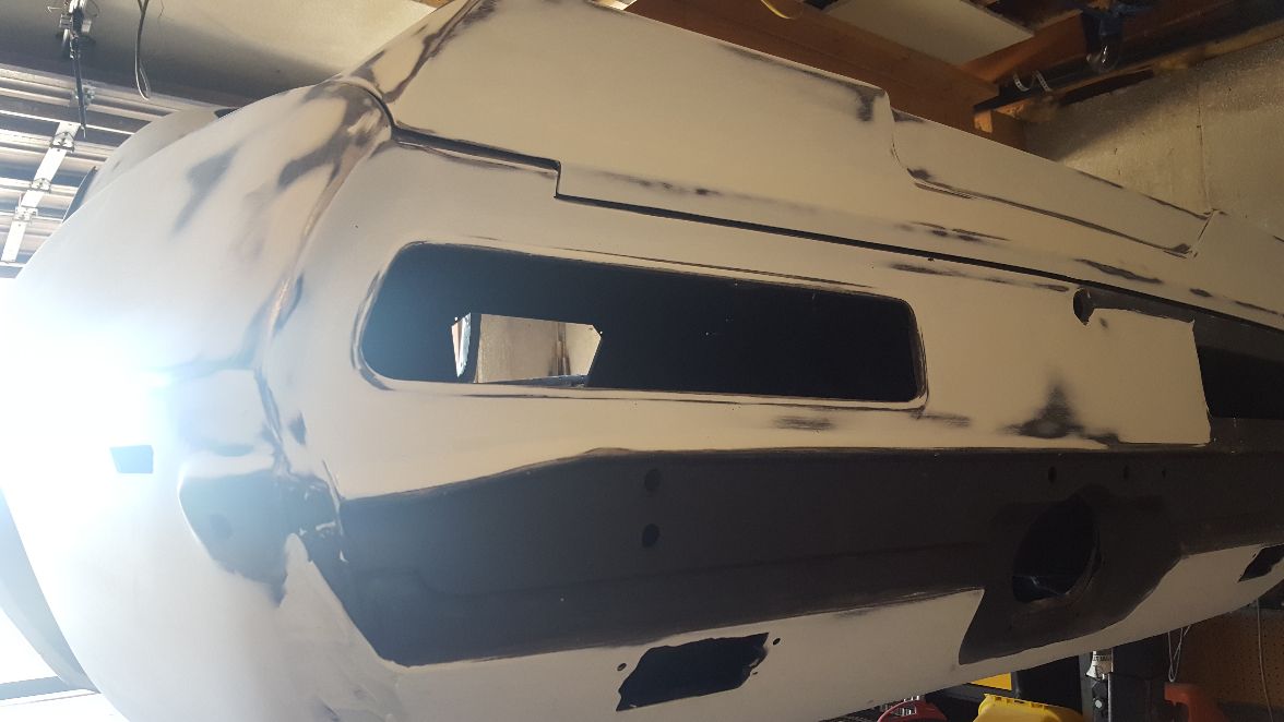

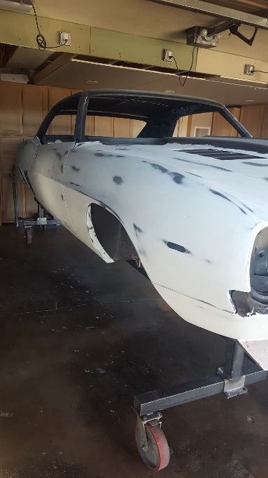

garickman 01-07-2022 01:28 PM

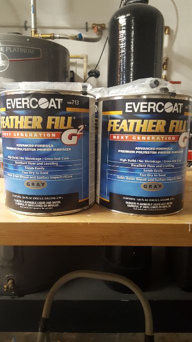

6 Attachment(s)

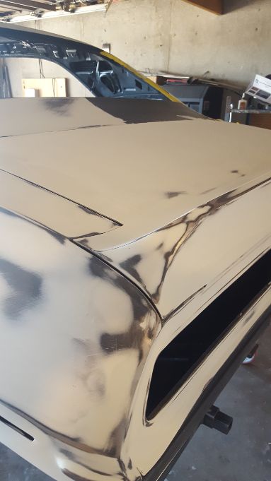

Ordered some high build polyester primer. This means we are getting close to the next phase of body work.

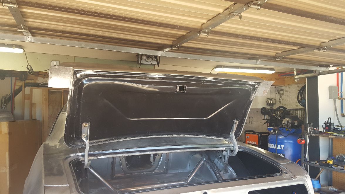

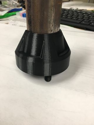

I forgot to mention this before, but I am using the fiberglass deck lid cover which I purchased from BBT Fabrications. It is a decorative cover for the underside of the trunk lid. It is a very nice piece and with a little bit of trimming it fit perfect. Rather than using exposed fasteners to hold this piece on, I will be using velcro at the top and the trunk hinges will secure it at the bottom. The fiberglass cover is just over 1/8" thick which posed a problem because it raised the deck lid up that amount in the rear when it is closed. We removed the stock trunk hinges and cut 1/8" from the center so the deck lid would close like stock again. With the additional weight of the cover, body filler, and the steel fabricated spoiler, we modified the stock hinges further to accept a set of gas struts which were purchased from the Ring Brothers. This made it very smooth to open the trunk and keep it open with the additional weight. I am also using a polished stainless steel trunk striker from Mad Mooks.
Attachment 77072
Attachment 77073
Attachment 77074
Attachment 77075
Here is a link to the trunk striker.
https://madmooks.com/67-69-camaro-trunkstriker

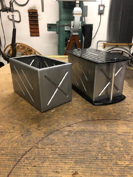

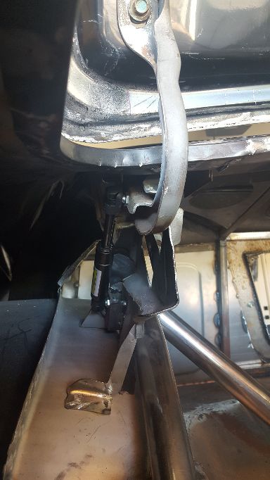

Originally I was going to relocate my battery to the trunk. Since I did the rear seat delete and moved the battery to that location, I decided to use the trunk space where the battery would have been for some additional storage. I bought a pair of Eddie Motorsports battery hold downs and had Josh from True Metal Shaping in Cedar City Utah make me a couple of 14 gauge boxes. He made them the same size as a battery so they stay locked down. I will use wing nuts to make the tops easy to remove and access the boxes.

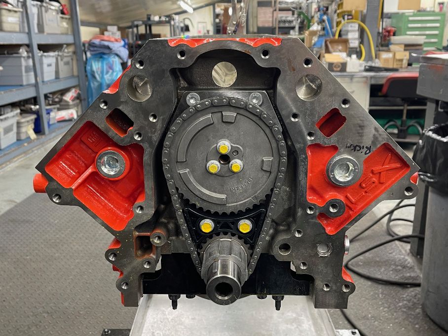

garickman 02-01-2022 12:42 PM
7 Attachment(s)

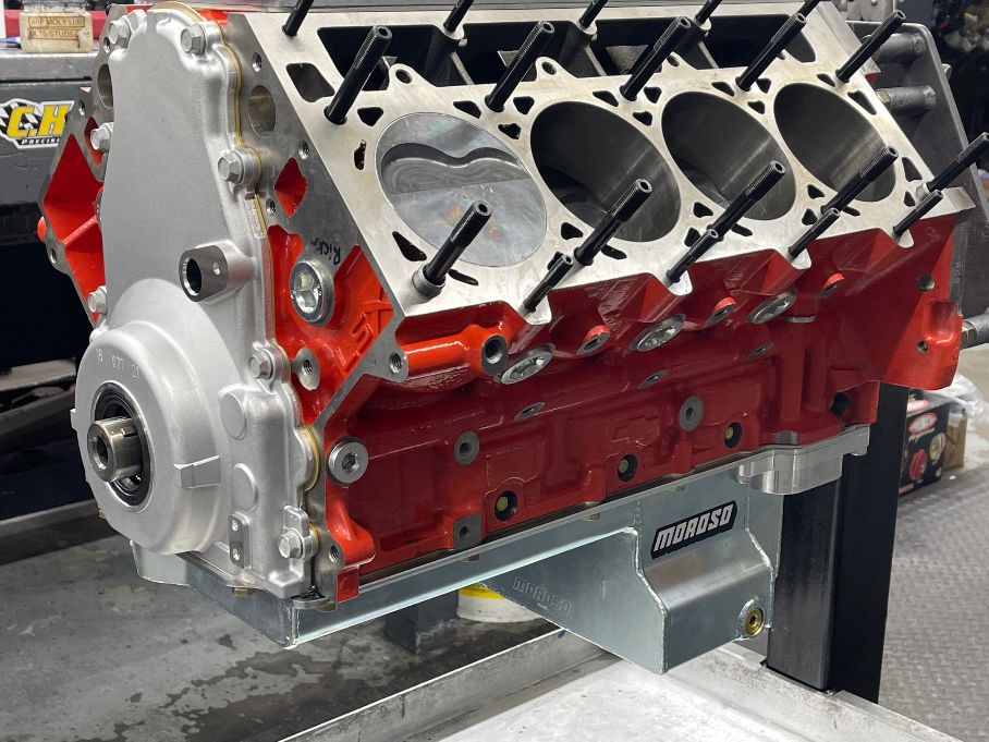

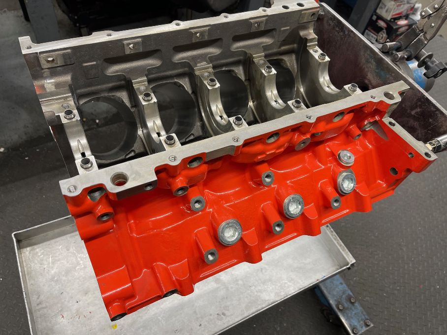

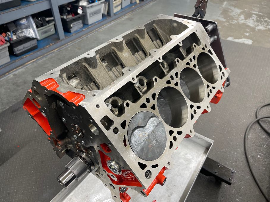

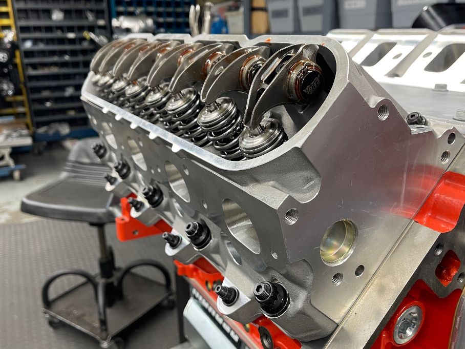

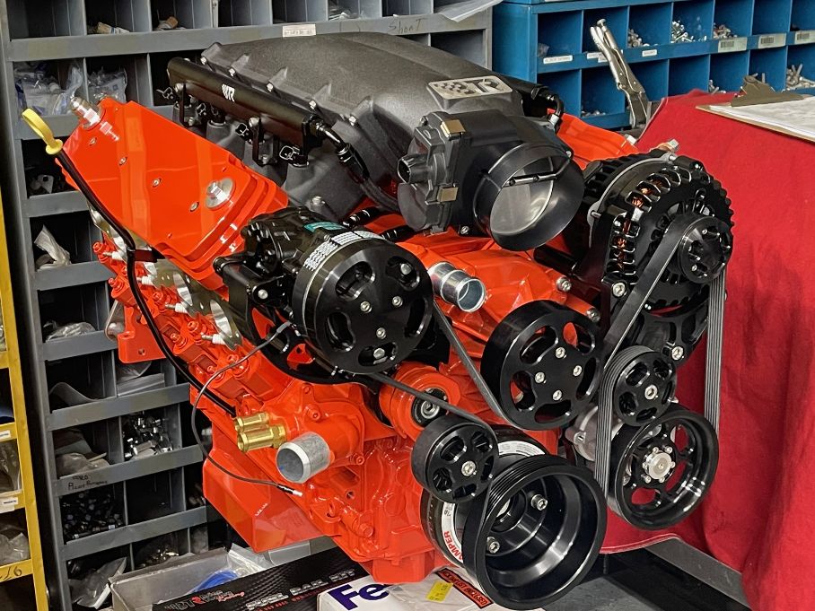

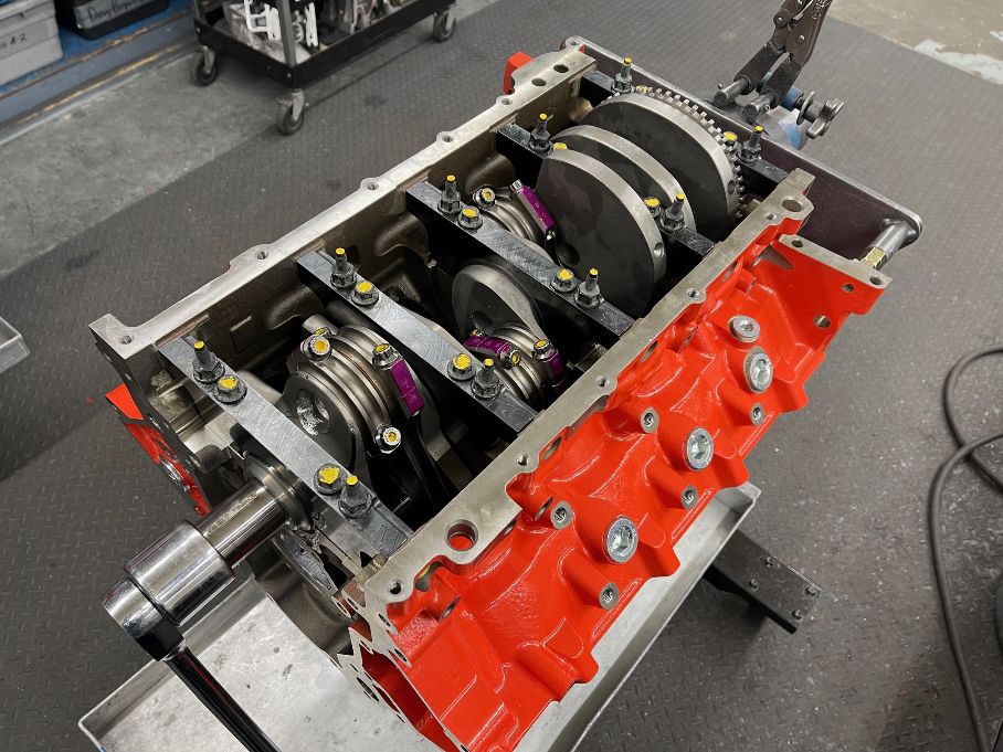

LSX 427 being built by Wegner Motorsports. It is currently at the Ring Brothers shop waiting to be painted Chevy orange. Then it will head back to Wegner to be dynoed. Should produce around 650HP. I let them know I was willing to sacrifice power for drivability, so it should be pretty street friendly.

Engine is done. Won't have dyno numbers until tomorrow.

Tinker 02-14-2022 09:28 AM
OMG I love the times we live in now. 100 hp more than a nascar cup car is a nice street motor!
Engine looks fantastic!

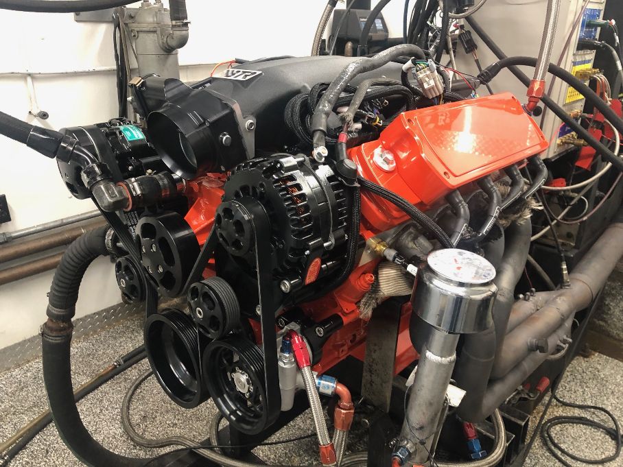

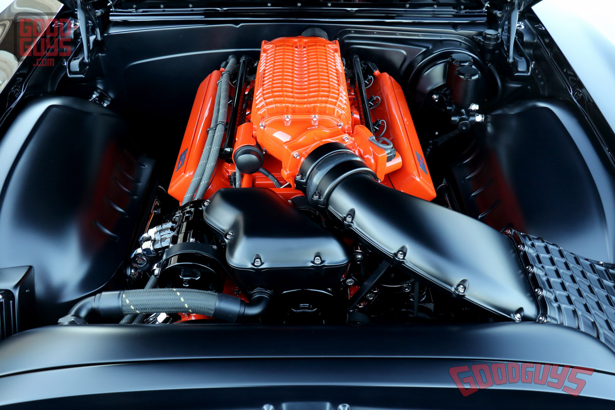

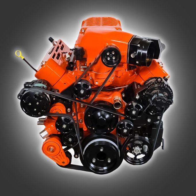

Quick question. Below are two pictures from LS engines that have the intake painted orange as well. These just both happen to be supercharged while mine is N/A.
Should I:
Leave the intake the way it came with the black wrinkled finish?
Smooth the plenum and runners and paint them gloss black?
Smooth the plenum and runners and paint them orange?
If it matters, my engine bay will be satin black like the 2nd pic of the DSE Tux Camaro.
Attachment 77347
Attachment 77348
Mikael A 02-14-2022 03:31 PM
Looks great,I would leave it alone but that’s my opinion.
I’m not making that decision on mine until its all together so i can see the differences in contrast and colors in the whole engine bay.
garickman 02-14-2022 03:38 PM
Good point.
camcojb 02-15-2022 02:19 PM
The only thing I'd consider is a black anodized thermostat housing and either stainless or black heater hose fittings.. I like the intake the way it is.

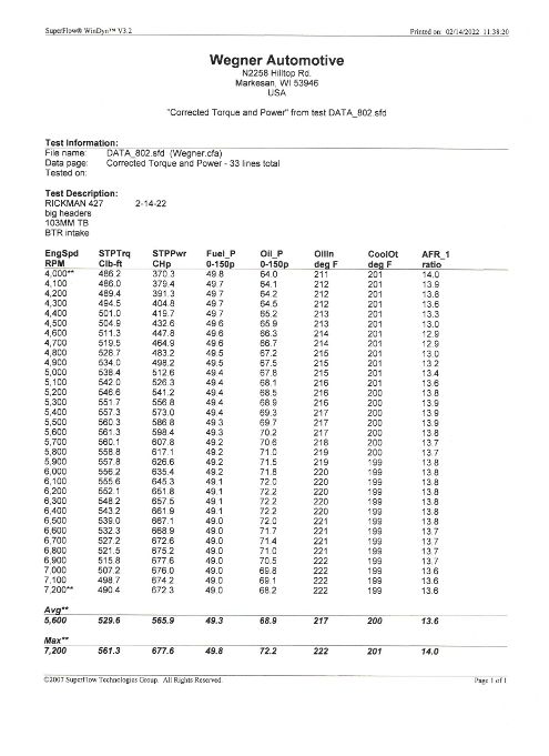

garickman 02-15-2022 02:37 PM
2 Attachment(s)
Dyno numbers are in. 677 max HP and 561 max torque.
Attachment 77387
Attachment 77388
Nice!!
Sheck44 02-16-2022 09:45 AM
Greg ... PERFECT, you hit that 'magic' power # for the street buddy !

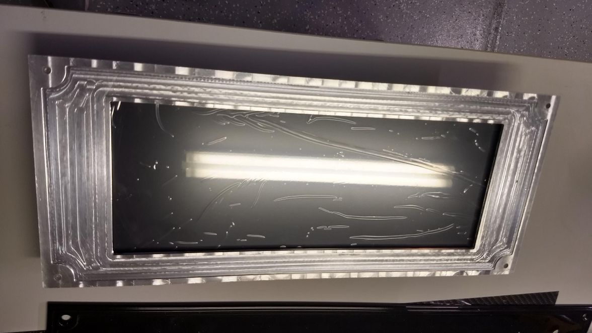

garickman 02-19-2022 11:45 AM
8 Attachment(s)

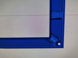

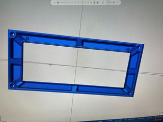

TJ from Atomic Machine sent be back some CAD drawings for the new Holley Pro Dash bezel. This bezel has a little more depth and much more character than the first one. TJ included some subtle notches which will match the other notches on the car like the front spoiler, rear spoiler, package tray, deck lid cover, roll bar covers and the BBT Fab rear view mirror.

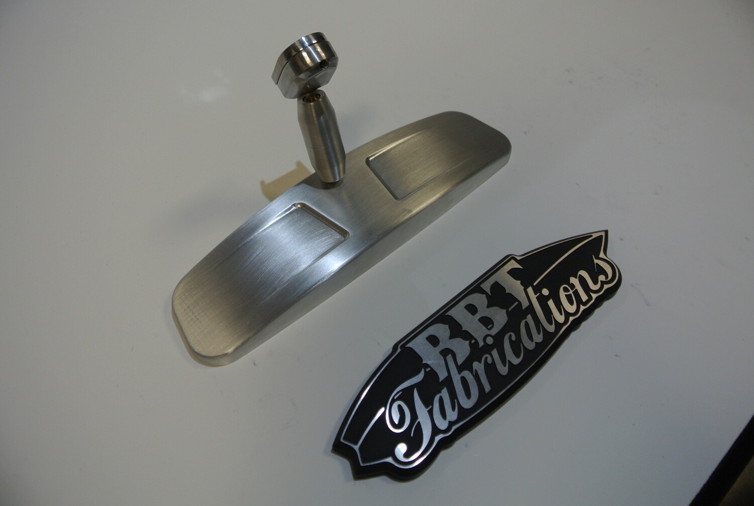

Greg, I'm digging that rear view deck. It's sick!! I have BBT’s rear view mirror too. Very nice piece…

572Camaro 02-19-2022 04:19 PM
Your car is awesome.
Please don’t paint your intake.
I like it the way it is.
Nice contrast.., doesn’t look so “dipped” in one color.
garickman 02-19-2022 04:31 PM
That seems to be the consensus on the intake, so I think I will leave it.

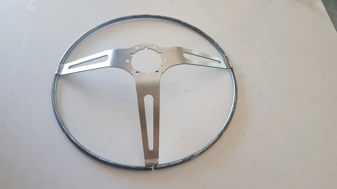

garickman 03-07-2022 07:47 PM
7 Attachment(s)

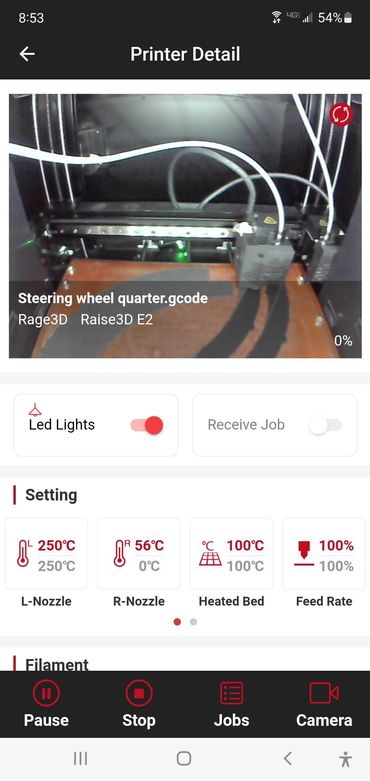

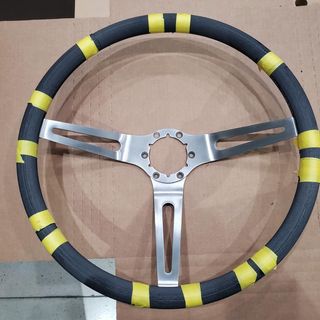

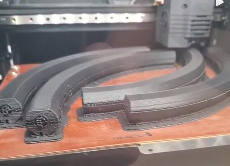

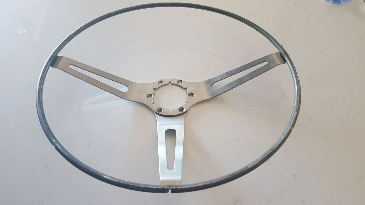

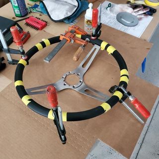

While the body work continues, I am working on knocking some other items off of my to do list. In continuing with my pro-classic theme, I wanted to keep the original 3 spoke steering wheel. I know I have said this before, but I still want it to feel like I am driving a 69 Camaro. The grip on the original NK1 steering wheel was just a little to skinny for my liking. I peeled the original grip off and sent the steering wheel to Greg from GP Raceworks. He 3D printed me a slightly larger grip which had to be printed in 4 pieces and then epoxied back together around the steering wheel. This grip will now be wrapped in leather. The steering wheel and original horn button will be finished in a black cerakote.

ScotI 03-08-2022 05:23 AM
Very cool. I like that 'original' vibe tweaked to how you want it. It has the 'nothing to see here folks' yet is actually custom. Cool to know/have people involved in your project that can help w/things that you want to tweak.
