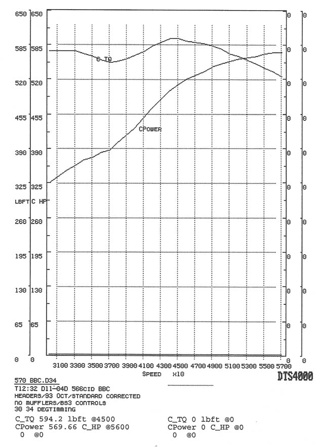

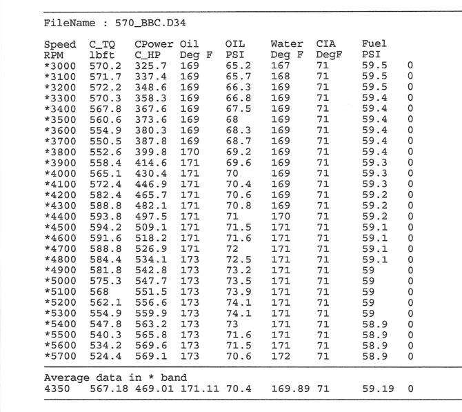

It is a very mild engine for being a 565" I think the hp was 575. I thought I had the dyno sheet on my computer but windows Vista has managed to make doing anything a pain in the ass. I emailed Kurt at W2W for the info. It has been over a year since it was done.

Tq was 594@4500 and hp was 569@5600. Nice torque engine. I will email Scott the dyno scans to post.

Dyno print outs:
https://lateral-g.net/temp/RW565dyno1.jpg
https://lateral-g.net/temp/RW565dyno2.jpg

was the motor tuned for drive ability or just a number?

How does this compare to the old motor...power wise?

I'm sure they made it driveable and able to live on marginal gas. If they would have built it to make a number it would have made a lot more peak power.
It does have nice torque doesn't it? Over 570 lb/ft all the way to 5000 RPM.

I'm not sure how it compares to the old engine. When I bought the car off Ebay the seller was saying the 532" was making 630 hp. Mark never had any real #'s for it. I would assume with the bigger crank it will make more than before so I have to assume it didn't make 630 hp before. I know I ran 12:15@122 starting out in second gear. I'm just a sucker for torque. This car never cares what gear you are in, it just pulls. I can't wait to have my old friend back.

i am not so sure.. i guess we will see how much tuning it needs. it does look awesome.!!!

It's a 9-1 compression engine so as before, it could probably run on beer without pinging.

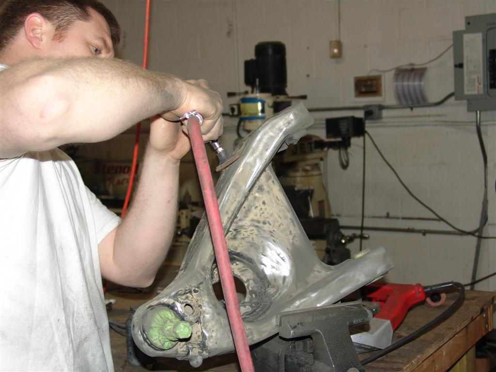

Attachment 7002
Prepping for Paint....

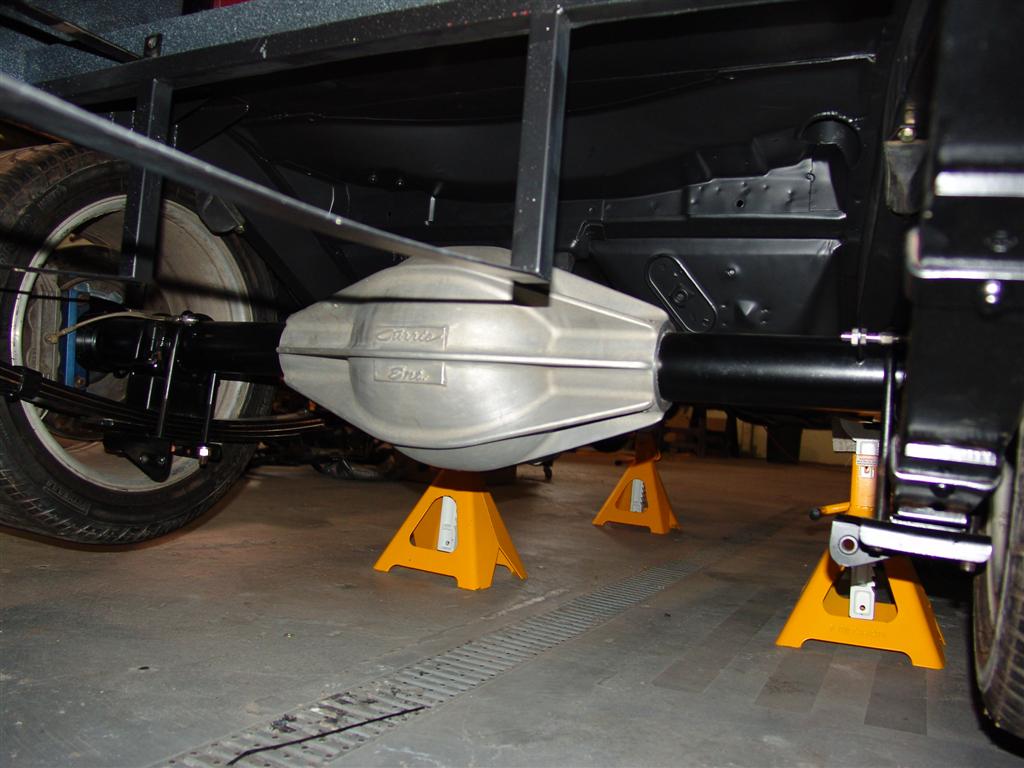

Attachment 7003
Under the car... Jory's painting turned out sweet!

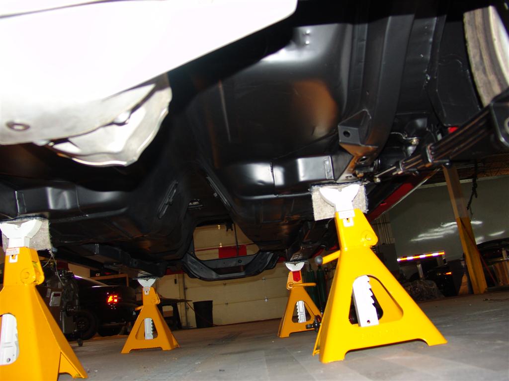

Attachment 7004
Ready to add some brake lines :D

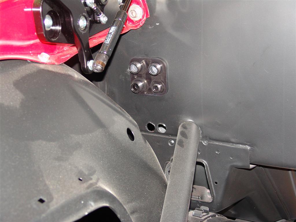

Attachment 7005
A/C pass through. Hard annodized black

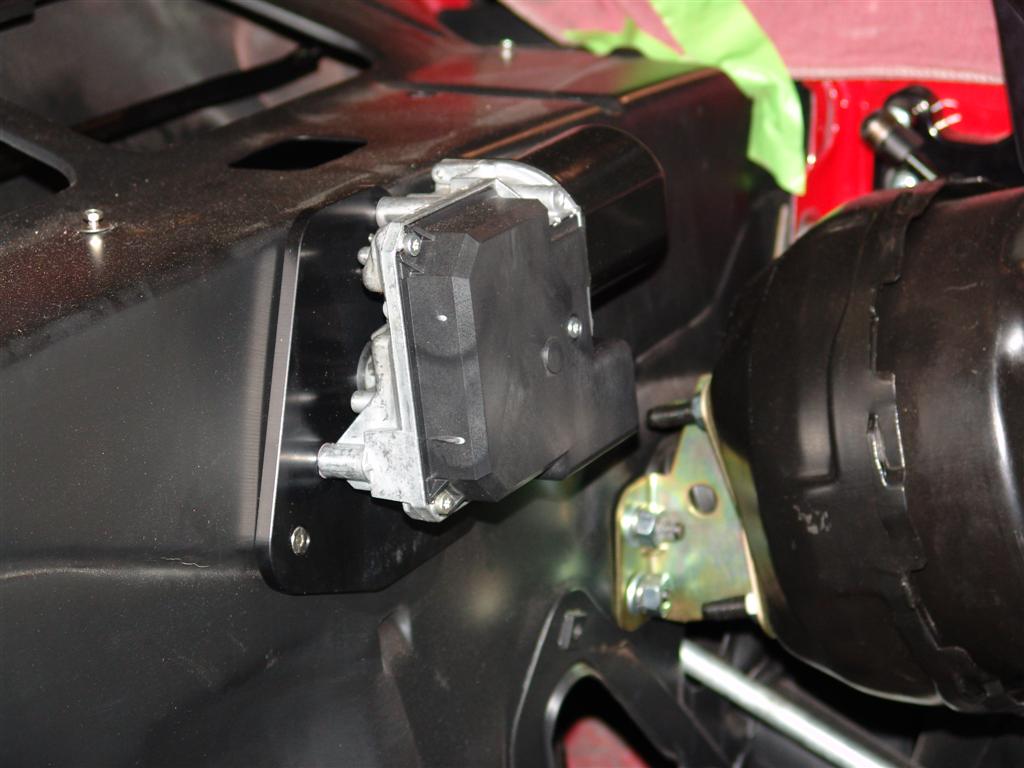

Attachment 7006
new DSE Wiper motor... oh so hot!
