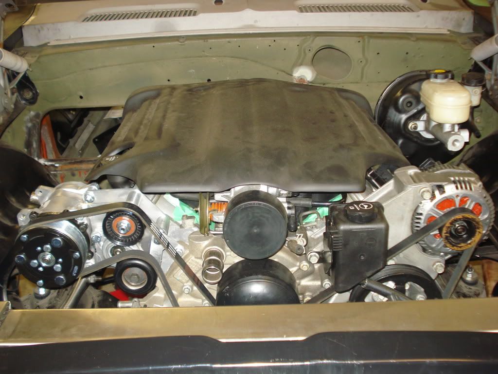

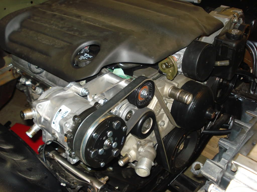

Well after around 8 hours and a few beers with a buddy the drivetrain is in place with a stock F body oil pan with no mods to it.Fits like a glove.....man Im tired but a huge step forward.Enjoy the pics.

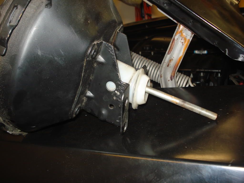

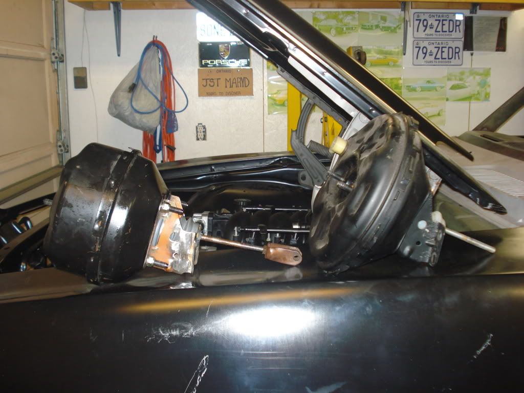

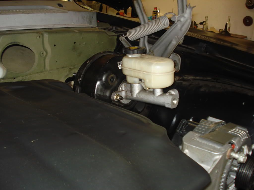

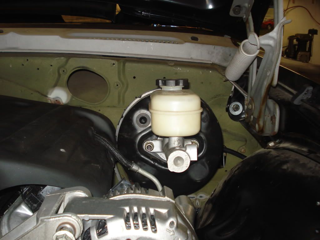

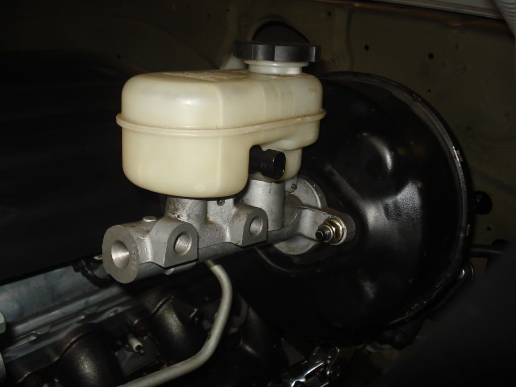

Well I have some more progress to show you guys.After dropping in my LS1 I ran into a few fitment issues.One in particular was my factory vacuum booster wasn't allowing one of my coils to bolt down.So I had a 2001 C5 booster and master that I wanted to use.So after talking to a few of our members here I went for it.Basically what I did was tranfer over the factory booster bracket and modify it to bolt onto the C5 booster so everything could bolt in smoothly together.Hopefully the pics are self explanitory but please shoot me some questions I"d be pleased to answer them.The whole process took me about 6hrs and it fits perfect.
Steve

Rybar 08-26-2010 10:54 AM
Real nice job, the vette booster looks great. :thumbsup:

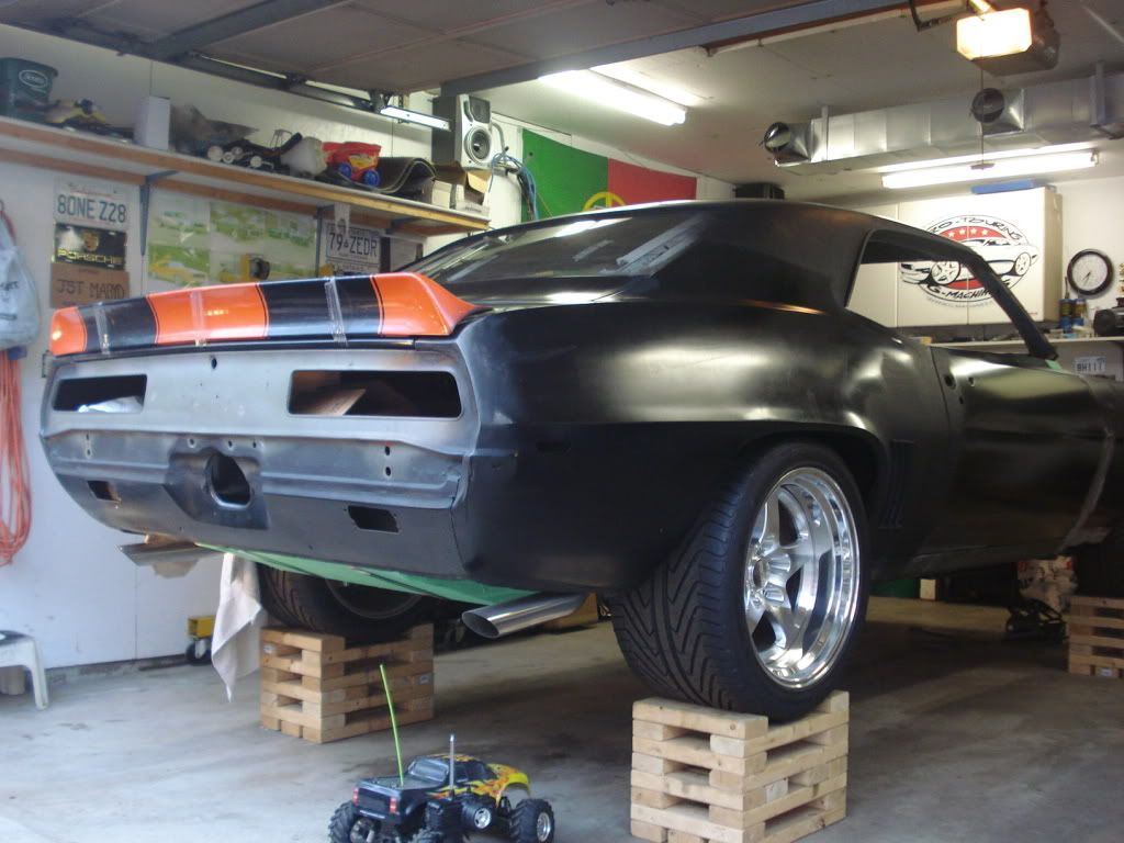

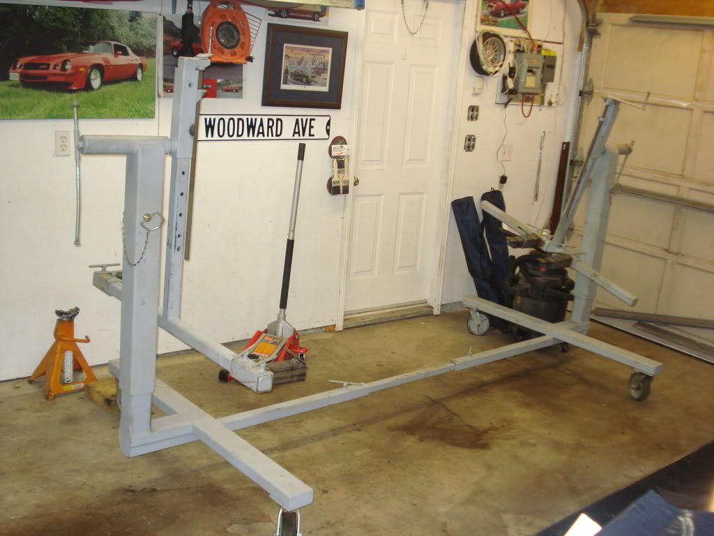

aany001 11-02-2010 06:06 PM
Not much progress but a new phase is coming up.........this will speed things up when doing the undercarraige!!!!!:thumbsup:

scherp69 11-02-2010 07:59 PM
Looks awesome Steve. You're gonna love the rotisserie. You won't want to ever crawl under a car again after working on it that way. Keep the pics coming.

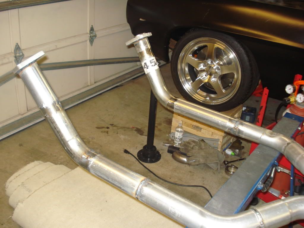

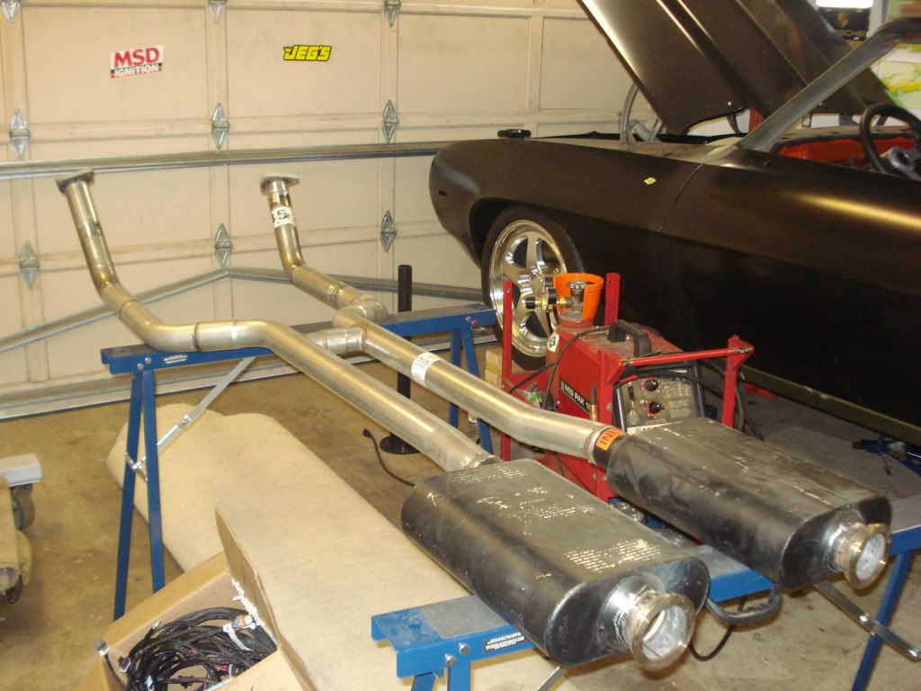

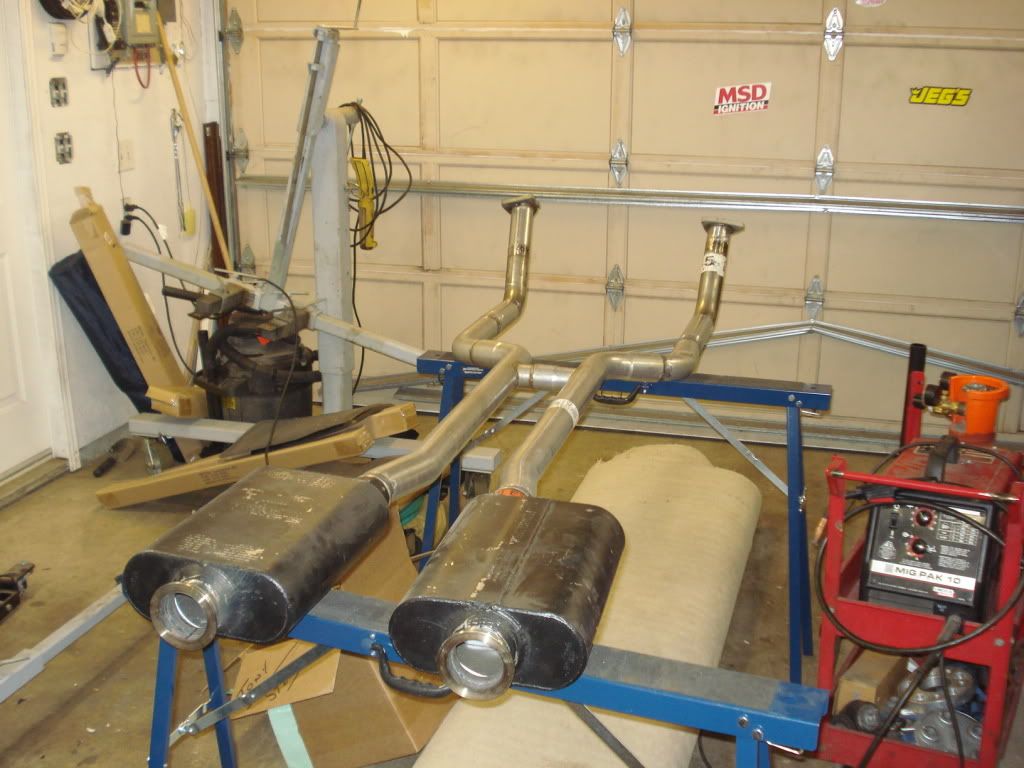

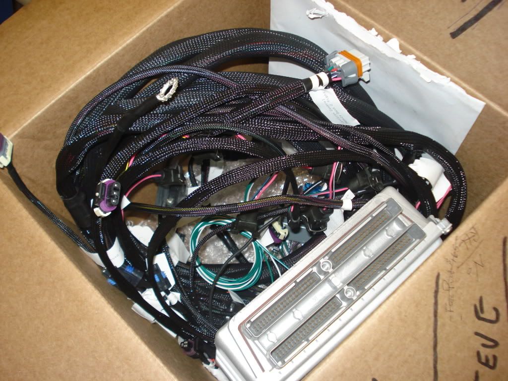

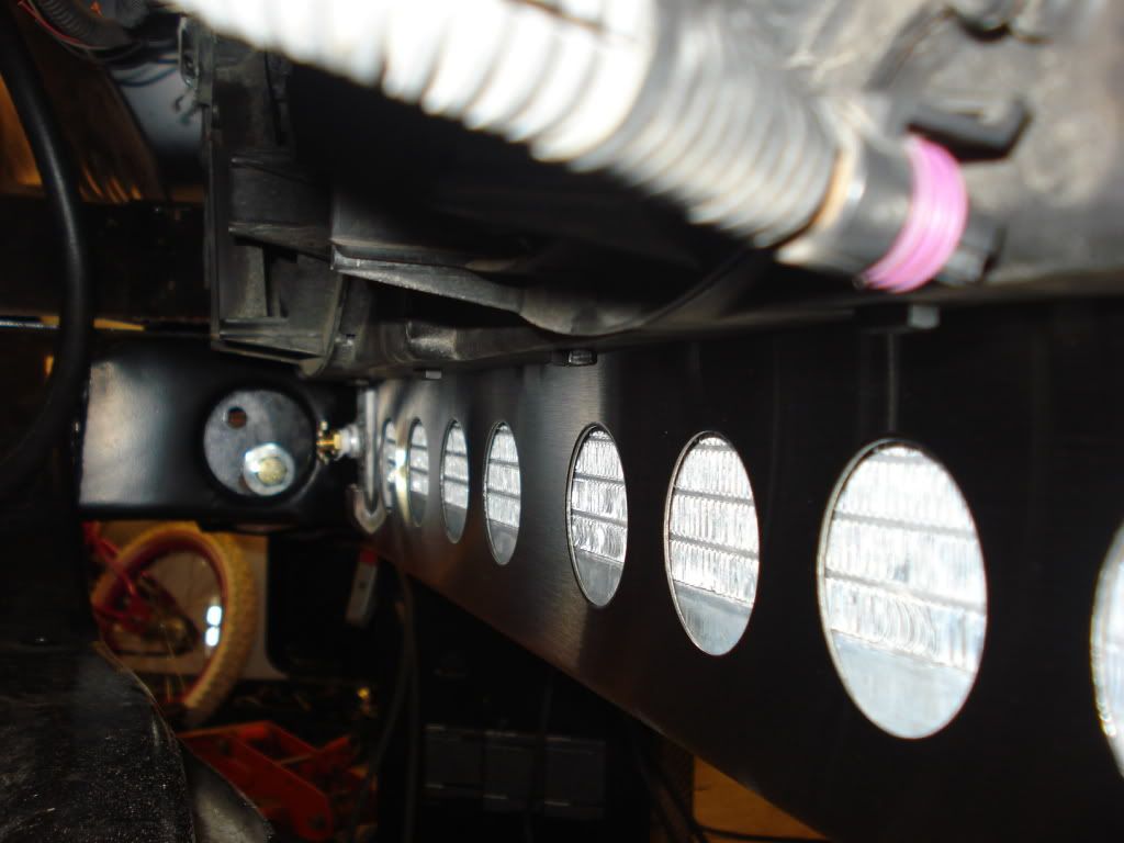

well I finally finished mocking up my exhaust for the second time!! Was going gen1 style engine with headers but things have changed to LS1 so some changes needed to be made to the down pipes.Headers are not in the budget so this will have to do.Quite a job to do on your back I tell ya:mad: .Anyways I got it done and also received my custom engine harness from Howell and I gotta say what a sweet harness.Well enjoy the pics.
http://i150.photobucket.com/albums/s...ny001/LS24.jpg
http://i150.photobucket.com/albums/s...ny001/LS23.jpg
http://i150.photobucket.com/albums/s108/aany001/LS2.jpg
In this pic the tail pipes are still not tightened up into place but will sit tight to the tail panel.
http://i150.photobucket.com/albums/s...001/stuff2.jpg
http://i150.photobucket.com/albums/s...ny001/LS22.jpg

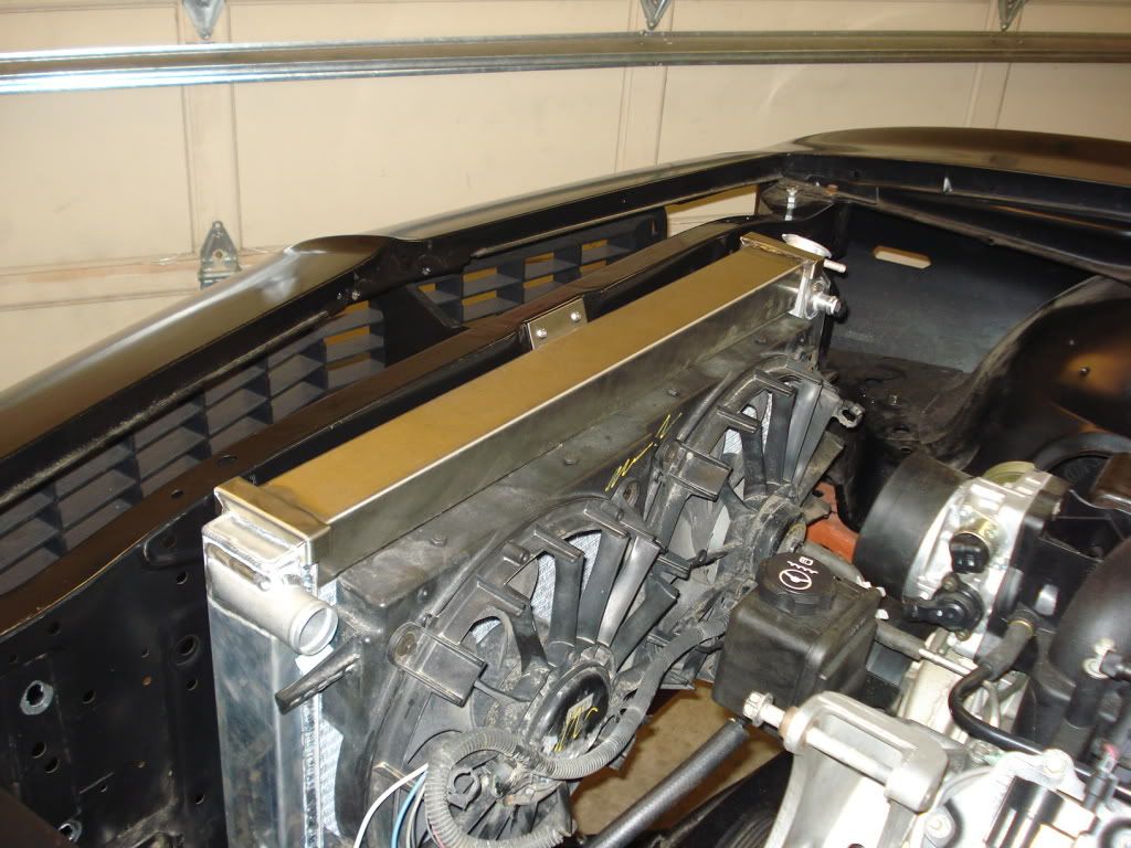

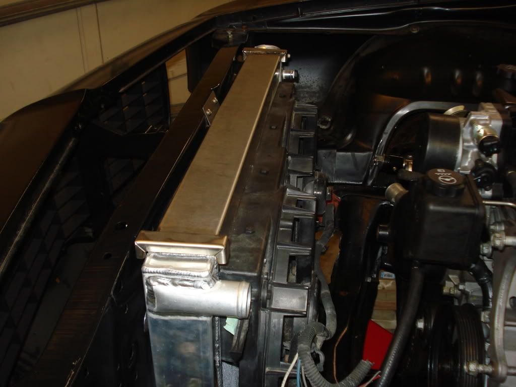

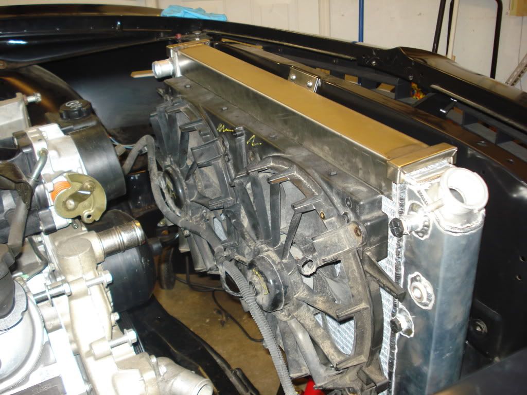

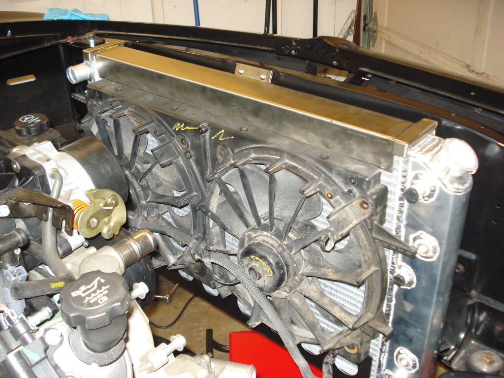

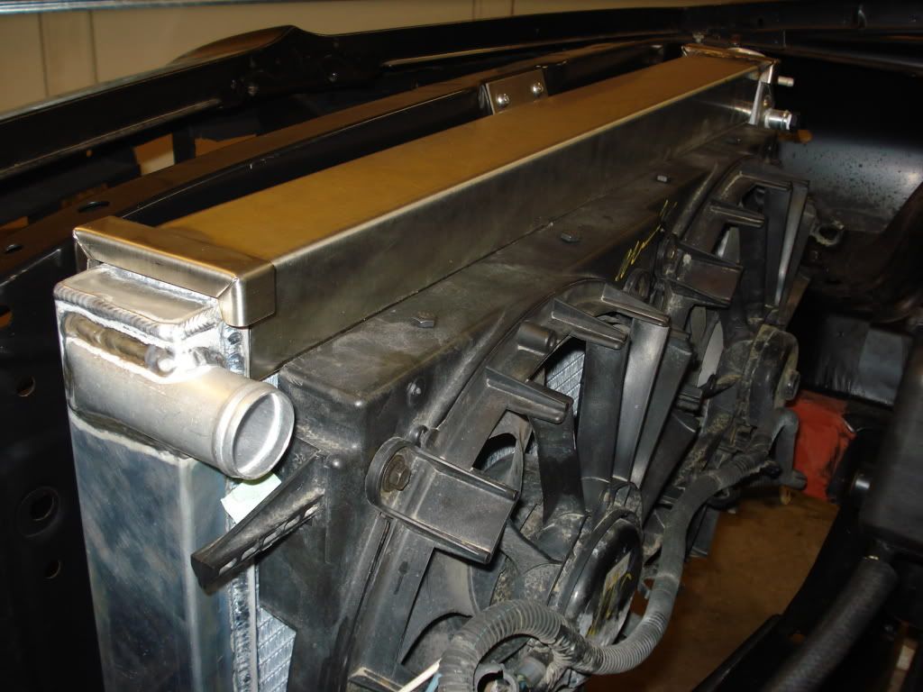

made some progress on my rad/fans and accesories
http://i150.photobucket.com/albums/s...1pics009-2.jpg
http://i150.photobucket.com/albums/s...1pics008-1.jpg
http://i150.photobucket.com/albums/s...1pics007-2.jpg
http://i150.photobucket.com/albums/s...1pics010-2.jpg
http://i150.photobucket.com/albums/s...1pics014-1.jpg
http://i150.photobucket.com/albums/s...1pics013-1.jpg
http://i150.photobucket.com/albums/s...1pics012-1.jpg
http://i150.photobucket.com/albums/s...1pics010-1.jpg

It looks sweet in there. I love those wheels.

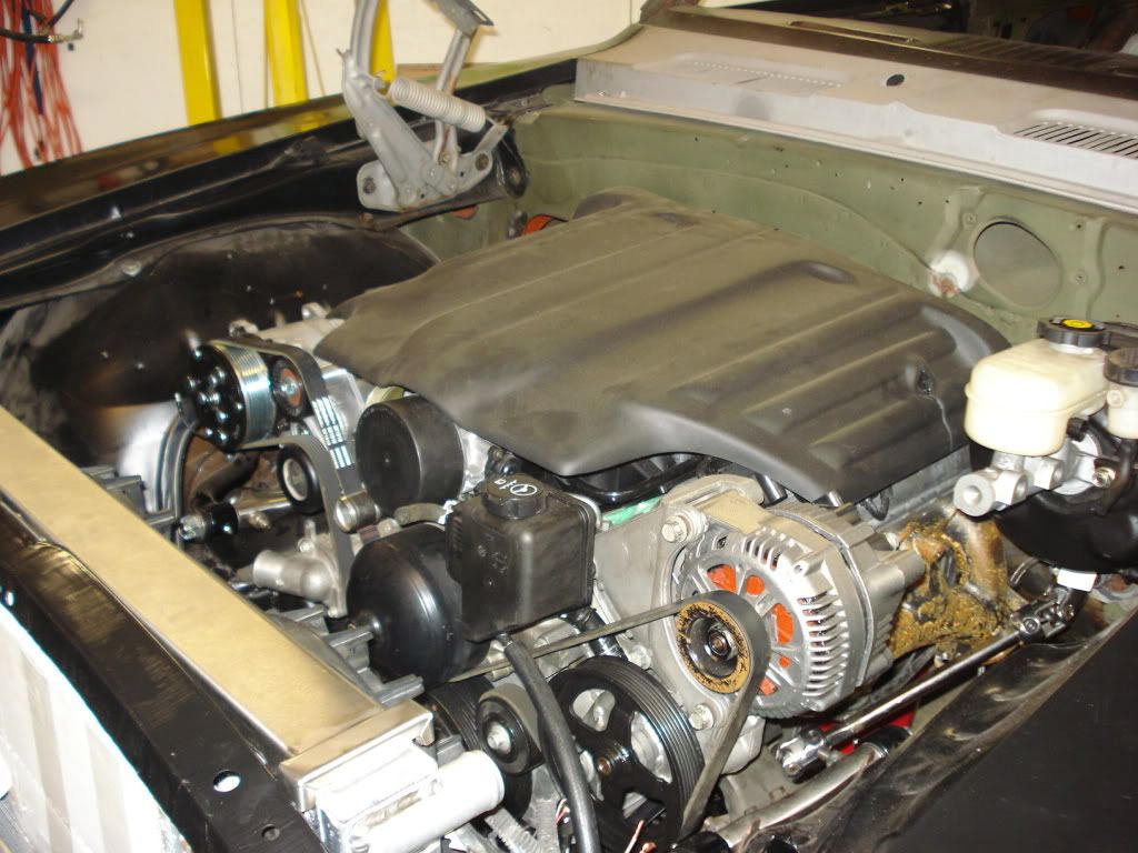

aany001 06-11-2011 04:40 PM
Not much visual progress but alot of unseen progress.Man Im pumped!
