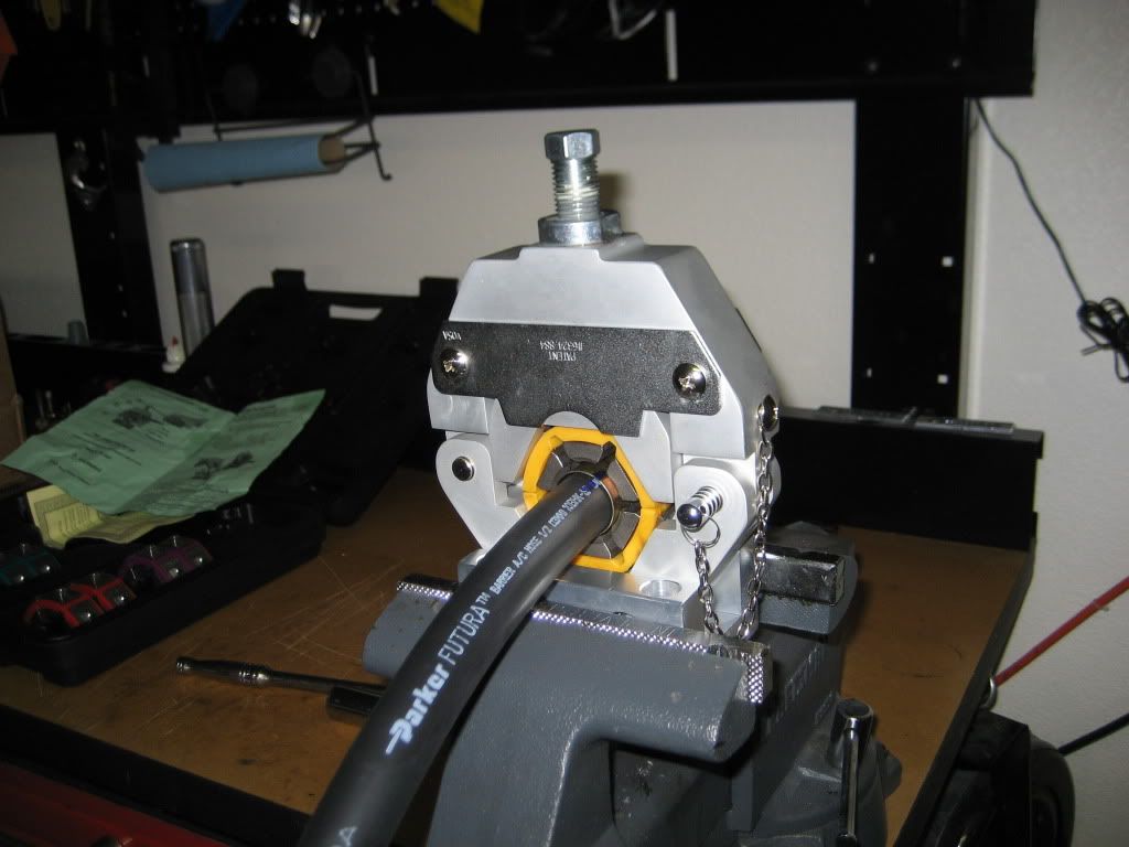

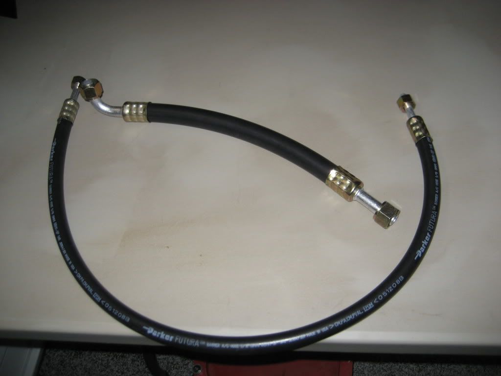

Nothing to exciting. I'm just getting as ready as possible for my new engine. I managed to order 2 fittings the wrong size from vintage air or I'd have the unit in the dash and done...:rolleyes: I did start crimping some lines. I've been spending some time at the nursing home trying to keep this old guys spirit up. He just happened to have a crimper he borrowed me. Thanks Greg! :D

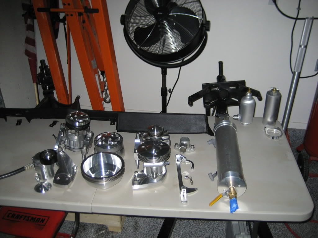

I cleaned all my accessories and they are ready to go back on. I also brushed my puke tank and coolant resorvoir. I sealed them with metal sealer. They are supposed to sit a day or two before wiping it off. I'll be running 2 puke tanks so I'll have to go through the whole process on the new one to match it. I had them both polished up and looking pretty. Wasn't feeling it.

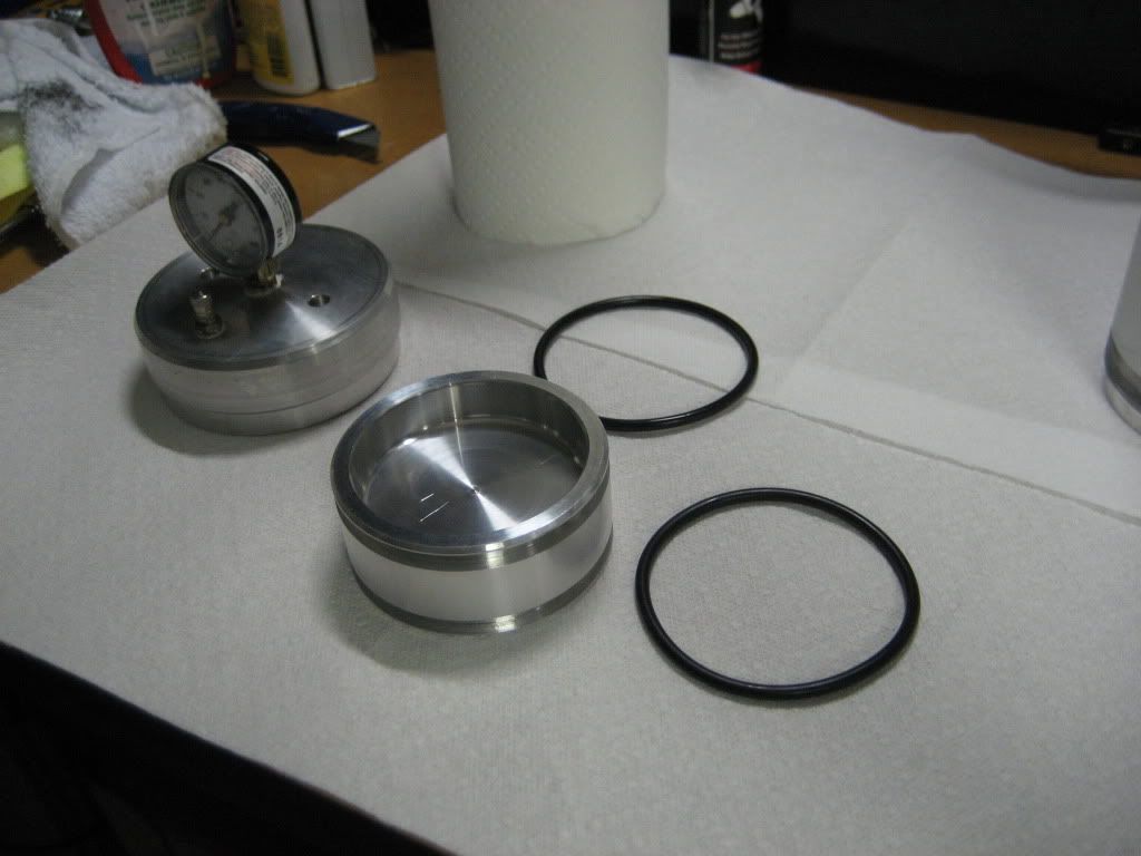

I pulled apart my accumulator to clean out all the old oil and possible debris even though it's after the oil filter. What a bitch getting that thing apart. I got all the oil out of it with some brake cleaner and then headed for the kitchen to was everything with soap and hot water. I got caught in the act and she didn't say a word. :thumbsup: Anytime I deal with internals, I like to use paper towels. It's clean as a whistle and back together. I thought some of you might be interested in the inner working of an accumulator. Super simple piece that most engine builders swear by.

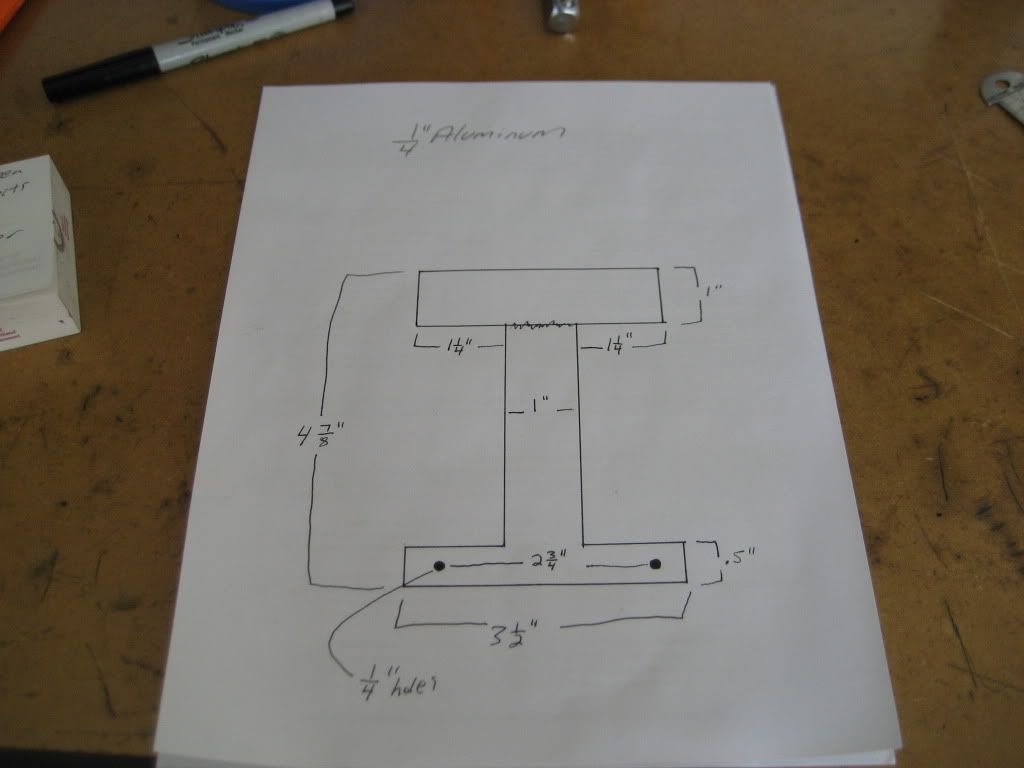

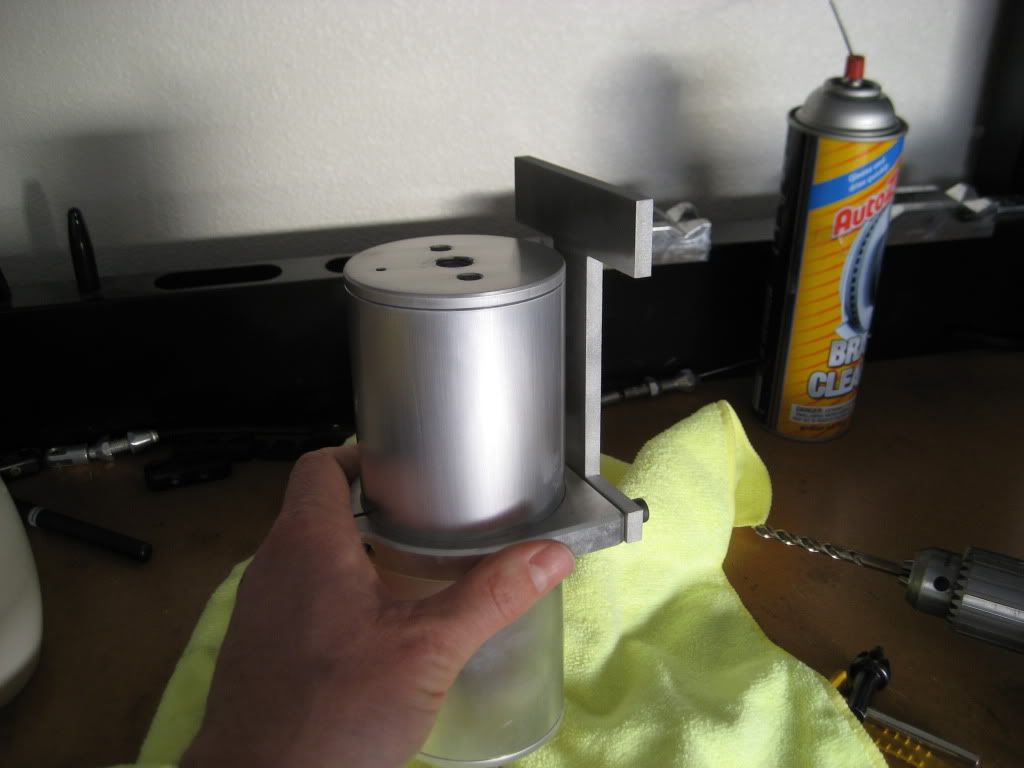

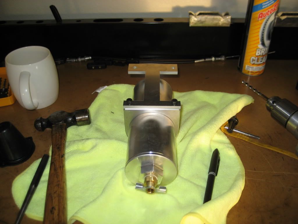

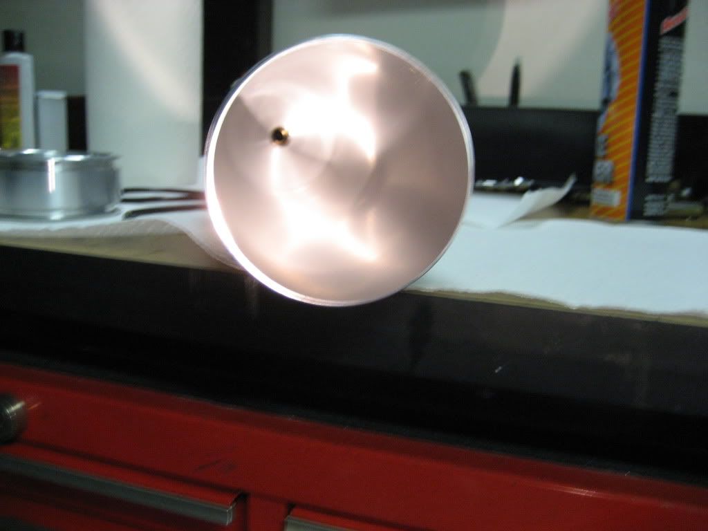

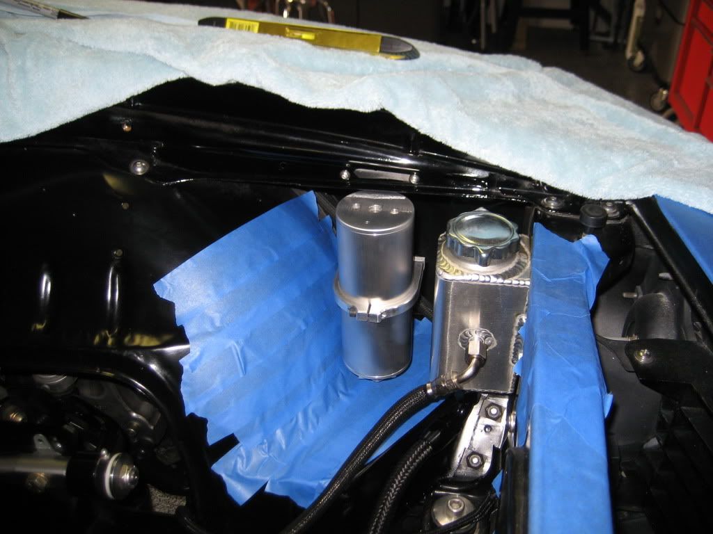

Now that I'm running dual crankcase puke cans, I had to find a clean place to mount the coolant recirculating tank. I want to keep the crankcase vent fittings, hoses, and tanks in harmony. So I decided to draw me up another sketch and send it over to my trust water jet guy.I designed it so it would all but disapear. I also brushed this tank and sealed it. I'll be using -6 fittings and hoses. The bracket will get the krylon touch in semi gloss to blend in with the inner fender.

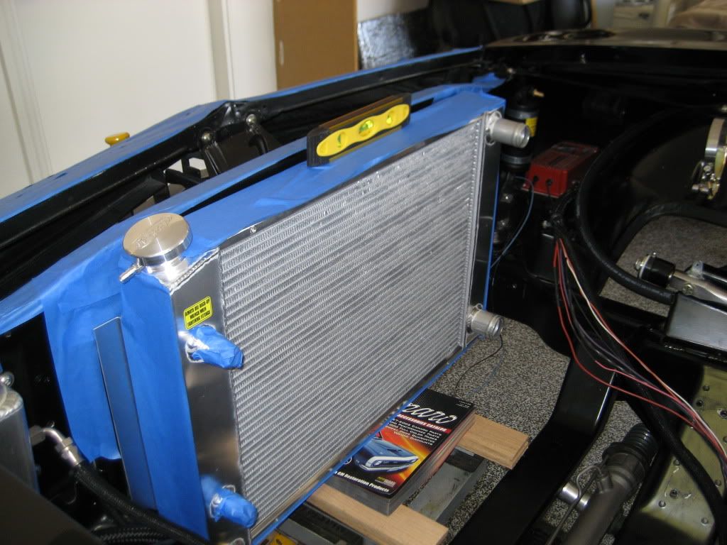

I also began mocking up the new radiator. I want to use the same holes as with the old radiator. I asked for the mounting tabs to be blank. I decided to wait until the engine is back in to locate my holes. They don't call it a big block for nothing. It's tight between all my accessories and the cooling fans. I'll wait so I can jockey it around and make sure I have proper clearance. It's going to look great in there.

Todd I like the lower mount for you radiator. can you even still use that book with all the stuff you have to the car:lol: :lol:
Vegas69 02-16-2010 09:02 PM
Not much!

I really like the recovery tank Todd!! How did you brushed it? I need to do same for my billet specialties polished one.
Vegas69 02-17-2010 06:42 AM
I polished it, then used red scotch brite with even strokes multiple times. Then sealed it.
