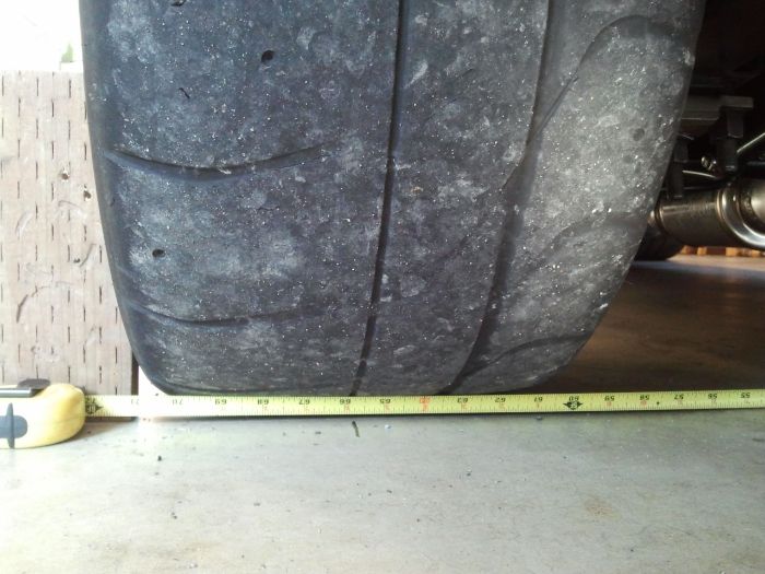

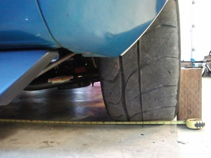

Dale that's interesting. So your outside to outside total tire width is about 71" front and rear?
DaleTx 07-06-2013 07:24 PM
Originally Posted by FETorino (Post 491716)
Thanks a bunch. I am really happy with them. :D
Yes, that's exactly right... I just went out and measured from outside of tire to outside of tire, front and rear and they both measured 71"
rear overall width
http://i1048.photobucket.com/albums/...psc16a4da6.jpg
front overall width
http://i1048.photobucket.com/albums/...psb99462fa.jpg
A little fuzzy... but at least I got the thumb out of the way :)
