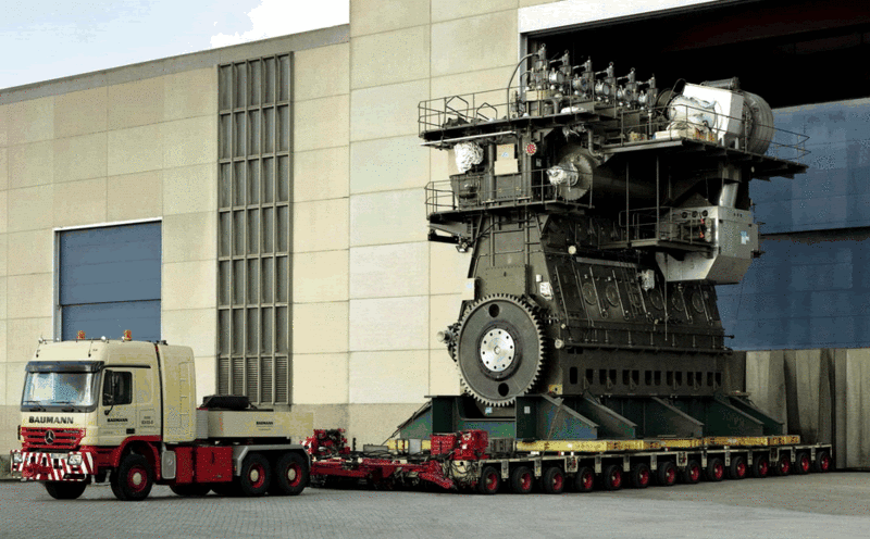

intocarss 05-02-2012 01:40 PM
Originally Posted by Vegas69 (Post 411612)
I think it's 65 or 70 lbs. It revs so fast I wouldn't want a lighter crank.
http://i2.photobucket.com/albums/y3/...engine_002.jpg

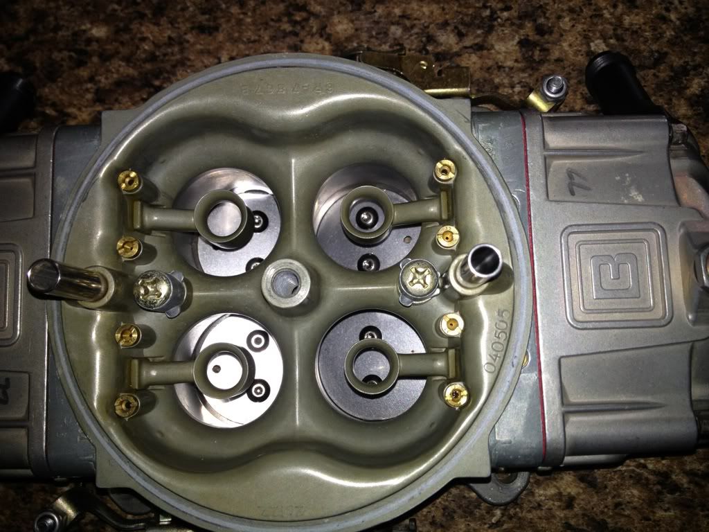

Flash68 05-02-2012 02:58 PM
Locked up my carb just now. A nearly fresh Braswell (dyno and 2 races) with 1.40 Venturi and 1.75 Throttle Body. Made 650hp on a 360" sprint car motor.
$600 (go for $1275 new)
http://i236.photobucket.com/albums/f...8/photo-15.jpg

Track Junky 05-02-2012 03:52 PM
Looks like he wrote the jet sizes on top of the bowls. Love playin around with 4150 style carbs. Theres a book out by HP Books, author Mike Urich.....Holley carburator handbook 4150-4160 selection, tuning, and repair. goes for $12.95. It will tell you just about everything you need to know.
BTW, great score :thumbsup:
