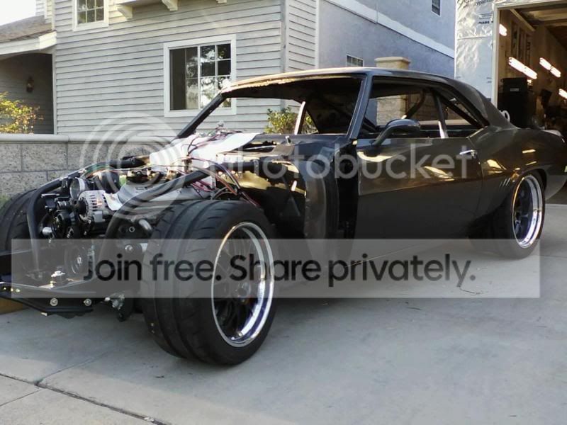

One of the other things that Ron requested was to clean up the existing engine wire harness covering. Which is good, because Im also not a fan of the platic corrugated covering. I have seen it melt and it collects lots of oil and dust from the engine compartment.
Ta DA..... now it's ready for me to route everything nice and tighty. Before I pull the wire tight, I will need to intall the intake, injectors, and all the engine accessories on the front.
Nice! The clear-loom covering....I like it. Easy to trace wiring that way ;-)
Funny - just sent you a couple PM's about this very thing. I'm sure you already have something up your sleeve lol.
Also a note sent about the steam tube plumbing - if not done already, it's a good time to plan that one too with the intake/TB out of the way but still with a mock-up or two to go and while you have easy access to the WP.
G.

Ron in SoCal 09-16-2012 08:31 PM
Originally Posted by Rybar (Post 436184)
That thing looks awesome, congrats Ron
Thx Ry!
G.
Clear loom! Why didn't I think of that? :lol: Call you tomorrow G!

Brett -- I always love clean and organized layout of stuff. My favorite part of Stielow's book and you're a believer. Customers appreciate that stuff. :thumbsup:
72Z/28 09-18-2012 10:04 AM
http://i1113.photobucket.com/albums/...IMG_3860-1.jpg
http://i1113.photobucket.com/albums/...o/IMG_4017.jpg
So, with some effort and a little patience, I was able to provide this stuff back to Ron (maybe he can try and return it) :lol:
http://i1113.photobucket.com/albums/...o/IMG_4016.jpg
Looks awesome man, just wondering from where you got the grommet to run the wiring harness through the firewall? Also, what size hole did you make to run the harness?
Ron in SoCal 09-18-2012 10:49 AM
Thx man. It's a 2" hole I believe and the grommet came w the harness from PSI Conversions:
