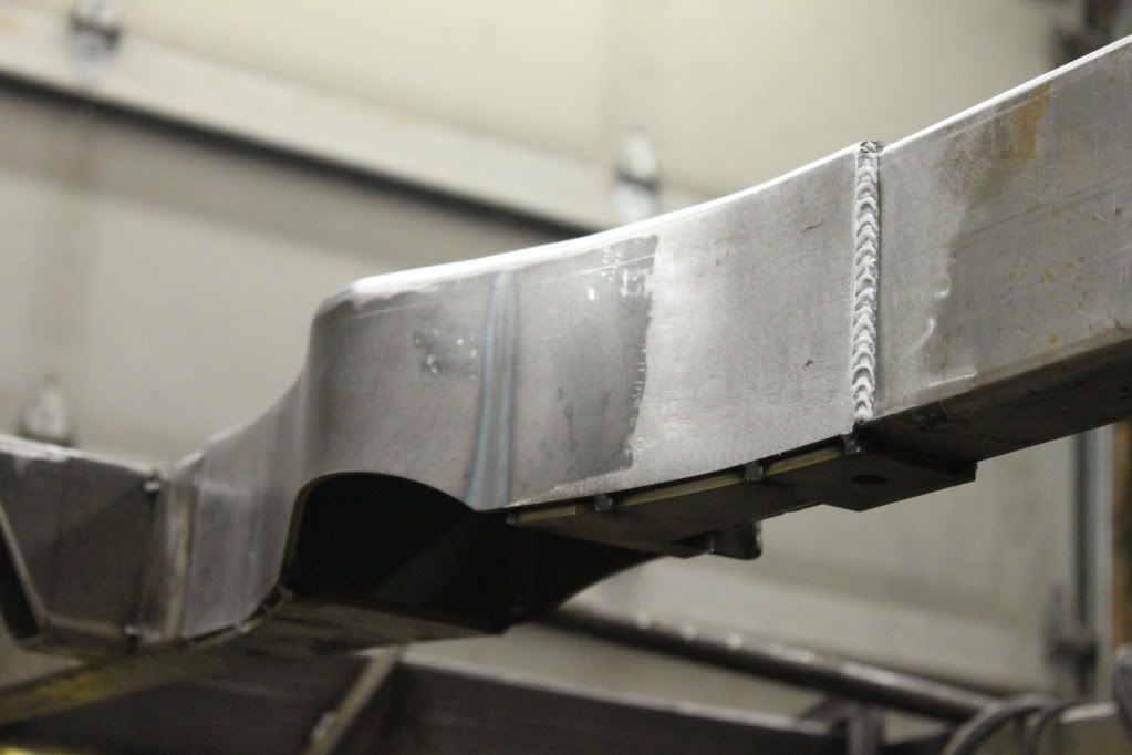

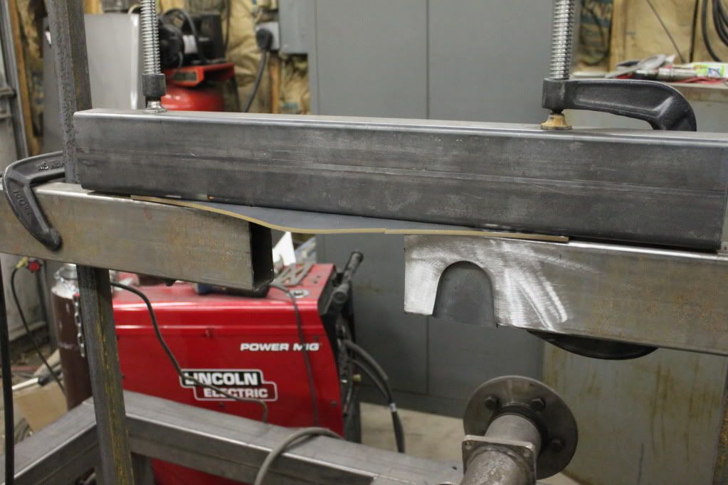

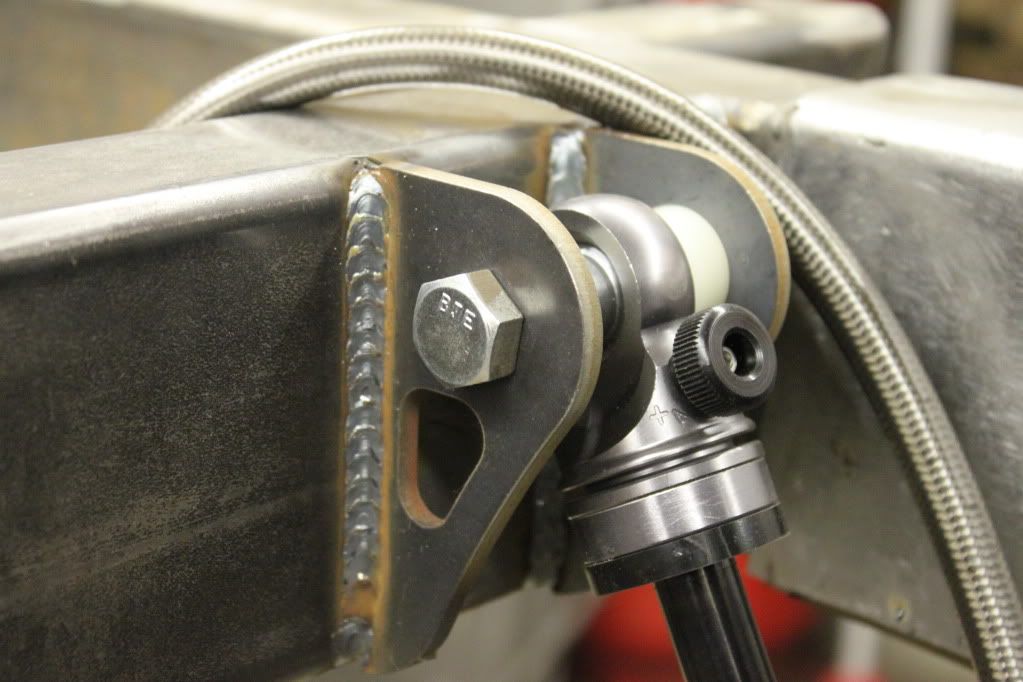

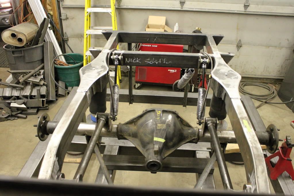

Chassis done, minus small brackets. But the rear is complete. Disregard the lower link bars. I used old bushings and angle iron as temporary lower bars to allow travel and location.
I get about 7.5" of lift out back limited by the shock alone
Bags sit up inside the frame now, better design and leaves more room for the exhaust coming over the axle.
The recess in the frame shaped like the upper link mount is to allow added clearance for the upper link bolt.

GregWeld 03-14-2011 08:01 PM
Nice work Nick! Love the brackets!
Oh yeah -- that welding ain't bad either! :D

thanks Greg, means alot. CAD really opened up a whole new venue for this build
