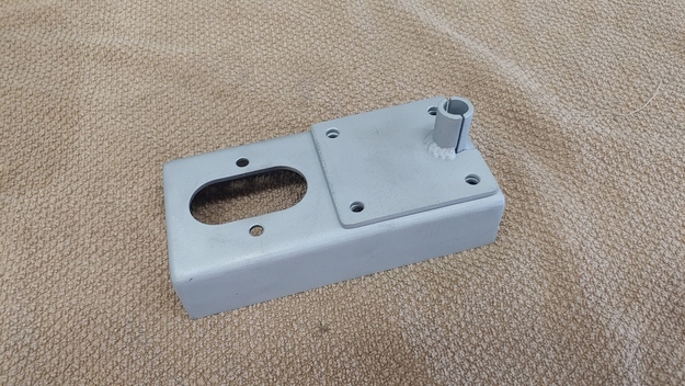

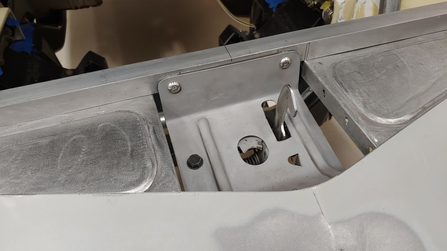

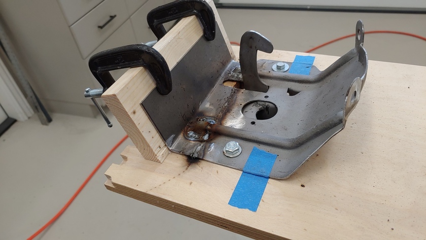

Fab'd up the cover for the hood latch.
Attachment 68570
Attachment 68571

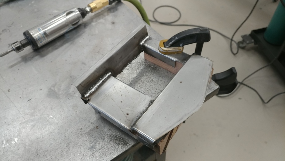

Small modification to the hood latch mounting bracket.
Attachment 68572
Still a bit of clean up needed before primer but everything clears and is functional.
Attachment 68573
Attachment 68574
Attachment 68575

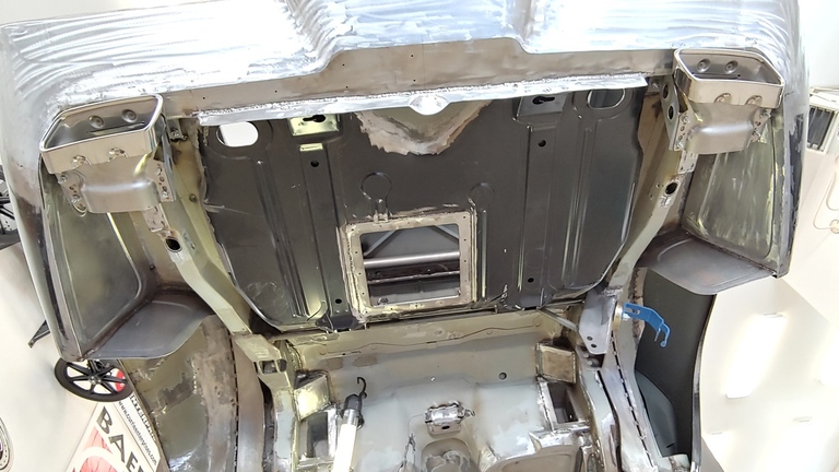

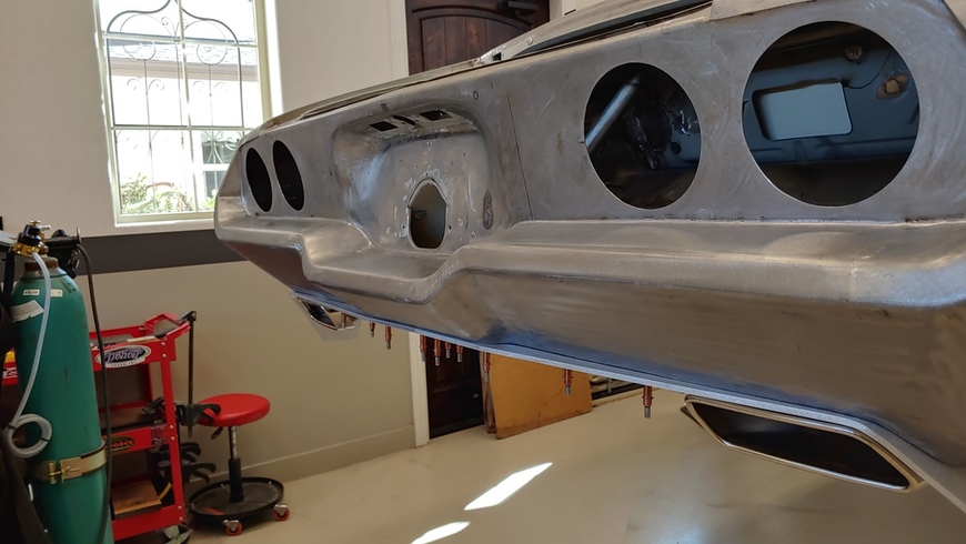

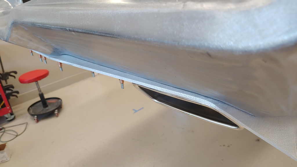

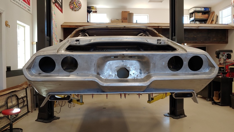

More progress on the exhaust tips and the start of the diffuser.
Attachment 68630
Attachment 68631

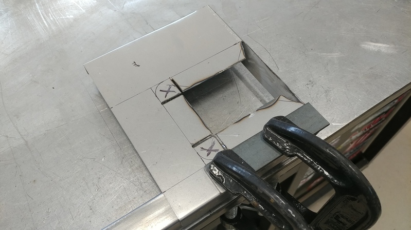

A little tech that probably most know....a carbide tip/flush trim router bit works great for trimming aluminum. I needed to bend the aluminum first and then cleco it in place to scribe the shape so it perfectly fit to the tips, then rough cut to shape, then straightened the cuts with a router.
Attachment 68632

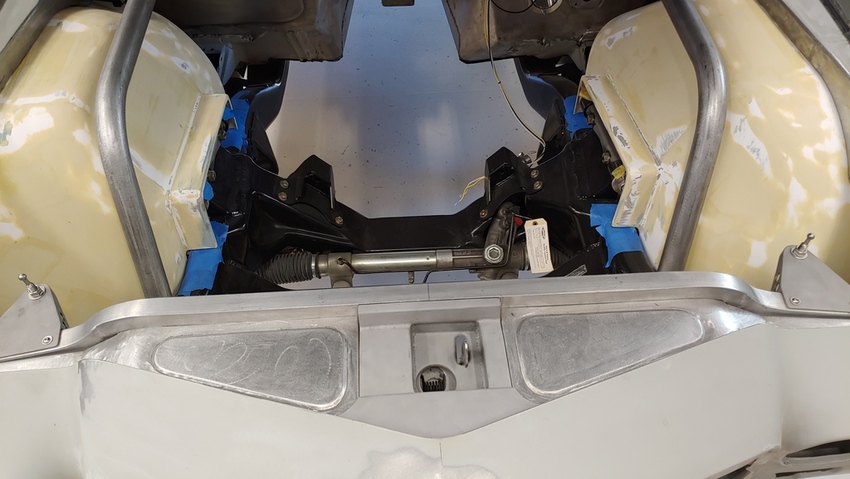

Still designing the center section of the diffuser. Will likely 3D print in plastic. Stepping away from this for now, just needed to get this area mostly tidied up.
Attachment 68633
Those wings will get trimmed way down...just waiting until the rear spoiler is underway so all of it will tie together.

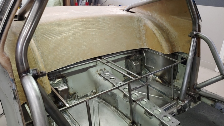

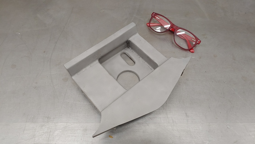

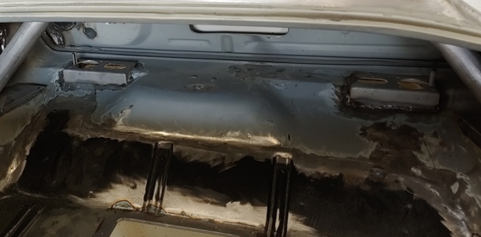

Built the frame for the rear-seat delete.
Attachment 68722

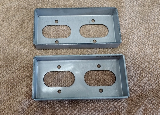

Fuel Tank and Differential vents: Started with these mounts from Chassisworks.
Attachment 68776

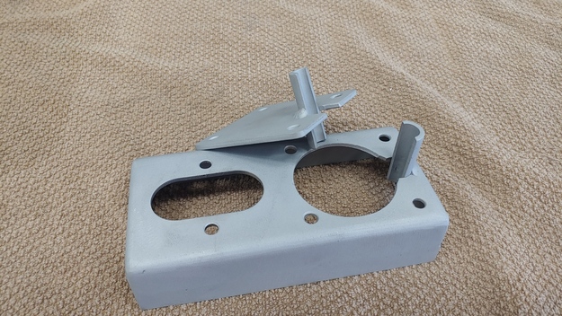

Then drilled a hole large enough for the JRi reservoirs and fab'd up these covers for the holes. Added a split tube for the reservoir hose. A rubber gasket for the cover and some foam rubber tube will seal everything up from water and vapors.
Attachment 68777
Attachment 68778
Just tacked in for now.
Attachment 68779
