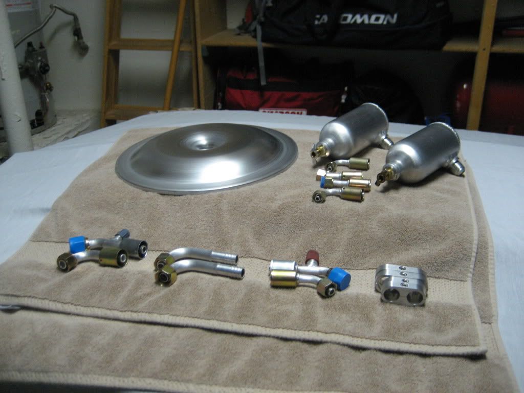

I didn't do much this weekend. I need an engine. Looks very likely for this coming week. :thumbsup: However I went off the deep end on the brushing. All AC/Heat fittings, air cleaner lid, hose seperators, and both breather catch cans. All sealed and ready to go.

akrapovic 02-22-2010 05:20 PM
Are you running a catch can off of both valve covers?
Vegas69 02-22-2010 05:28 PM
Yep, my new engine builder recommended it and not why you think. It's a matter of crank case air speed. One vent would evacuate the system but the air speed is higher and will carry more oil vapor. I didn't have any issues with the old setup but I only road raced it once. I'd rather it was over kill if anything.
g356gear 02-22-2010 05:28 PM
Originally Posted by Vegas69 (Post 269760)
I polished it, then used red scotch brite with even strokes multiple times. Then sealed it.
What do you use as a sealer? Matt finish clear?
Vegas69 02-22-2010 05:38 PM
Just Wizards metal sealer.
